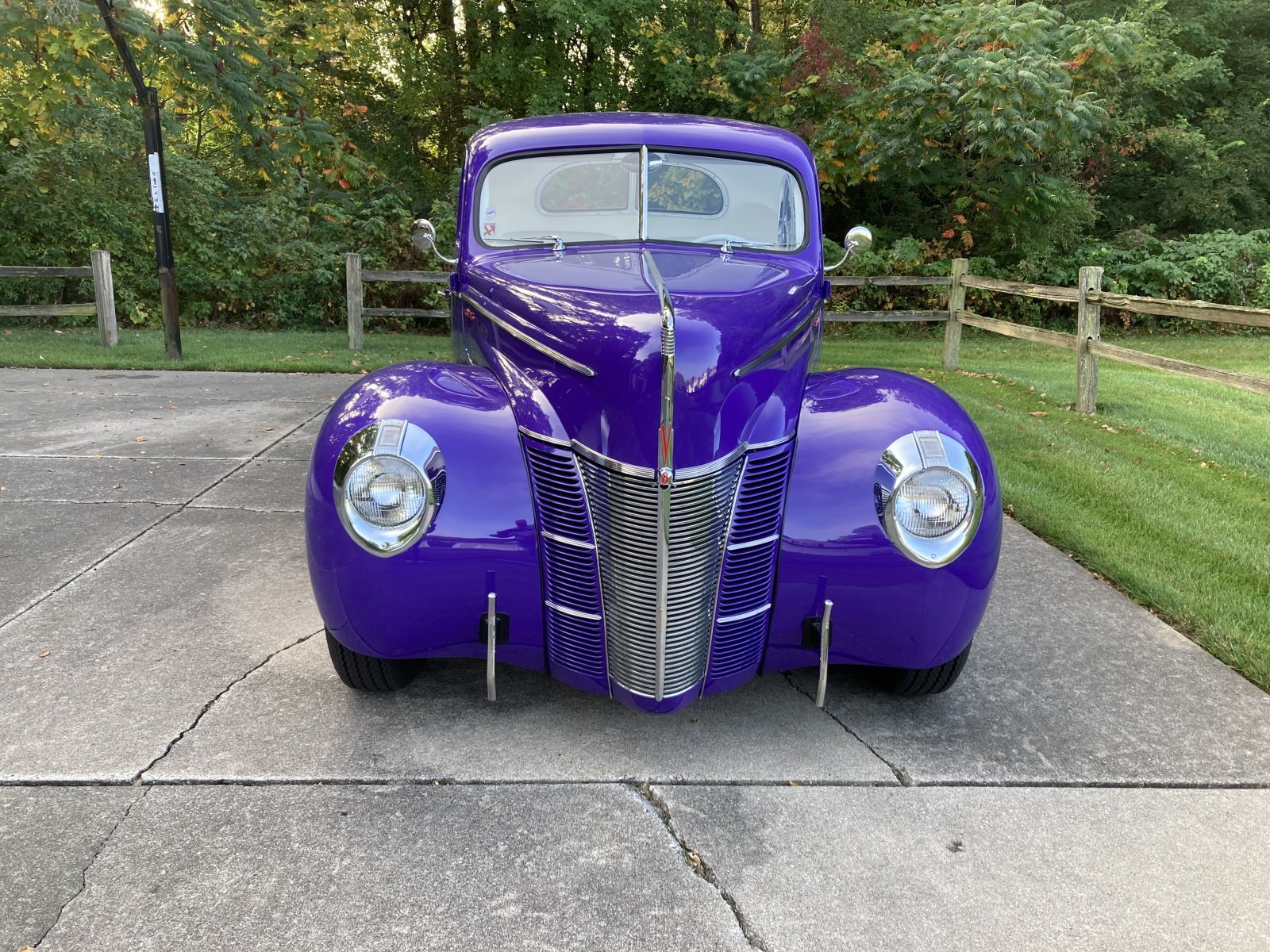

    I have had a great luck with the Drake hinge pin mirrors, I had the cowl mount ones and as others have said, the Right side is useless.you can see in this pick how far up the P*** side is so you can still see it.
    MMM1693 and lothiandon1940 like this.

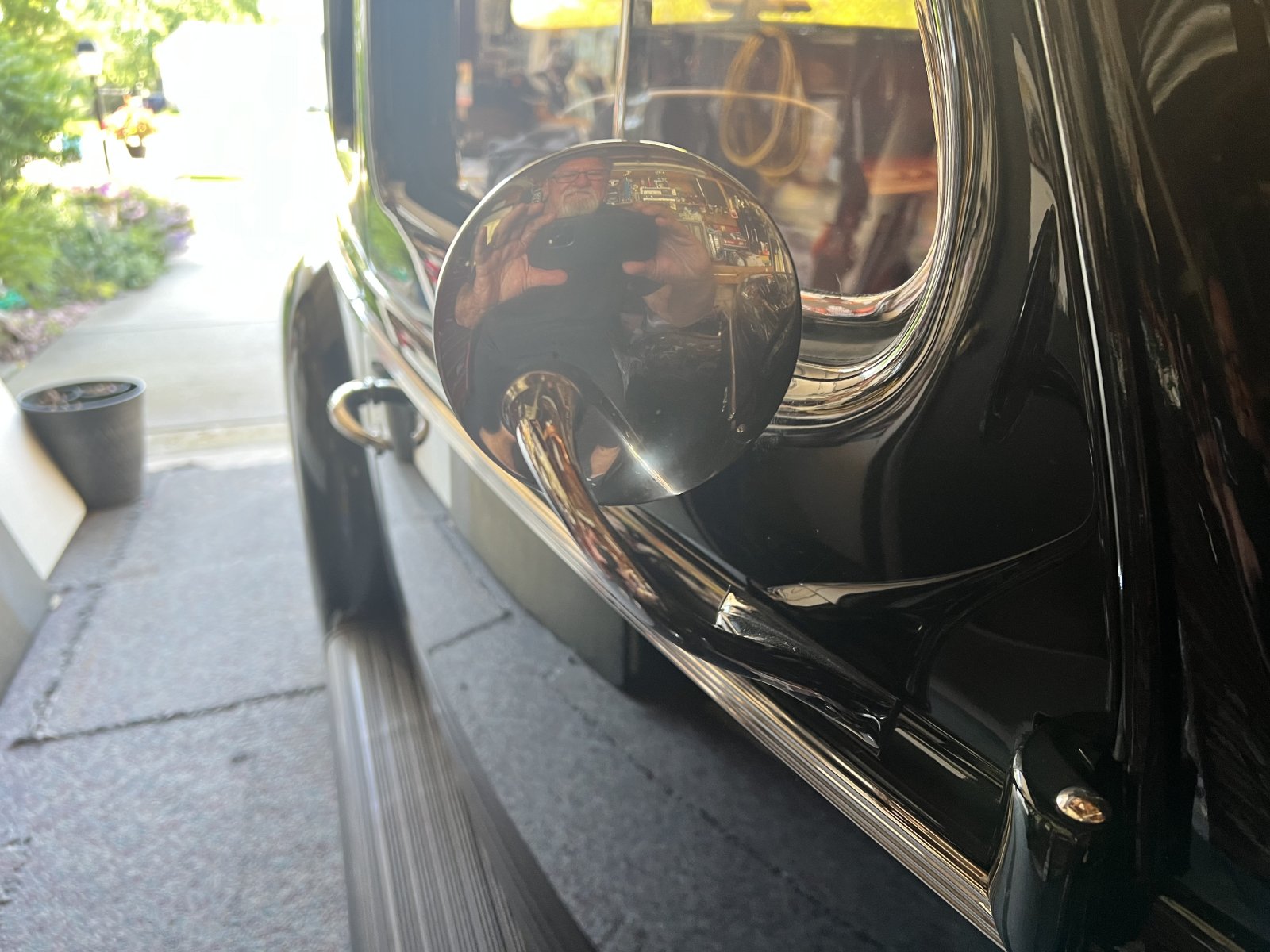

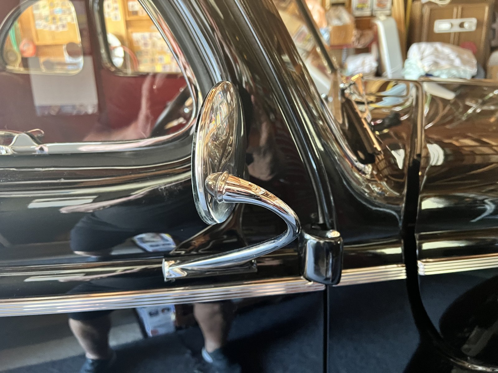

    Here’s a few pic’s of mine Dan, no problem seeing from driving position. These are Drakes but there’s similar out there. PM me if you’d like more photos. :D
