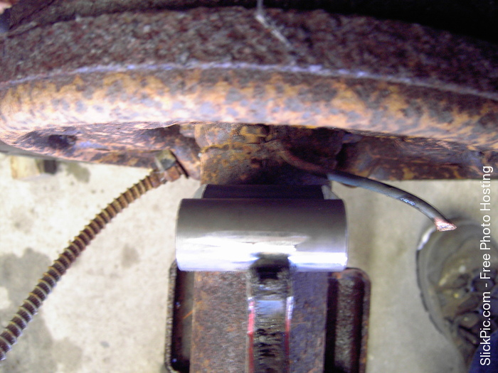

  3. I have a bronco 9" with a model a spring attached. The spring is loaded to 45" with the length of each shackle spans 49".....
    thanks, I appreciate your pointing out potential danger issues. I'll address those issues and make the 4 link frame brackets stronger. I'll redo the horizontal welds and gusset the bracket plate...
    also I'm still figuring out the placement of a pan hard bar. That should address the fro and aft movement.

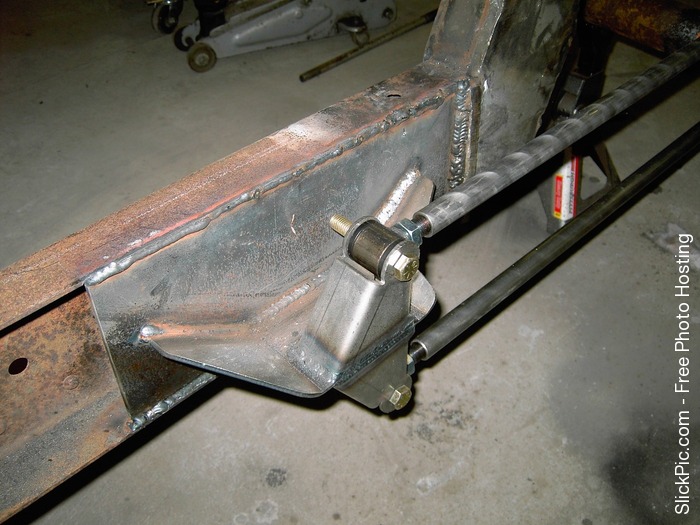

    I am in the other camp. Weld the vertical welds bottom to top. To keep them from looking ugly, cut the heat a little and s***ch your weld in a zig zag motion as you go up. Kinda like going up steps. It takes some practice and I am not sure if I would practice on my frame.
    A top down weld will look better and is easier but your weld puddle will follow you down and the weld will not get the penetration needed.
    I have heard the argument that top down is fine and that may be true for someone with some welding talent. But for an amateur welder on a weekend, I would doubt it.
    Another option is to avoid vertical welds. When you are working with the frame, lay it on its side and now you are working on a horizontal plane. I have done that when I can.

    Maybe you don't have a Bronco axle then, because the mounts would be right up against the backing plates, blocking the wheel cylinders. Bronco measures 58" from wheel mounting surface to wheel mounting surface. A panhard will not address the arc that 4 link travels as it moves up and down. The Model A spring wants to move straight up and down. It's going bind during it's travel if it moves in that small of an arc. Spreading the Model A spring to it's stock mounting points eliminates the need for the panhard. But since you have an early Bronco axle, it won't work. Put backing plates on and you'll see.
    You are just going through a lot of work to use that spring. Just buy some coil overs and be done.
  7. thanks for explaining the problem....it does measure 58" and it is a early bronco rear.
    Even though I believe what you're saying, I'll mock up a backing plate so I can get a visual.
    So coilovers and pan hard bar and that should make the rear end setup safe and strong. Is that correct?
    I really appreciate your constructive feedback. I'm not posting this build to bust balls. I need help to make this build, strong, safe,mechanically and structurally safe for me and everybody else on the roads. I learn by everybody's comments, neg. and pos.

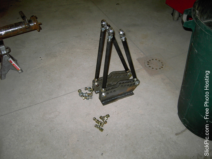

    the buggy spring will work and has to be at least 49 1/4" and then I don't have to use a pan hard bar. My 4 link bars are way too short. It was suggested that 26" bars would be much better.So my 4 link "race car" setup is out and for sale. I've got some Pete and Jakes 27 1/2" bars coming. I'll mount them on the inside of the boxed frame rails.
    A lot has been said about a buggy spring and a early bronco 9". If I turn the mounting bracket around I have 50 5/8" to work with, I only need 49 1/2". Sure it's close to the backing plate but I'll have ample room to attach a brake line plus bleed the brakes.

    In your second to last picture, the spring hanger is turned around the wrong way and a shackle won't be able to swing, but in the next picture the one on the other side is facing the right way. I don't know which picture is newer.....

    You can't turn it around like that. The shackle will get up against it and the spring will not be able to grow longer, therefore can't compress= solid suspension.

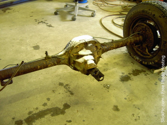

  19. well, I went to my stash of rear ends and found this 1965 fairlane 500 9".....measured her up and I believe this will work. She has 3:50 gears but just one wheel drive, so I'll change that to limited slip.
    and yes, the early bronco rear is too narrow to properly run a buggy spring.
  20. I won't learn if I have somebody does my welding for me.I lay a good penetrating beed then go over it fast just to add more material. I'll stop that bad habit I have. You'll be able to judge my welds better.

  25. got the buggy spring hung at exactly 49 1/2".......also installed my pete & jakes parallel bars. I still have to fine tune the pinion angle to 3 degrees.
    For those of you who are like my brother-in-law, able to see and point out any flaw in my projects, yes, the axle mounting brackets for the parallel bars are different.Why? BECAUSE!.......
    I'd like to thank all the critical ***holes, I mean , concerned hot rodders for the continual pressure concerning my "inadequate" welds and lack of skills there of. You forced me to seek outside help, improve my welding skills and technique.My buddy ,who is an excellent welder, gave me some hands on instructions. I don't learn if somebody says "you **** at welding" I learn by example and practice. 90 % of the welding done on the parallel bar work was my buddy's,some of my 10% work you can pick out and the rest is the same as my buddy's.Now ,I'll go back and re-do my old welds........
    thanks you guys,keep on pointing out the good and not so good things you see in this build.
    I personally think the pete & jakes parallel bars look so much better than the "race car 4 bars set-up I previously had.The 27" bars will work much better.
    One other thing I learned was ,my rear is an 8", not a 9", I've ordered the parts to make it a limited slip differential, 3:50 gears.

    The new 4 link and ***ociated welds look muuuuuuch better. Good job! Keep on learning brother, its a journey to greatness.
