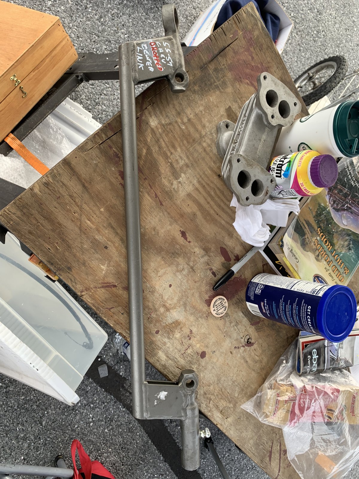

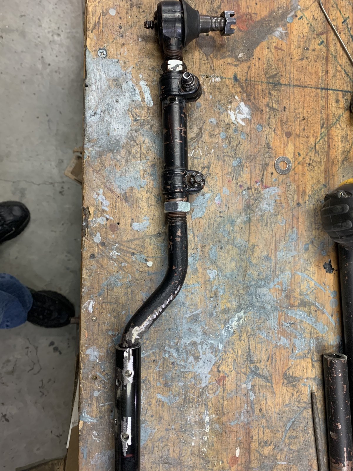

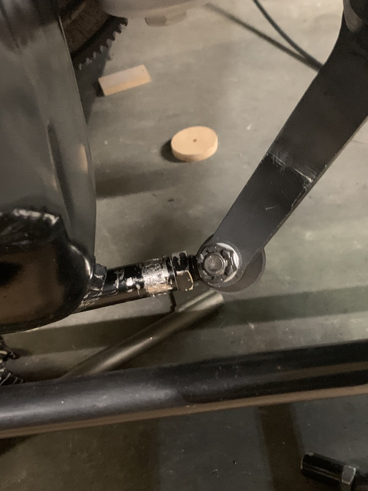

    Yes, I finally have updates! The house projects are nearly done and the last couple weeks I have had an hour here, and an hour there on the truck, working on my steering problem. I bought a dropped steering bar setup for a ‘57 Chevy in Hershey that I thought might work ….
    But my biggest problem still was the steering arm’s closeness to the oil pan on a full left turn. I had shortened the steering arm a while back so I ordered a new stock one from CPP. I figured let’s start fresh and see what happens. Once I had that, the ball really started rolling for me.
    The stock arm is 1.5” longer than my shortened unit once installed was now sticking below the oil pan at the tie Rod end. That was a good start but upon moving to a sharp left with a tie rod end installed on the arm, it interfered with the steering link. I then heated the arm at the top on the splined end, and bent the arm 1/2” at the tip towards the firewall. It now cleared the pan area even better ….
    … with a full inch between the top of the steering link and the bottom of the pan with no steering link interference. I am also running away bars front and rear, minimizing body roll for left turns into driveways, speed bumps, auto cross …..
    Now I had to meld the solid rod portion of the steering link to the hollow tierod end. The solid rod was just a bit too big to slip in so I ground down the solid rod until it slipped in. It is in 3.25”+ and I will do 4-5 rosette welds through the hollow rod as well as weld it at the pictured end. All in all, it worked out well.
    So the motor will remain at its present height and I will begin fabricating a ****** mount and get the angle degree of the rear and the ****** dialed in.
    It’s been a long break and we have some things going on the next two weeks but I can now finally move forward.

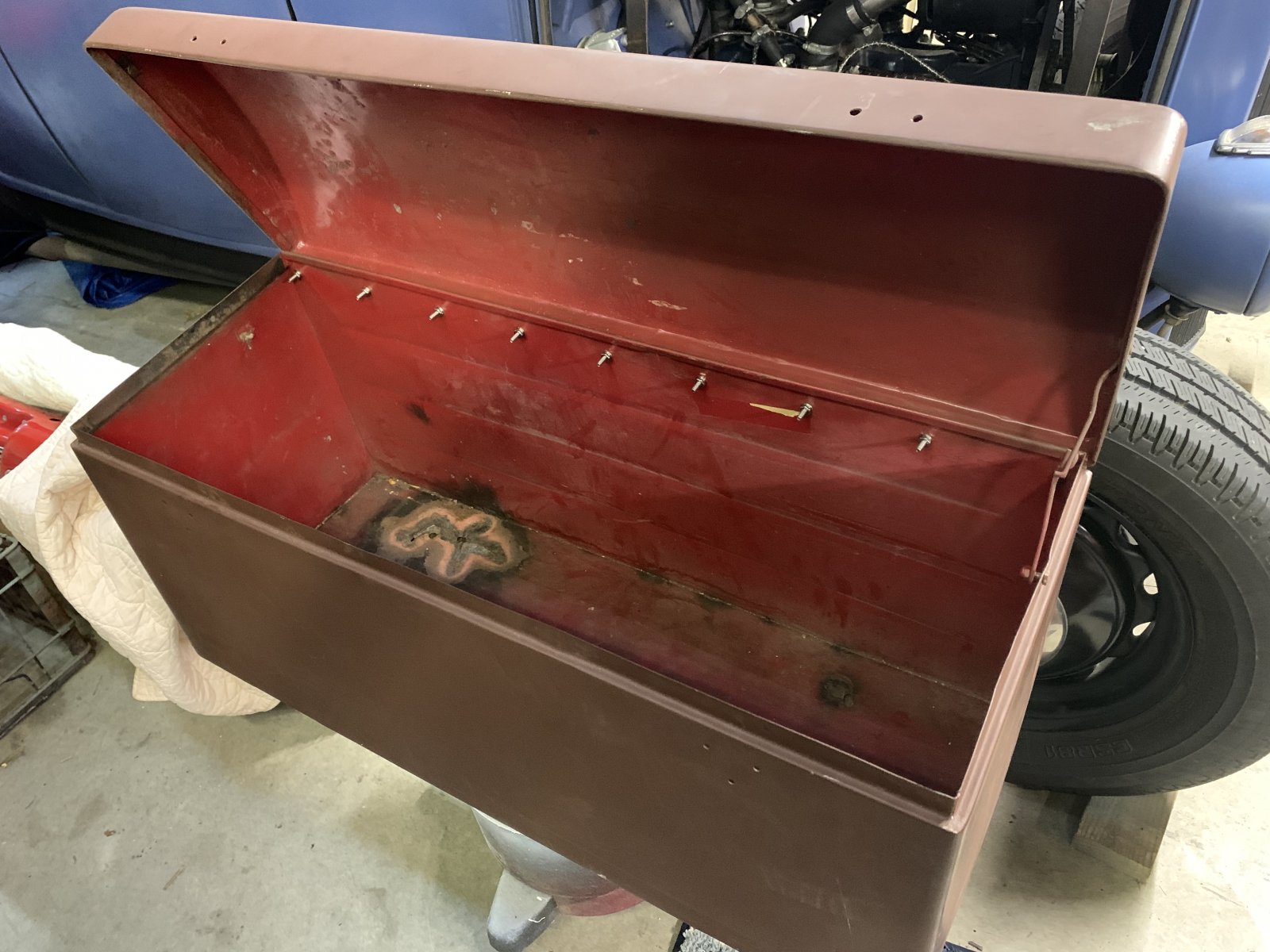

    One final note - a while back I bought a old military trunk for the back of the truck, prepped it and cleared it for the weather. But at Hershey my buddy Gabby had a nice metal trunk that is the right dimensions for the bed and was going to sell it since he bought one that better suited him at Hershey.
    The height is just below the angled top rail
    of the pickup and the width is good ehough to have a spare on either side. I have since bought some lockable hinges and I deciding on whether to paint it the color of the truck (that may be too “matchy-matchy” for my taste), black (but it will be hot as hell in the summer), or maybe a color that does not match the truck color but is somewhat similar, like my 32 coupe rim color ….. we shall see …
    Regardless, it was a good day and I am very happy to be over the steering link hurdle …..

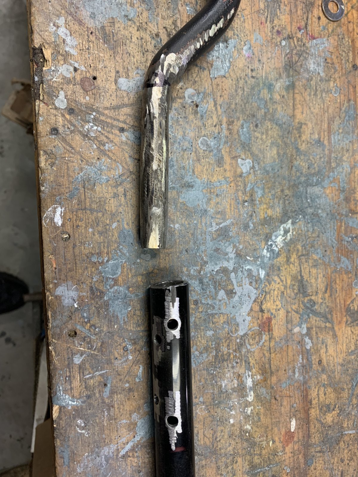

    Our some time in on the project here and there - one somewhat minor problem is the steering link hangs a bit below the scrub line right where the rod end attaches to the steering. Not much but I am not comfortable with that. Did some measuring and a heim end would put me where I need to be. Ordered the parts I needed and we will see what else might need to be tweaked.
    Here is how I have set up the area where the two pieces of the steering link meet ….
    Holes for the rosette welds have been drilled ….
    … and here it is tacked together.
    The overall length of the steering may have to be extended to accommodate the heim end having a shorter threaded end than a tie rod end. I will handle that at the joint above.
    I am pretty much occupied with some travel plans and family time the next week or so. My parts should be in though by then when I am ready to get back on it …..

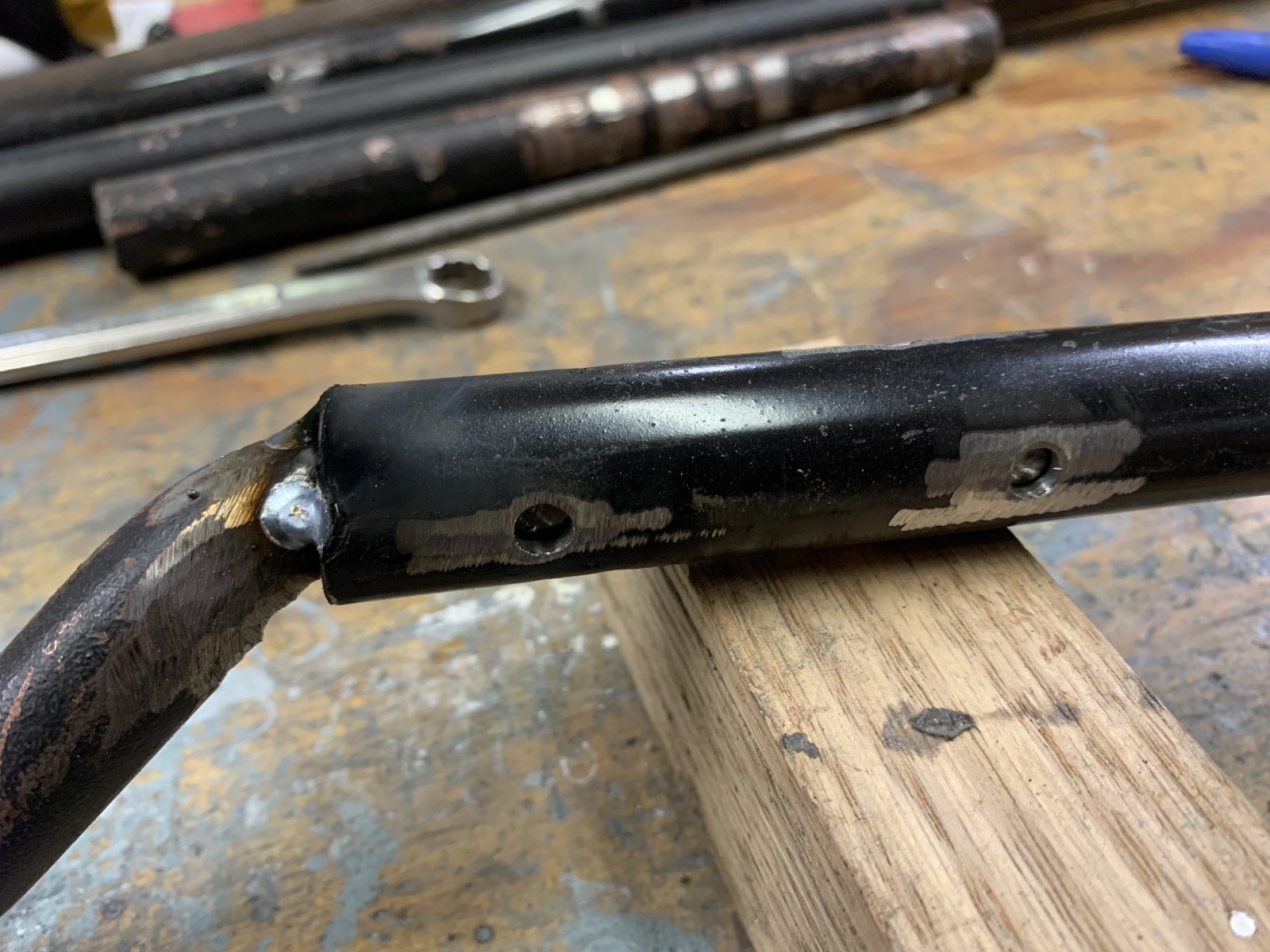

    I try to cut a chamfer on the holes in the sleeves for the rosette welds so that it's easier to start the weld on the shaft and work your way out. Keep it up; you're nearing the finish line.

    Although I have been doing small things from time to time, I finally got in the garage to DO something today. I checked out the steering link, making sure things would clear, and welded it all up …..
    I got my toe in close before welding things up but I may have to shorten the link just a bit. I will do that at the steering arm end and tap some additional threads in for the heim joint. I will also lift the motor a little bit more - two large washers per side - to bring it up just a tad. I will clean things up, paint, and move to fabricating the ****** mount. I also have to enlarge the steering arm tie rod end hole to 5/8” for the heim joint.

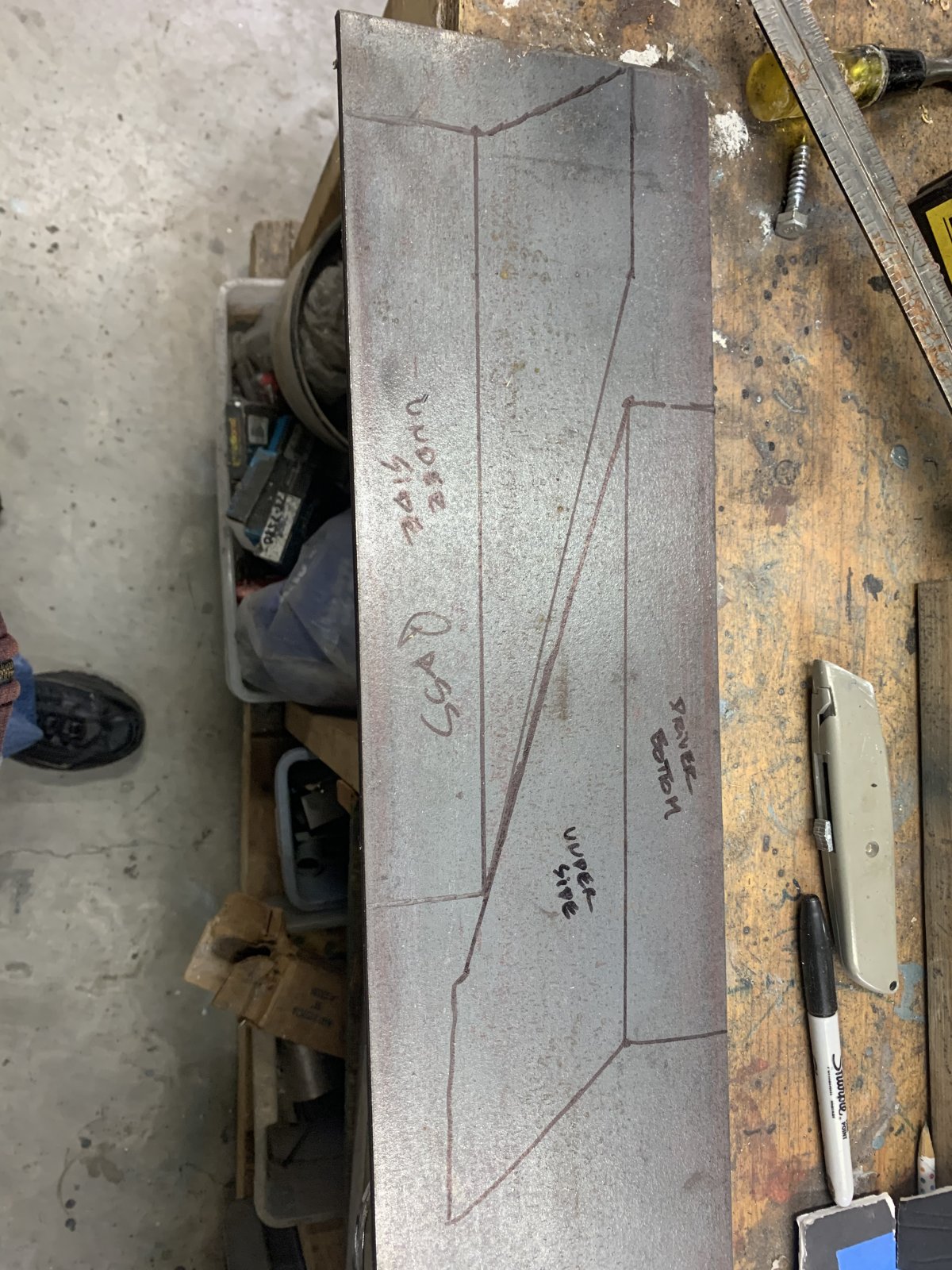

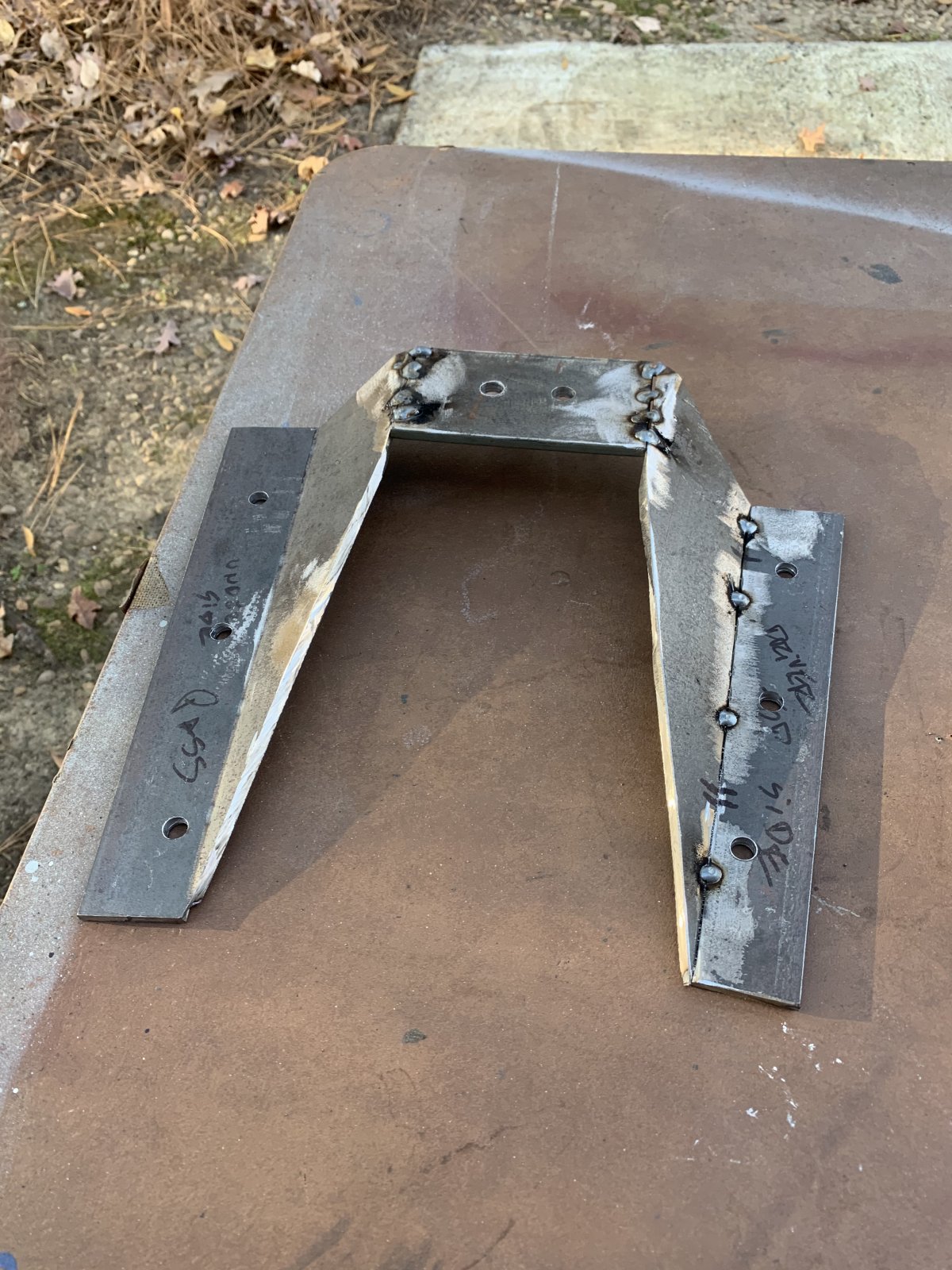

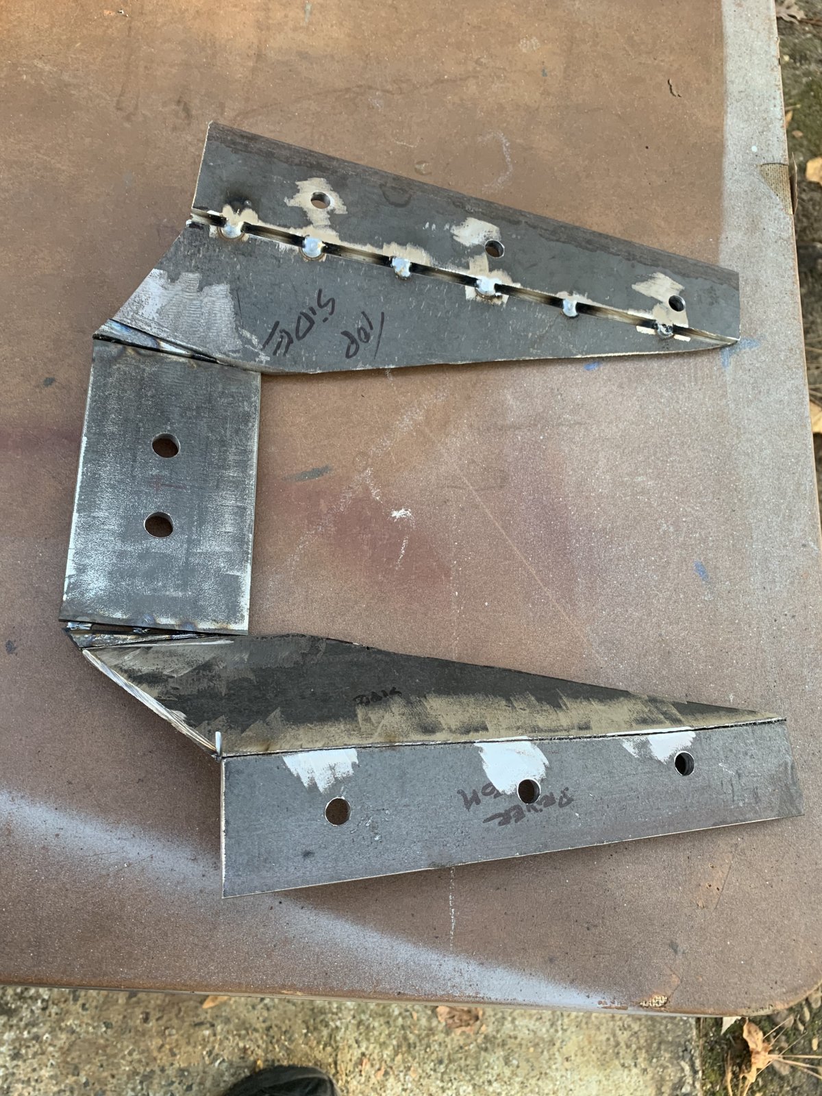

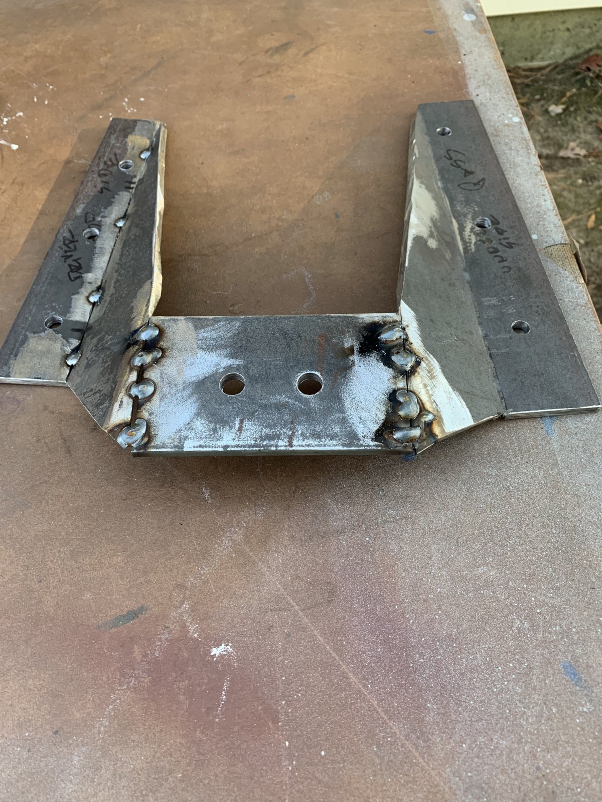

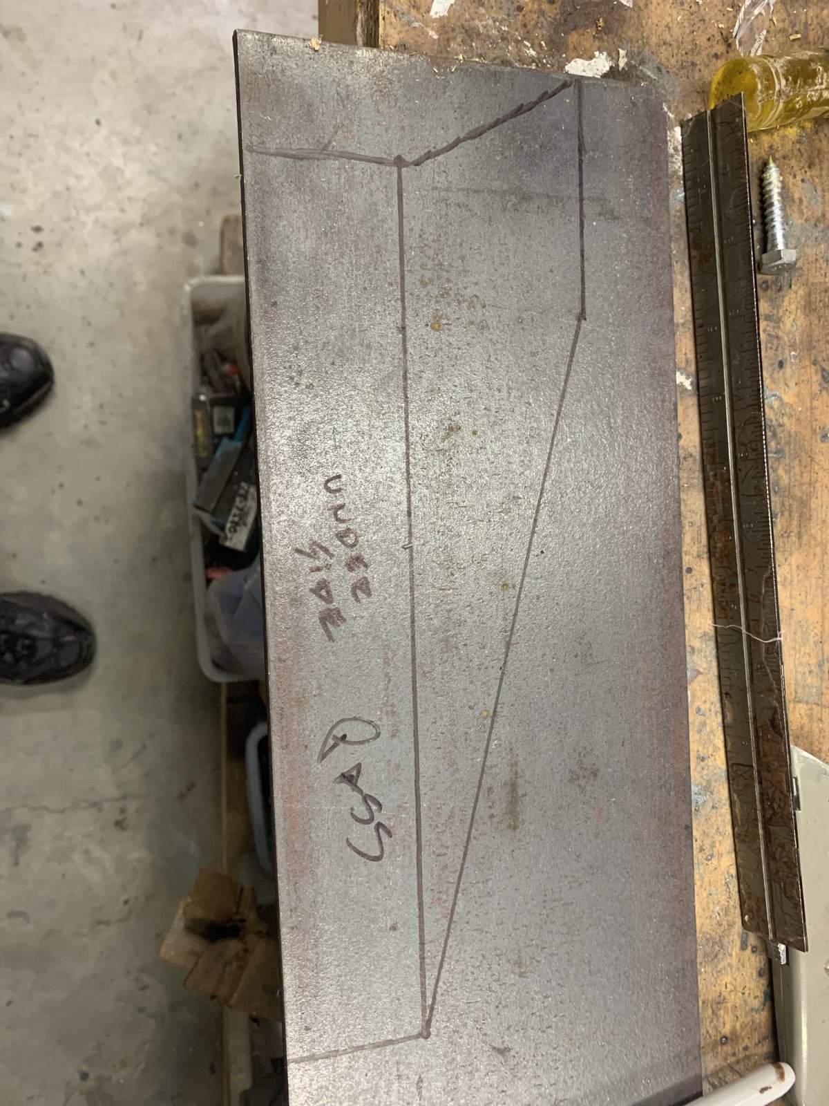

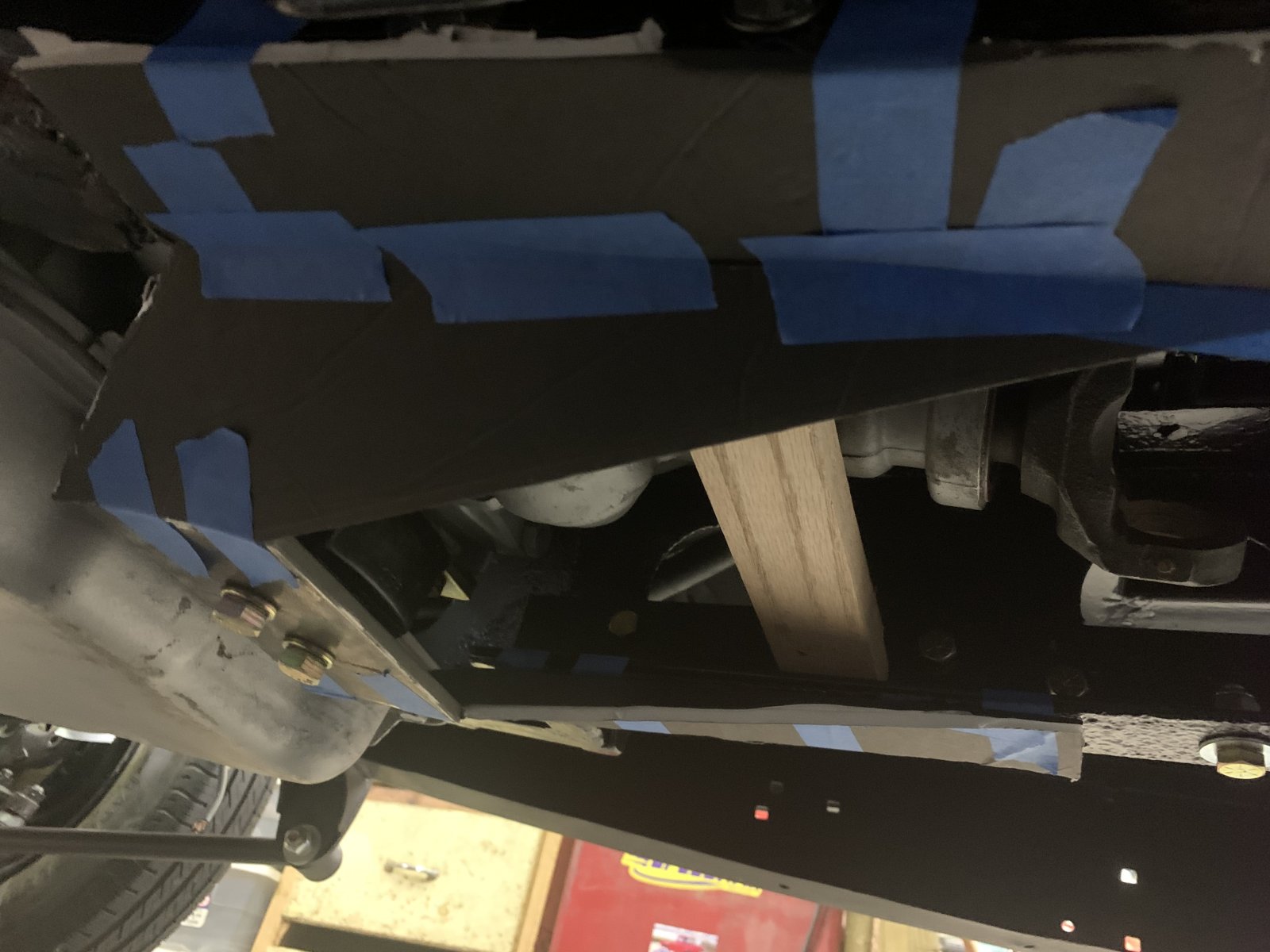

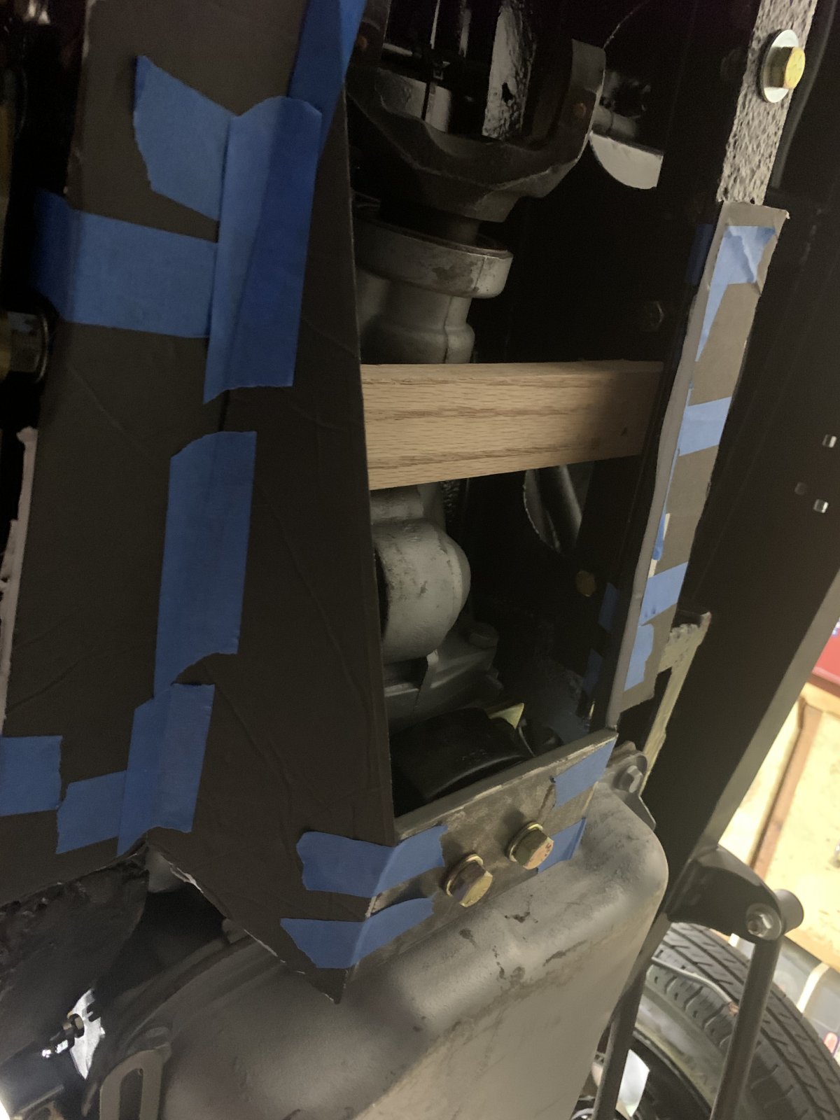

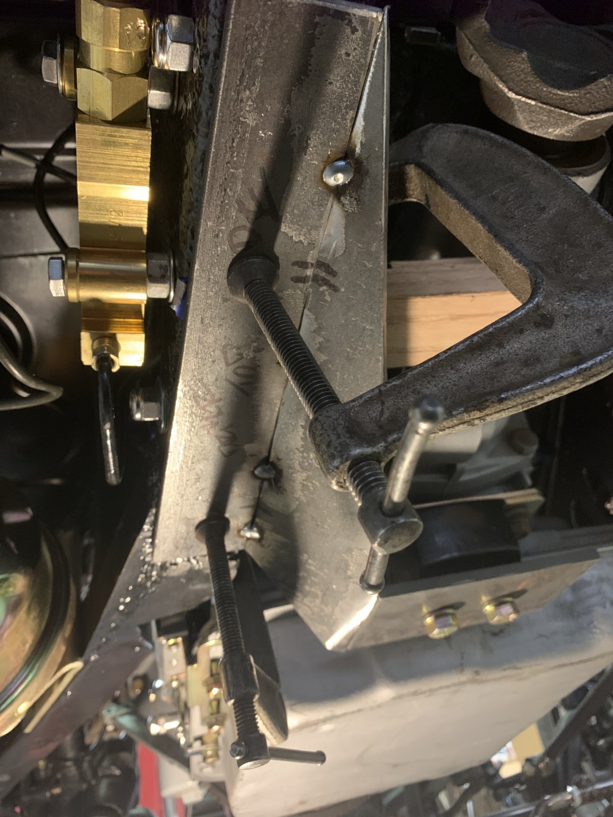

    I worked on the ****** mount today. It loosely resembles the Mod A trans mount you can get from Speedway but made for my modified “X”-less 36 Ford frame. I first cut out a 3x5 mount plate, drilled it with with two single bolt holes - the slots will come later - and bolted it to the trans mount ….
    I then started on the p***enger then driver side templates ….
    I then transferred each side to steel - it’s hard to see from the pics but there are angled pieces on each side that sweep into the frame rail pieces - and cut them out ….
    I am presently working on the driver side angled steel and about ready to attach it to the mount plate and to the flat bar that goes under the frame rail. I only had about 2 hours yesterday and 3 today but I should have it all tacked together with pics tomorrow. Then it goes back under and the fun begins with drilling the 3 mount holes on my back, upside down, and through the flat of the frame rail. Remember they are reinforced with bed rail so it’s double thick. I have more money invested in drill bits, let me tell you ……

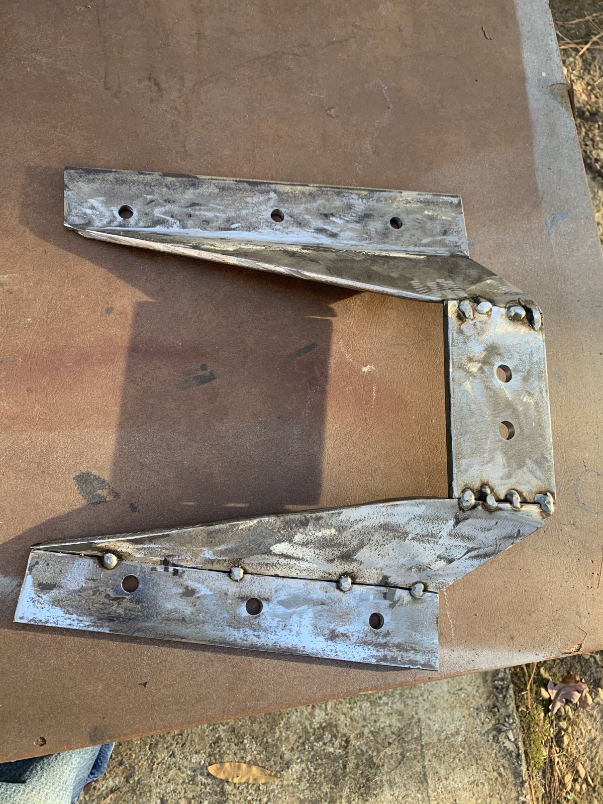

    I got the ****** mount tacked together on both sides and drilled it for the mounting bolts ….
    It came out better than I expected - I will reinstall it in the frame, drill the mount holes for n the frame rails, and then get it all tig welded up. I put a slice in the steel to bend the sides up but I cut too deep on the first one but the second one came out pretty good. That’s the reason the side pieces look different.
    I hope I can have this all ****oned up and painted soon so I can work on the exhaust some before the surgery…..

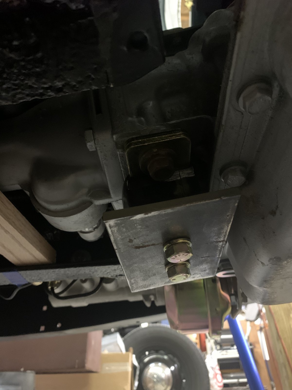

    I finished drilling all my holes and confirmed its installation. Tomorrow it goes over to my buddy Koppy to get tig welded and I may get it back on Sunday as we are in the Williamsburg Christmas Parade together with a few other guys. We call it Williamsburg Rod and Custom just to goie our group a name and it’s a-once-a-year thing ….. I may post a pic or two of my 32 coupe bedecked in lights. I will also be prepared for how many people will call it a rat rod - grrrrrrrrrr …….

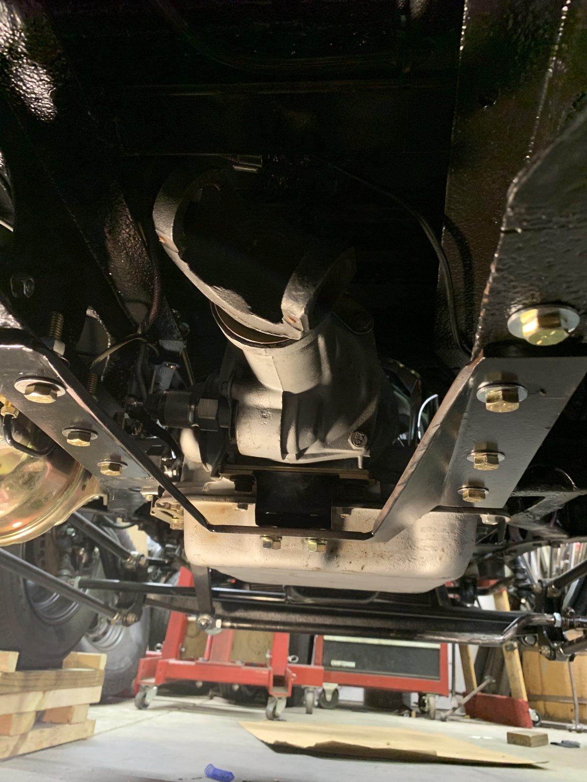

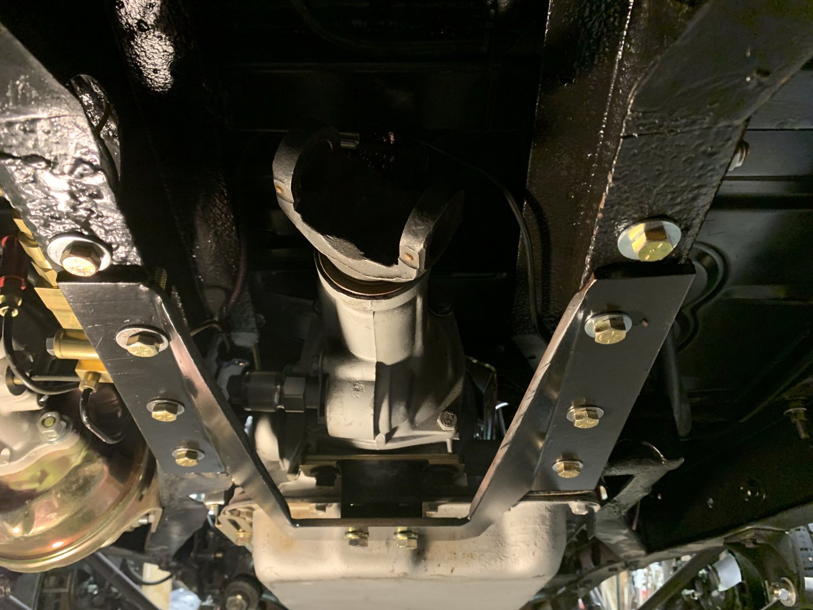

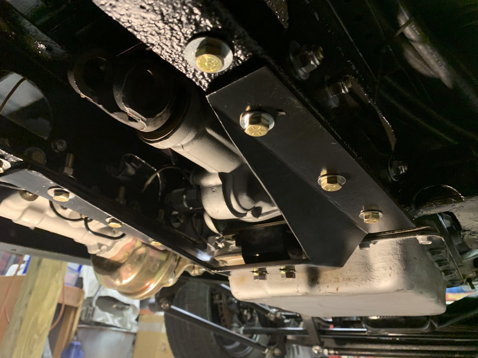

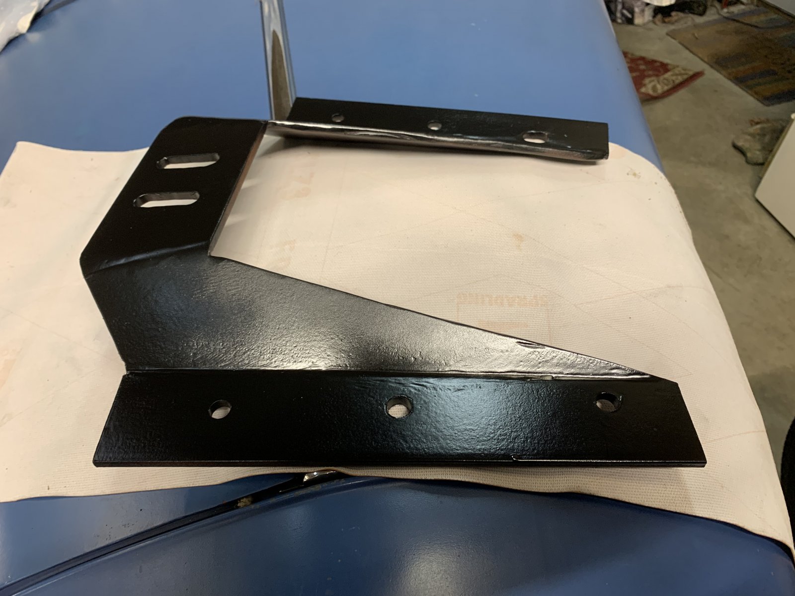

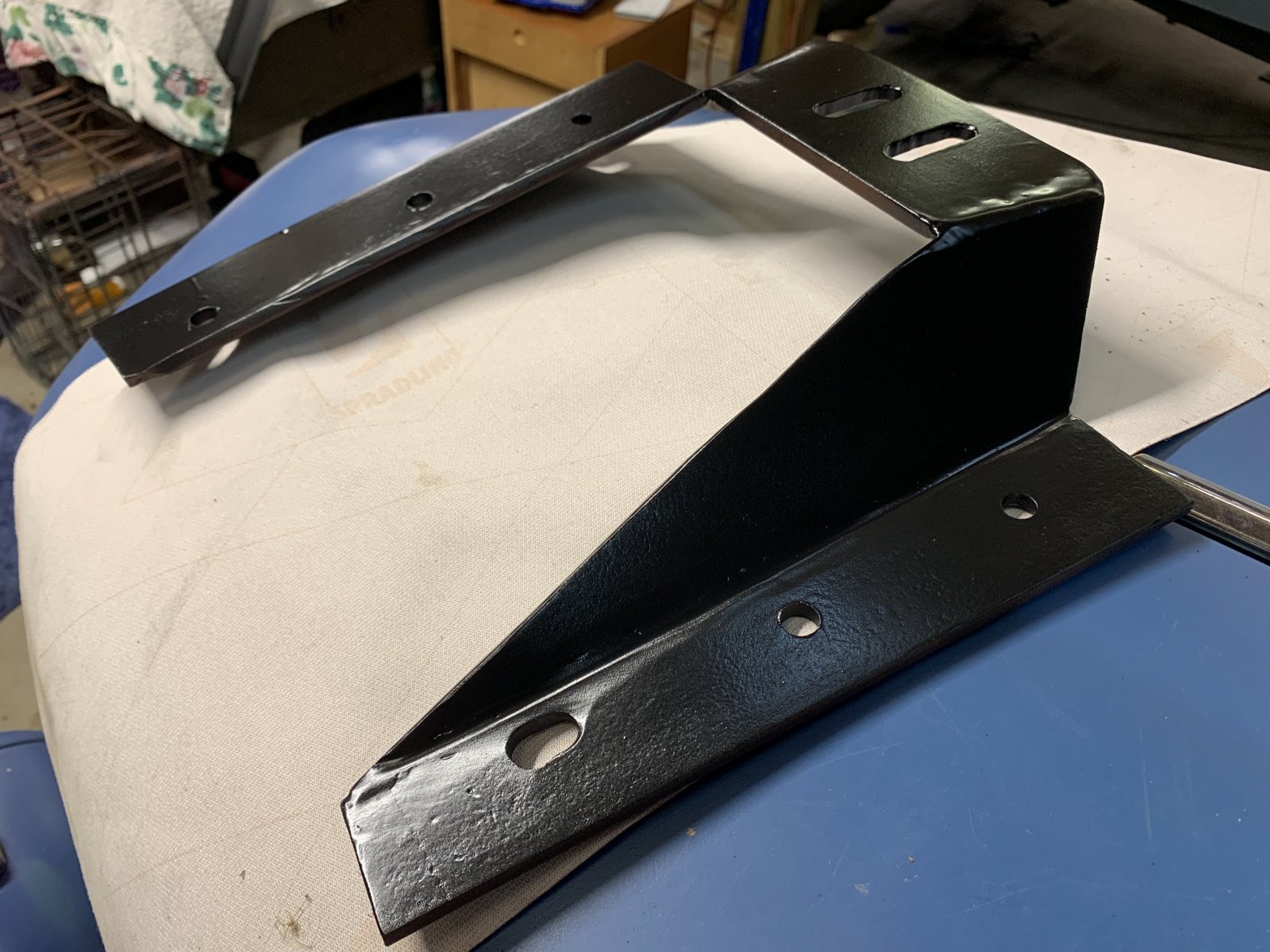

    Picked up the trans mount today and painted it …..
    …. and it went in easy as pie …..

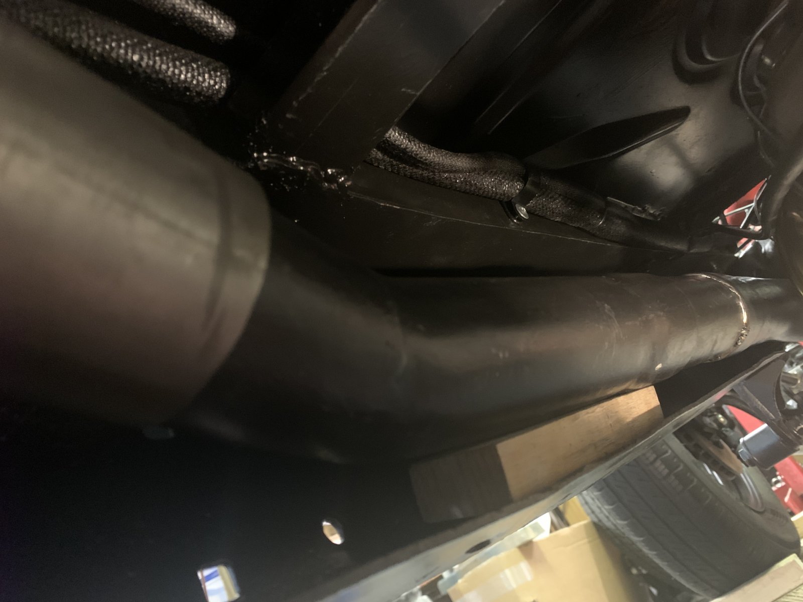

    With that done, I started working out n the exhaust which began with t******* the one side of the ****** some the exhaust would clear. Nothing structural, just the one end that holds the outside bolt of the flywheel cover…
    … and it came out pretty good ….
    There are one or two frame rail spots that need to be trimmed to clear sow or f the add one to the ****** as well but I ran out of time. Before turning out the lights I did begin on the driver side exhaust, just seeing what I had made up that will need some modifications ….. a good day ……
    Stogy, brEad, RAK and 6 others like this.

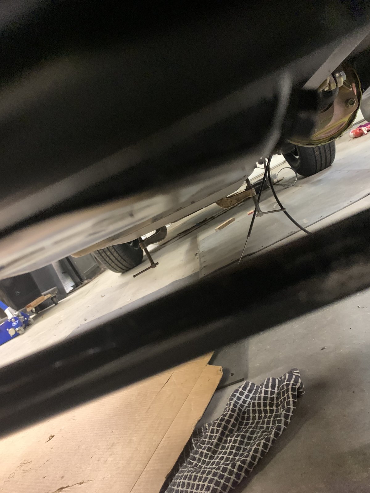

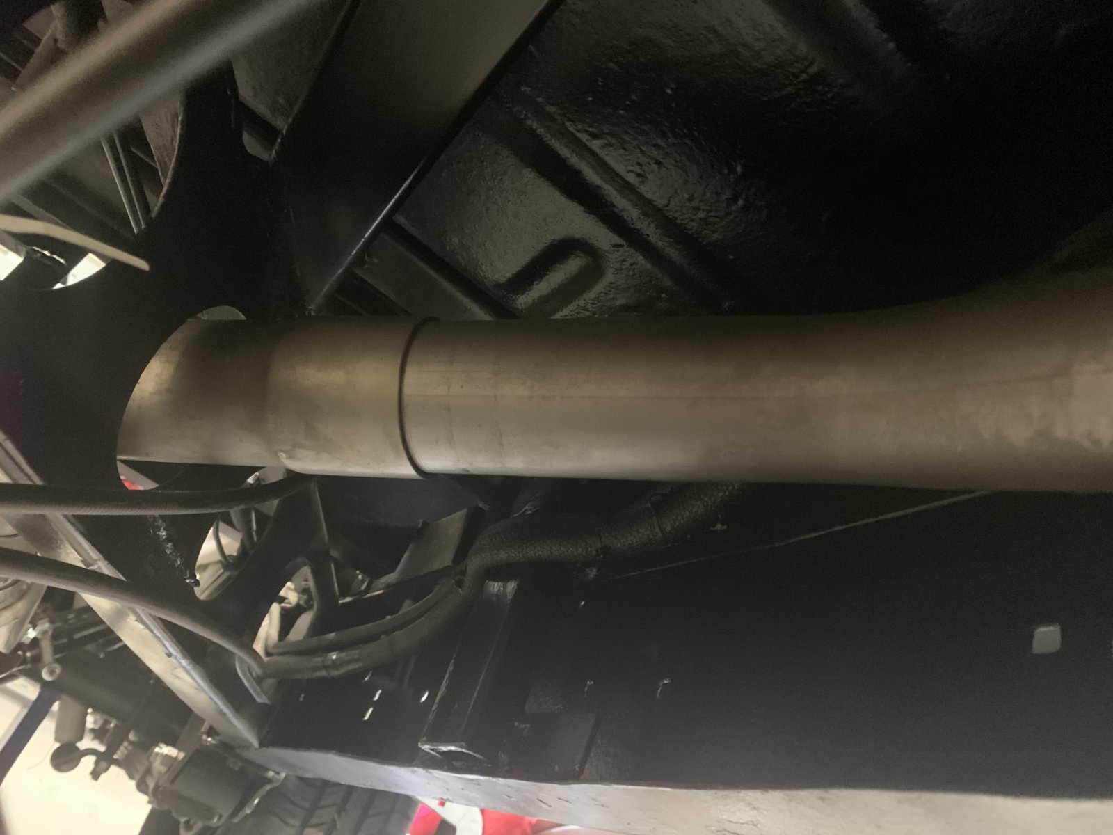

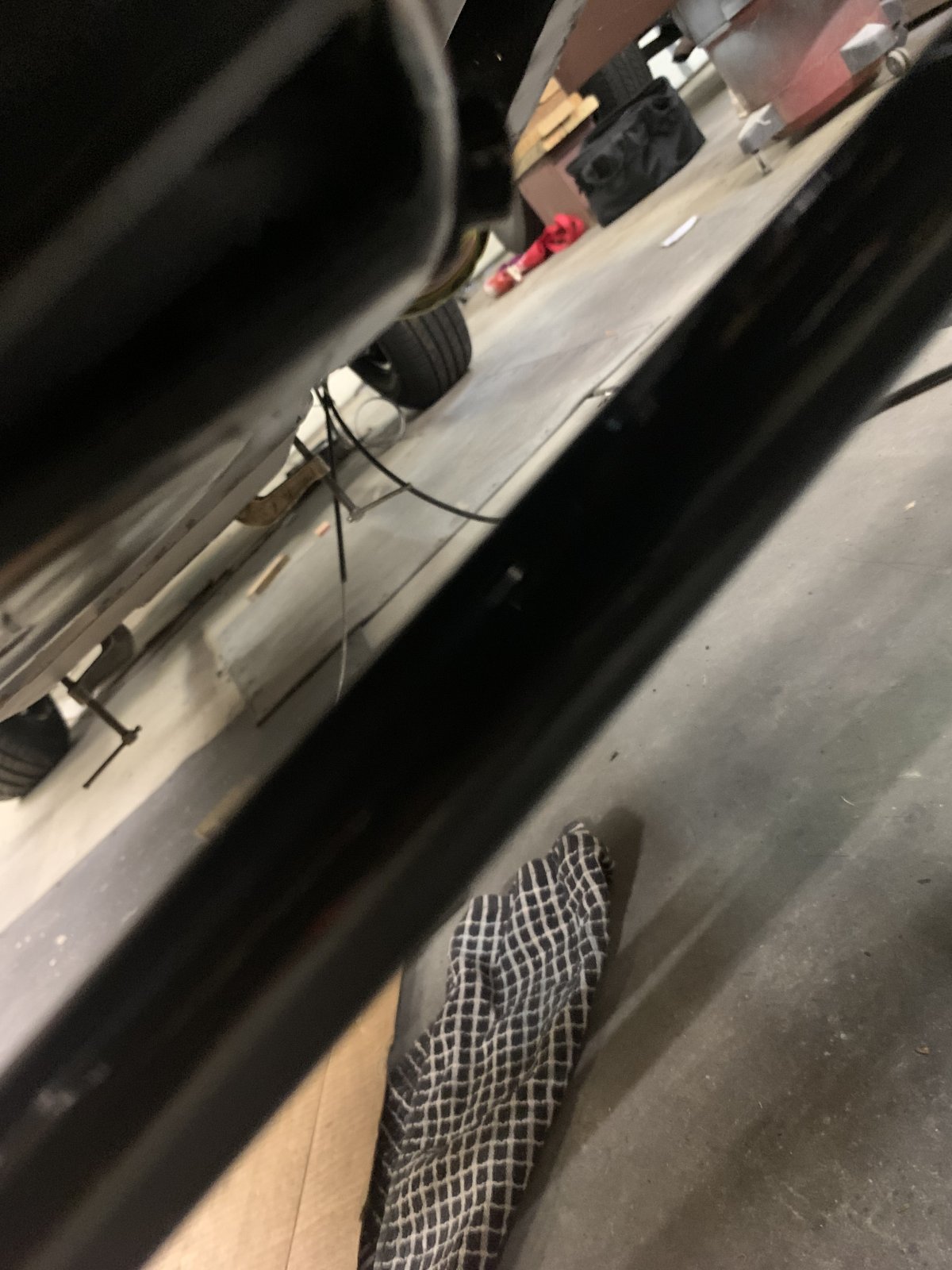

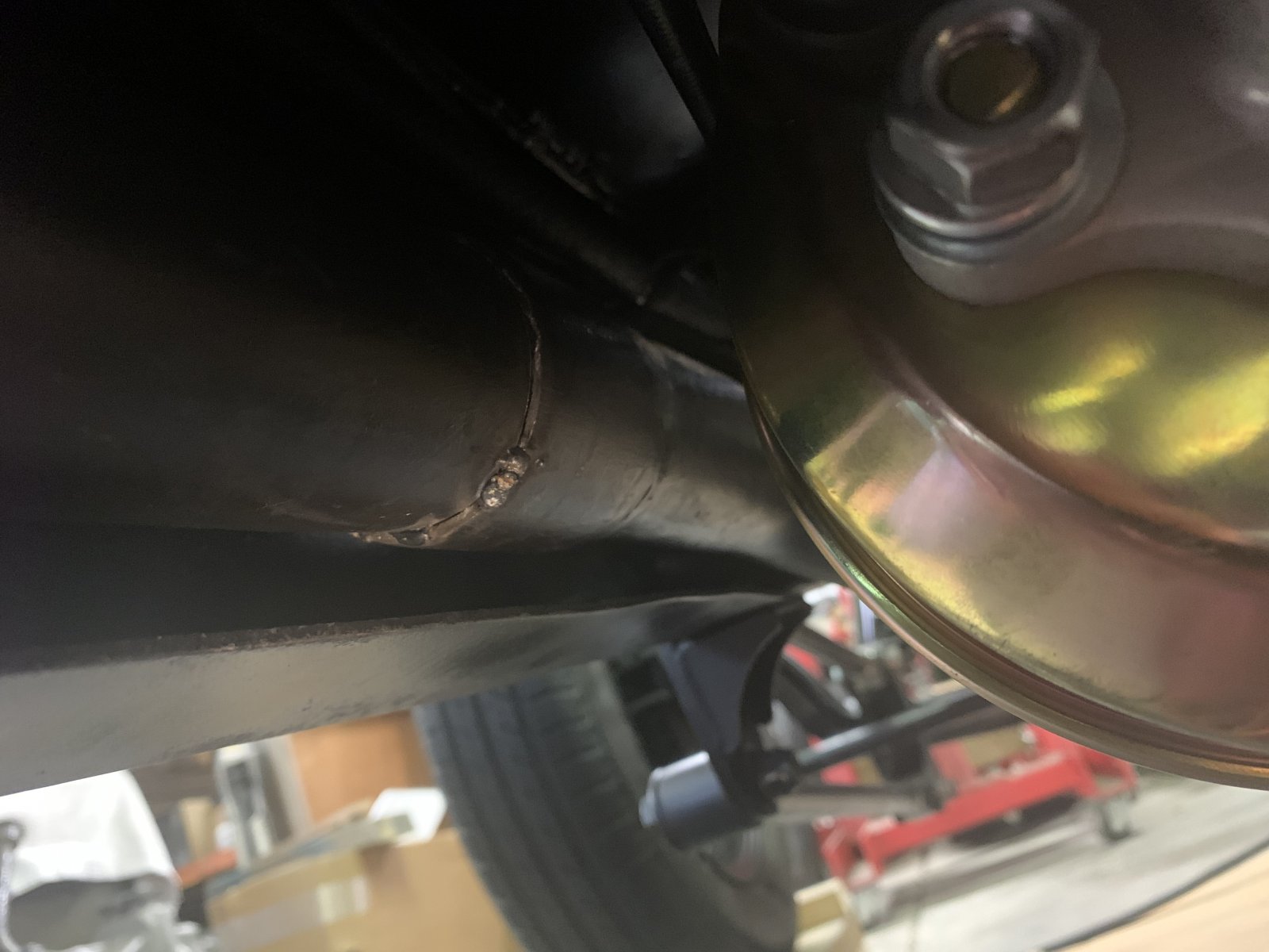

    I have been working on the driver side exhaust off and on the last couple days. After at what I had mocked up originally so I can now run it within the frame rails instead of under, I whittled away quite a bit and I have the driver side the best I can make it.
    I apologize for the lousy pics. I cut off just below where the exhaust pipe meets the manifold and added a right angle piece and brought it up inside the frame rails before the brake booster …
    Tough to see, I know. I then used the piece that ran under the frame rail, cut one end off, rotated it, welded it, then connected it to exhasust pipe. By doing so I created at least a 1.5 “ space between the pipe and the brake booster with plenty of room for the header wrap and removal when needed …
    That is the upper palm of my hand between the two . The back portion is just 2 46 degree pipe sections to get inside the “X” ….
    Again, the pics are lousy but here are a few more to hopefully clear up things ….
    Tomorrow I will work on the p***enger side and see how much I can get done. After that, it just depends how long my recovery is before I can back to the project.
