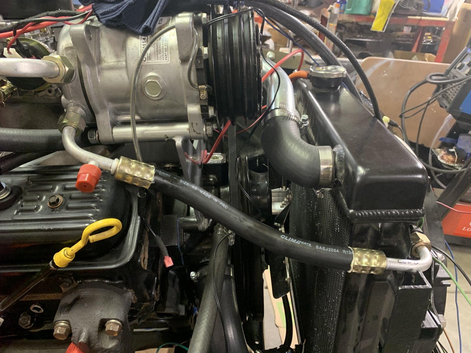

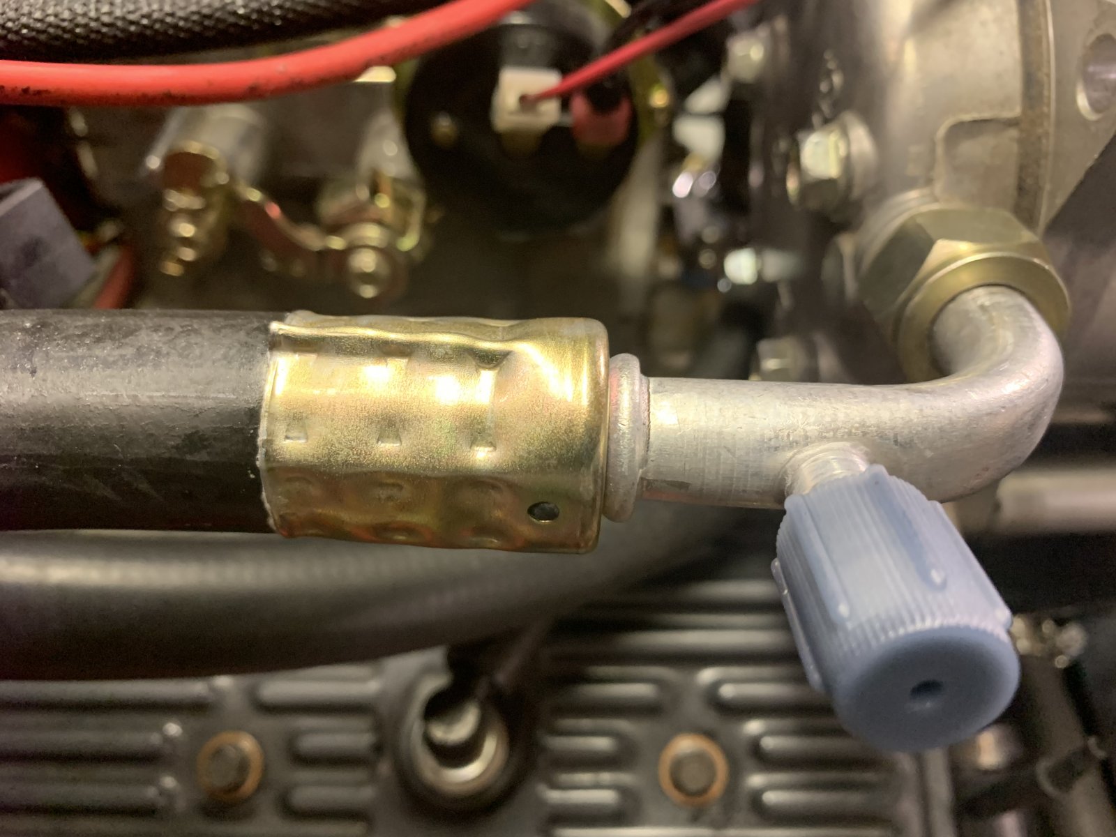

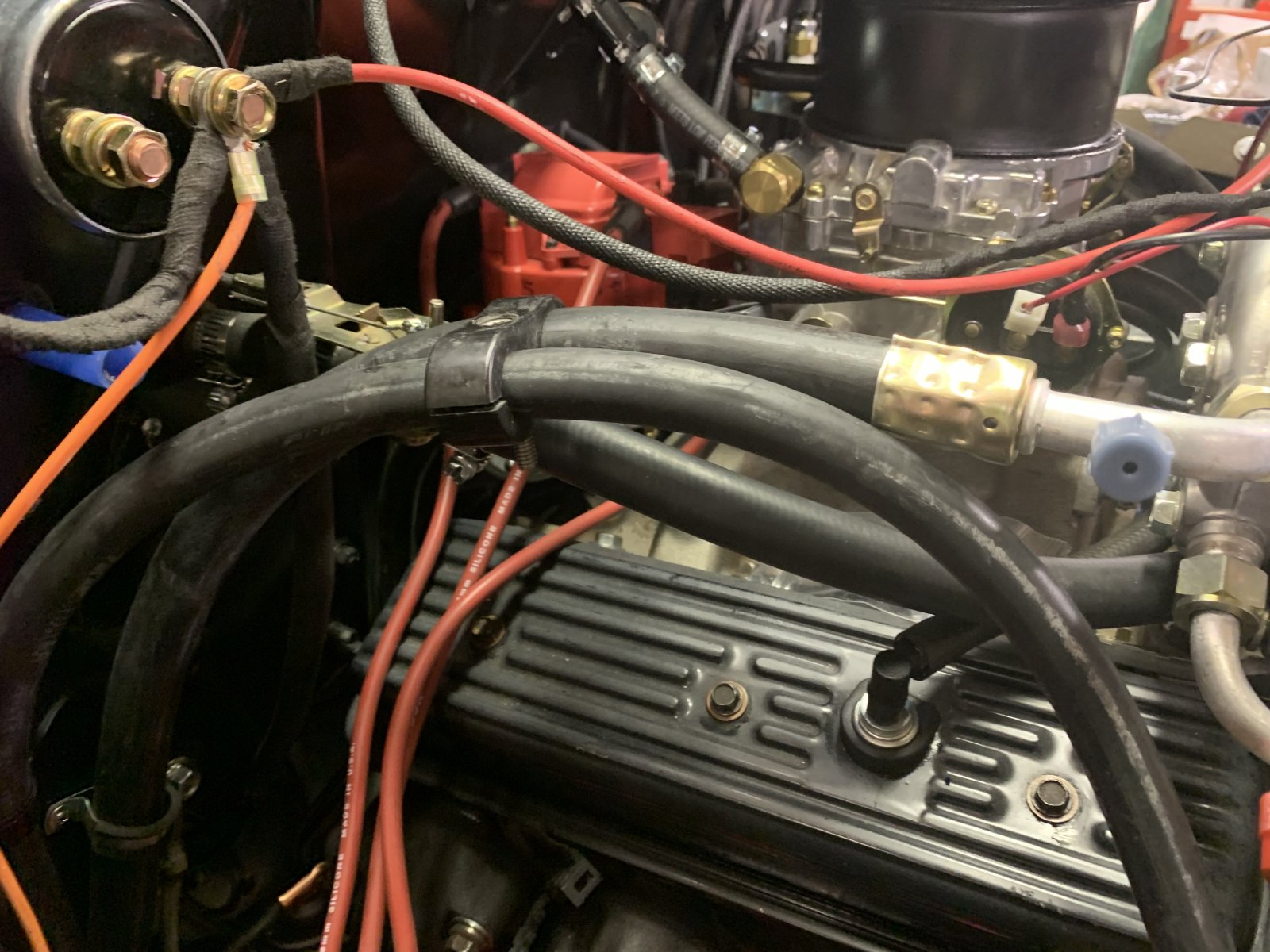

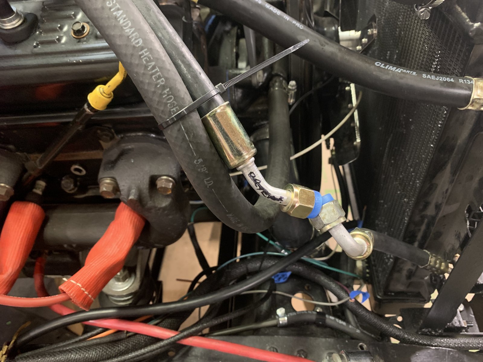

    Well - the AC fittings are all crimped. I borrowed my buddy Koppy’s hydraulic AC fitting crimper you can use right on the car ….
    The tool worked fantastic. I have the old vice mount manual unit which I would have had to put something together to get the vice close enough to do the two lines coming from under the cab.
    First one ….
    Piece of cake! I started doing the rest ….

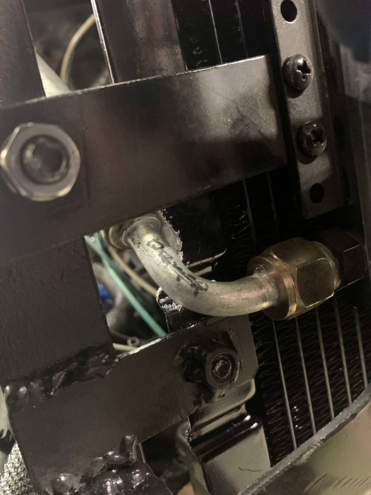

    I had to install the inner fender panel to do the dryer lines. I also found that one plastic holder holding the two AC hoses across the top - worked out perfect.
    I had to trim away a little for the lower condenser fitting and Ibalso had to remove the inner fender panel to get to it. There is just not enough room with it in place at this time - I may get to move a few things to be able to get to that fitting.
    I finished the water pump heater hose line with my neighbor Denise’s help.
    I have more to do today but I just had to post this now. This tool saved me a LOT of work and made life much easier.
    Another short list item off the list ….

    Those crimps look tidy! I got my AC at Vintage Air and they said when I am ready to make the hoses they will send me the crimper to borrow and return. I hope it is as nice as the one you used!

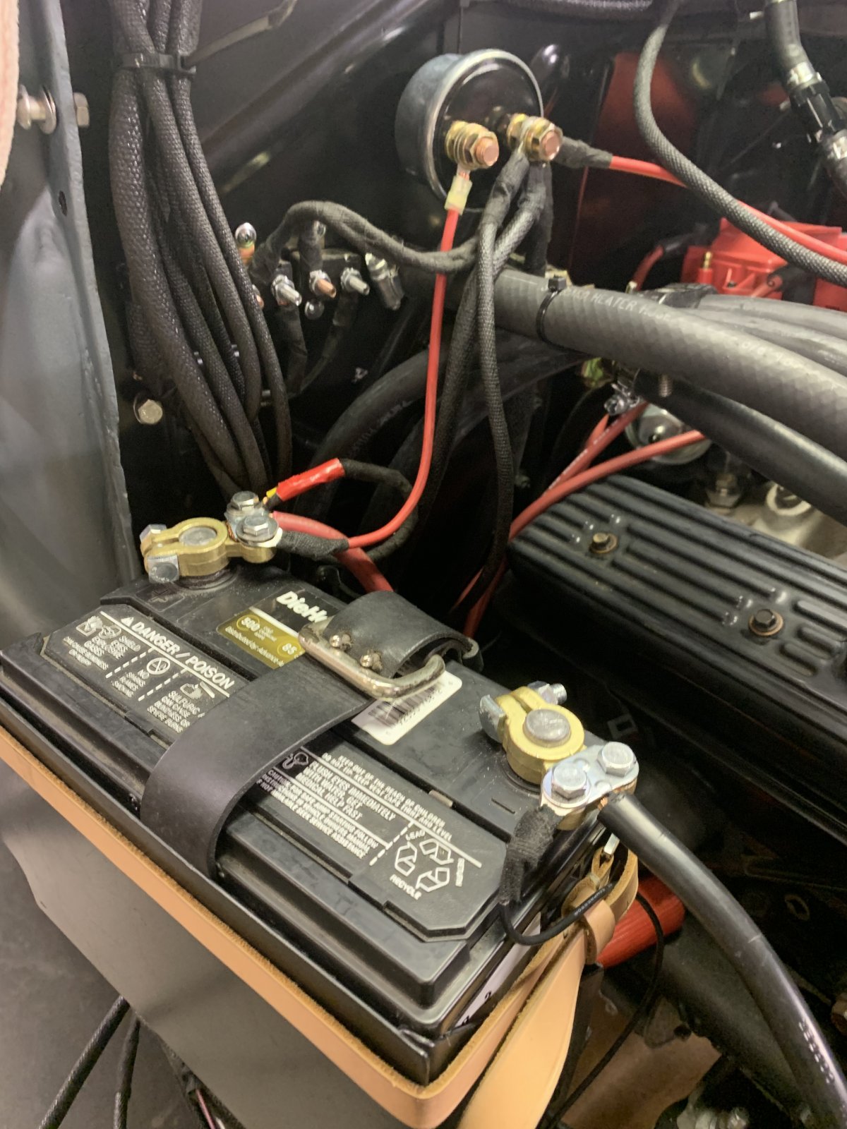

    So I have done a few more things - checked the fuel lines after putting in about 5 gallons of gas and fired up the pump. Just one small leak was all there was and I lowered the pressure to 5.5.
    I also got all the battery wiring done ….
    … and we have tail lights, dash lighting, wipers, cabin lights, fans work for both the heater and AC unit (they are separate units if you remember), but I do have some circuits that are not registering - I am working on them.
    It was a good day in the garage ……

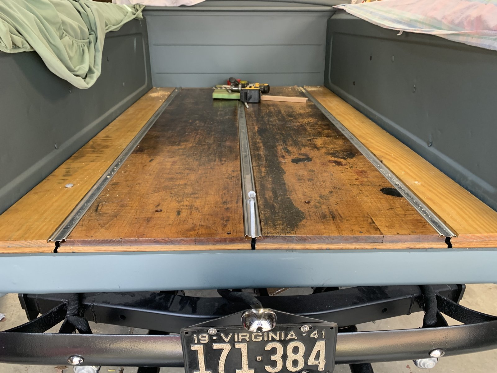

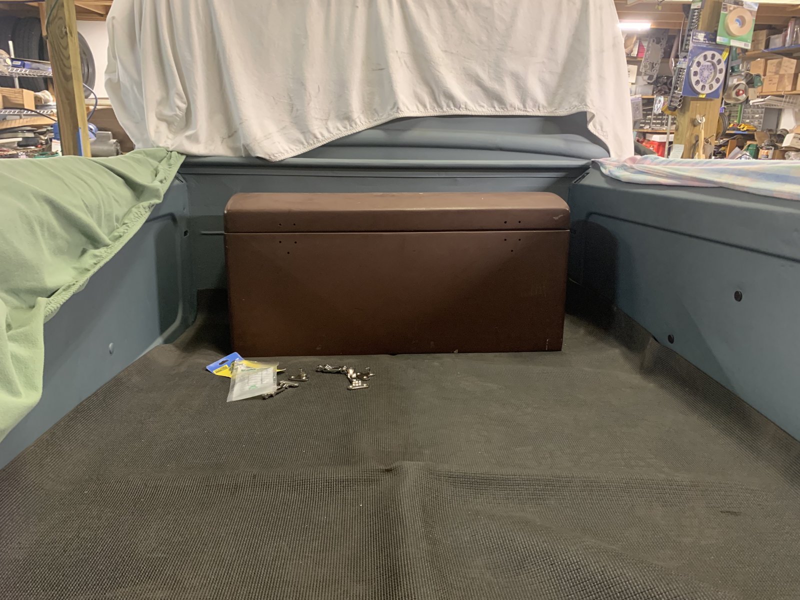

    Today I worked on putting the bedwood in the truck. But, as it usually happens, I needed to make some mods to the two outer boards ….
    The kickup areas were giving me some problems and it took several tries on Borge sides to get them sorted out. Once they were good I laid everything in ….
    I then drilled the 4 corner holes for the long bolts that hold the two main supports to the frame, each one 9” long. After several trips to the hardware store for needed items - thank goodness ACE is 1/2 mile away - they were in. With the end boards fixed I put in a couple lag screws in front and rear to hold the two main boards in place. I also started drilling the holes for the stainless strips and the three closest to the tailgate are drilled ….
    I will need some kind of rt angle piece of aluminum or something for the outer edge but so far, so good. I will need another person to help with the metal strip bolts but I am liking things so far …..
    I put the bedwood in now as they are heavy enough to affect the ride height. I had put in 5 gallons of gas and I have another 5 to put in tomorrow. But I need to come up with a pair of front tires.
    In my past experience with 40s you need to watch your backspacing so you don’t clip the front fender when going up a driveway with a dropped axle. I had a 40 dropped axle in my old coupe and I was close but never touched. The difference this time around is that I have a dropped 32 axle in it so I am tucked under and in a bit more. The 195/75-r15 tires would be perfect but they are no longer listed - it’s either the 185 or 205. Gabby had one 205/65-r15 hanging around that I mounted. It’s the same height as the 165/80-15s I have on now and the section width is good with the 4-bar suspension. I think a 295/70-r15 may be the tickets. Once I have a front fender installed I can work it out and then have my front ride height set. Then we shim the rear what is needed for my pinion angle and order a driveshaft.
    This is like feeling I am in slow motion, sneaking up on the completion of this project. It’s the dominos principle, right?!

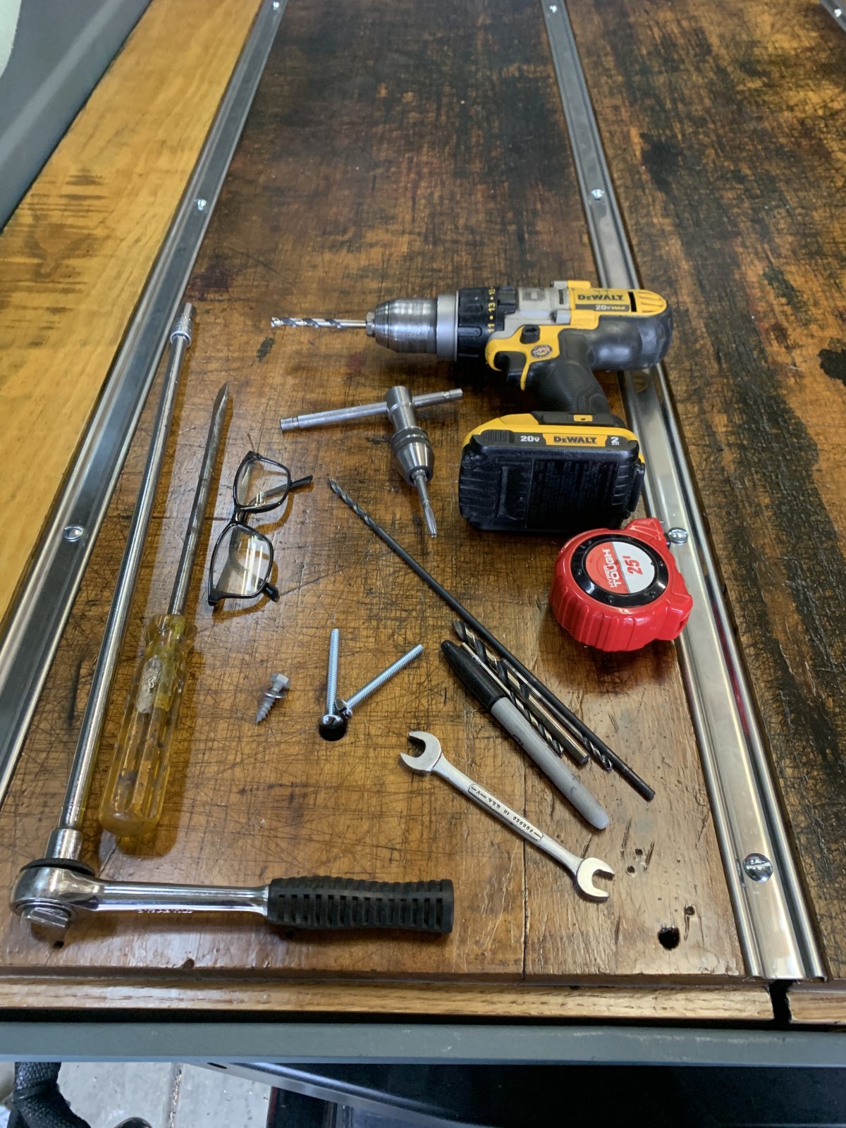

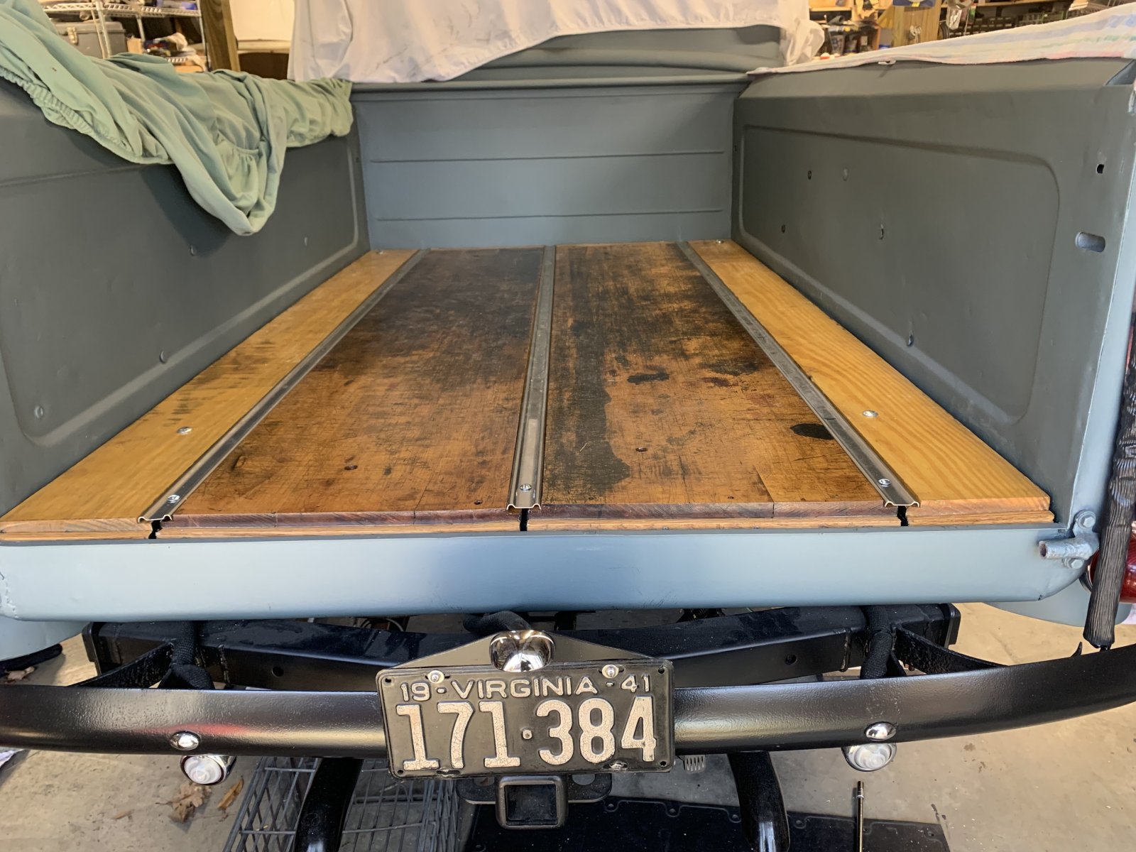

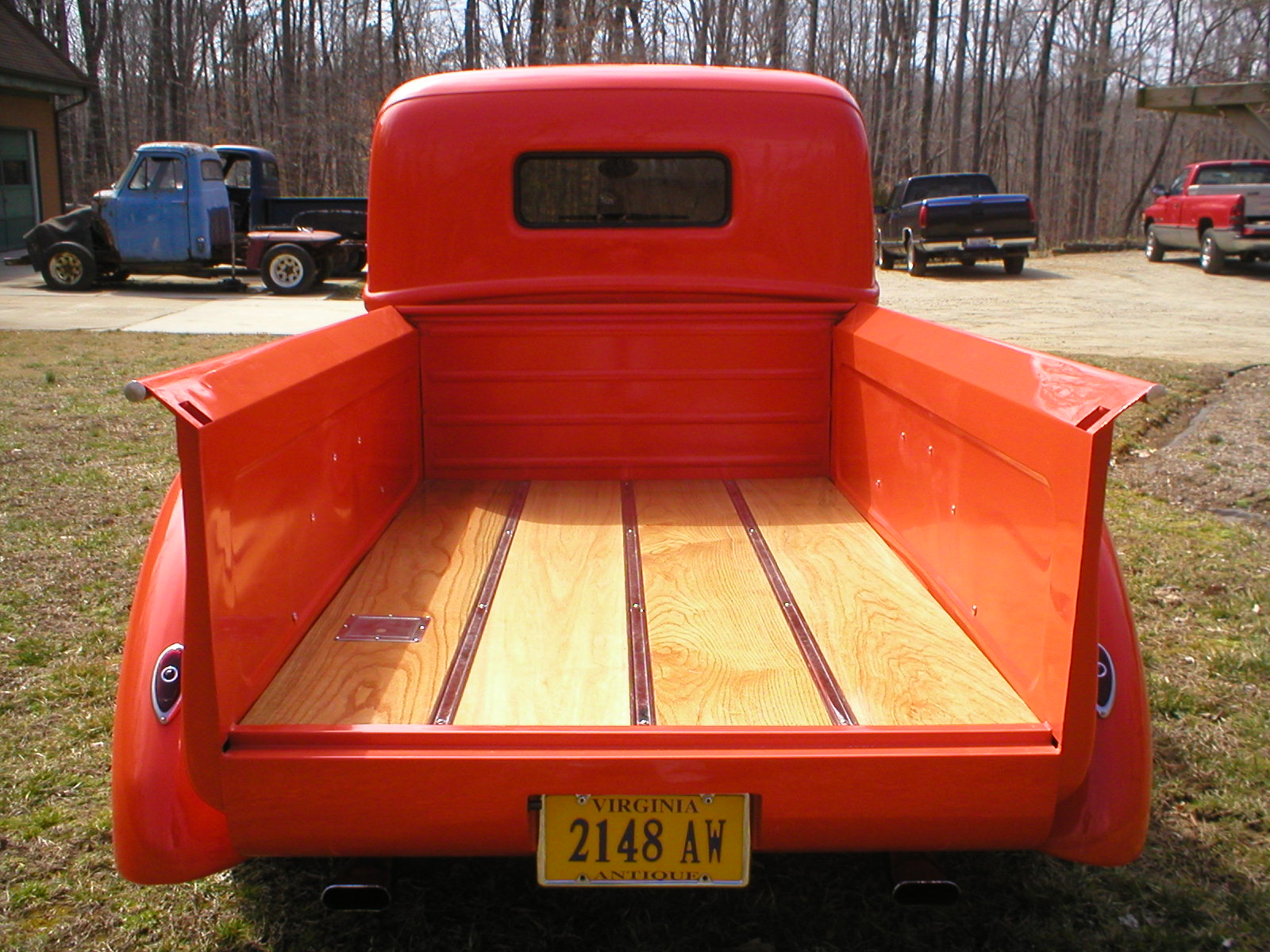

    Between what I did last night and today, the bedwood is installed and done. Here is what I used …..
    I used the lag screws pictured to hold the boards in position from underneath. The long drill bit was for drilling a pilot hole and the long extension and ratchet got them in place. If you know the pickups, the cross pieces have holes for the popular multi board style bedwood. With my setup, I actually hit most of the holes to attach the bed strips. They are on tight but mostly they function as a cover for the board joints. You see the long slotted bolts I used and I drilled my own holes in the strips. I drilled and tapped where I needed including into the oak bed supports. It just made things look nice. The aluminum strip pictured will protect the edge of the bedwood….
    This piece is about 3” too short and I need to pick one up.
    And I will fess up - I did make one mistake drilling the strips right in the center of the bed. Fortunately I had one more bed strip so I cut about a 2”piece off, drilled it, and it covered my mistaken hole. A kick save and it was a beauty - lol!
    I started mounting the inner fender panel on the driver fender so I can test for tire clearance when I ran out of time. Tomorrow is another day …..

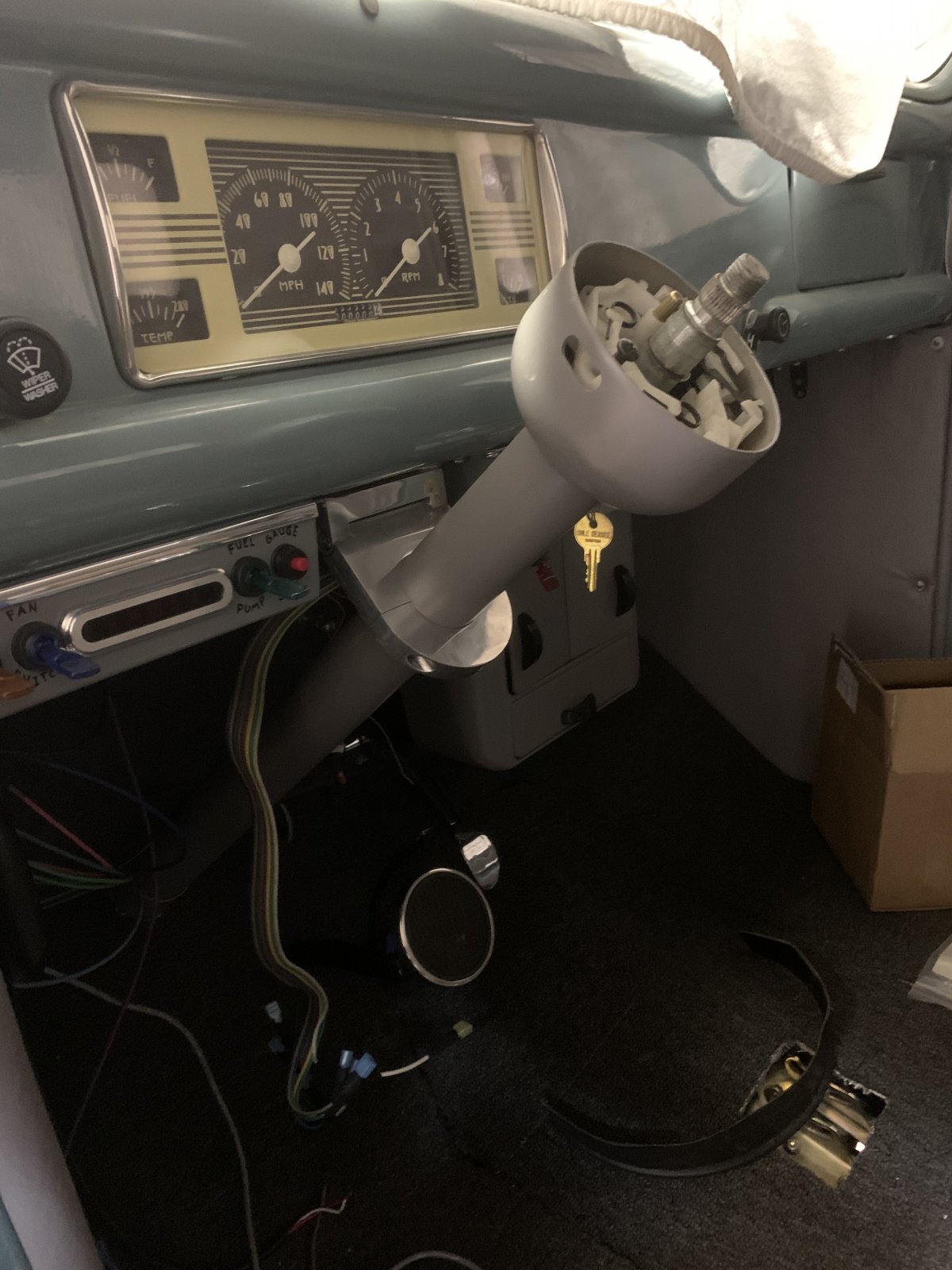

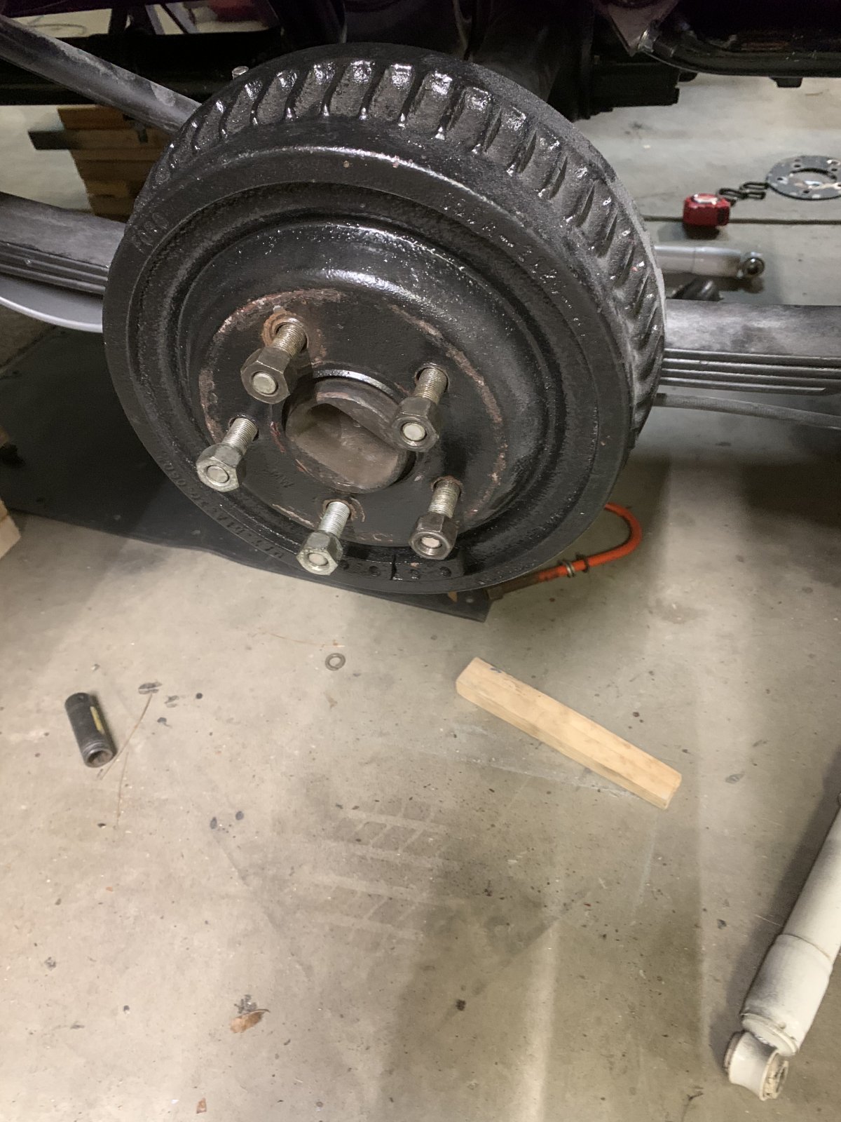

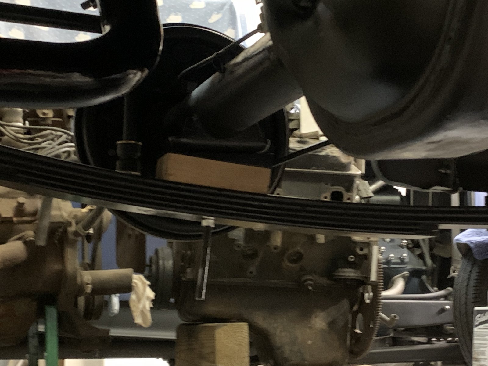

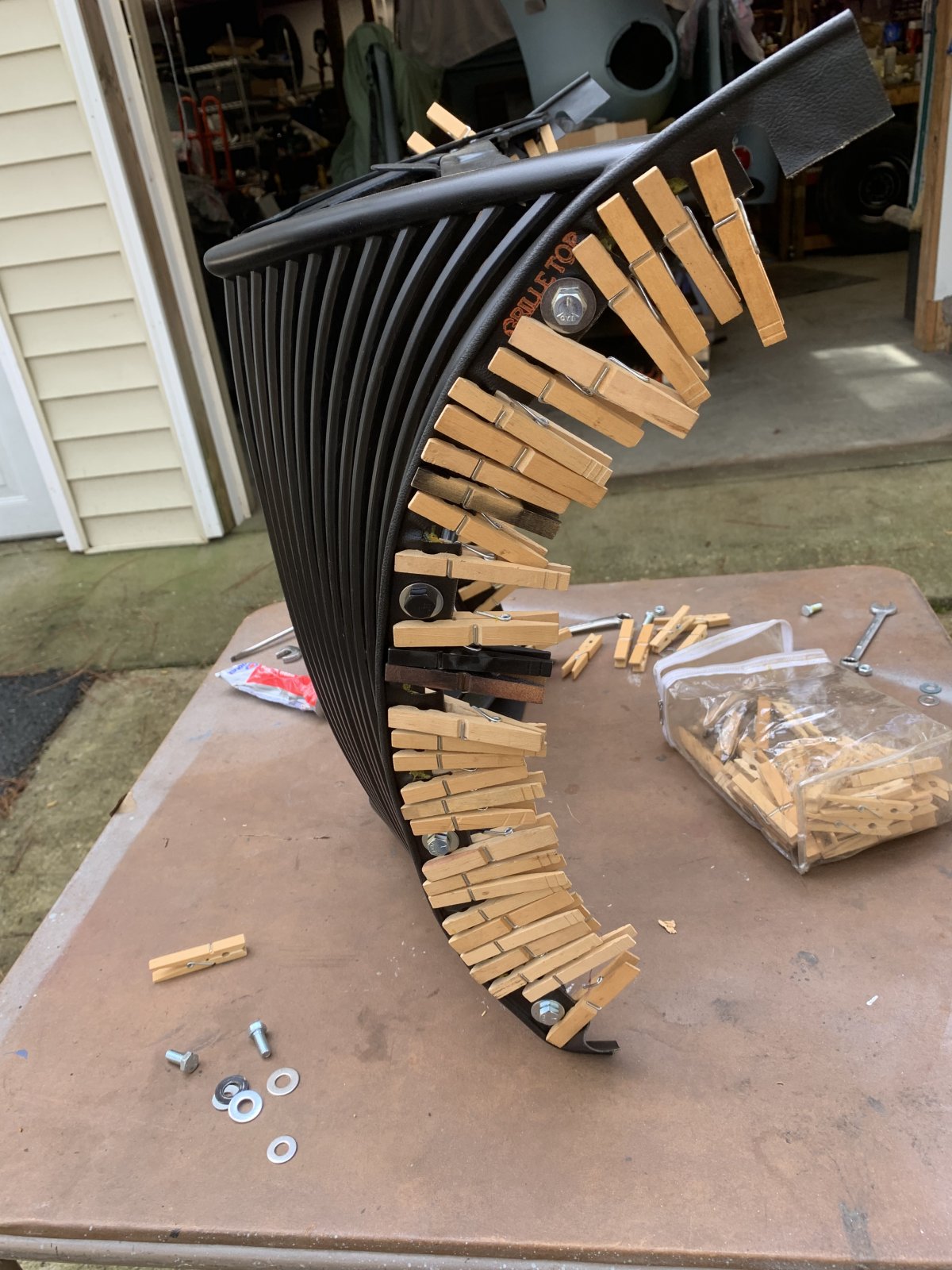

    I now have the rear suspension suspended getting ready for the shim install. The extra leaves that I have are the same length and width of the lowest leaf in the spring pack. I want to install them to see how the rear spring looks afterward. With the helper springs installed the spring is nearly flat if not flexing upward. With the extra leaf per side I am hoping the springs will stay flat if not slightly cubed downward with the helper springs installed. I cleaned and painted the extra leaves today along with the hood springs….
    Once the suspension was loose I changed the axle wheel lugs to one’s that were longer. I want to move the tires out with spacers but the original lugs were too short and I did not have enough lug nut bite ….
    Unfortunately the rear axle bolts I ordered should have been 3/8” but instead were the 5/16ths. I have the 3/8s on ordered and I already expanded the shim holes which were also 5/16ths.

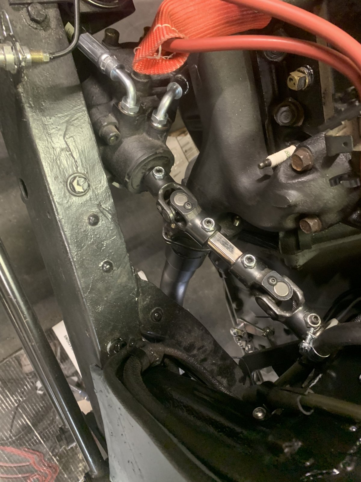

    With the driver fender off I was also able to connect the steering column and u-joints ….
    … and the column is now back in ….

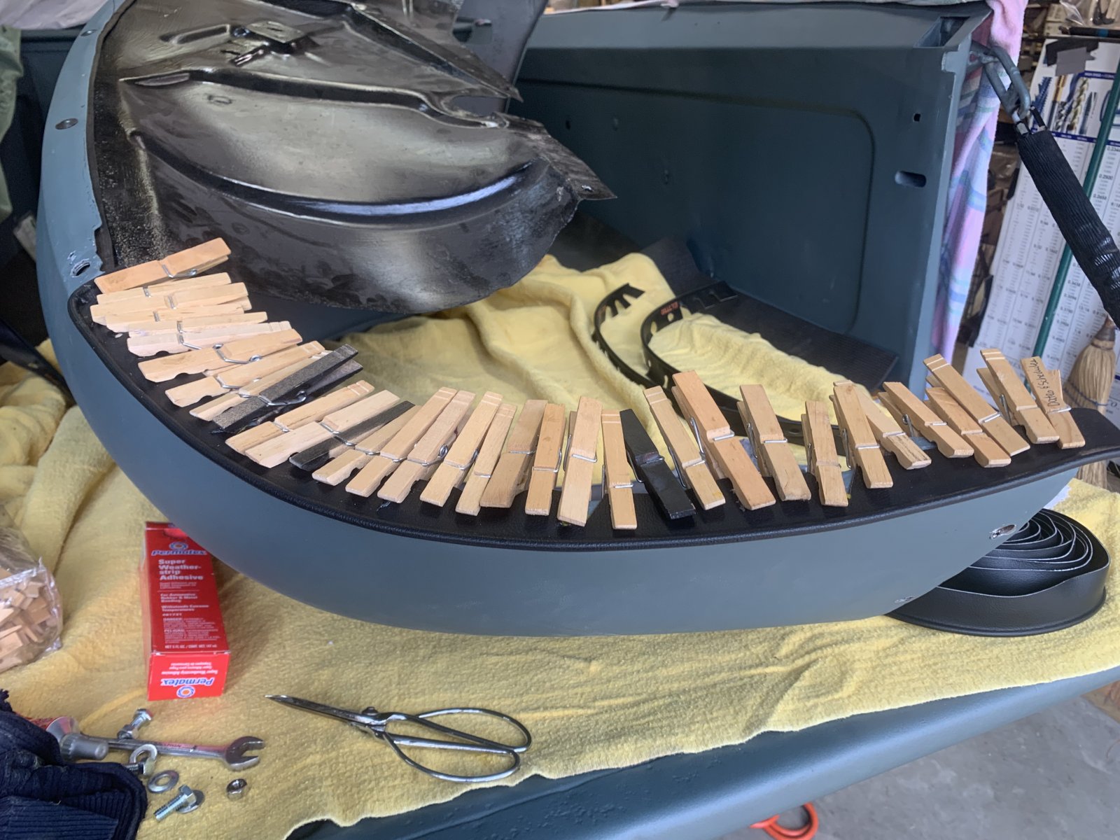

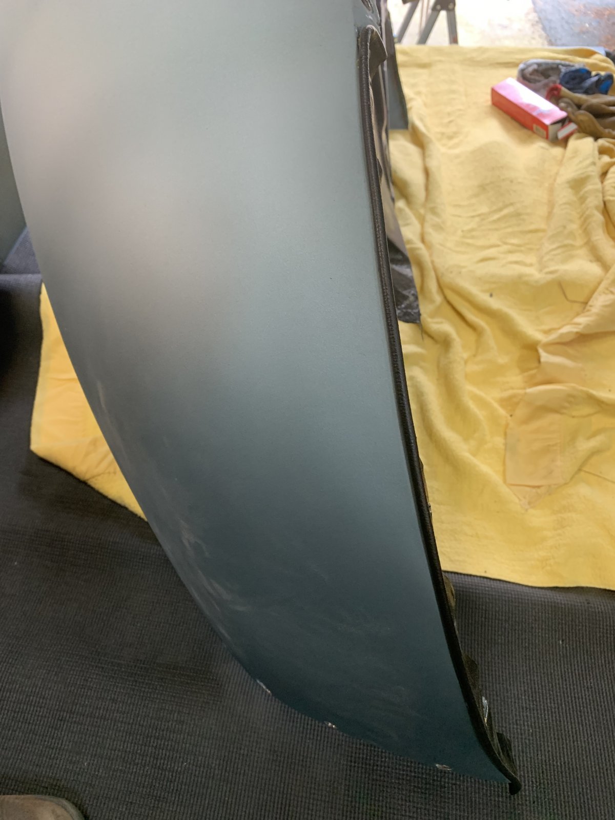

    I also put some fender welting on the the driver fender where it meets the cowl ….

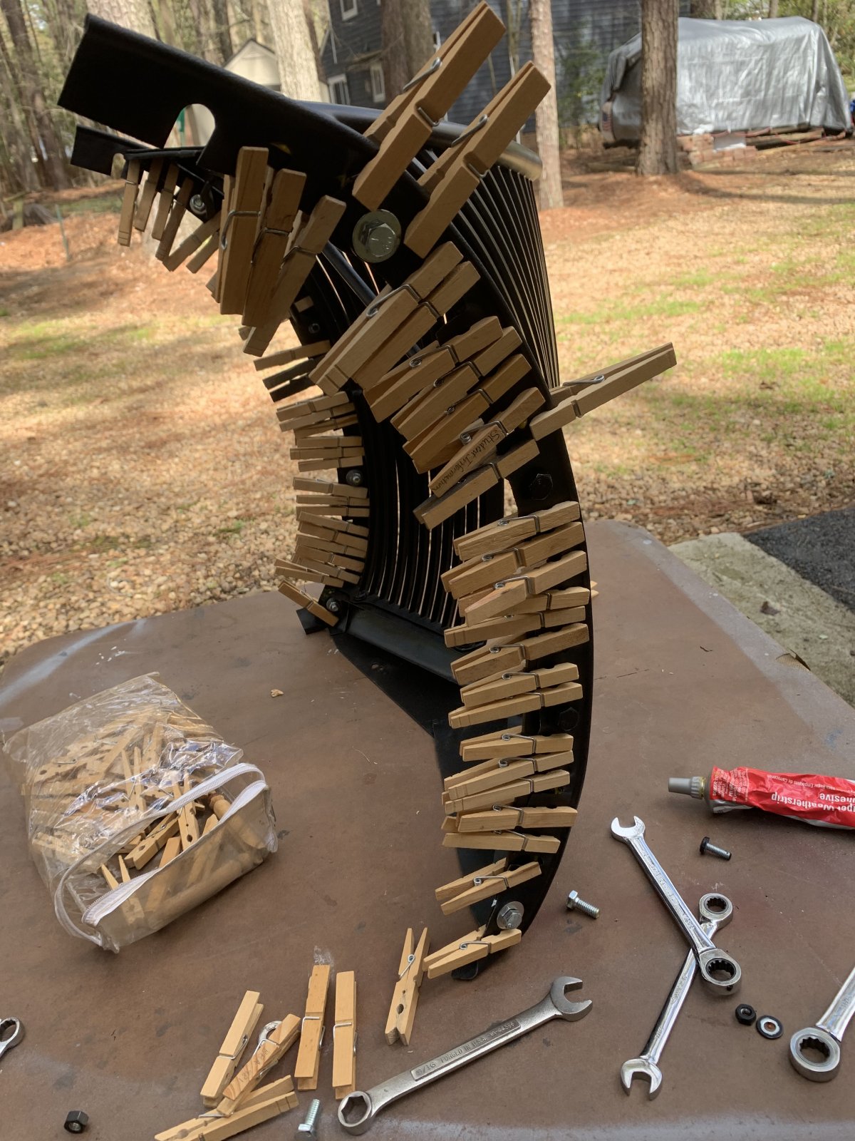

    My wife likes how I use her old clothespins to keep the welting in place while the glue dries! P***enger side next …

    ^^^^Great use of the clothespens^^^

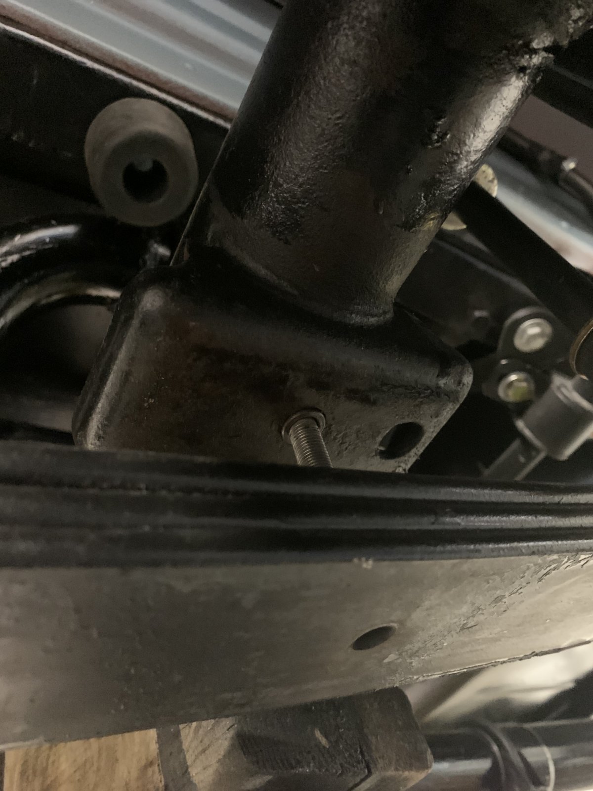

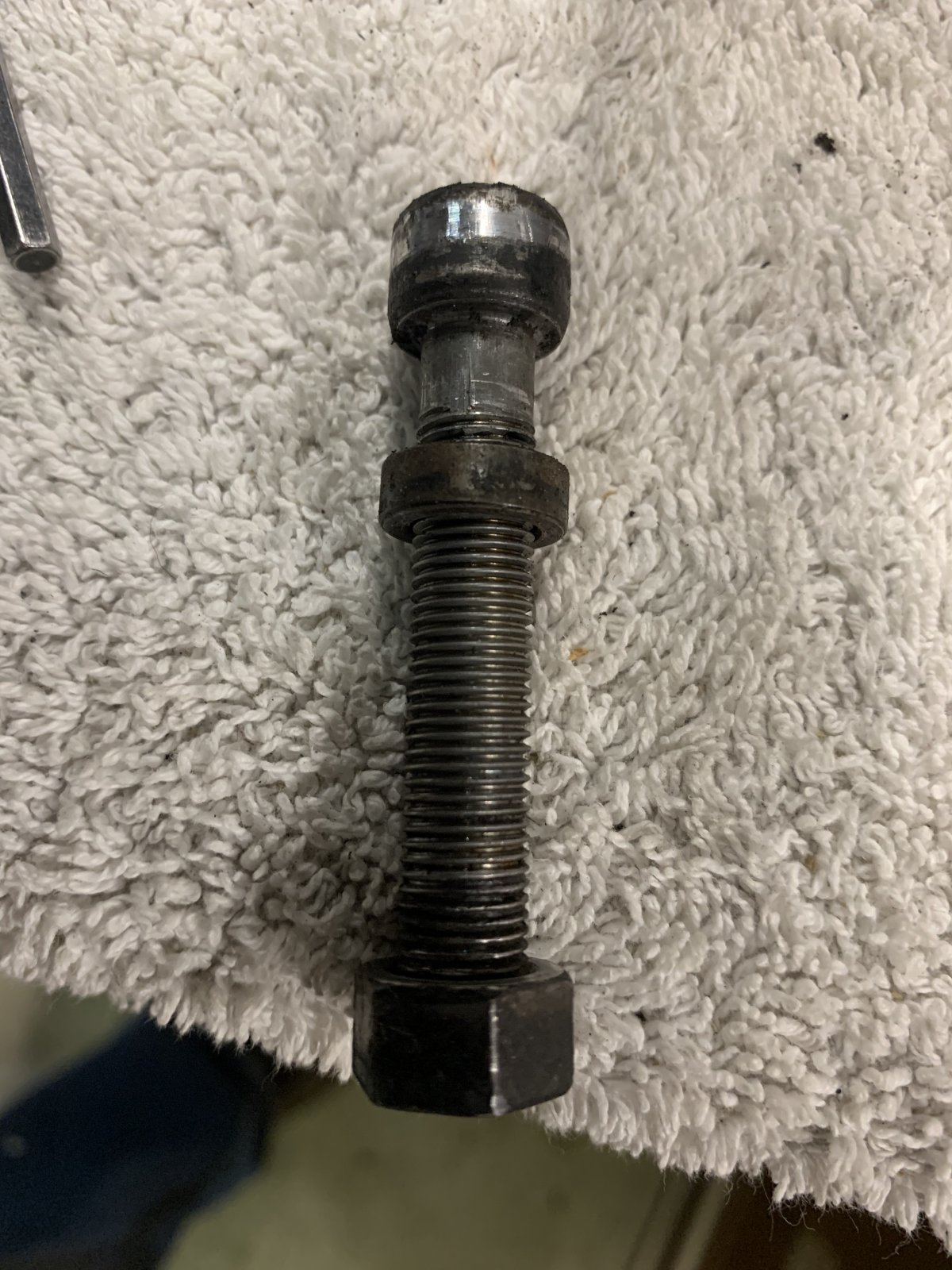

    I got my axle bolts this am so all the dis***embling I did yesterday paid off. I worked on the driver side first and I ran into a problem right baway. The bolt that was there could not be removed from the top. There is just no room to do it. So I dropped the spring from the front and took this picture …
    …. and you can see there is a sleeve around the bolt as it goes through the axle pad. I called around and no one could understand what I was talking about. I have maybe done 6 or so 8” Ford rears and I never saw this. I was perplexed with how I was going to get it out - if I cut it, not a good idea. I still can’t get to the portion about be the axle plate and under the axle tube. So, I thought I might be able to pry it out. Using the closed end of a 5/8” wrench, I put the nut on the bottom of the bolt - maybe 4-5 turns - slipped the closed end over the nut and rested the wrench on the upper lip of the nut. Then, using a pry bar I was able to pry it out completely no problem. Here is the bolt and sleeve …
    My next hurdle was the new bolt head was too big for the axle plate hole. A little turn on the grinder straightened that out and I was able to ***emble the shim plate, 1 1/4” lowering block, and the two lower leaves for both sides ….
    And that’s where I ended up tonight. I have to ***emble the u-bolts and lower plate to then install the helper springs. With only the shocks and sway bar remaining, I can put the truck at ride height to check the pinion angle and how much suspension travel I have. I may have to trim down the lowering block to get my 3.5 “ of travel. I also put longer/taller axle snubbers on or I would have crushed the exhaust pipes in that area.
    One last thing I did yesterday before the rear shin dis***embly was to glue fender welting to the grille …
    I haven’t removed the clothespins yet but here’s a pic of the cowl are of the front fender ….
    Came out pretty nice imho ……
    Another good couple days, for me anyway …..

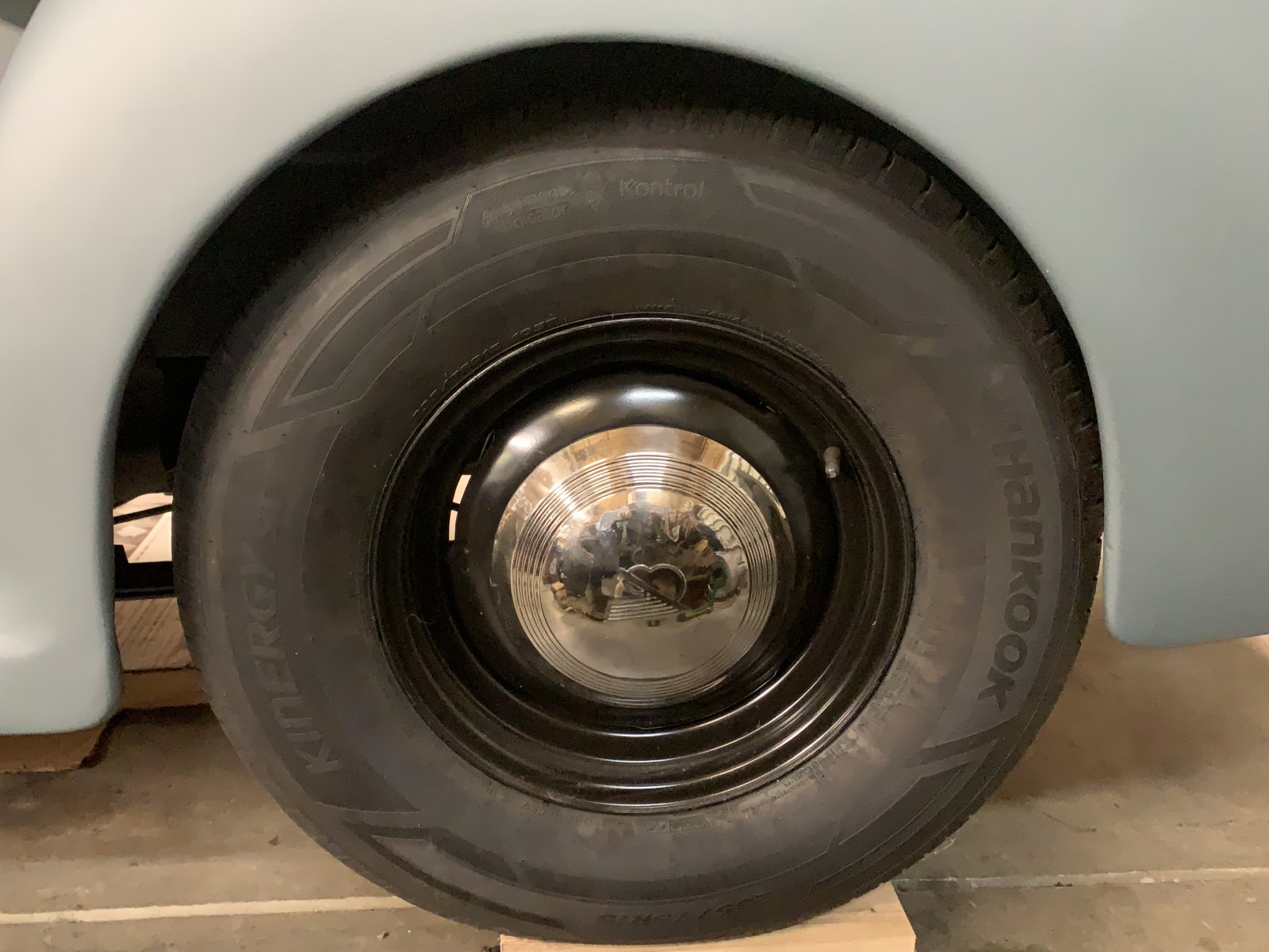

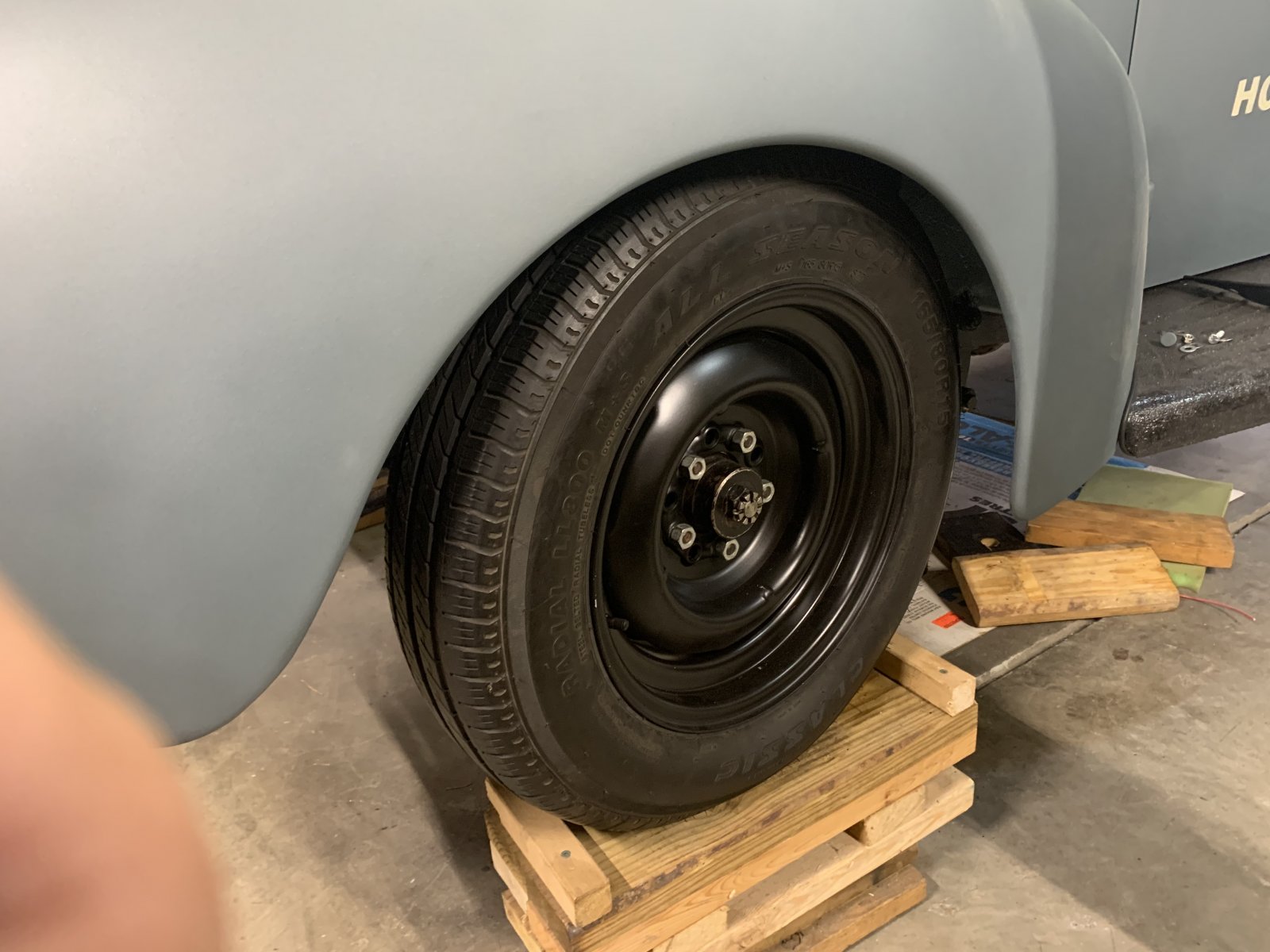

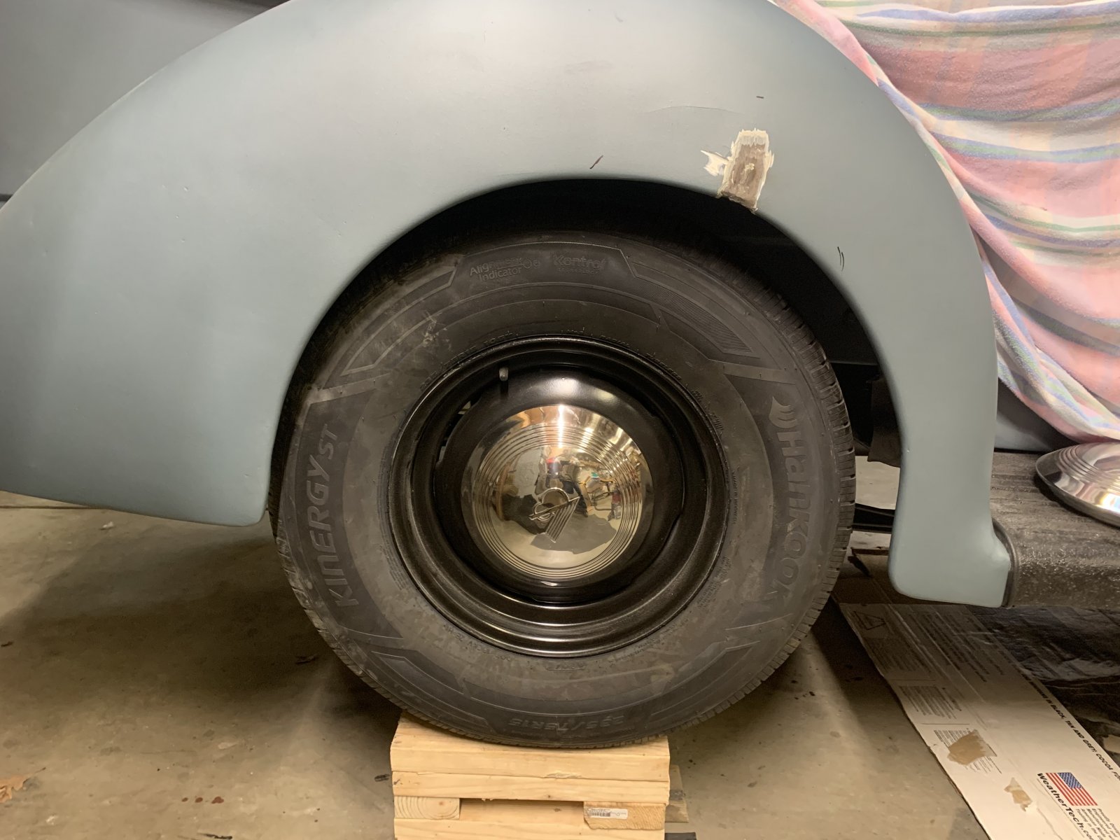

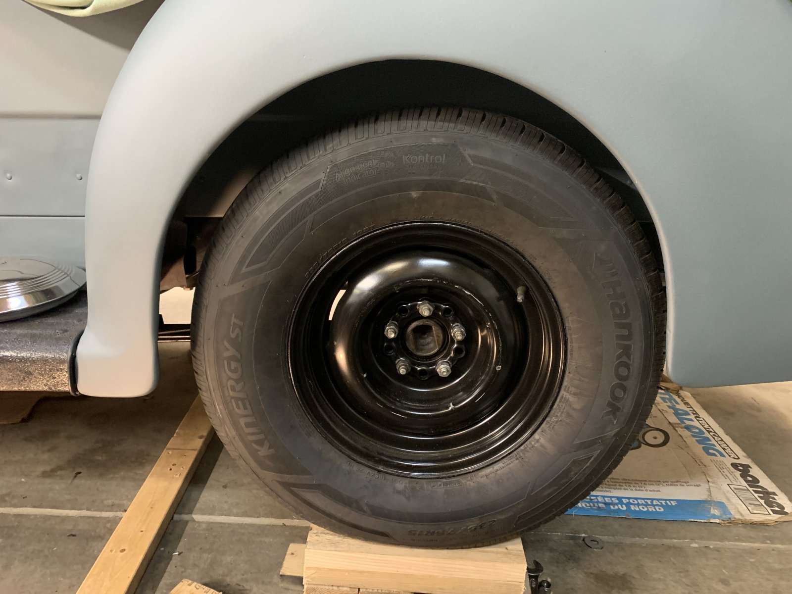

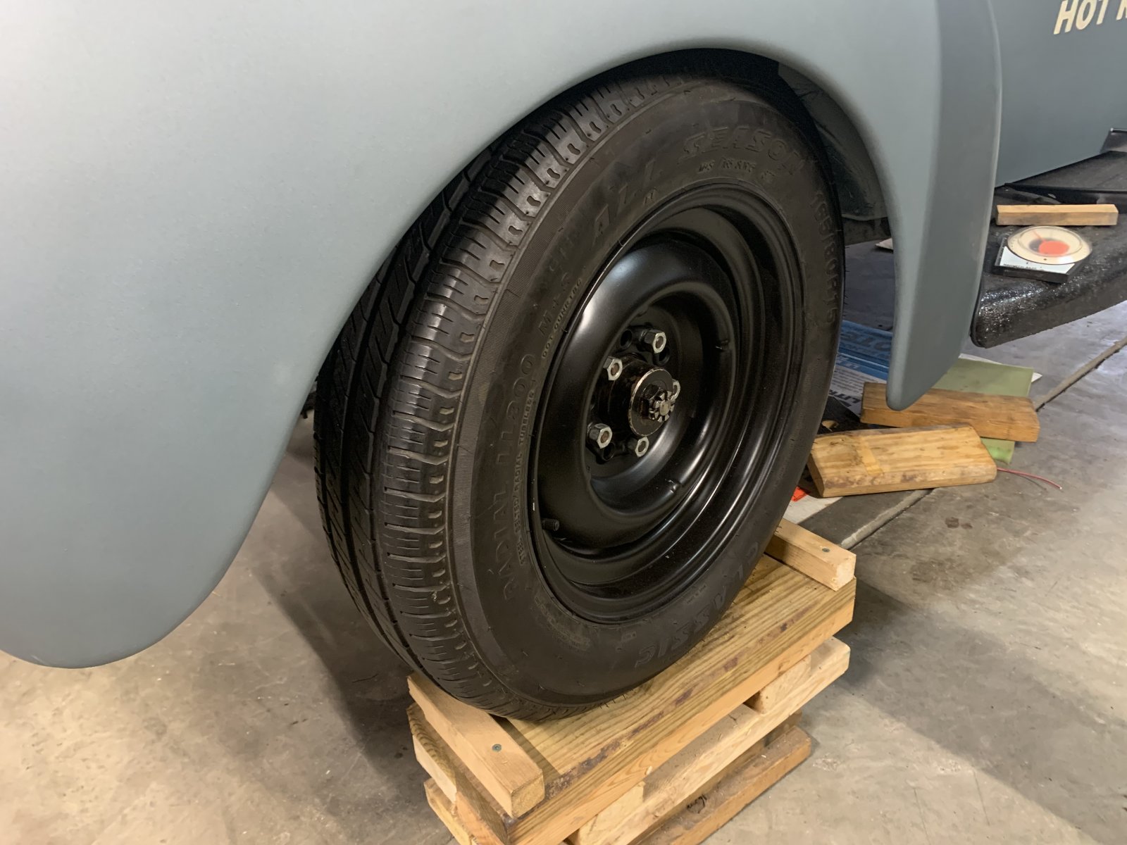

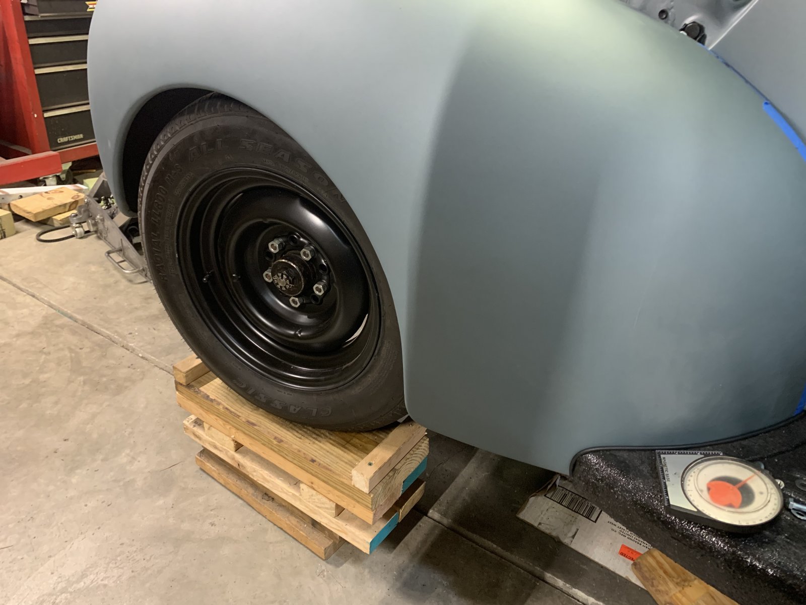

    Everything is back together but there I a problem….
    … the tire looks s not centered n the wheel well opening. I like the height of the n tge wheel well but the lowering block has rolled axle back about 3/4”. I think if I remove the lowering block the wheel will be much more centered. Once I see how it all sets I might try longer rear spring shackles. We shall see.
    But, the tire needs to be centered in n the wheel well opening - it does not look really get if it isn’t.
    Back to work …..

  26. hotrodA
    Joined: Sep 12, 2002
    Posts: 7,795
    hotrodA
    Could you not redrill the locating hole for the spring center bolt offset in the lowering block to make up the difference? Probably have to redrill the locating hole in the spring bottom plate to correspond, so the u-bolts would line up.
    Bill
    Bandit Billy, 40FORDPU and TomT like this.
  27. TomT
    Joined: Dec 11, 2003
    Posts: 4,682
    TomT
    I did think of that but I decided to remove the lowering block ….
    It’s better but not perfect and I think it’s as good as it’s going to get. These trucks were not that perfect to begin with!

  29. TomT
    Posts: 4,682
    TomT
    Hotroda - you hit the nail on the head. We are working on that now - will let all know when it happens.
    Thank you!
