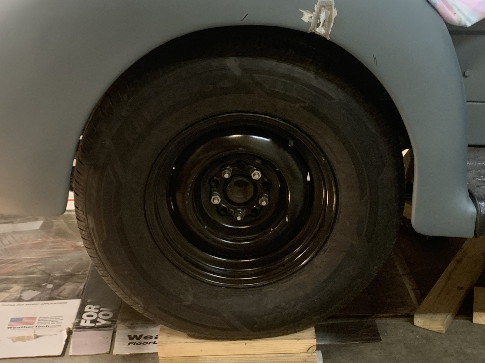

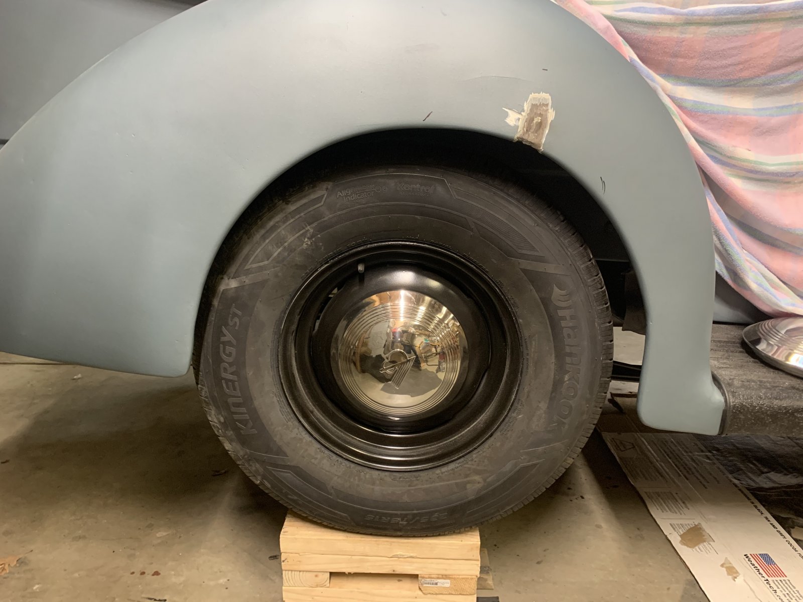

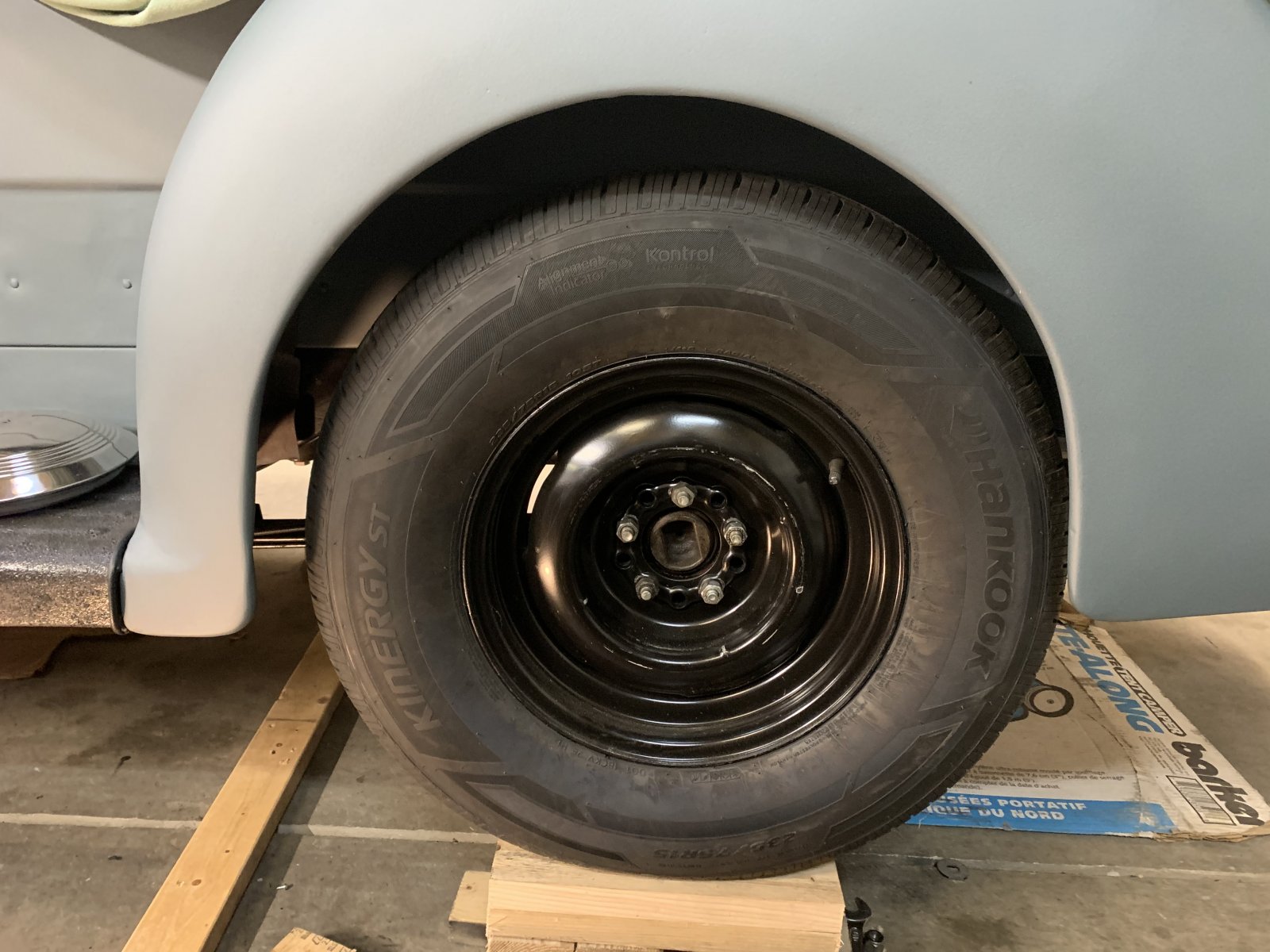

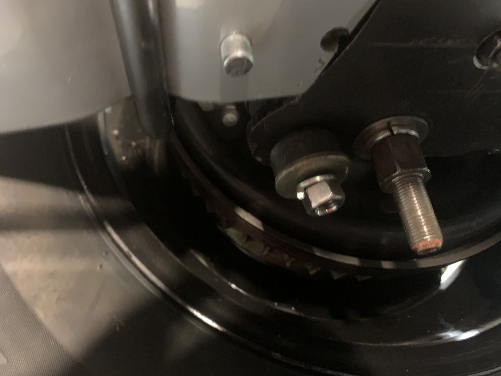

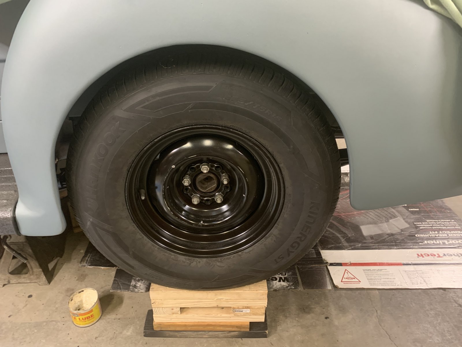

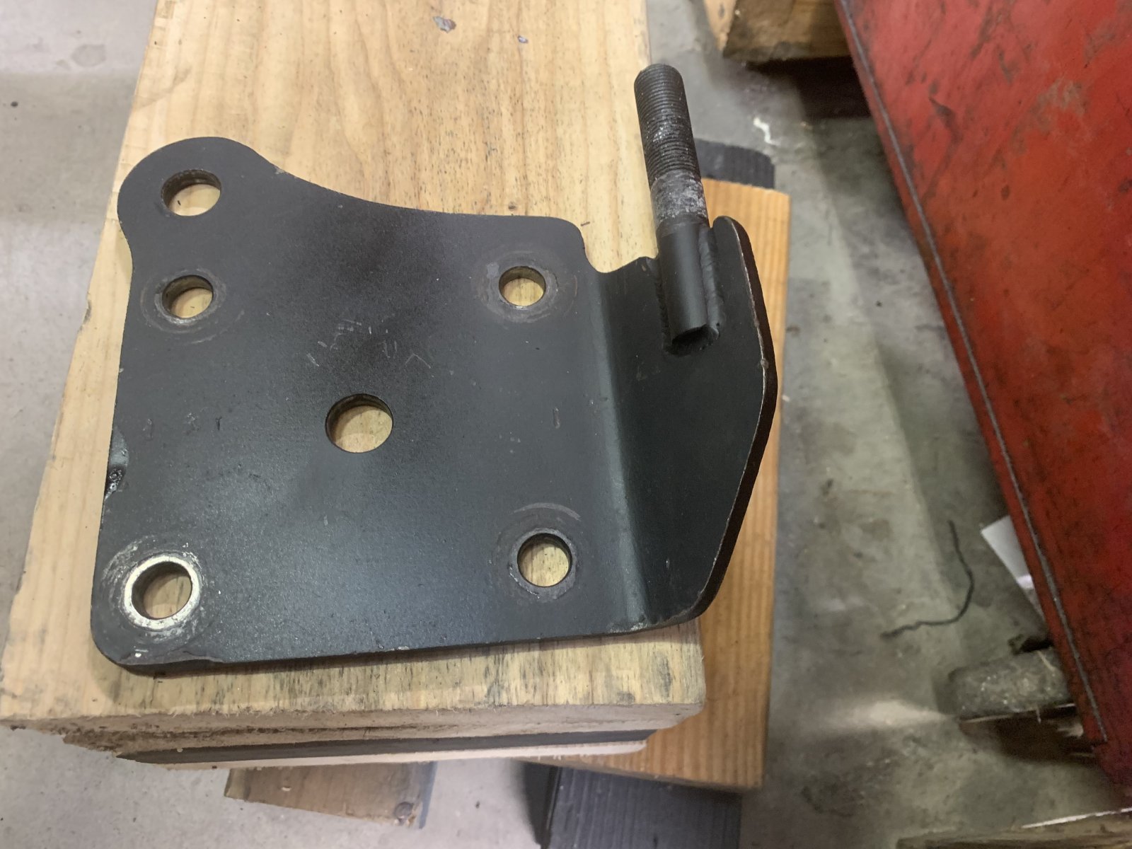

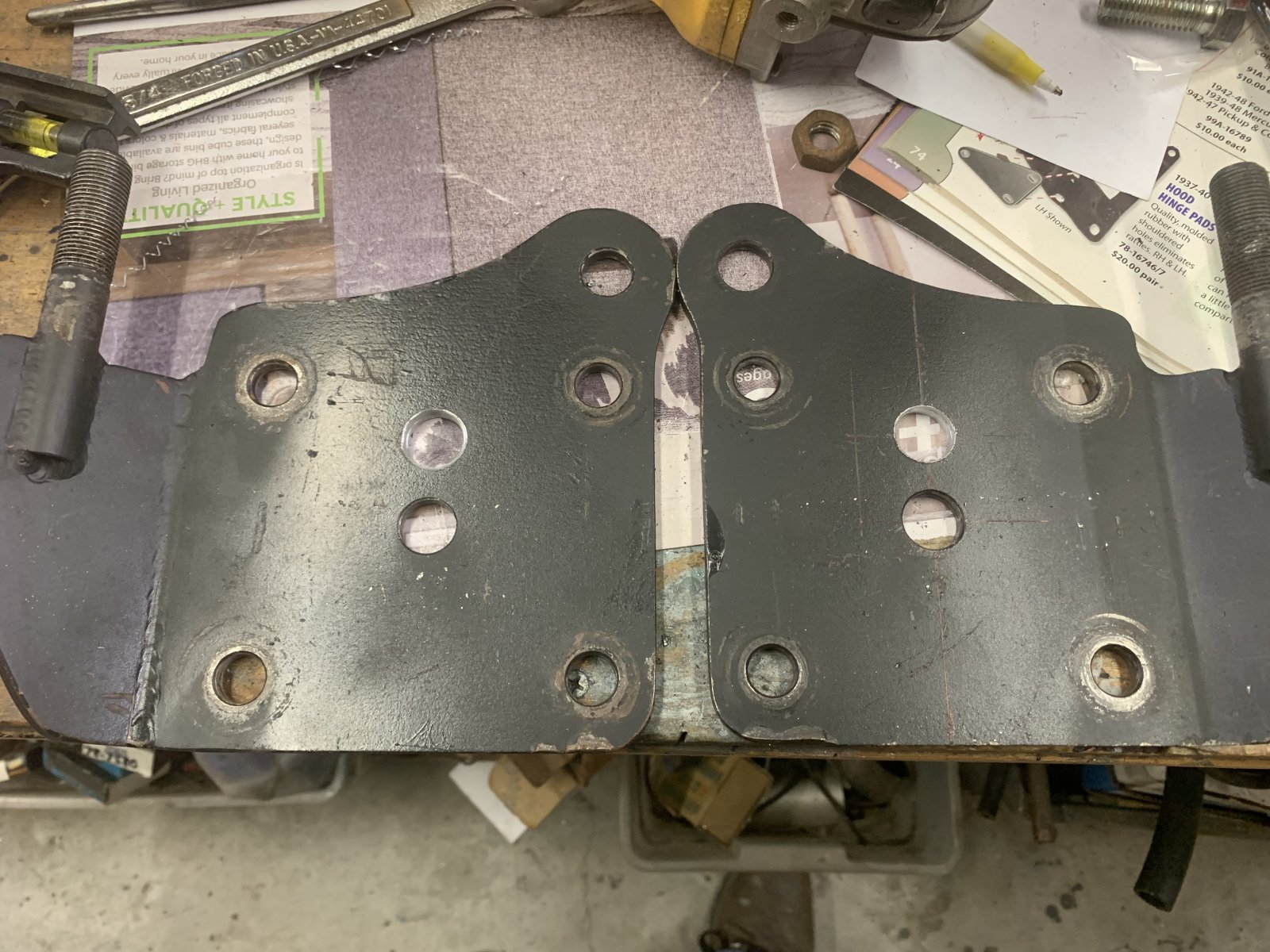

    I finally got the rear wheels centered in the wheel wells. 3rd time was a charm in this case. I started with ….

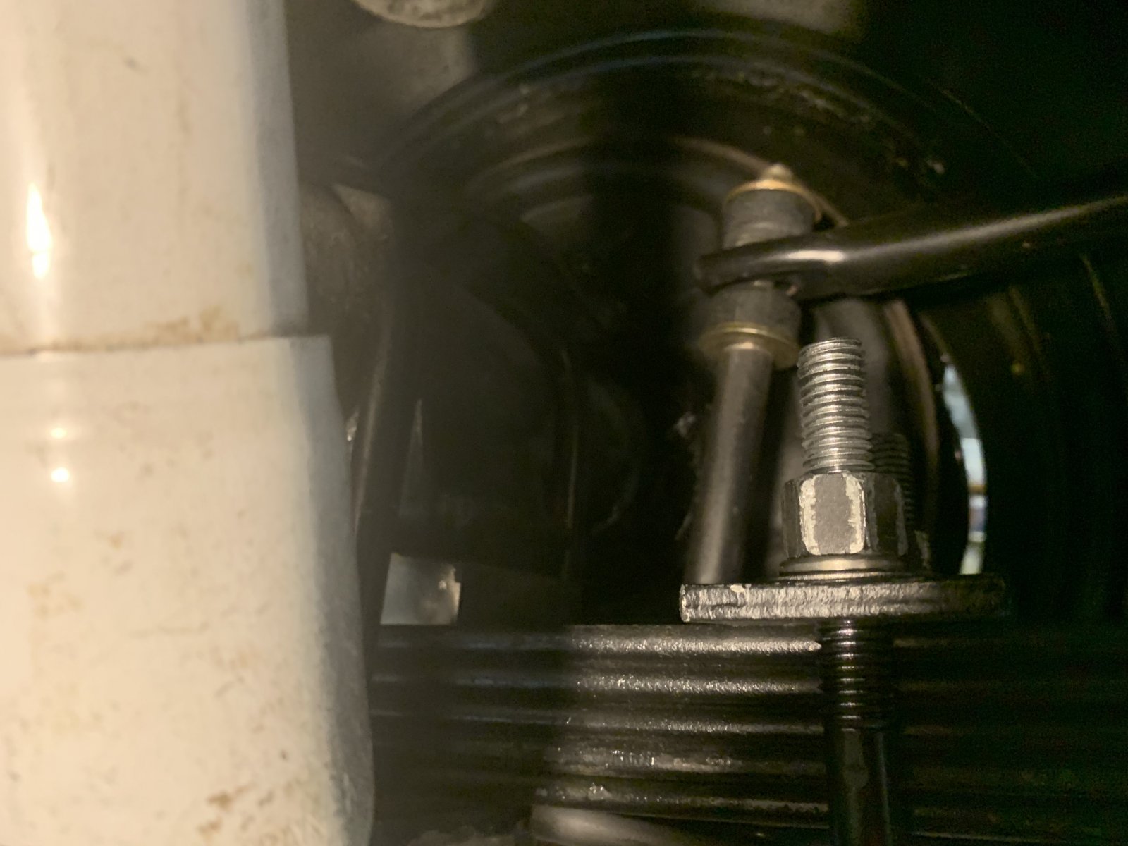

    I had my friend cut a 1/2” steel lowering block the same size as the shim and weld it to the shim. The center hole of the shim was set with the head of a spring bolt which would go up into the center hole of the axle perch. Then, after a bit of math that I had to dust off the cobwebs to get my brain working, I had a hole drilled 1 1/16” further back than where the center hole would be on the underside of the lowering block. The lowering block was needed to provide enough meat for the head of the bolt that goes through the spring and locates the axle pad on the spring. The 1 1/16” worked perfectly to center the tire in the wheel well opening.
    I got this far and I was feeling pretty good about things until I tried to put the ubolts through the bottom plate. That did not work too well and certainly did not look right. I had to drill a corresponding hole 1 1/16” back from the original center hole so everything would seat as planned ….
    Once that was done I got the ubolts bolted in and set it down on all 4s. Originally the wheel and tire looked like this …
    But now they look just right ….
    I had to shim the shock mounts a bit to allow for shock removal (of which I got a little creative) - the upper mount needed to move forward, the lower towards the back 1/4” for both. The sway bar strut rods (?) also were at a severe angle with the suspension hanging. But once down on all 4s they ended up being only at a 10 degree angle going forward and they look to be ok that way …..
    The helper springs also moved further forward by the same 1 1/4” amount which seems to have made them even better by flattening the spring out even more - so that was a good thing.
    All in all, this took awhile to get through especially with visits from family and friends but it is very satisfying to see this finished. A big thank you goes out to my buddy Koppy for the precision machining and heavy welding work ….

    Centering the wheels is well worth the effort, now it looks right.

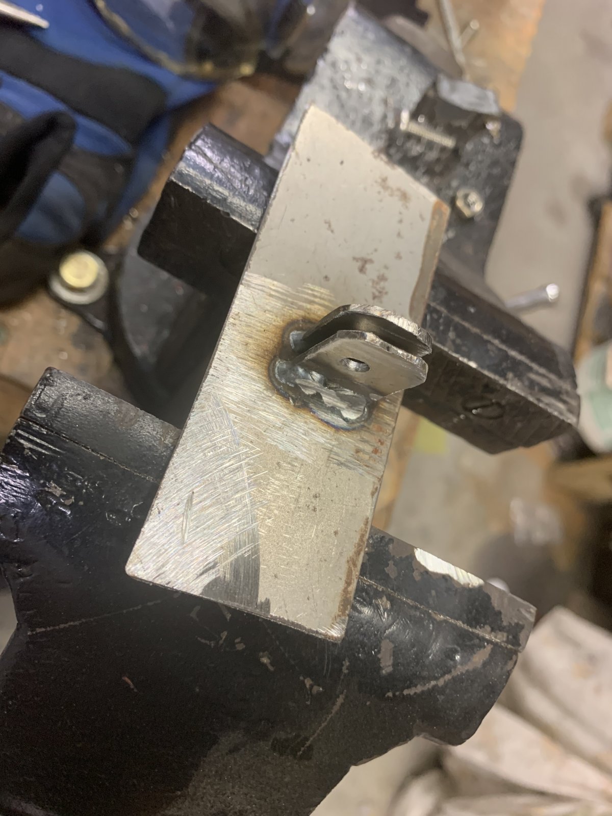

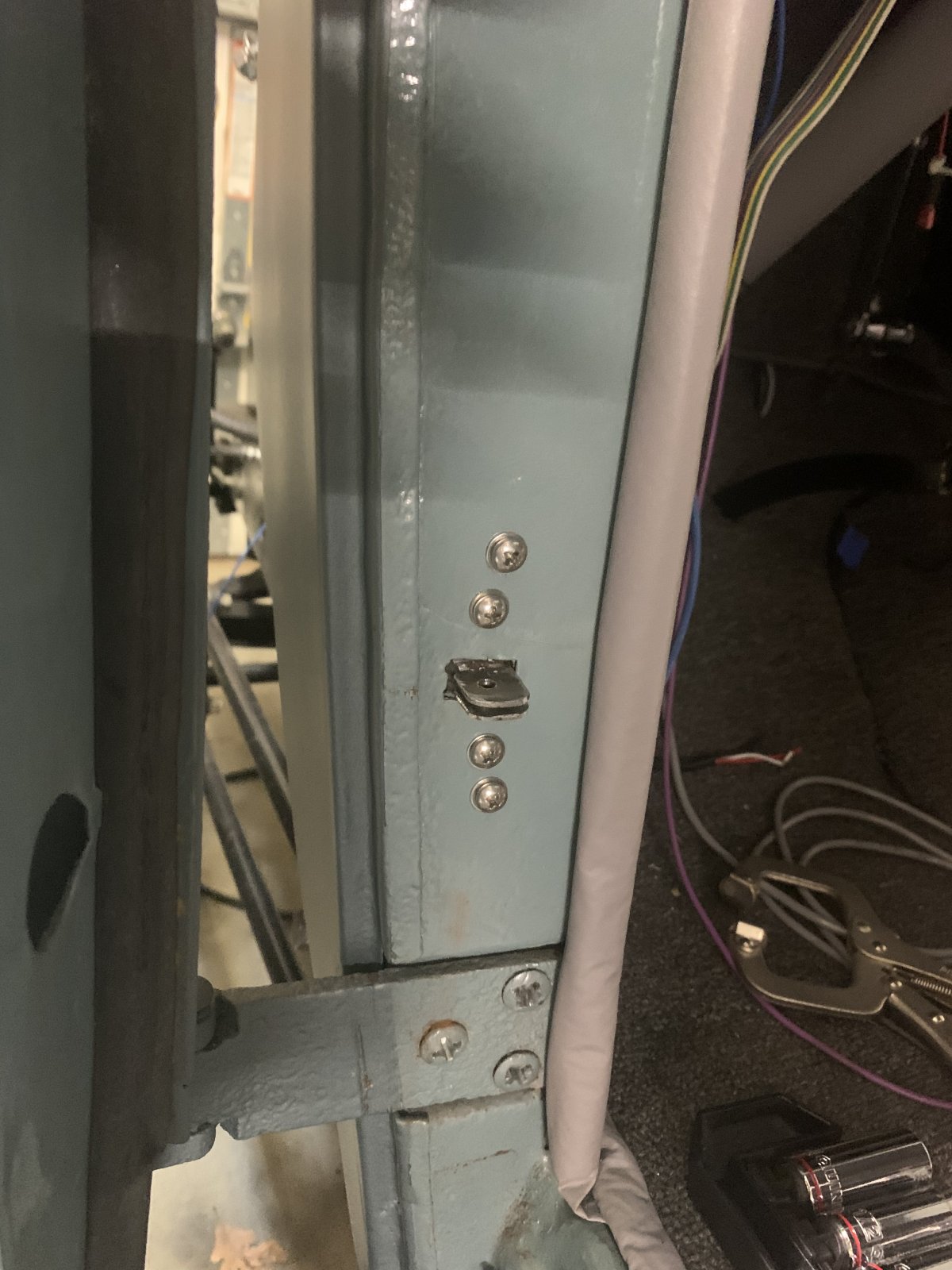

    Been chipping away at smalls today with about 5 hours of garage time available- column is all wired up, I worked a bit on the rear fender that was repaired and needs some body work done to it, and I had to repair the door check arm tabs that come out on the front door post p***enger side. I knew the tabs or tongs where the door check strap connects weren’t there awhile ago. I was just going to use door check straps like on Model As. But I got to thinking about it today and decided to see if I could find a repop piece but they do not make one. So, I decided to make my own. My only problem would be not being able to weld it in place due to everything being painted. But, it’s a truck so I decided to just bolt it in place ….
    Everything was there except the tabs which I made up and welded things together using 14 gauge which seemed to be what the p***enger side was. The original tabs were actually two plates with the tabs made and bent at a 90 degree angle to poke through the door jamb. I just made the tabs a bit longer and cut another plate for a mounting surface that just covered over the old. I used a bolt with a nut in between to line up the tabs and welded them in place.
    I painted the repair piece with self etching primer and bolted things in place …..
    I touched the heads of the bolts up and the tabs with paint and voila - it was done. I just like having the door check arms vs the straps - the arms are on order.

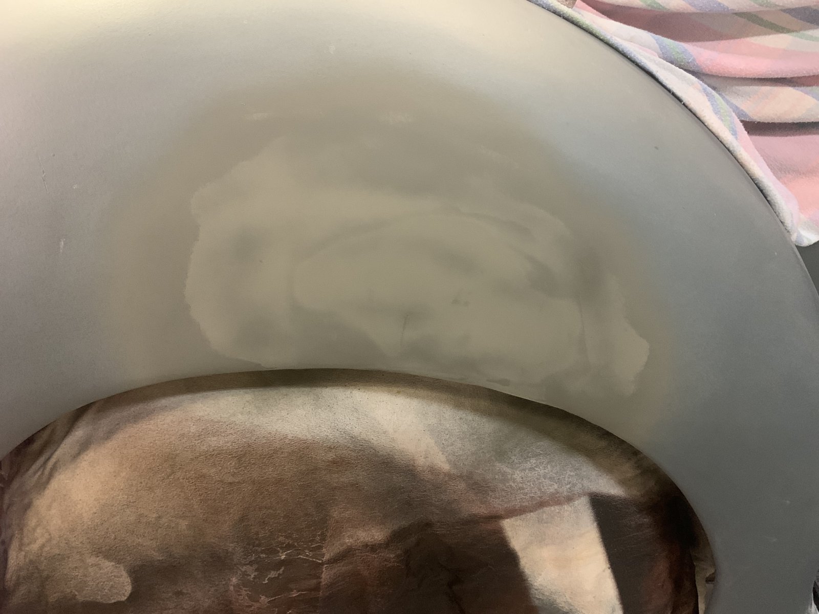

    I still had some garage time so I started prepping the rear fender crack repair by making a first p*** at knocking down and cleaning up the bondo surrounding the repair ….
    I have a bit more to clean up before starting to smooth things out but it’s a good start. I need to find something flexible to wrap sandpaper on when sanding the newly applied bondo. The fender curve there will be hard to get right without it ….

    Finished the rear fender today and I also repaired a crack in the driver so de cab corner. The cab was done almost 15 years ago now remember, by my good friend who has since p***ed on. I imagine that I might see other areas needing attention from time to time ….
    I could have gone a lot more on this one I think - I just stayed with what would come off easily and cleaned and addressed the metal before applying the UPol bondo - that stuff is great. Hardens right up and sands very easily - it even makes me look good!

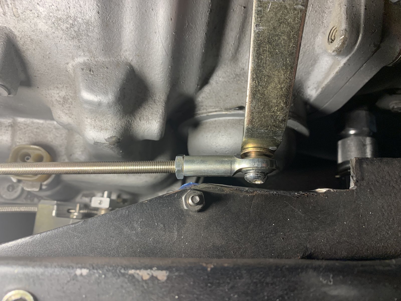

    I did get to do some work on the project yesterday. I had not wired up my neutral safety switch so I took care of that. I had taken the shifter out as it’s a lot easier working inside the cab without it along with no steering wheel and column.
    Anyway, what should have been a simple thing, turned into 4 hours. I had raised the ****** at one point to reduce its downward pointing at the tail shaft. That made the Lokar shift arm run into the frame rail ….
    So I marked the frame rail where it needed to be trimmed. I had to be real careful as there is a brake line underneath and just enough out of the way to make the cut. Getting in there to make the cuts was a bit of a Houdini act. I ended up using a small air cutoff wheel that just allowed enough room for the device to get in there and the small cut off wheel. Since the cut was so close to the brake line I then ground things down until I had it shaved enough. Each time I tested it for clearance I had to install the shifter, connect everything, try it and then take it apart and remove it. I also had to cover things up with towels and such for sparks. After about 5 tries, I had it so it would p*** and still left the brake line untouched….
    once that was done I installed the shifter and tested for voltage on the two neural safety switch posts. In park and neutral I had nothing which is as it should be because there’s no connectivity, and around 12 volts for all the other shifter positions.
    Another piece of project mischief has been managed …..

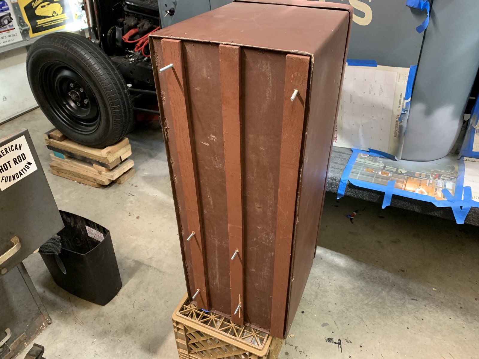

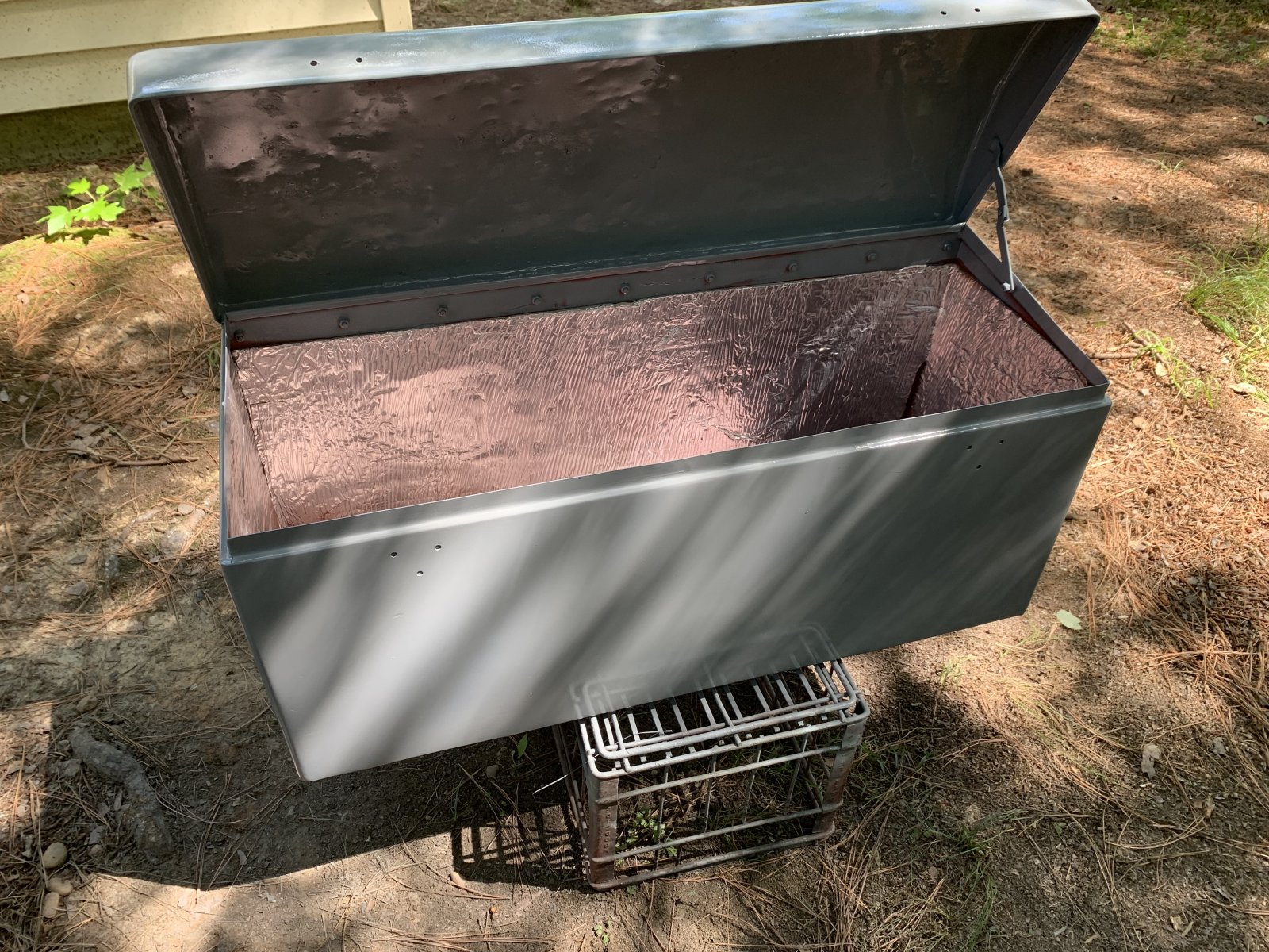

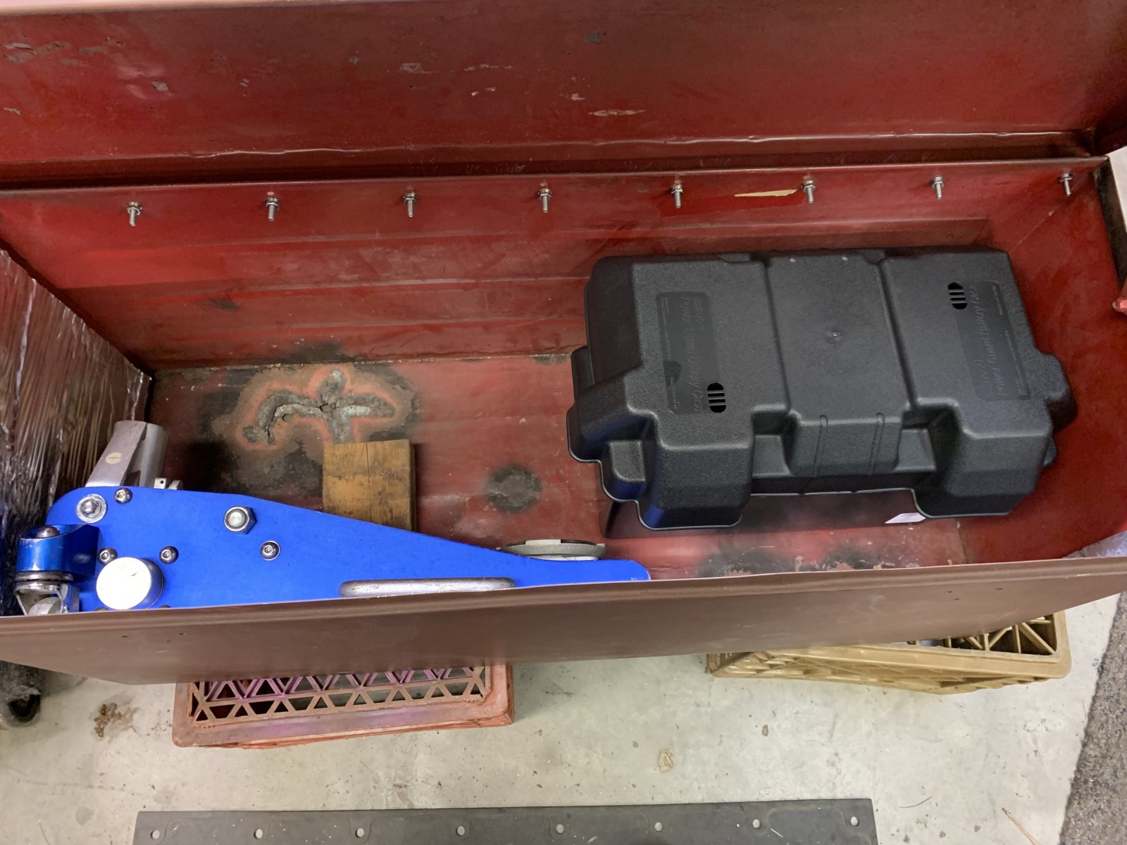

    Been back since July 4th and have been spending as much time on the truck as possible. I have mainly been working on the bed box which has been a saga just like anything else in hot rods at times.
    My first issue was where to put the battery inside the box and how were the cables going to run. I got a rather large one with plenty of cranking amps. I insulated/sound deadened it first …
    I didn’t want the lower lip of the metal touching the wood especially with jokeying it around as much as I would be doing so I used some 1/2 x 1 1/2” oak strips place them so the battery box would mount through two of them ….
    I usually carry a small aluminum floor jack so I selected a location for it …..
    To keep it in place a built a “cradle” that would hold it in place and bolt through it, the box, and the floor so keep things from banging around …
    I started off with bolts I had from attaching the wood bed but they ended up just a bit too small. What the longer bolts things worked out well save for the 3 bolts that hold the cradle down. With those 3 being longer things worked out ok after that.
    Once all the fabricating was all done I cleaned up the box, did body work on a couple of spots, primed it and had the wife pick out a color. She selected a Smokey grey but it only came in gloss which we both did not like. I then thought of satin clear over top and we both liked that ….
    My latches finally came in yesterday and once the paint was dry, I installed them last night and installed everything this morning. However, there was something on the top of the trunk - something that made the paint bubble. I s****ed the whole top down and repainted it and recleared everything ….
