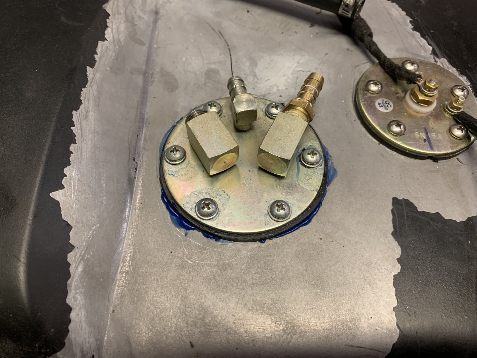

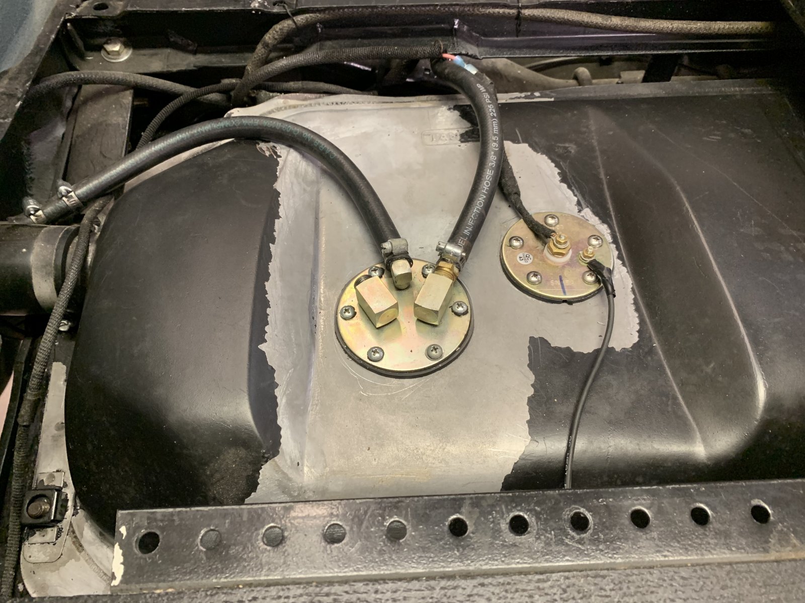

    Home now and got some time to check out the fuel leak. There was fuel puddled at the top of the tank while removing the bed box and two bed boards. I knew that because when I started remove it things the fuel began to drip all around the pickup area.
    Once I got things off and the gas at the top of the tank cleared off here’s what I had ….
    I then turned the key on and flipped the fuel pump switch - no leaks appeared. The result was as you see it above.
    Now I have questions ….
    1- tank sending unit
    the screw package came with rubber washers which fit the tank screws so I used them on the sending unit. Should I use a stainless flat washer instead?
    2- I did have one loose hose clamp that caused a slight leak up by the gas filter where it ran down the pipe to it.
    3- is there more pressure when you crank the engine over? I would oh d think not.
    At this point I will get the new distributor in and attempt another startup, checking the top of the tank for leaks.
    I was hoping to put this to bed today but it was not meant to be. I am also thinking of a trap door in this area either one of the aftermarket stainless ones or one that I make up that fits the theme of the truck, I am also thinking of cutting out the access hole wood carefully and using it as the door using a small piano hinge.
    All in all it was a good day …..

    I use the little o rings supplied by tanks inc, don't twist them down too snug is the trick. Get some Permatex fuel and oil resistant sealant. It never dries, just gums stuff up so it doesn't leak. Apply liberally to the rubber base gasket and those o rings on the screws. It'll stop. Looks like you need to pick up another can of krylon too while you at napa

    Spread on the permatex on both sides of the rubber gasket and set the bolts down down just to the point it starts to squish the gasket out, no tighter. Let the sealer do its job. It never hardens, just a layer of goop to keep the gas in the tank.
    FYI, you might consider buying some fuel injection clamps to use rather than worm drive clamps in your picture. They hold more pressure and you can clamp them down tighter. I hate leaks, especially gas. They look like this if you haven't used them before. I prefer them over worm drive clamps always. The sizing is weird as they are for injection fuel line which is a bit thinner so bring a chunk of fuel line with you to napa to make sure you get the right size.
    brEad, RAK, TomT and 2 others like this.

    I've found the Holley brand of those style clamps to be better than anything I can find in the stores, even when they look the same there is something different and better with the Holley. Price isn't bad either

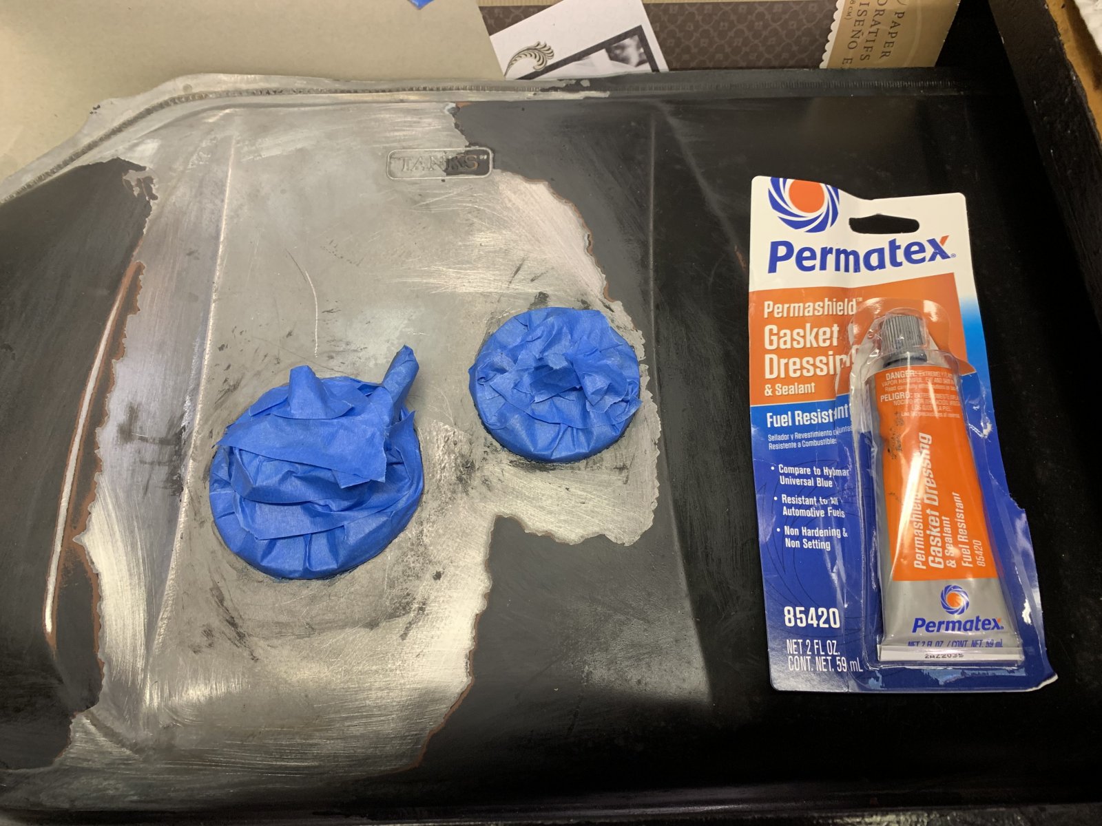

    I picked up the Permatex stuff Bandit Billy told me about but had to order the hose clamps. I got them straight from Holley. Every gasket was coated and all was reinstalled…..
    I will get a picture of the actual tube - pretty sticky stuff to be sure. I have also taped the sending unit and pickup readying all to paint the top of the tank. I will install new hoses with the clamps as well just in case. It won’t be Krylon but rustoleum however ( chuckling). Then I will move to the underneath and clean, prime, and repaint those areas …..

    Here’s the picture I promised ….
    I primed and painted the tank today - got company coming this week so I will not get back to it until Sunday at the earliest. Maybe I will have the clamps by then and I can ****on up the top side …..

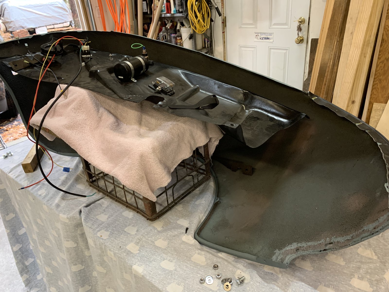

    Any way, I worked on the p***enger fender a bit yesterday and now today ….

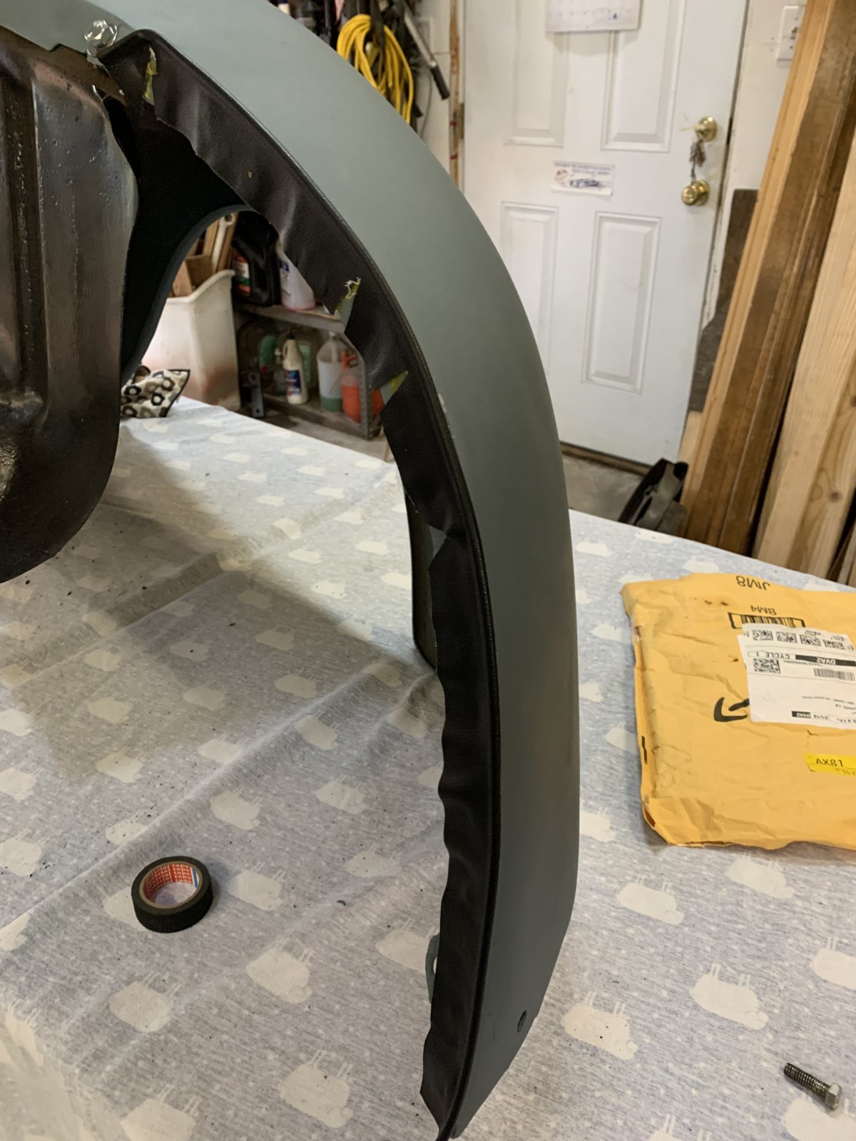

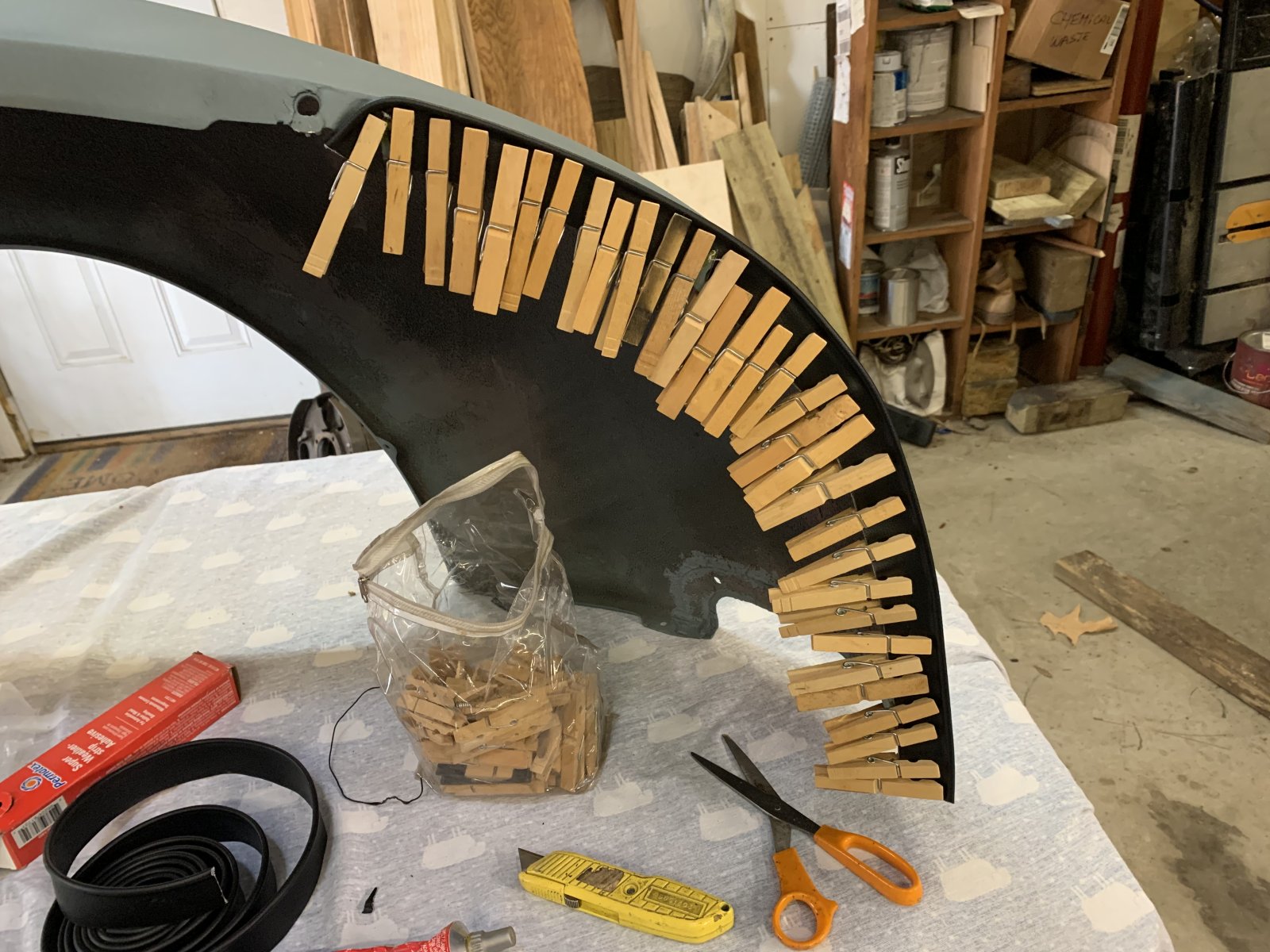

    First off was to put some fender welting where the cowl meets the fender edge. Even tough it is not bolted to the cowl this will aid in keeping things clean during the install and somewhat rattle free going down the road.

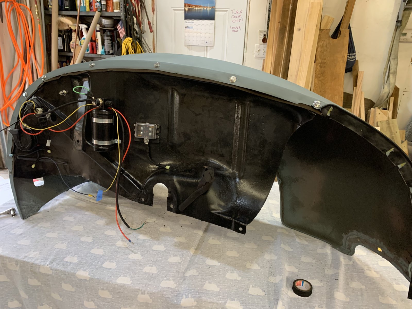

    The inner fender panel was next and I had to get a little creative when doing this by myself ….
    …. and after doing a little m***aging, got it done ….
    Of course I could not find the 4 stock lower surface face bolts anywhere (and I just saw them too - sound familiar?!?!) and just used regular bolts until tge new set comes in.

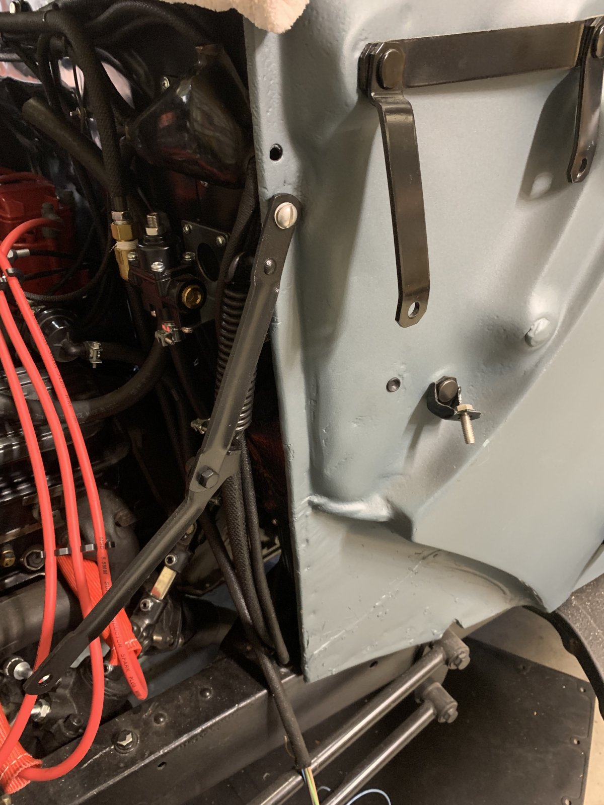

    With the determination of where the hood support arms bolt on the cowl, I have the arms now installed ….
    I have not heard from my engine guy yet so maybe I’ll hear from him this weekend. But I will see if I can round up a couple guys to help me install the hood ….

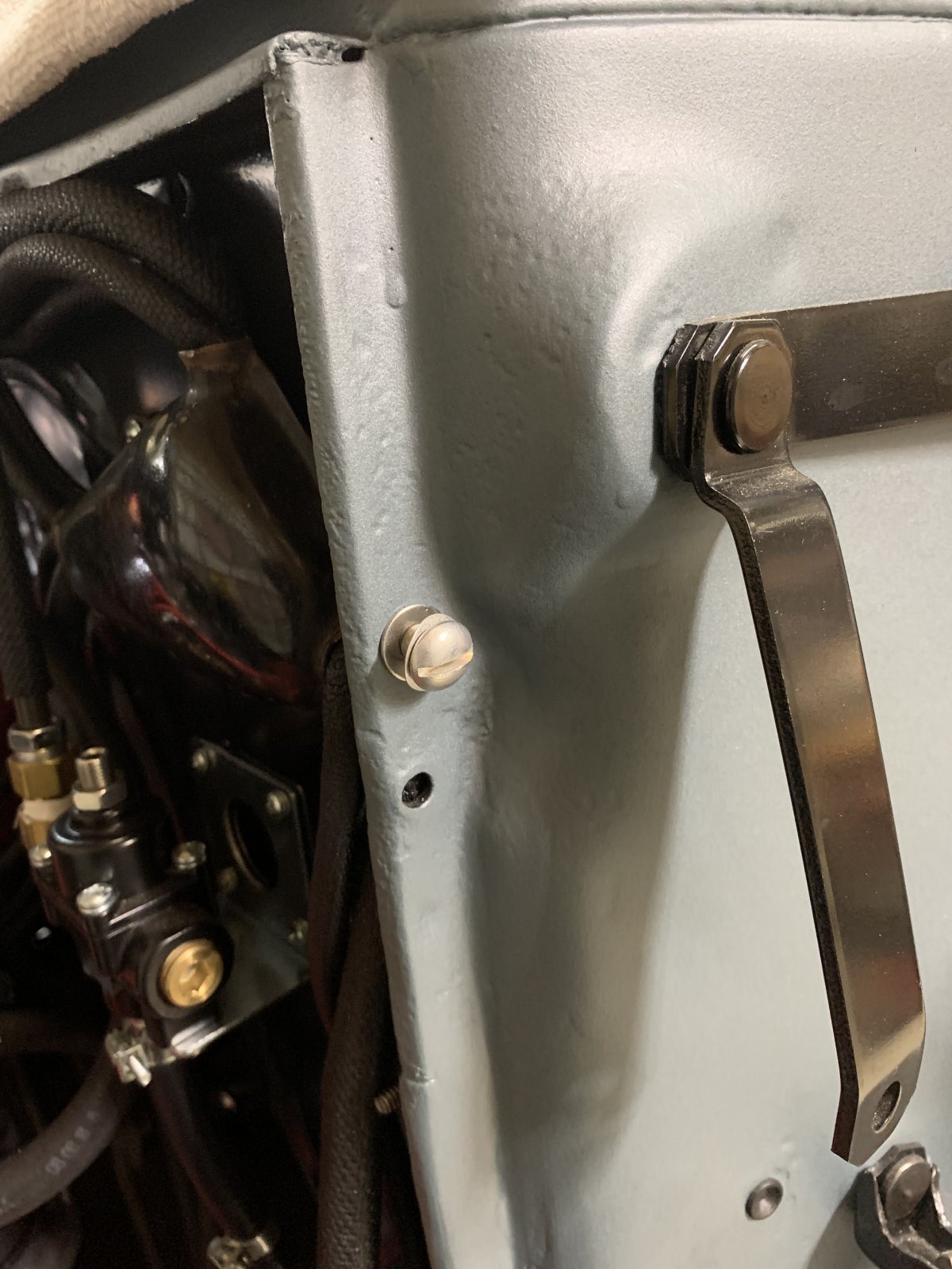

    Hey PU buddy, since your cab is 42-46 there are no holes in the lower cowl as you picture shows of your truck above. However, doesn't the front fender require a hole to bolt to down there? On my 46 cab I requested a template from our HAMB brethren and drilled the holes and set them with riv nuts. I think only one is required and I think it is the lower one but being that I have not re-***embled mine I am doing a lot of guessing. @40FORDPU will know for sure. If he charged for advice, I would be penniless by now. :cool:
    brEad likes this.
  18. TomT
    Joined: Dec 11, 2003
    Posts: 4,682
    TomT
    I think there is one hole way down on the frame, the bracket off the cowl and the rest is bolted to the running board. I will check things out though and see what I come up with …… my fenders do have holes in them to bolt to the cowl but I can’t remember if there were any holes in the cowl in any/all the cabs that I have owned ….
    Btw the holes you indicated, if there are any, would be way up and further towards the back ….

    Here is a better example. My 46 cab in bare metal and no holes in the lower cowl like yours.
    I had one the fellas do me up a template off a 40 cab, I transferred the holes to mine. Drilled and zerted them. Afterward I learned I only needed the bottom one if I remember correct.
    The 39 guy and 40FORDPU like this.
  21. 40FORDPU
    Joined: Mar 15, 2009
    Posts: 4,066
    40FORDPU
    @Bandit Billy is correct.
    Only the lowest hole, the cowl L bracket (or equivalent '46-'47 bracket), running board, and splash guard (tied in with inner fender) attaches the front fender.
    The other two holes will not align with fenders for the pickup, I believe all of the cabs were the same, which explains the other holes which would have been used on the larger trucks for fender mounting.
    Bandit Billy likes this.
  22. 40FORDPU
    Posts: 4,066
    40FORDPU
    This may help when you get to the mounting of the splash guards.
    The splash guard (fender brace) attaches at three points:
    1-lower bolts to frame-shared hole/bolt with inner fender panel
    2-second one bolts to bottom of fender
    3-third one (end with the "arm") bolts to fender lip, approx. 6-8" from bottom of fender wheel well.
    The fender is the only part that bolts to the cowl, utilizing that small "L" shaped bracket.
