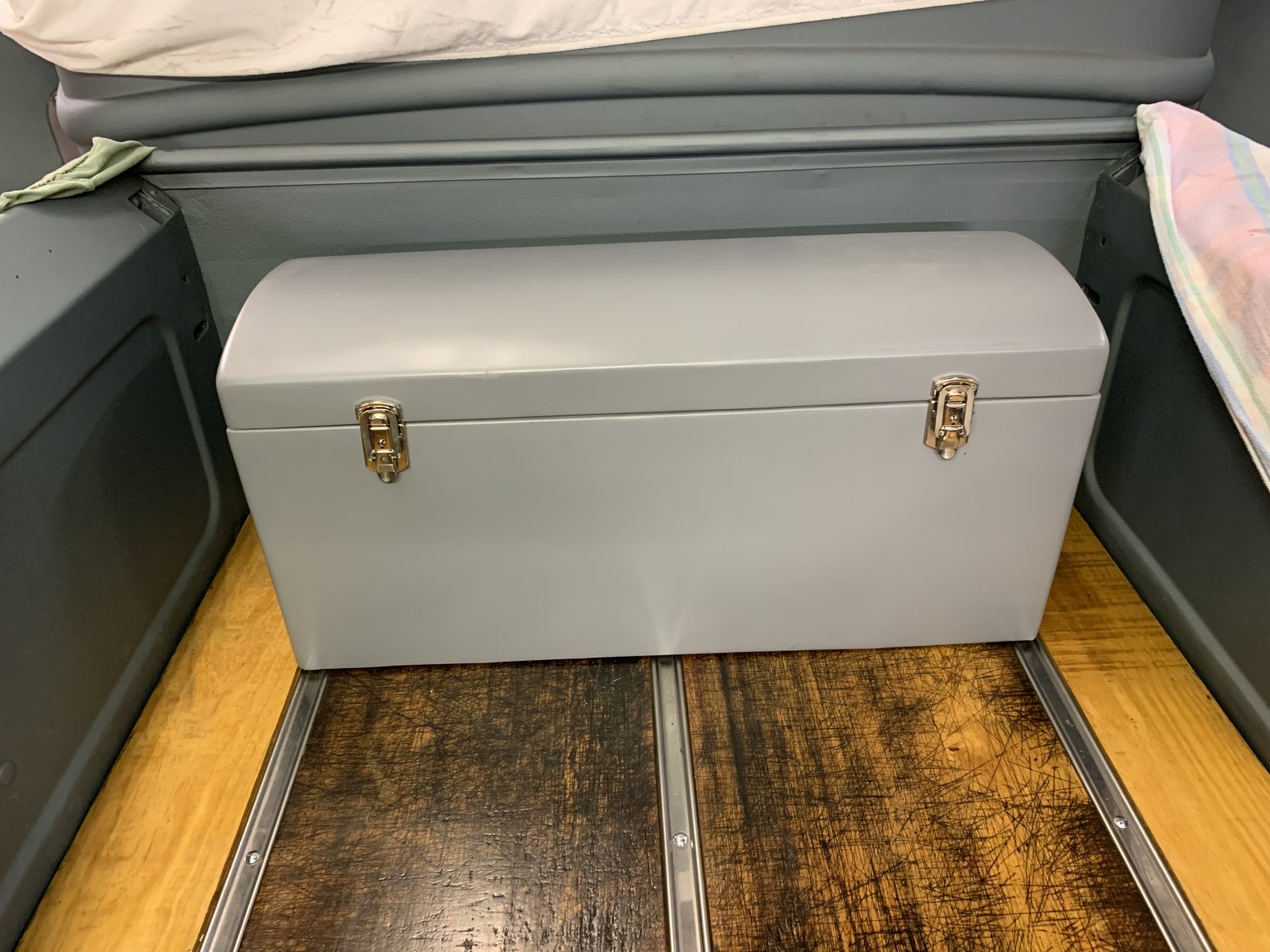

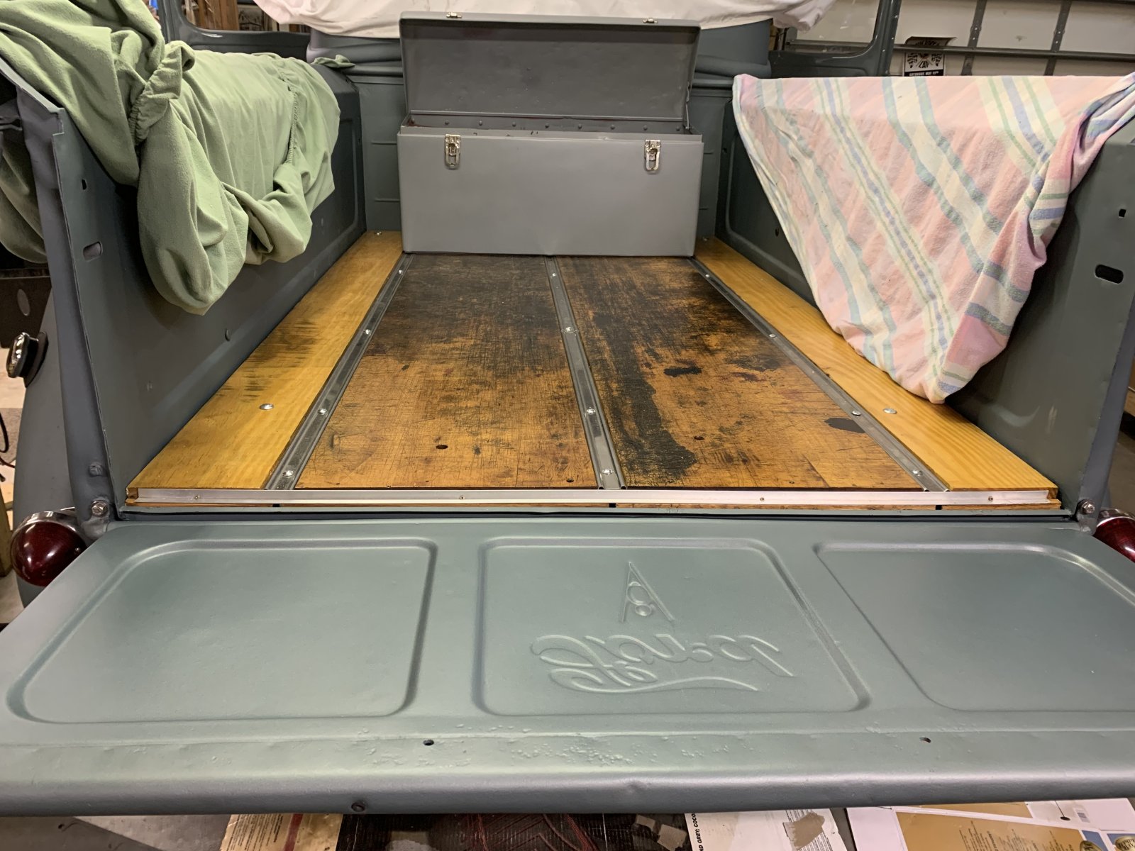

    Some pics of the completed bed ….

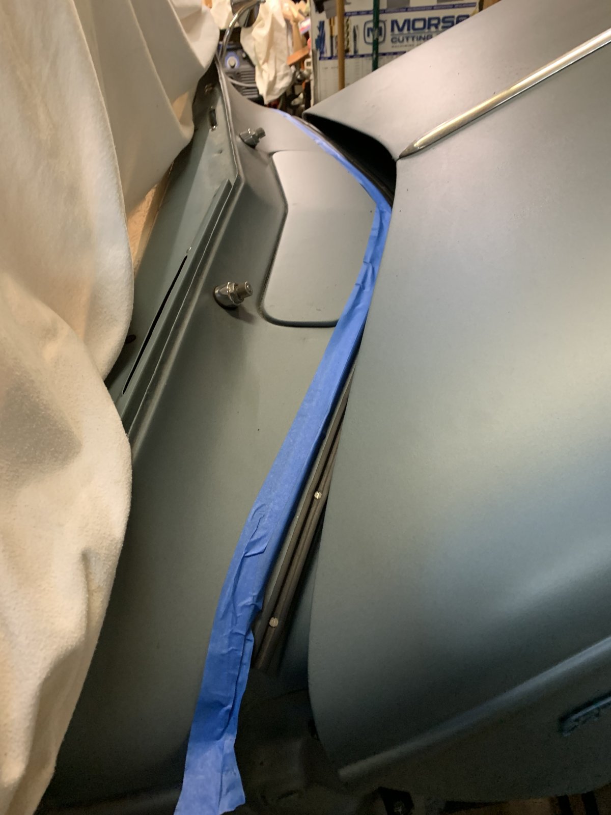

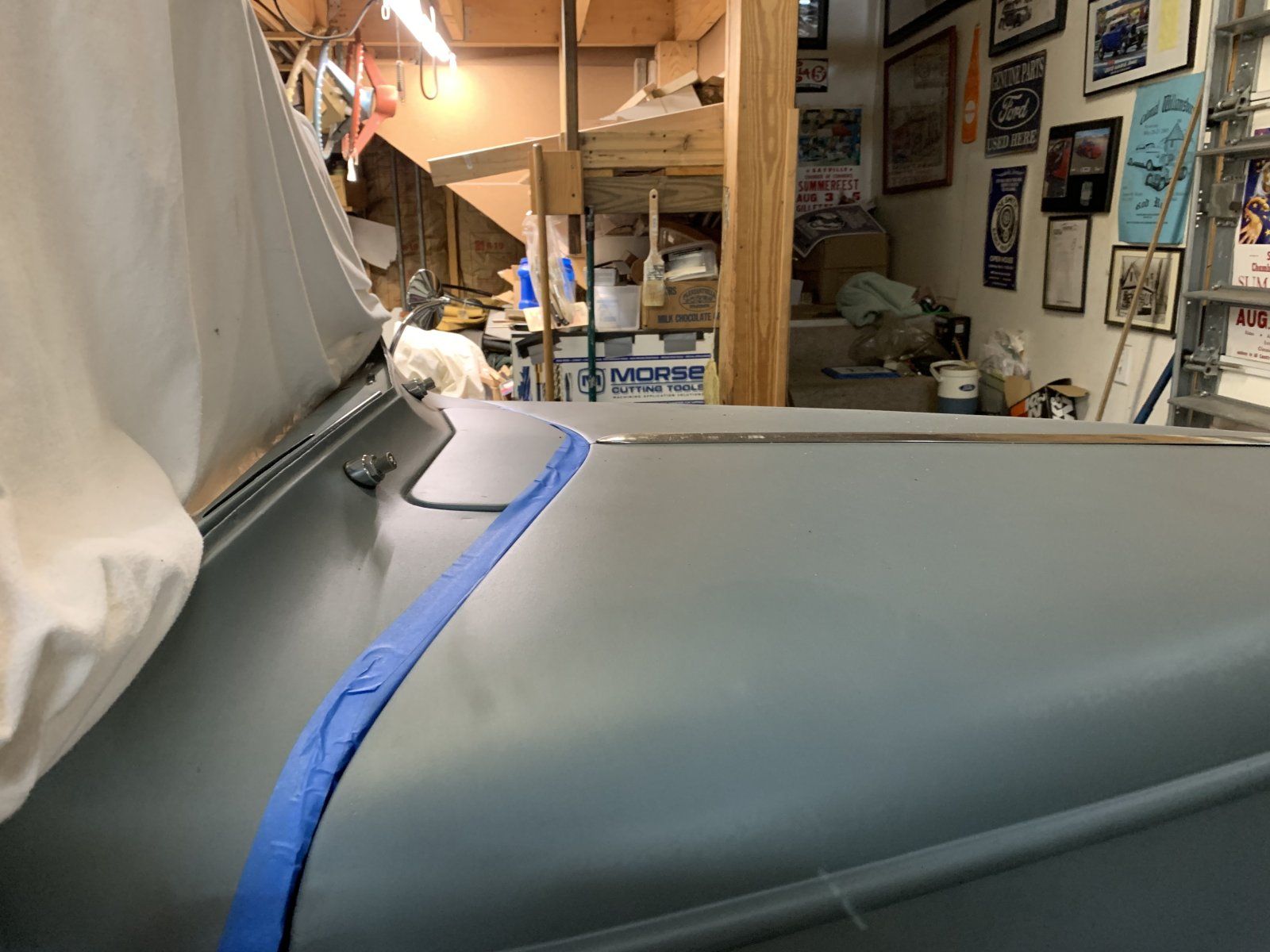

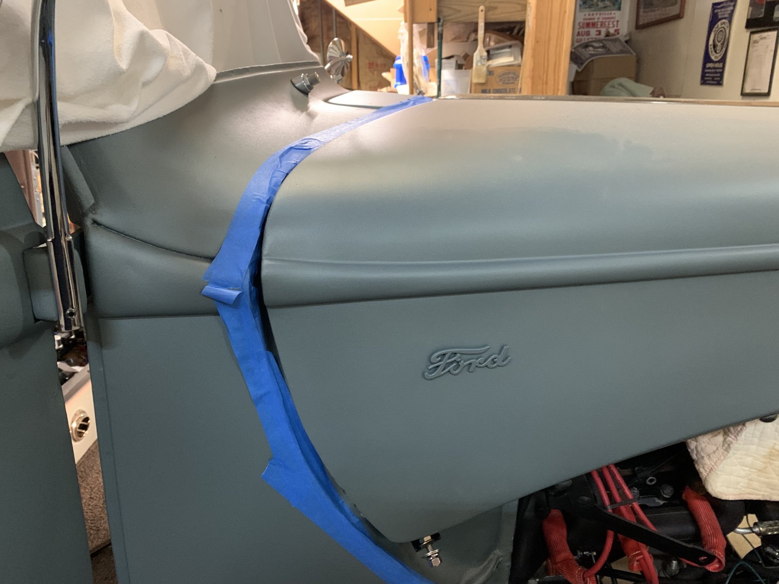

    I have some of my buds coming over tomorrow morning to mount the hood. I have all the hardware at the ready, all threaded holes have been chased, the cowl has been covered ….
    …. along with the engine. The idea is to:
    1- first lay the back cowl edge of the hood right in the cutout of the cowl
    2- bolt the two lower hinges to the hood
    3- then rotate the hood and attach the arms
    4- I will then remove the cowl covering so we can test fit the hood ….
    … with the exposed edge covered
    5- at this point I will adjust the hinges so the cowl gap is right

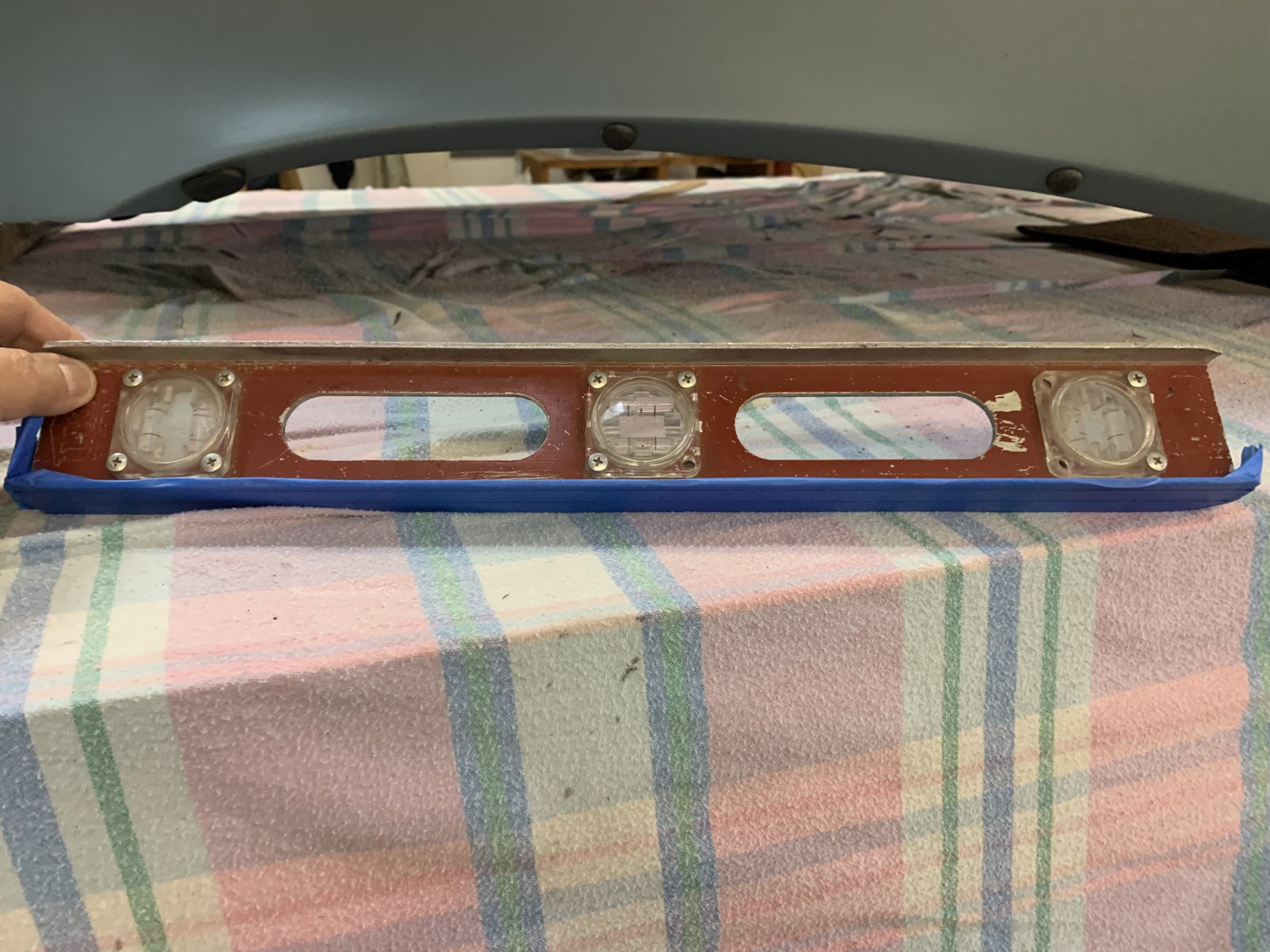

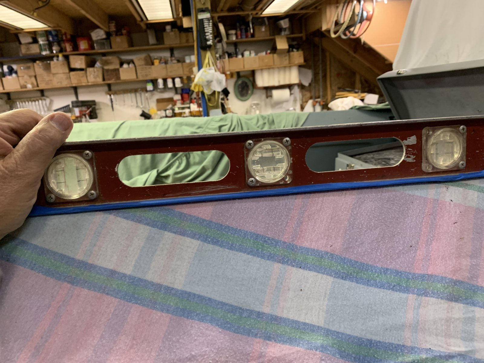

    6- and then see how level the hood is to the truck. This “level” will be taken off the top rail of the bed ….
    … and then transferred to the top of the hood to get me close.
    At this point final adjustments will be made once the rest of the nose is in place. We will see how this all works out tomorrow but you know what they say - sometimes “the best laid plans of mice and men ….”. Fingers crossed!

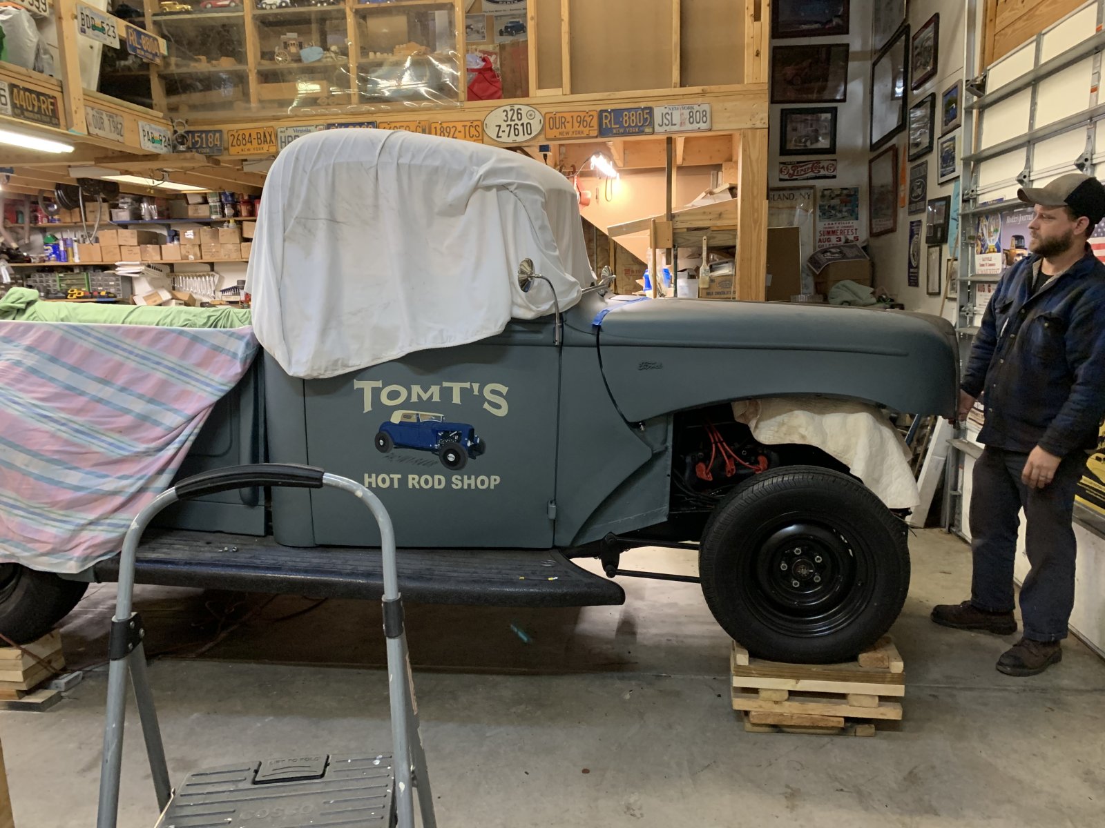

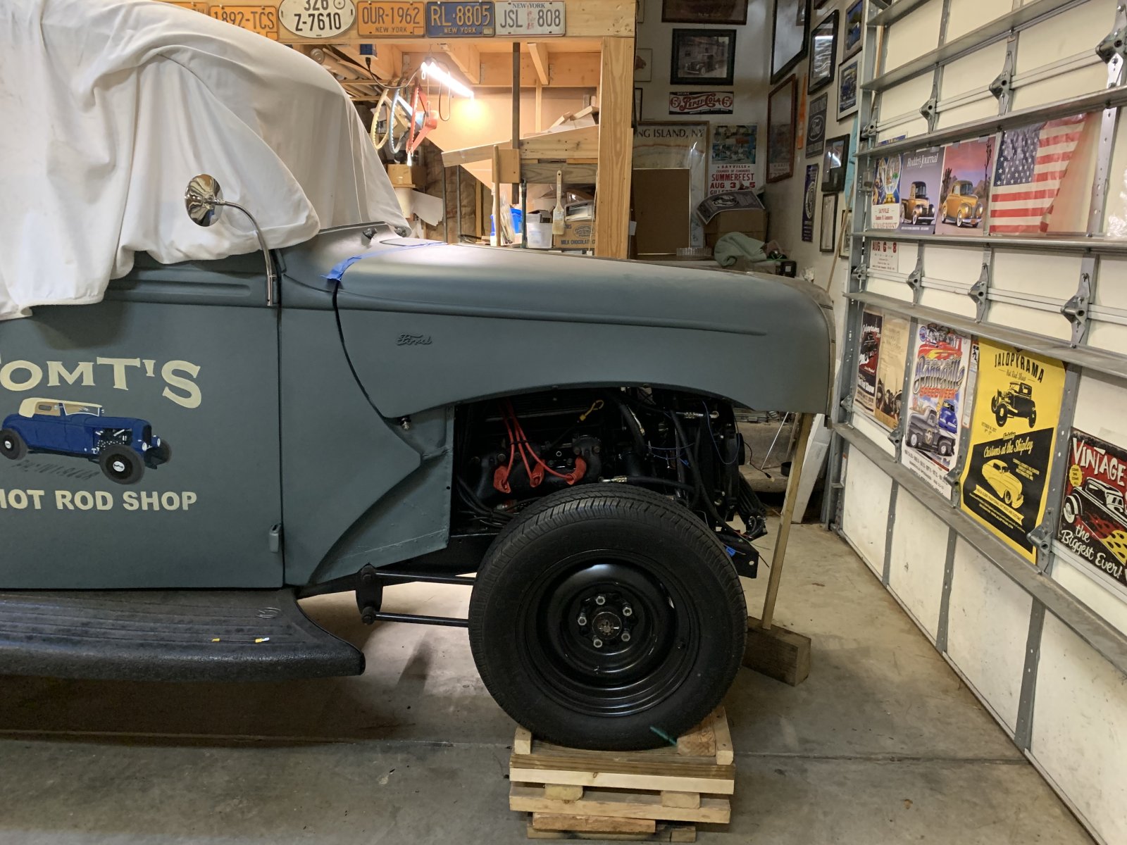

    The hood went on great! No runs, no hits, no errors, and no men left on base! I had 3 guys over and that really worked perfect - one each on the back side and one on the front nose piece. The cowl covering worked out great and the blue tape saved my bacon …..
    The p***enger is up a bit in the back corner but we’ll see if we can straighten things out better once the fenders are on.

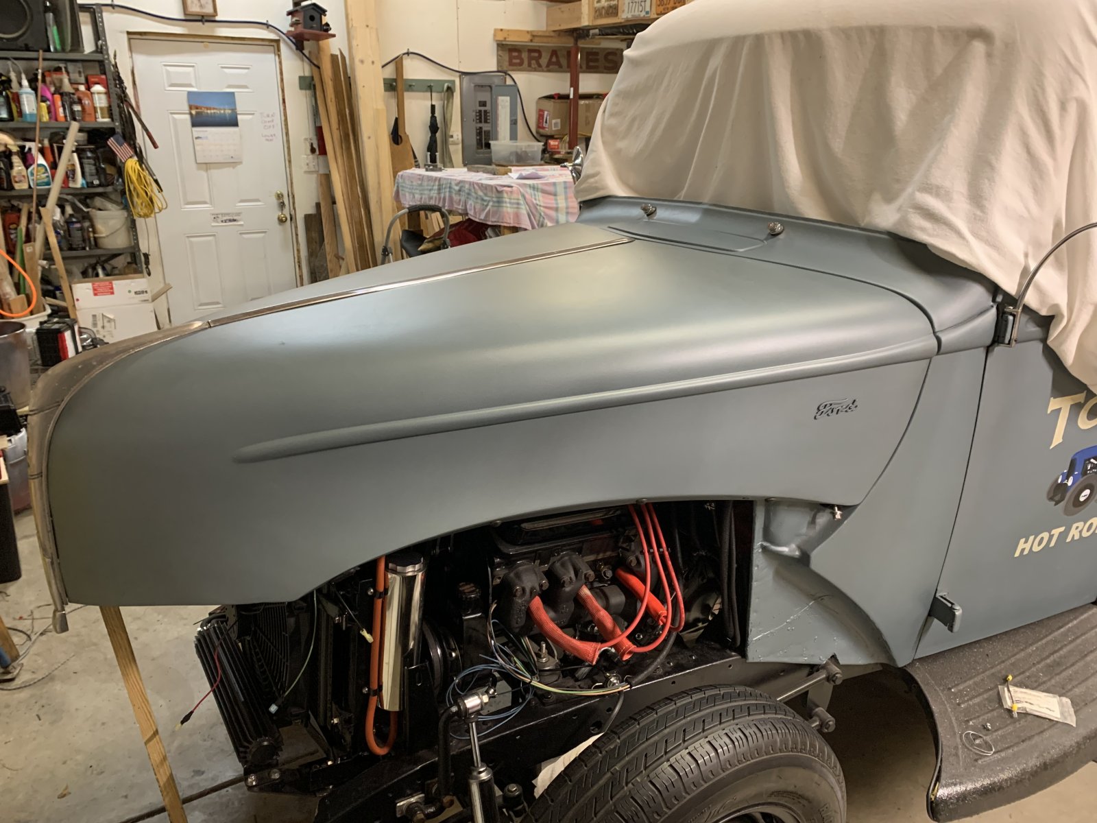

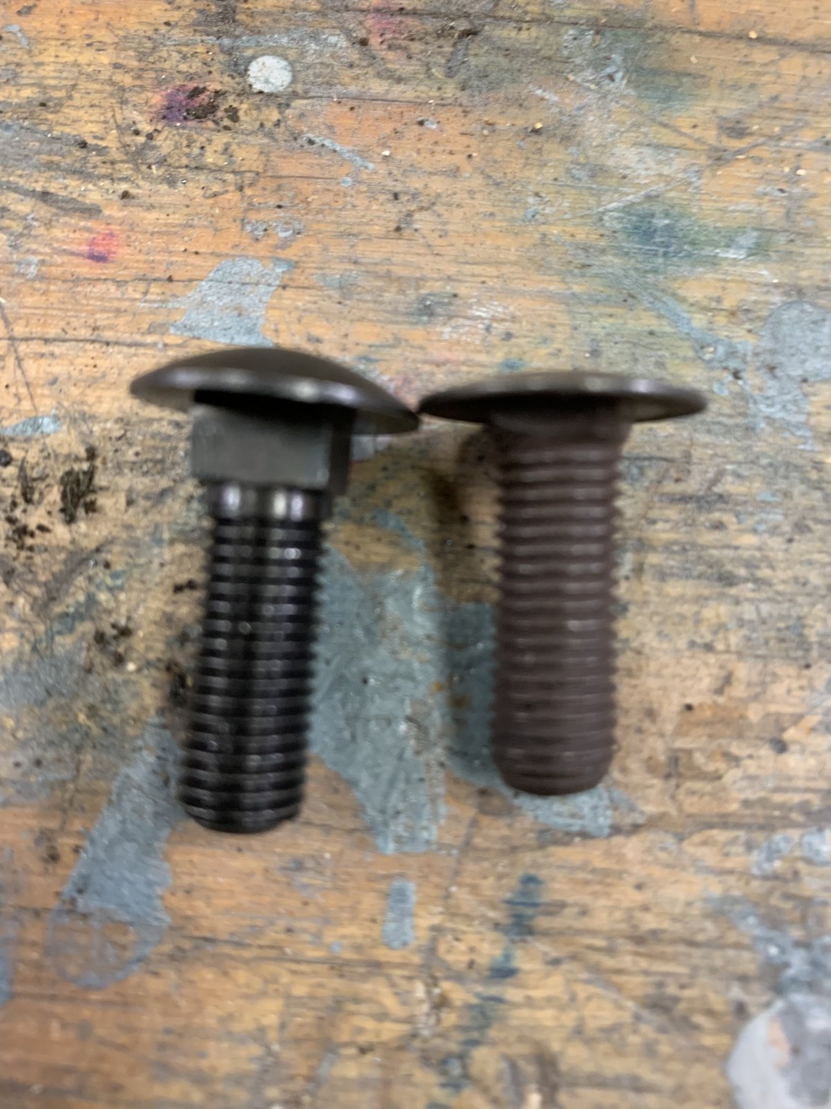

    So, I have been cleaning up the shop and dis***embling the 3-level roll around dolly where the hood sat. Presently, the top portion is off and the second level just has the seat on it so that will get on soon. The bottom level has one piece of bowed windshield gl*** and the rest is junk that I need to go through.
    So, I got the fender to inner panel bolts and don’t you know I find the other 4?!?! Go figure! But, it was a good thing I ordered the new ones ….
    …. as there is a substantial difference between the ones I was using on the right (I do not know where they came from) and the ones on the left which are from Vintique. Needless to say, I used the Vintique ones on both fenders.

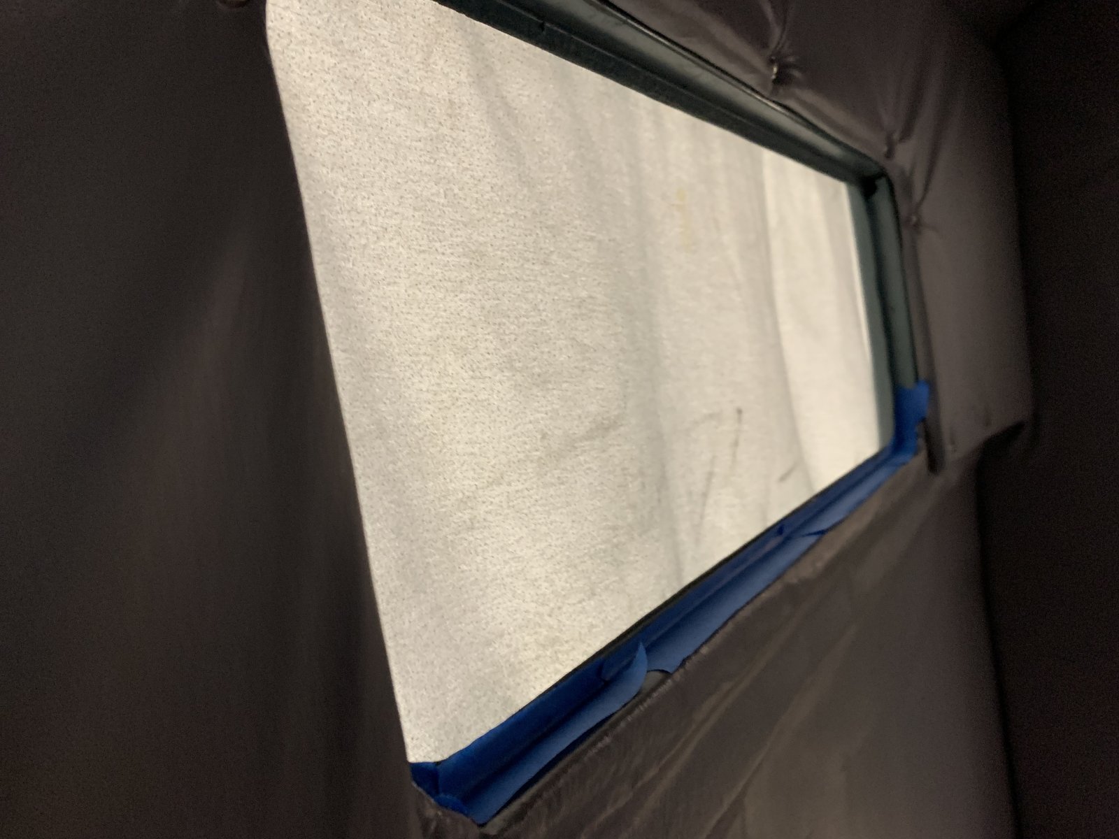

    Got some time on the project today and I realized that I need to install the rear window and windshield gl*** before putting on the frontfenders as I would have a better reach. But in order to install the gl*** having the seat in would be a great help and to kind of prepare myself for the front windshield install, I started with the back window.

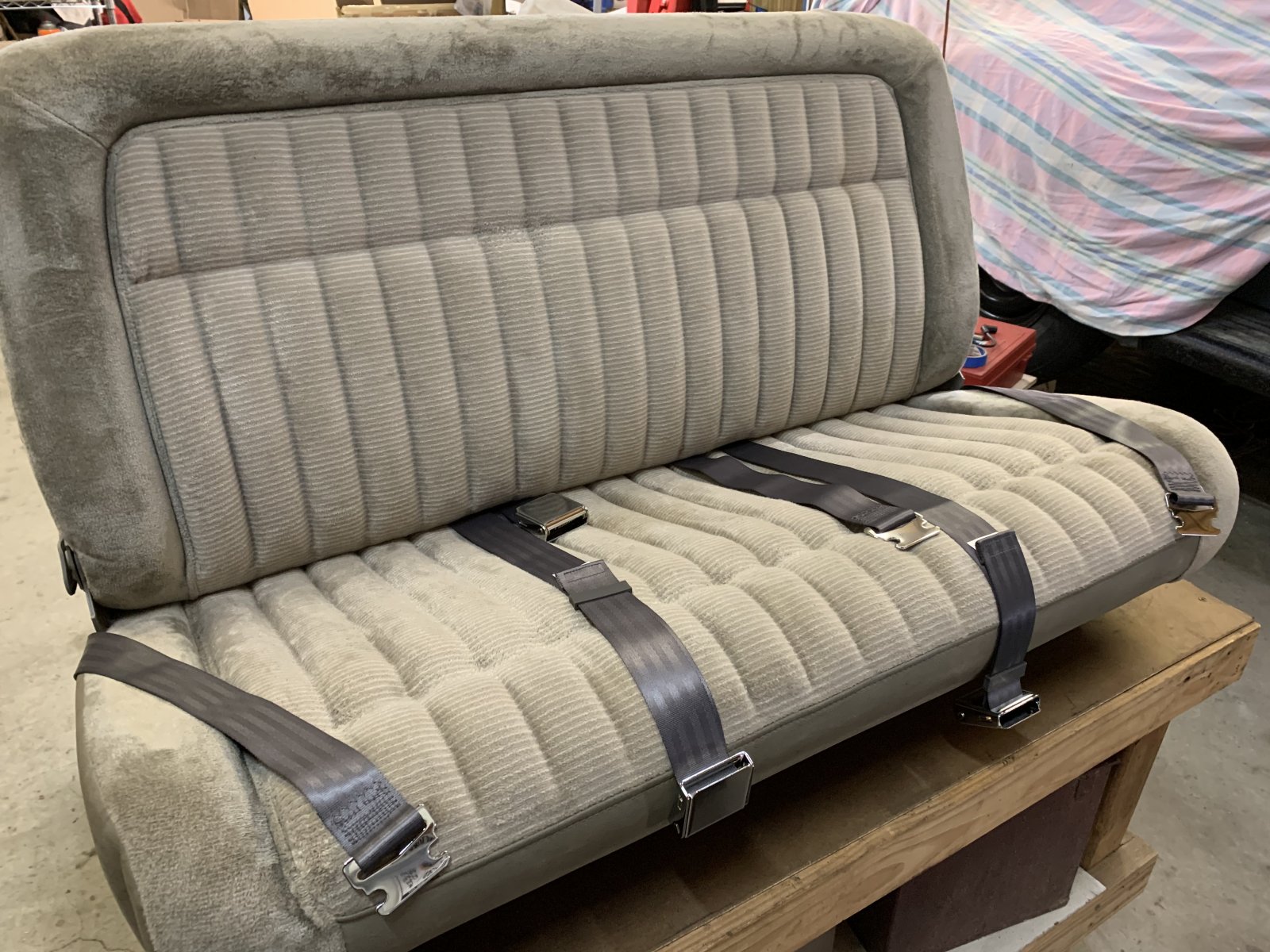

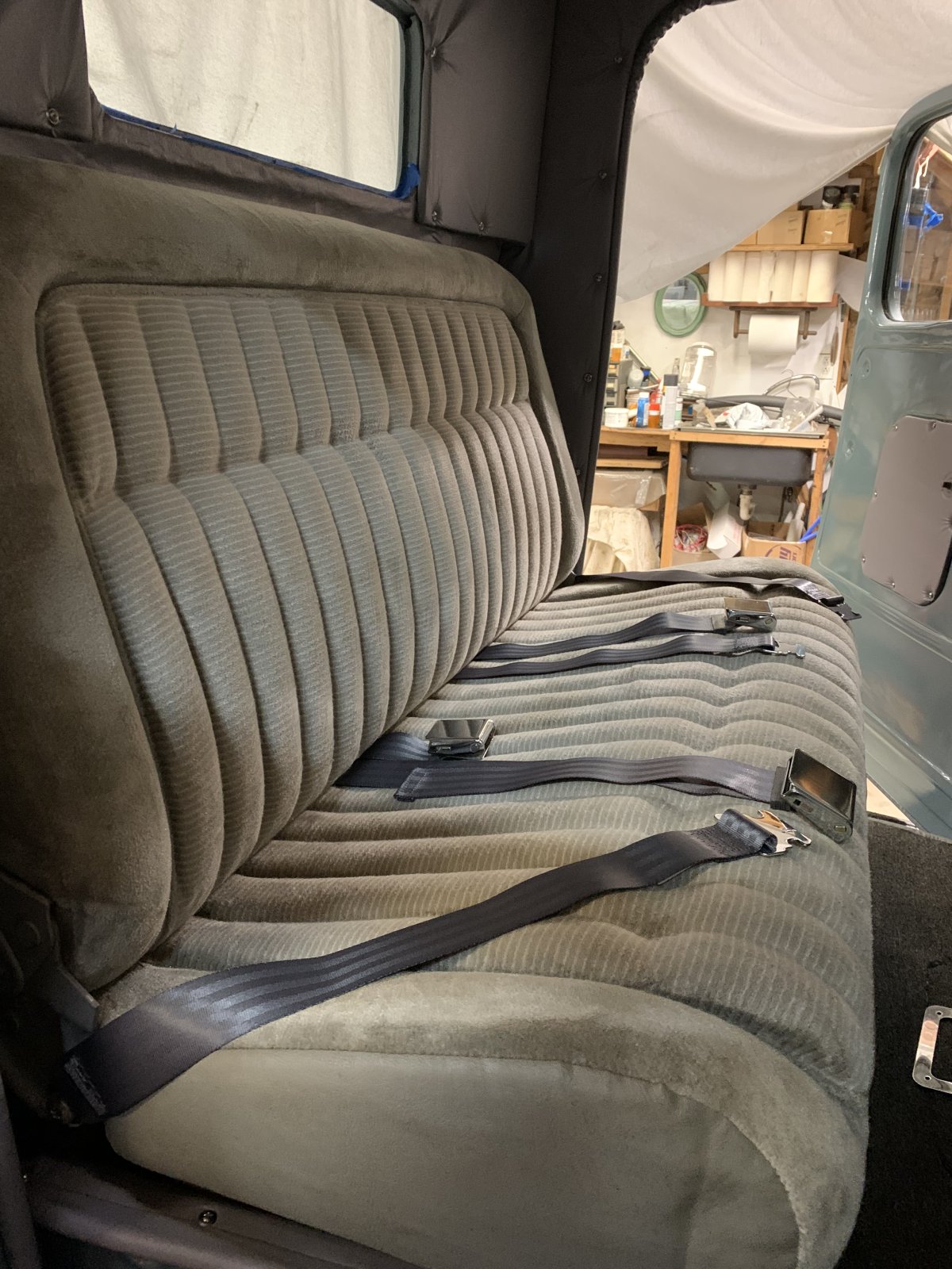

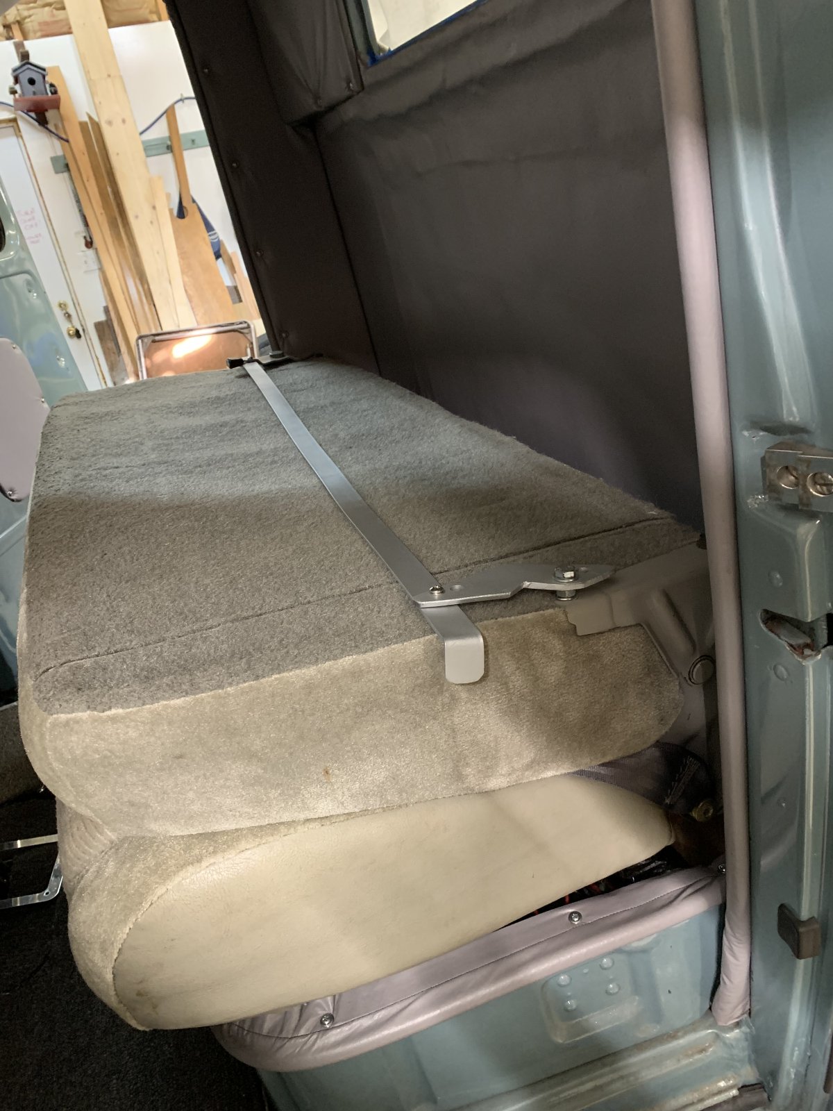

    I got the seat uncovered and cleaned it with some carpet cleaner, scrubbing it with a brush as I went along. While it dried, I glued down some of the excess material around the window ….
    The window surround rubber will extend to the outer edge of the opening and should make for a nice finish.
    This is a pic after the material cleaner but before it dried. When it was dry I installed the seat belts …
    I then vacuumed the seat up good and my neighbor helped me install it ….

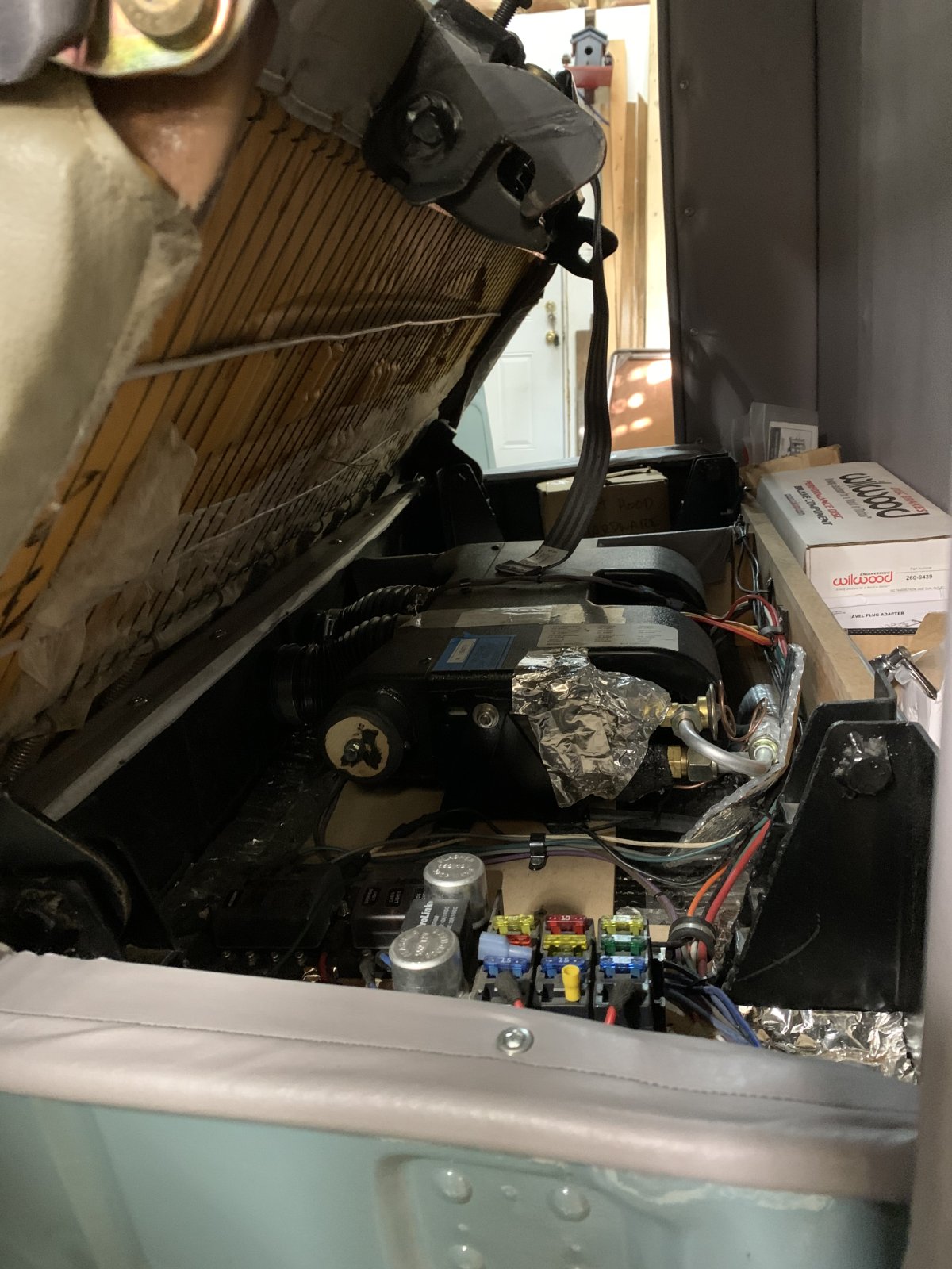

    Remember that this is a 1992-3 Suburban 3rd seat that folds forward and is easily removed with fabricated factory mounts emulating what would be in the Suburban, similar to the Dodge Caravan 3rd seats ….
    It folds forward far enough to access the fuses, tools, and various fluids under and behind the seat easily which is great! There’s precious little room in the cab as it is so every little bit helps!
    The bar you see is to allow the driver to release the seat to gold without going to the p***enger side for the singular release the seat comes with.
    I need to wait for the upholstery to dry and the window surround area more before attempting to install the window. But, I made some progress which I am very happy with …..

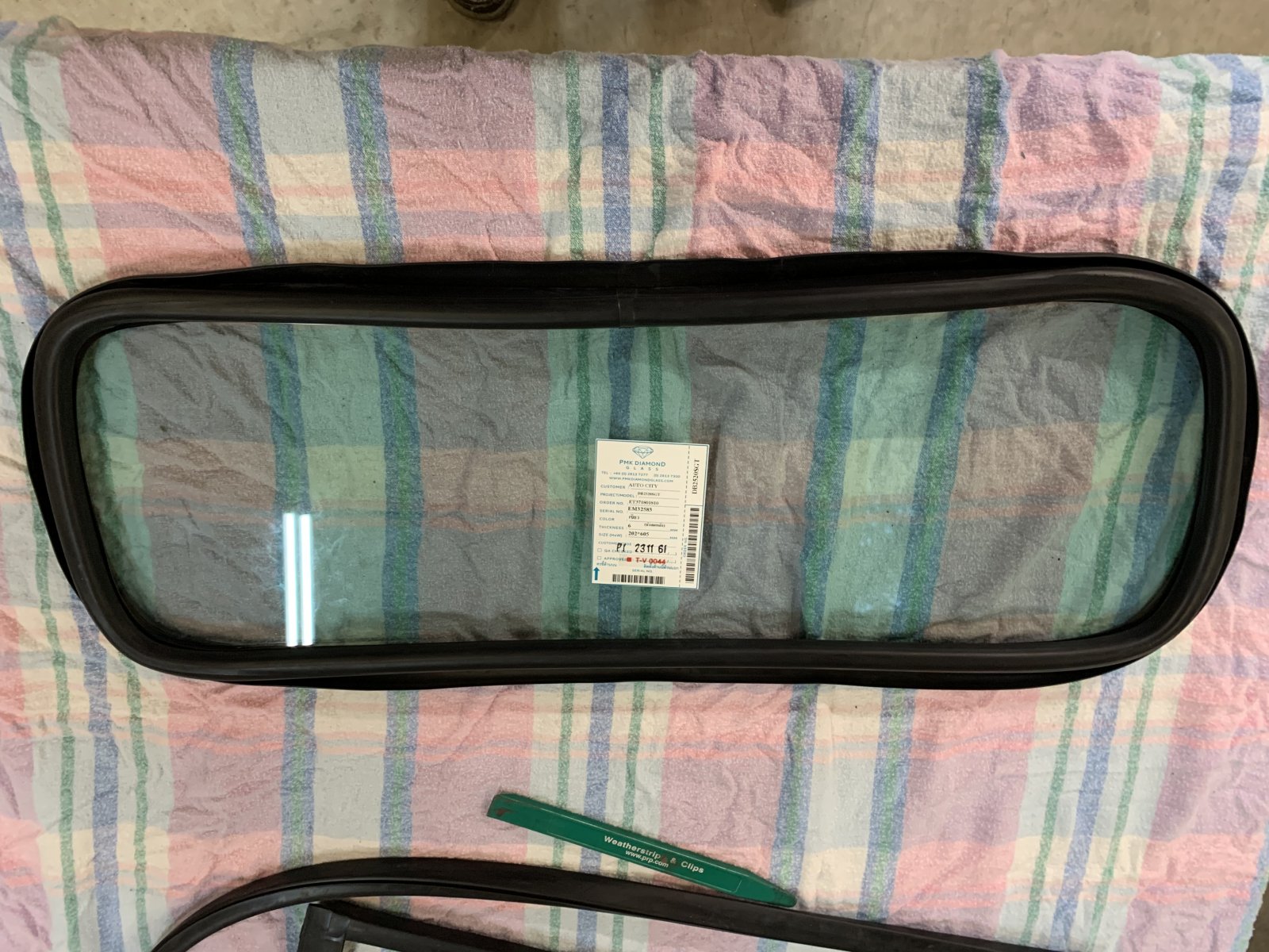

    I attempted to put the rear gl*** in on my own and after 3 hours of frustration, I had to stop before I broke something. I have one of two problems - the gl*** is either cut too big or the rubber is just not flexible enough on the inner lip to allow the gl*** w/rubber to “seat” in the window opening. I will have help later this coming week so I have ordered a new rubber seal and I will check the gl*** size in the opening once the old rubber is removed. This rubber was purchased in the mid 2000s from Drake andcc C although it’s not dried up., the outer lip is stiff. So, I am stymied at the moment.
    I have been working on other small things, just not truck related. I just need to step away, clear my head, regroup, and have at it again. I have always said I get like a “bull in a china shop” at times when certain things get to me - this was one of them.
    I did find a 2014 thread here on n the Hamb on 40 gl*** installation of which okiedokie was able to set me up with a pretty nice article with instructions - thank you - that will help with the gl*** install along with a reference to 3M Bedding and Glazing caulk to help seal things up which I have purchased.
    I will keep you posted …

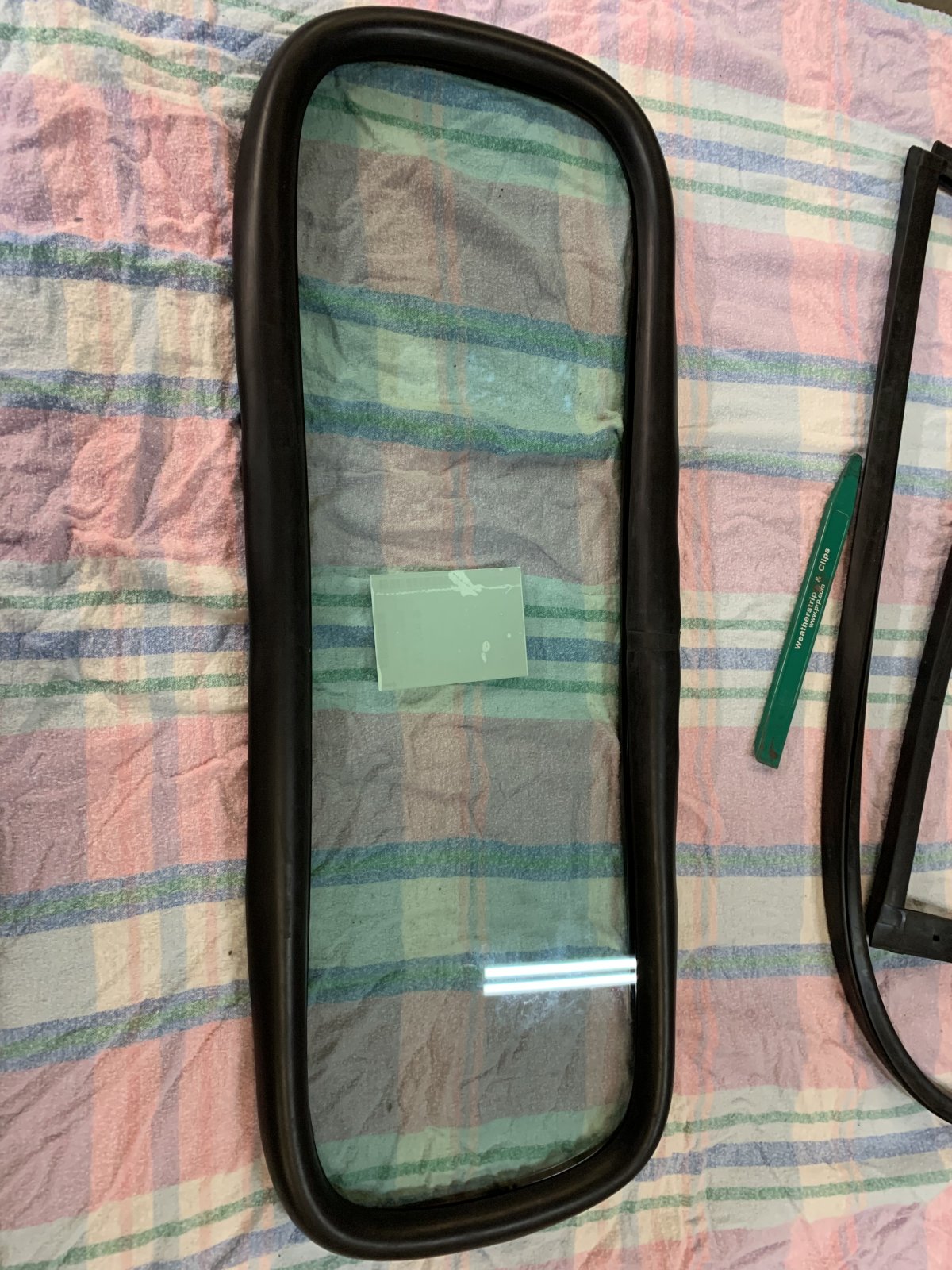

    I have been working on the gl*** installation as my buddy arrived late yesterday afternoon. Couple pics of the rear window ..,.
    We removed the rubber and checked the gl*** size. Since it sits inside the truck, it does not seem too big. We are going to put the rear window aside for now and work tomorrow n the front gl***. I have everything oriented and we are going to install it from the inside. If you do it that way, the driver side is installed first as the fuel center overlay flap is now on the outside so as not to interfere with the inner flap of the p***enger side.
