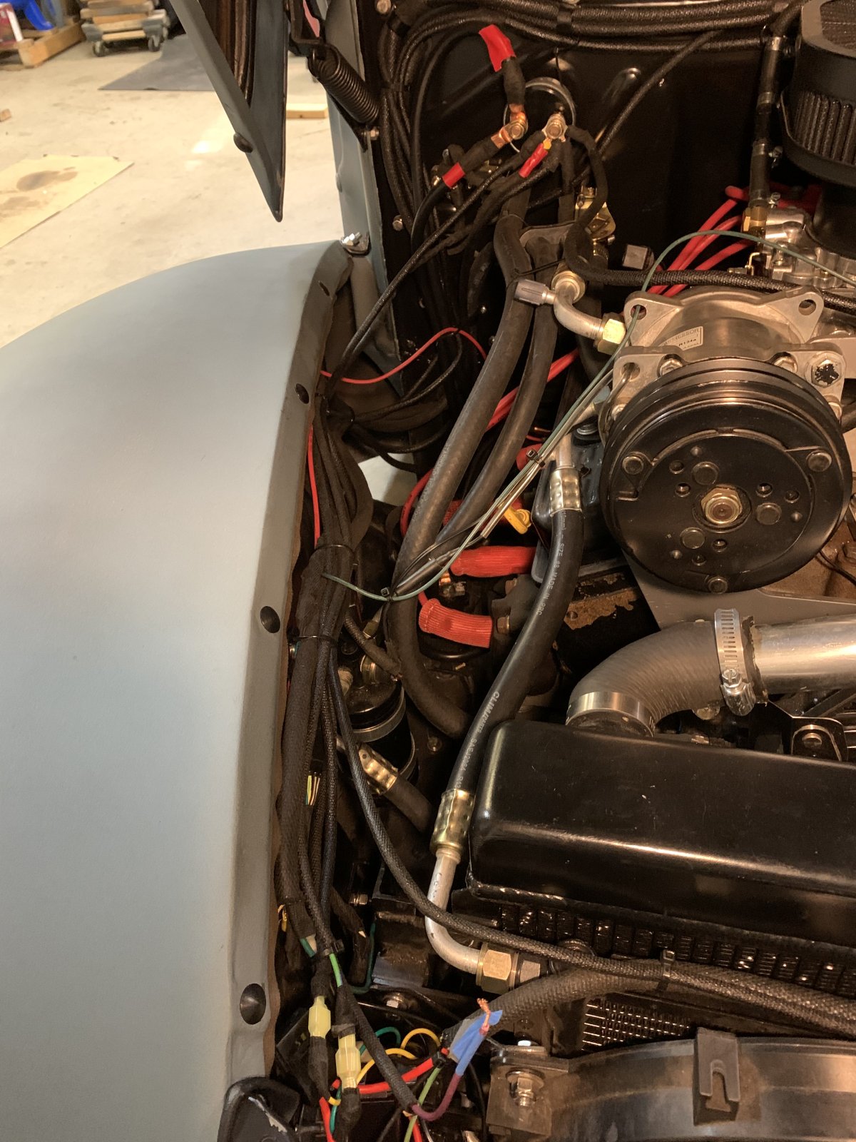

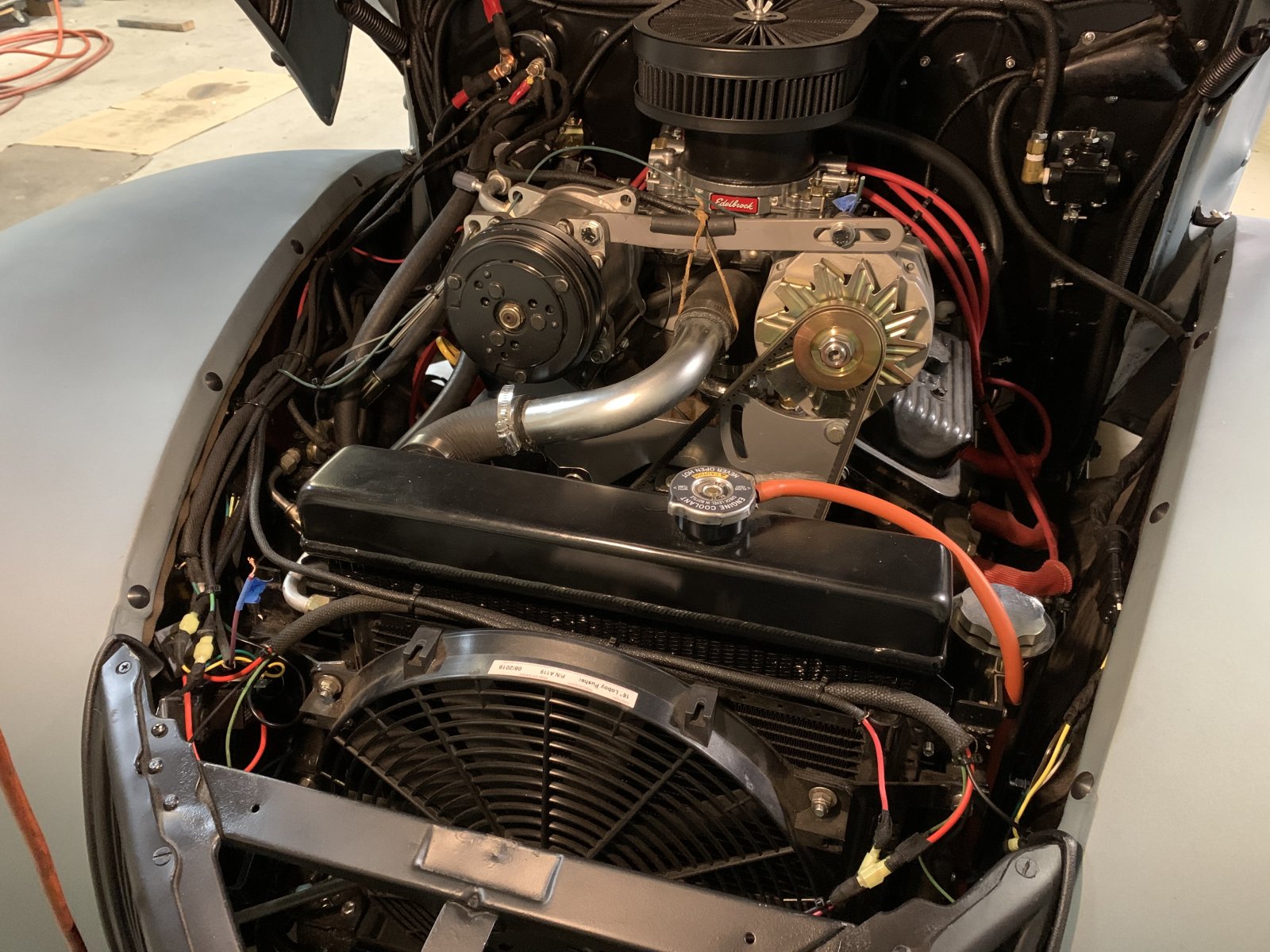

    So here are a couple engine compartment pics - I don’t love it butcI don’t hate it either. There’s just a hellova lot going on with the p***enger side - AC, trailer wiring, Derale fan, hl wiring, amber light, etc etc - it is what it is but you can get at everything and it’s all tied back. The green wire a top the engine is the electric choke wire, the purple one in the front left of the radiator is the amber light wire. After this pic I capped the ends to avoid problems …..
    Memorial weekend bbq plans and such are putting a crimp in my garage time. I will probably only have short segments of time here and there. I will probably clean up the shop getting ready for the last punch list that I need to get through ….. been a long road to get here but I am very, very pleased with the outcome so far. Let’s just let it be reliable for us so wifey can have some fun with it …..

    I am just getting to the front end wiring. Not a lot of room left in the engine bay without everything looking cluttered like you said. Once they are all tidied up I'm sure it will look better.
    Since the AC and heater hoses are on that right side I am going to take the harness down the left side. I bought a bunch of cloth covered wiring in colors that match my wiring diagram and will likely use an aircraft style lacing to keep them neat. I thought about running the harness under the fender in a armored harness but I think I can make it look tidy without hiding them.

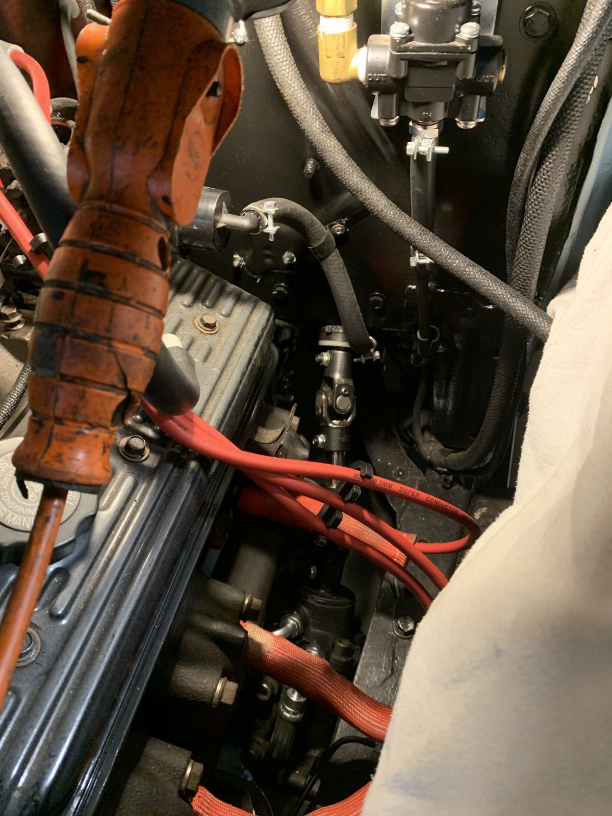

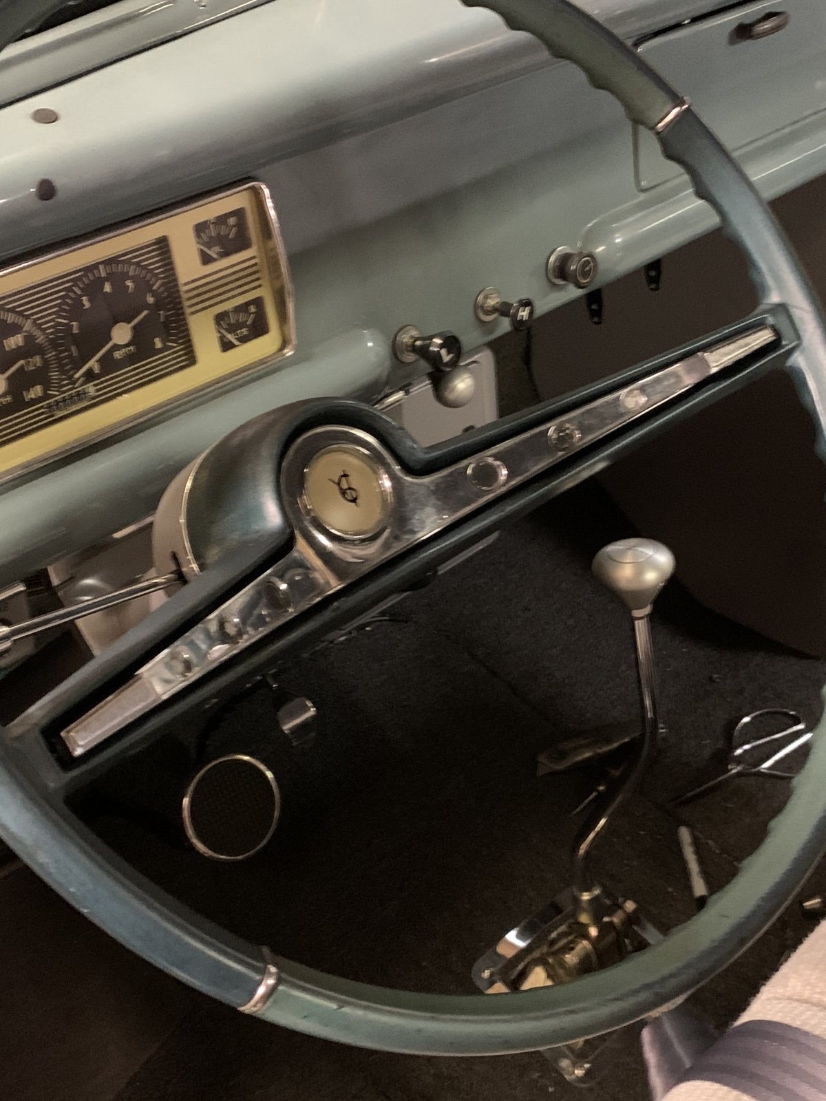

    Anyway, while installing the steering wheel and testing the horn, I noticed the center steering rod had some play/movement hindering my ‘62 Chevy steering wheel to activate the horn (I am using a swap meet find aftermarket Speedway column). After investigating, I did not have the column universal joint properly set on the “flat” of the 605 PS steering box - the flat area that should be used for the universal joint lock screw and nut. So, I have discoed everything in the engine compartment, reset it, and that’s where things stopped (our daughter came to visit). Tomorrow I will be free to jack up the fe and turn the wheel enough to reinstall the universal screw and lock nut and then test the horn. A not-so-little thing that needs to be addressed. Interior wiring is almost there but once the column gets s settled, it’s time for the first test drive around the block ….
  6. TomT
    Joined: Dec 11, 2003
    Posts: 4,682
    TomT
    Sorted out the steering column and the horn works but the clips holding the plastic center piece of the chrome horn piece are now gone so I have gorilla glued it in and I’m waiting for them dry.
    You can’t see too much in the above pic but I posted it anyway.

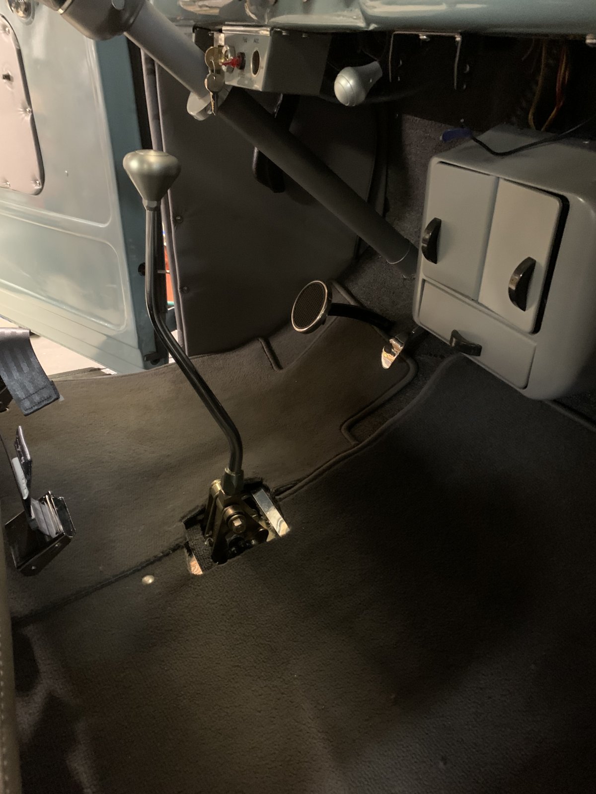

    So while I wait for glue to dry, I had some grey mats from our 2010 CRV that I sliced and diced to form a nice set of mats. I have to edge them and there is a snap system I will incorporate that holds the two sides together. I think they will work nicely.
    So now that I am ready for a test drive, we are supposed to have 4-5 days of rain - go figure! I also bought a radiator cap with the sacrificial diode attached - I had a DUH moment when looking for just the diode and then saw ones attached to a new cap! Oh boy …..

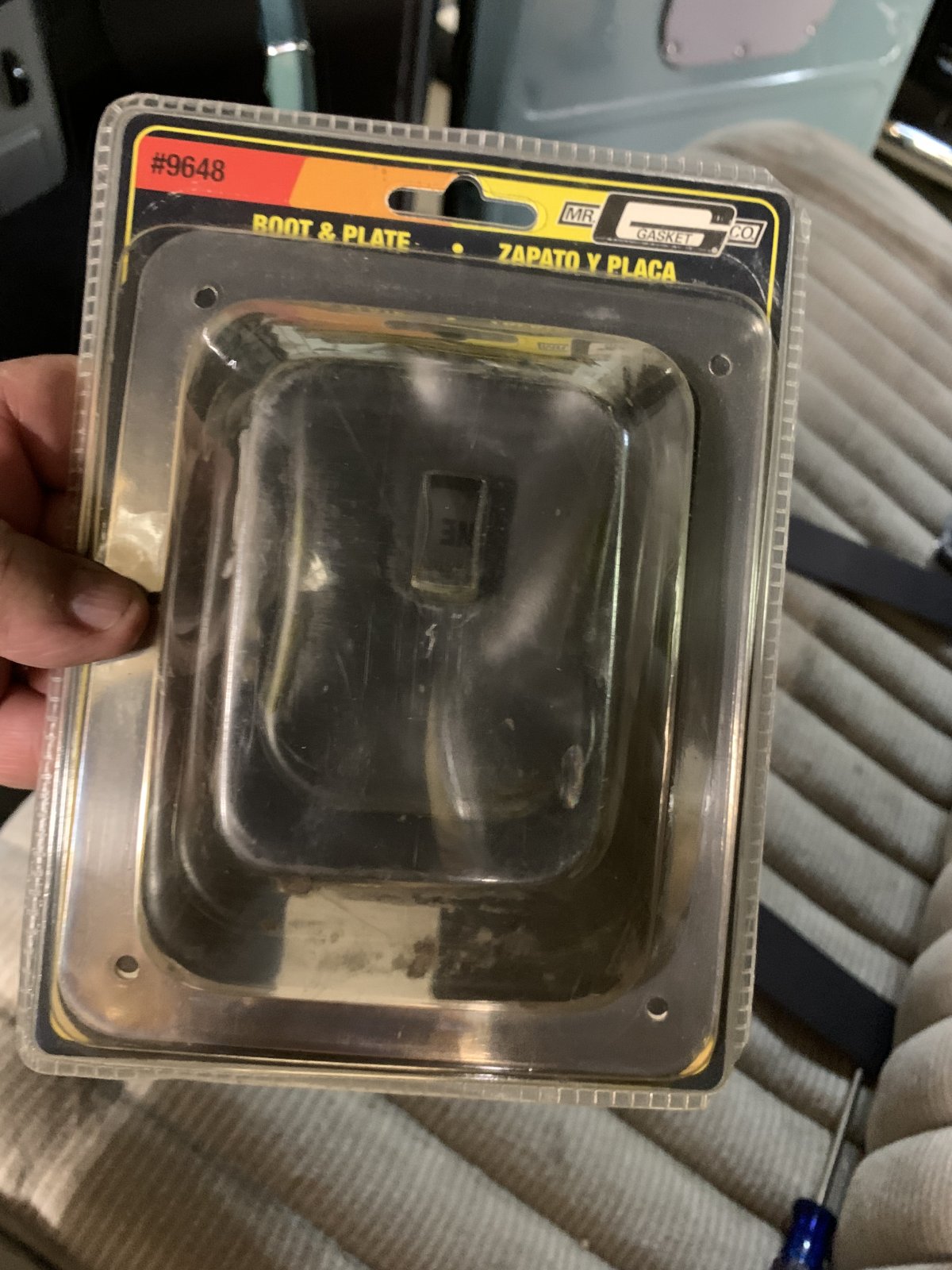

    So I will mount the shifter plate for the boot and have my wife sew one up for me. It will be the draw string type to accommodate the large shifter head.
    Had fun today - it’s been awhile since I played in the garage ……

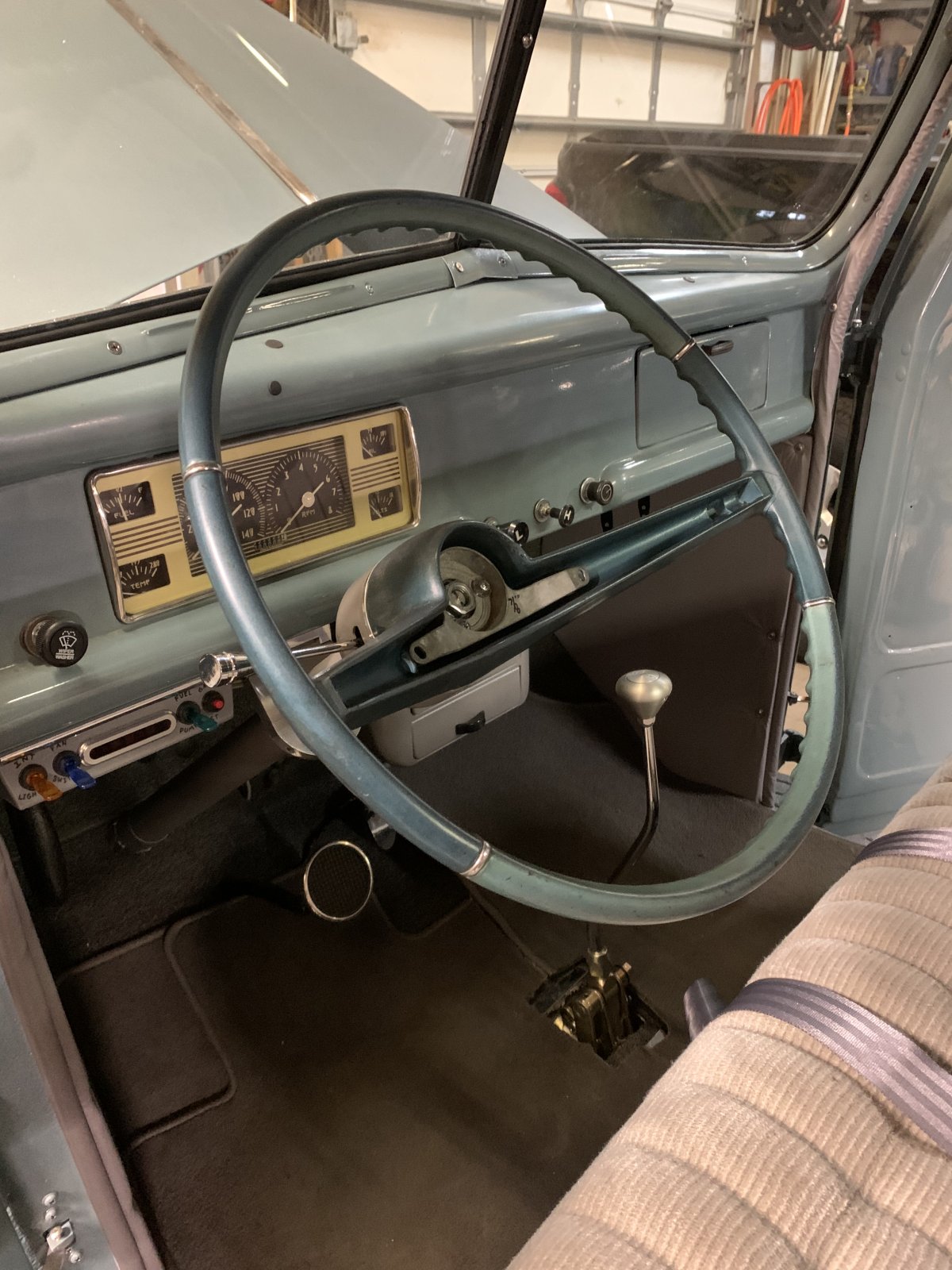

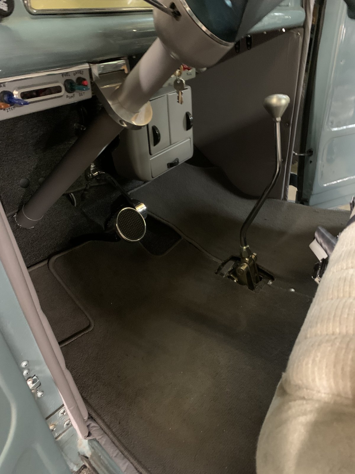

    Still pouring around here but I am in the garage chipping away at the last bits. Horn ring is on and functioning ….

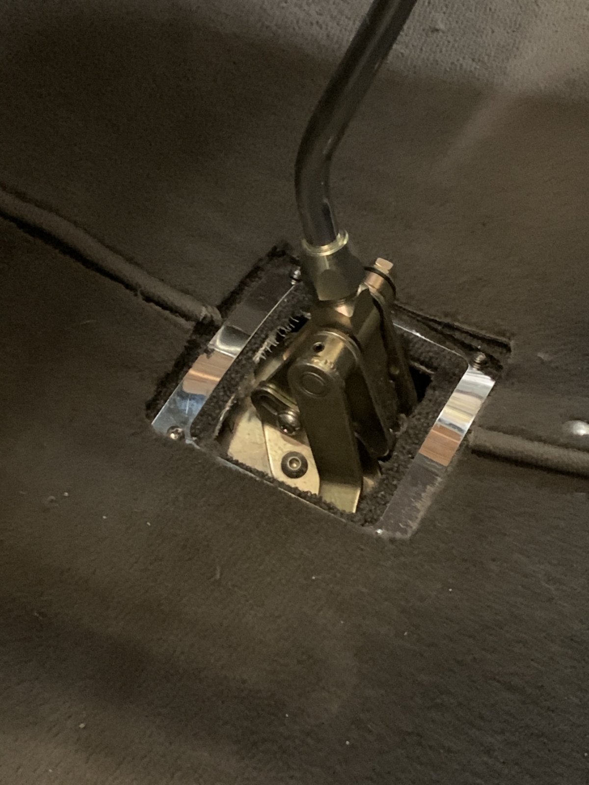

    Installed the boot plate - I needed a certain size plate (not too big, not too small - you know how it goes) and I found a pair on eBay for an AMC or at least via an AMC link ….
    Having this in place will define the mats surrounding it better. Then I can bind them - just using left over grey vinyl ….
    Almost it for today - it’s our anniversary and I was hoping to do the first drive with her once I go around the block once but it’s not to be.
    As they say - “raindrops keep falling on my head” ….. lol!

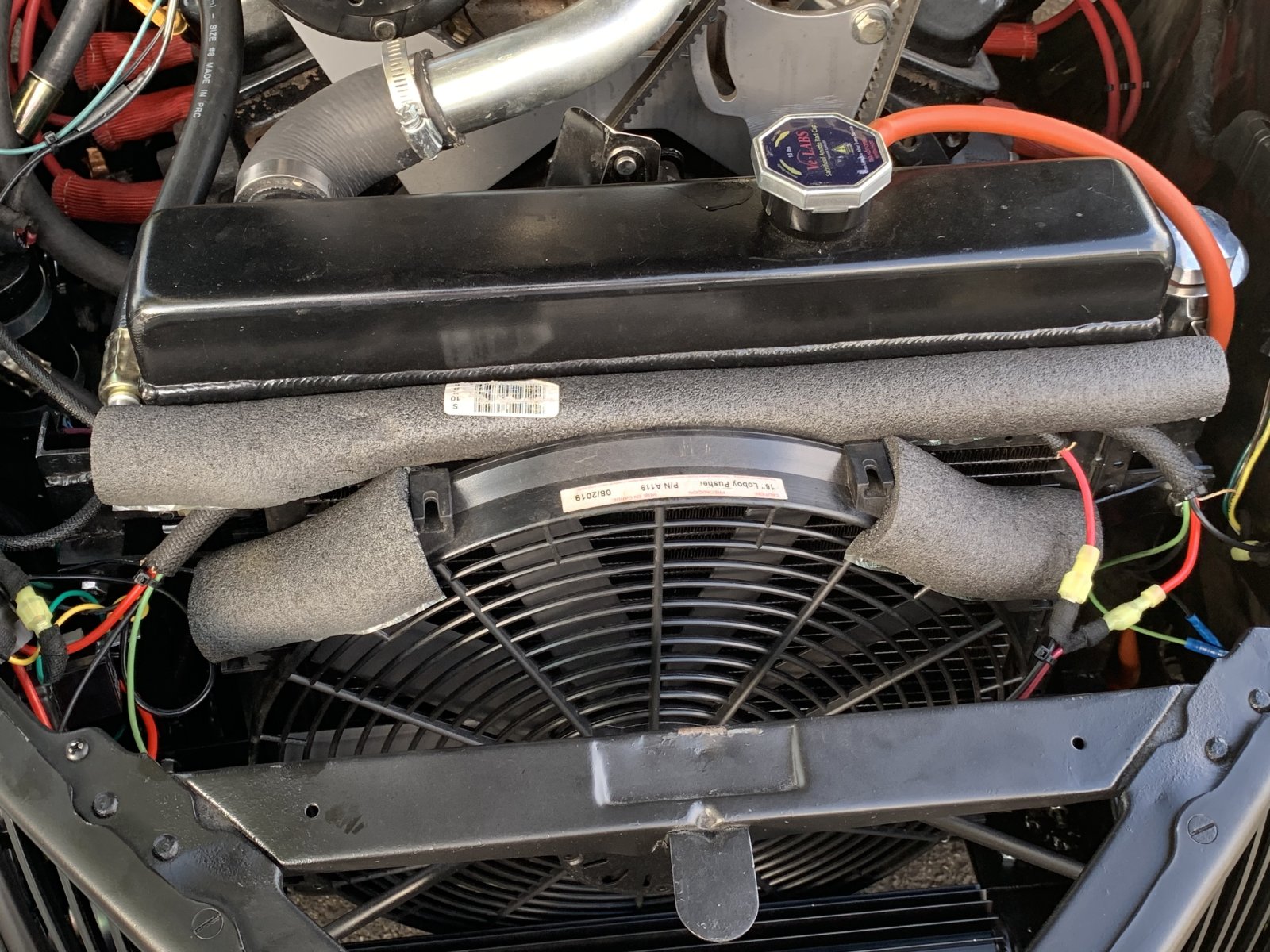

    Got a couple more cruises in before, after, and during the rain we’re having. First I noticed I wasn’t reading any transmission fluid when on all 4s (the motor had to be tilted back for clearance reasons). So after speaking to a couple of my buds, the ****** cooler and the fact that the trans fluid is also running through the bottom tank of the radiator, I am pretty sure I needed to add two quarts from the initial 12 I had in it - 2.5 qts later, I am just registering at the low end of the dip stick. I am thinking either 1/2 to a full qt is still needed.
    First time run up to the gas station my temp gauge registered really high. Got home ok and I found my electric fan was blowing the wrong way - fixed that and the second run up to town and back the temp stayed steady at 180. I have also adjusted the electric fan turn on point so that is another thing to test.

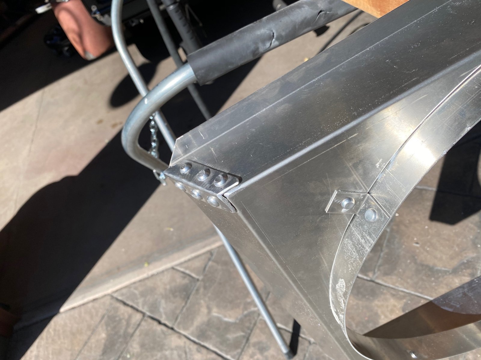

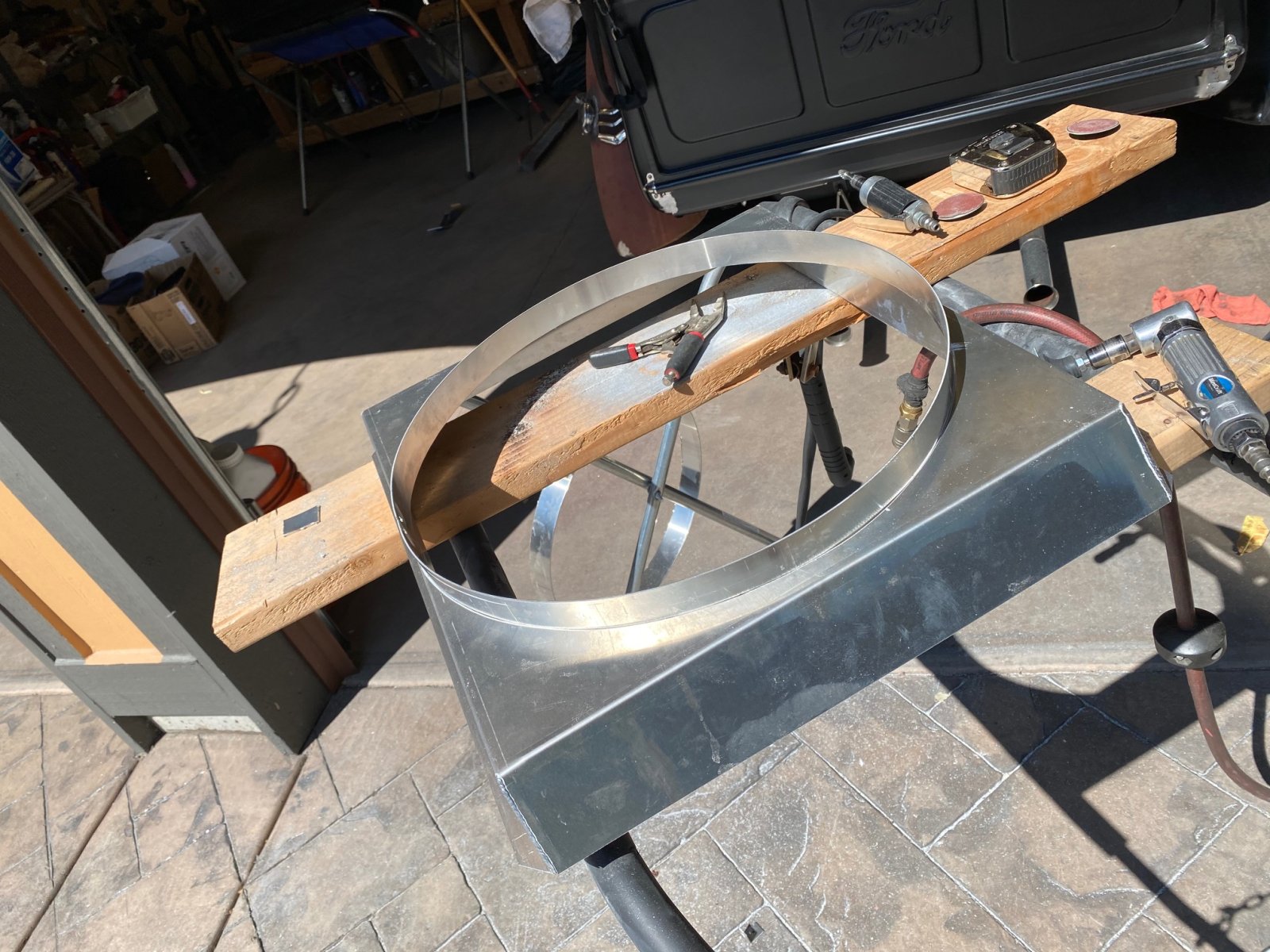

    I did sone blocking of spaces where the fan air escapes before getting big through the condenser and radiator, just three spots along the top. The pipe wrap works pretty well and is not effected by the radiator heat. I had really helped and is perhaps the start of a reversed fan shroud. If you know your 40s they had block off plates on the sides and bottom, with an aftermarket cover for the top. This would be a bit different and would probably mean I would have to use the fan all the time. We shall see what falls out once the AC is charged running …..

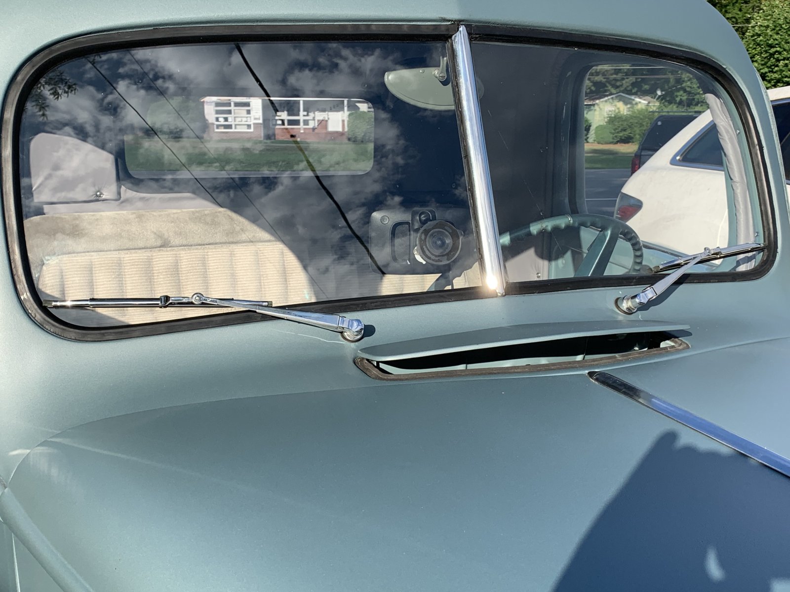

    I also installed the wipers and rainx’d my windshield. Now - go ahead and downpour! Make my day! HA!

    Help me remember why you used a pusher fan? Pusher fans are not known to be efficient.
    Can the radiator be moved forward enough for a fan and shroud behind? That would likely cool better.
    Yes, the cover from grill to radiator would force incoming grill air to go through the radiator, rather than over the radiator.
    Just throwing out cooling ideas.

    Thank you - it is certainly a pleasure to drive that’s for sure. As for the cooling issues, moving radiator forward would be a major job. However I am going to do some measuring and see if I remove the mechanical fan, do I have enough room to mount the electrical fan (I am not losing cooling capability with only a 13” mechanical fan) as a puller with a shroud.
    Let’s see if that is an option …..
    Right now, sometimes she cools just fine and other times, especially in stop and go traffic or having stopped for gas or something, it’s probably at 220 or more and it does not cool down that quickly.

    Cooling is most often a problem when stopped. When moving the radiator has air flow.
    I'd start by removing the pusher fan and see how the mechanical fan cools.
    The problem with pusher fans is they block airflow to the radiator.

    Wide swings are for badonkadonks. I'd recommend a fan shroud around that flex fan. Mine was just a cheap Summitt kit, I dressed it up with braces, rivets and black powder coating.
