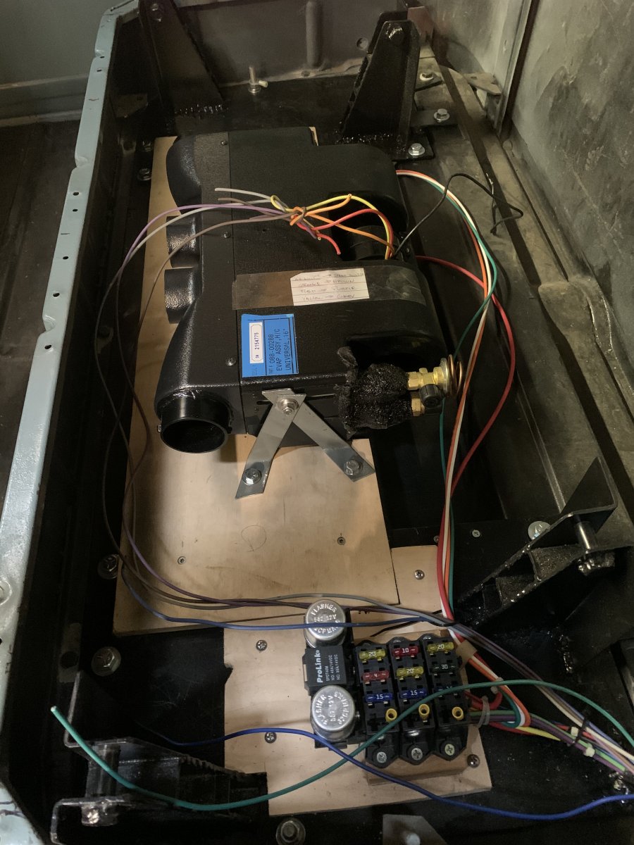

    I mounted an a/c evaporator under the seat like that as an auxiliary unit ages ago. Bad idea since it gives poor air flow to where you need it.

    Goldmountain - thanks for your insight. Where did you have your vents or is it that the unit was not able to pull enough air being under the seat? The under seat area will not be closed off in that there is an opening between the seat bottom and the surround and around the back side .....

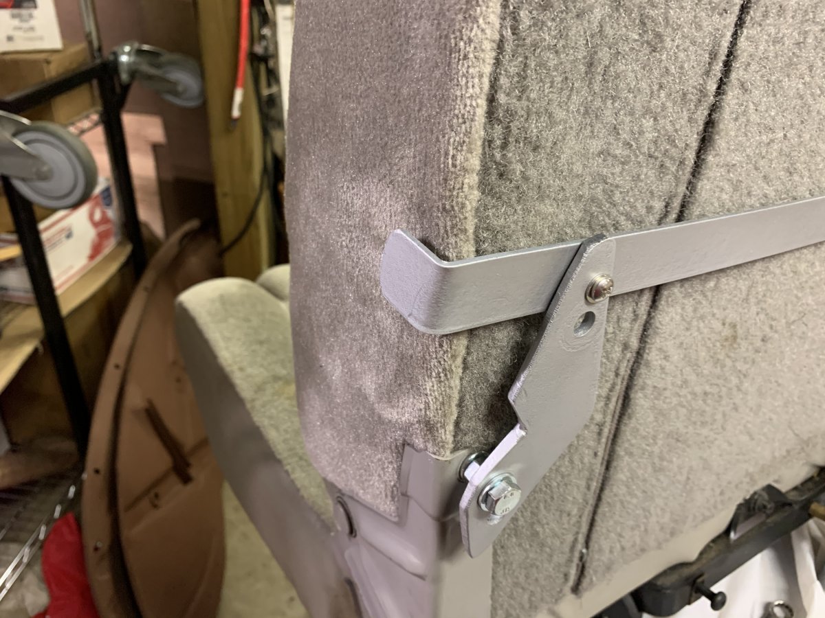

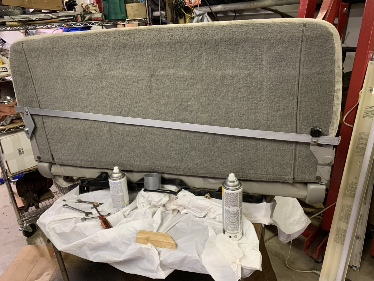

    Working on the truck but sporadically and mostly small stuff. I have also been working on my coupe correcting some things. Clutch was very hard when it should not have been. Made some adjustments and softened it up quite a bit. My third member 3:23 pumpkin was leaking. I pulled it, had it checked over (the crush collar was the culprit), and working on reinstalling it today. Anyway you look at sit I am having fun in the garage.....

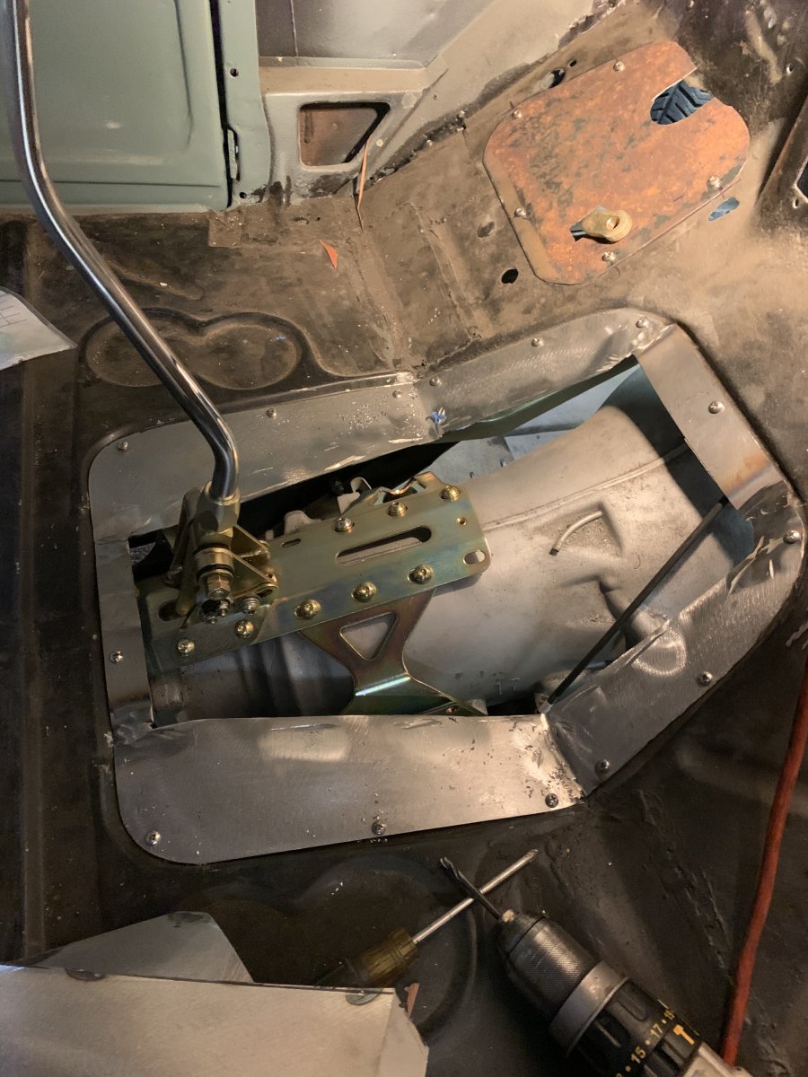

    The seat folds but the release is the only on the p***enger side and tough to get to when the seat is in. Made up an arm for the drivers side and used a metal band to connect them. Now I can release the seat from either side ...

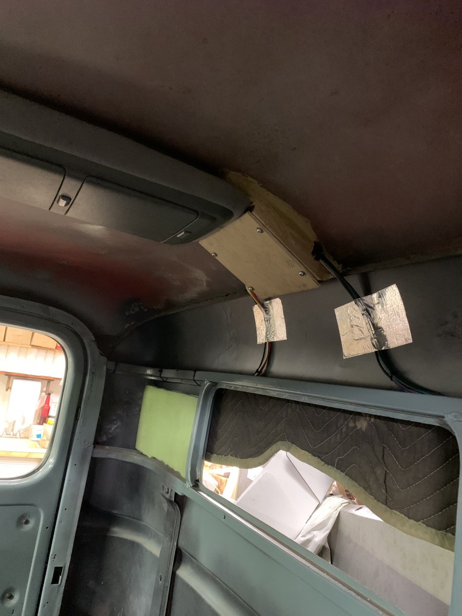

    Well, didn’t get to the gas pedal today but I mounted the ac unit, finished cleaning up the wiring and made a cover plate for the rear console section ...
    Tomorrow is another day .....

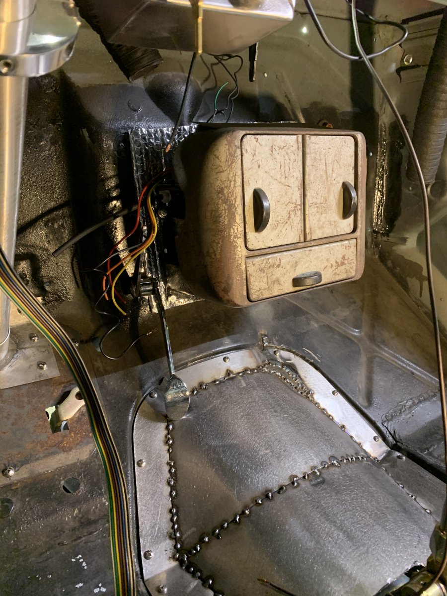

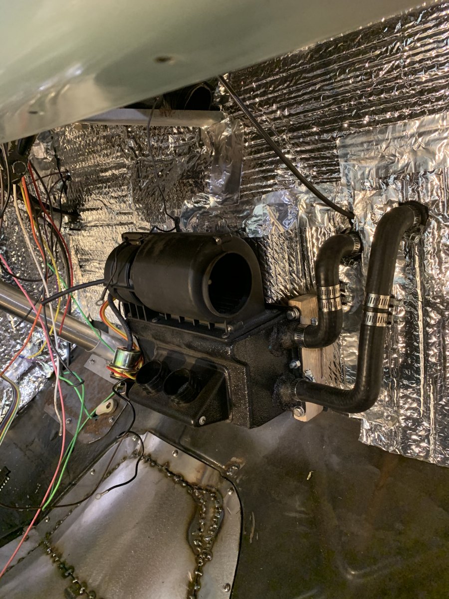

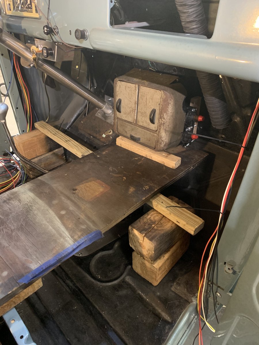

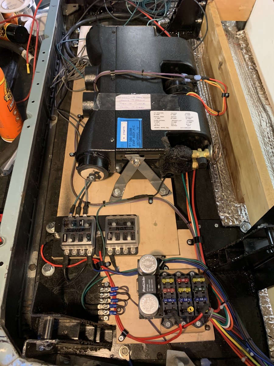

    I have spent the last two days on the heater installation. First, I had to move it to the right so there was room for the gas pedal. In doing so the firewall has a 1.5” indentation into the cab so I needed a block on the right side of the heater. I could not find the bolts I needed for the block side of the heater box install so temporarily I am using all thread which I had around. Now it was time to drill holes into the firewall. Made up a cardboard template with a piece of 1x2 wood on the one side that is 1.5” thick ....
    I drilled one of the three holes for the left side but now I did not have a way to hold the heater up, get it level, and drill the rest of the holes. So, with some s**** lumber I built a shelf to support the heater so I could play with the heater to get it into position ....
    This was supported well enough in the front, back, and in the middle so I could lean on it and do whatever without things moving around. I was able to drill the holes right where I needed them as the shelf was nearly spot on with a shim underneath .....
    The all thread has proven to be a pain but they will come out once I get the correct bolts. I had the heater in and our multiple times checking things and drilling just a few holes at a time until it was done .....
    I put some firewall insulation behind it, ran the vacuum lines and installed the vacuum switch for the defroster on the unit. The heater hose supplied with it fortunately slips inside the stock Ford defroster hose so once I have insulated up under the dash and stuff, I will combine the hoses and reinstall the glove box.
    It seems like I spent a whole lot of time for just one thing but that’s hot rodding. Rome wasn’t built in a day and time is something I have right now so I am just going to keep chipping away at stuff ...

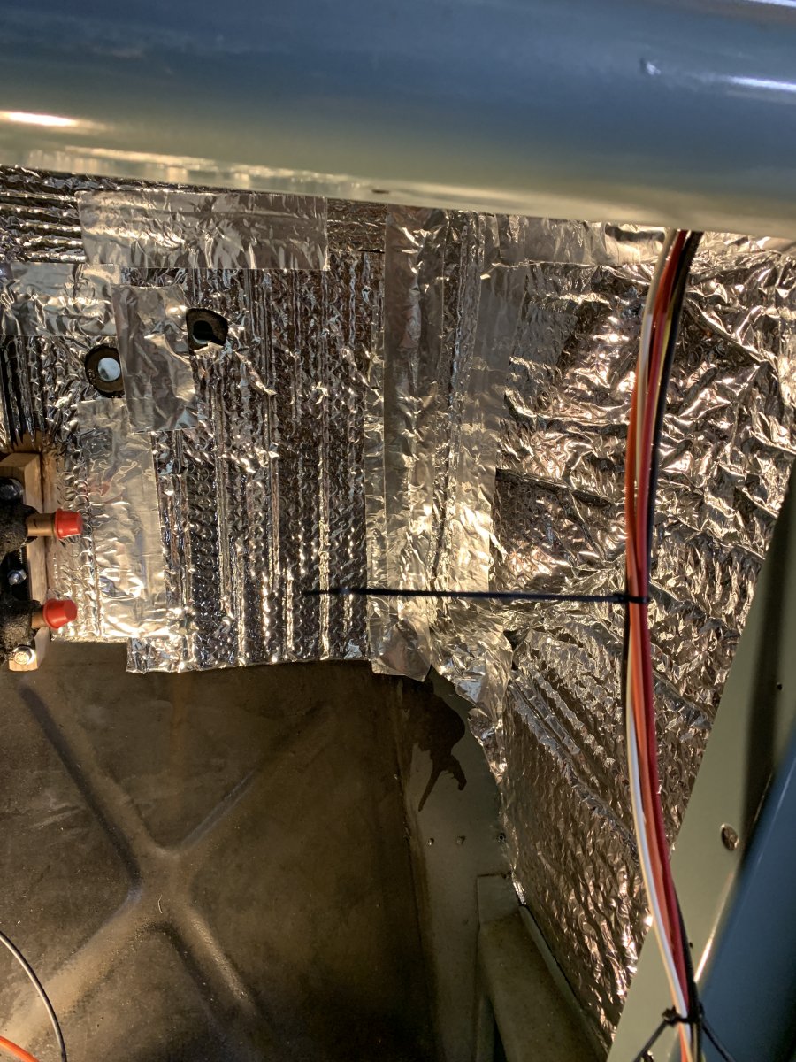

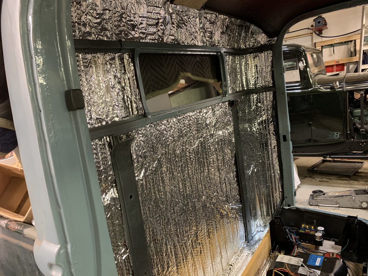

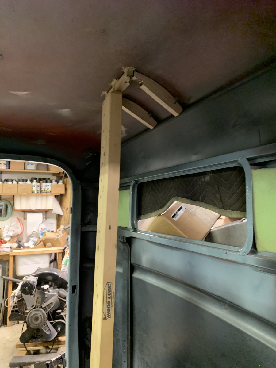

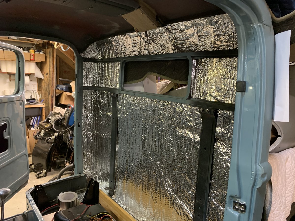

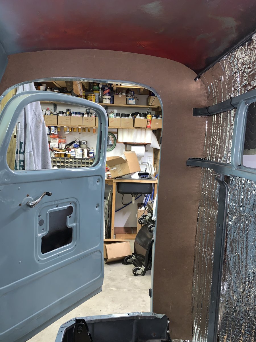

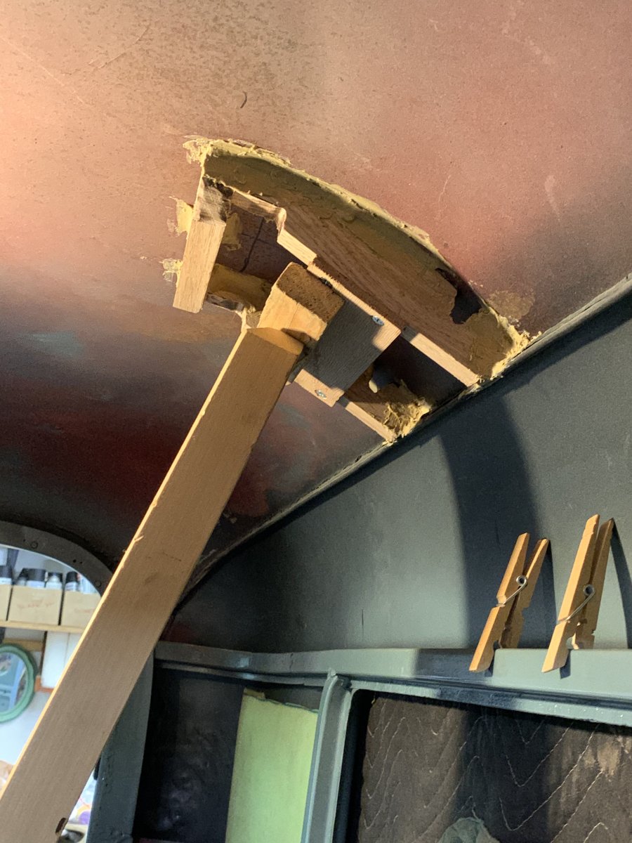

    Been working on the backside of the cab insulating, making a storage tray, and working on interior panels .....
    I am kind of stuck on the cab at the moment as I wait for done electrical stuff, insulation, and a few other things. Insulating the cab got me thinking on where minor stuff could be stored ....
    So I made an area behind the seat .....
    It is not done yet but I walled off the area so things don’t slide around from a short stop or sharp turns. I built a 40 Pickup some years ago and made up panels for around the doors, rear window, cowl pieces, and some door panel pieces which I made templates for knowing I would build another pickup some day. They were rough cut then so I started fitting them to the cab .....
    You have to start with the headliner and work your way down. The door surrounds are tricky but when I did this before, it really looked pretty good and the wife liked it. I will need some upholstery material and padding to complete the look but it is a bit of a dance with the curved cab corners. Future work/pics will tell the tale but I will dig up some pics of the last pickup I did it to .....

    Been waiting for some electrical parts and insulation so I have been working on a honey-do project and sone upgrades/changes to the 32 coupe. Actually the 32 coupe stuff has been pretty time consuming and that and the truck have kept me busy, using the 32 as a fill in time wise. The electrical blocks and insulation has come in but not the connectors I need as of yet. I did install and run some wires to the blocks. My Rebel wire purchase for this project was a while ago with no thought to ac or other items I have added so it’s only a 9+3 fuse panel. The “3” are for two keyed and one hot plug-ins of your choice that would require an inline fuse. I chose the blocks as they have 8 fused ports that can be configured anyway you like. I bought two, one hot, one keyed, installed and ran wires to them until out of time yesterday ....
    The blocks are for boats or cars and come with little labels as well. The Hot port on my fuse panel is to the right, the two keyed middle and left. I used 12 gauge wire to energize the blocks .....
