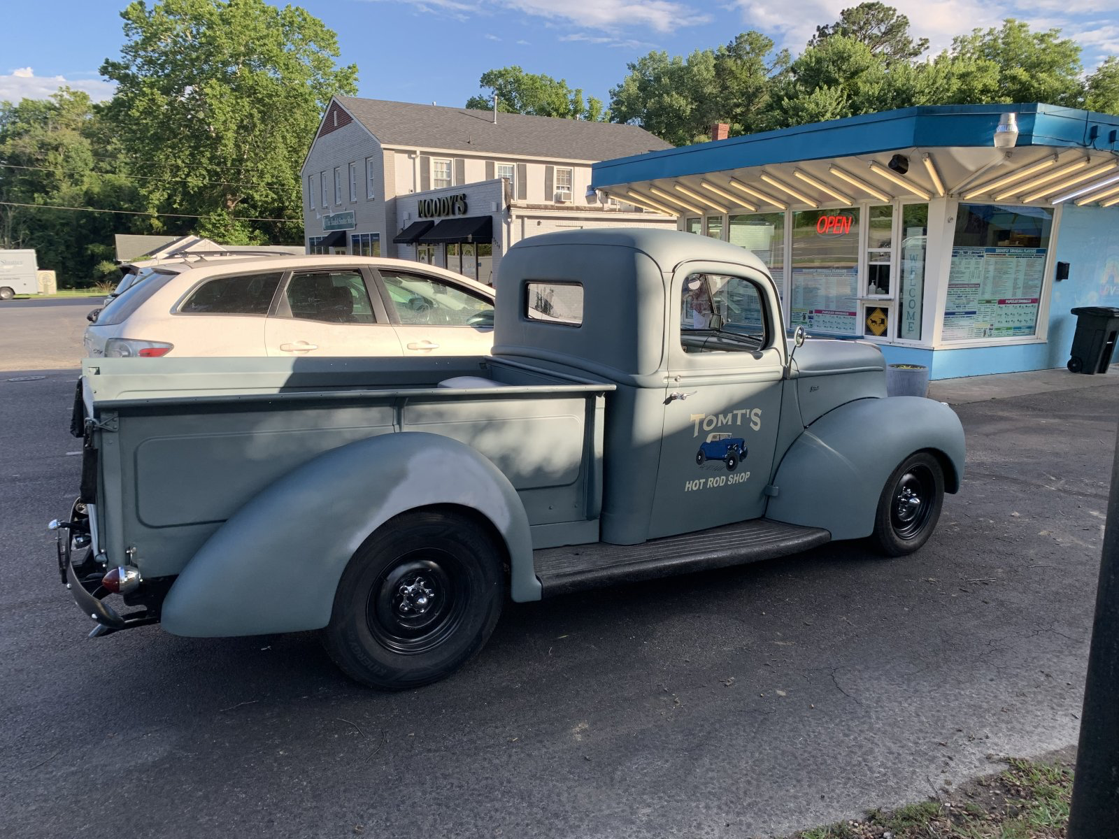

  7. hotrodA
    Joined: Sep 12, 2002
    Posts: 7,791
    hotrodA
    Big day, the first run for ice cream! Who-hoo! Happy for you and the Mrs.!
    Outback, Hotrodmyk, Mr.Norton and 6 others like this.
  8. Bandit Billy
    Joined: Sep 16, 2014
    Posts: 17,206
    Bandit Billy
    Damn that's a fine lookin pickemup! Good on you Tom! Don't get a DWI (driving while icecreaming)

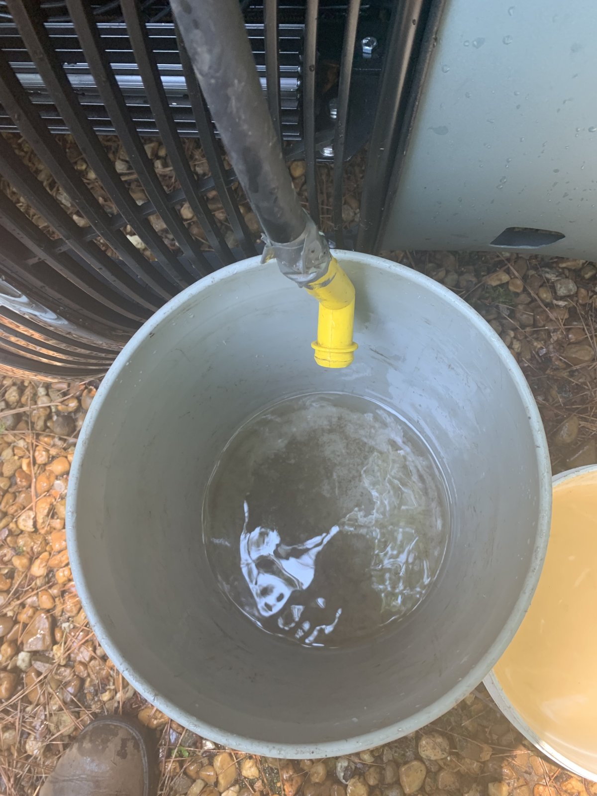

  10. TomT
    Joined: Dec 11, 2003
    Posts: 4,682
    TomT

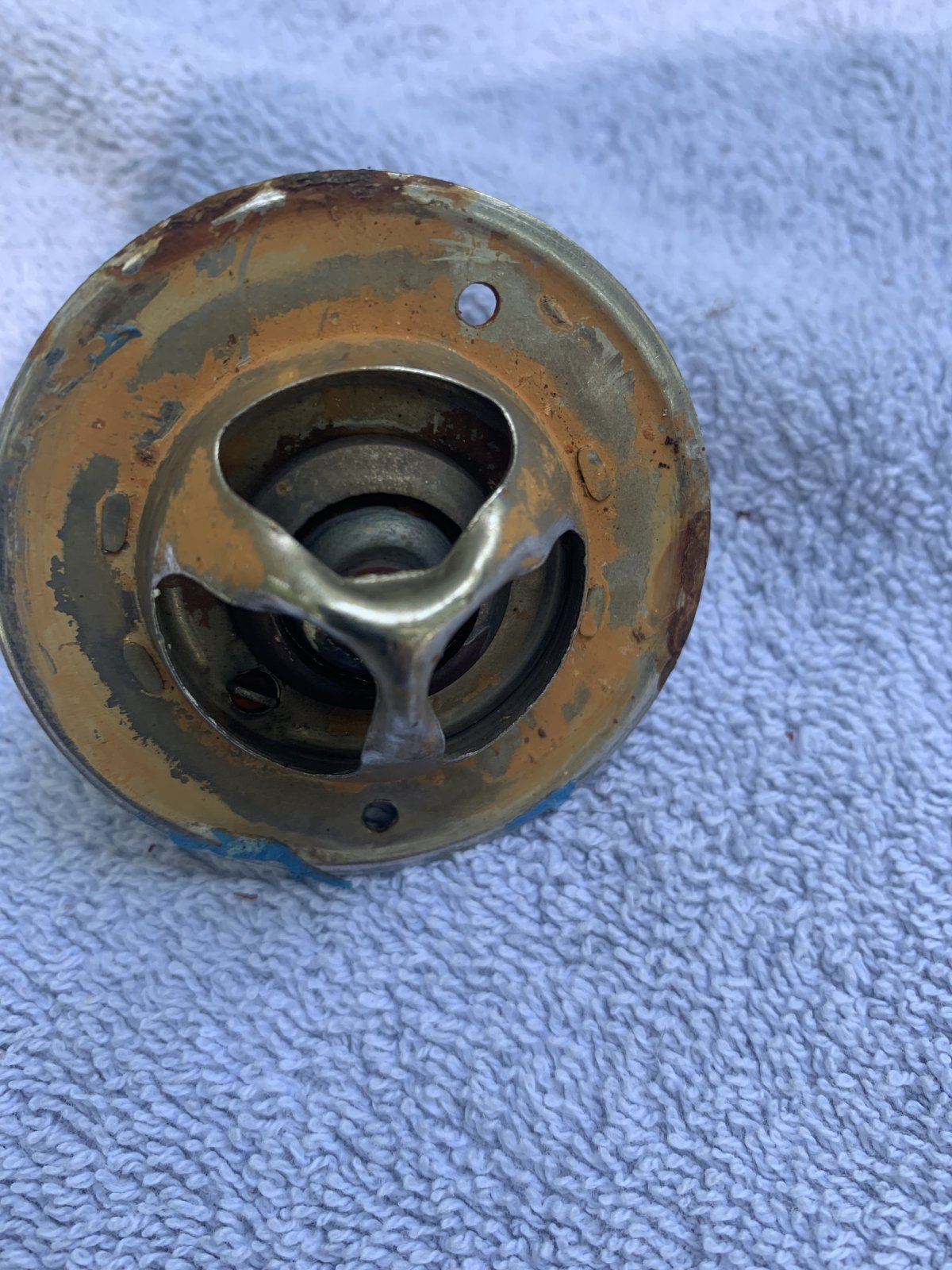

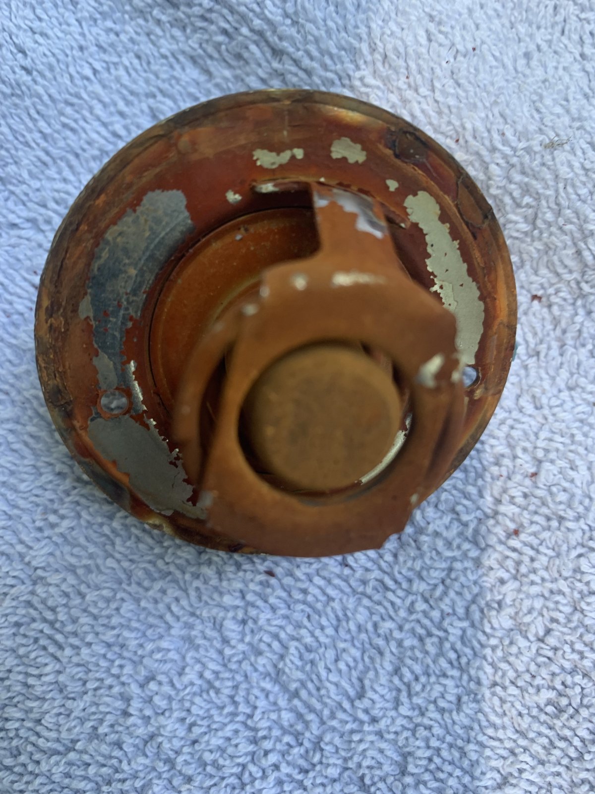

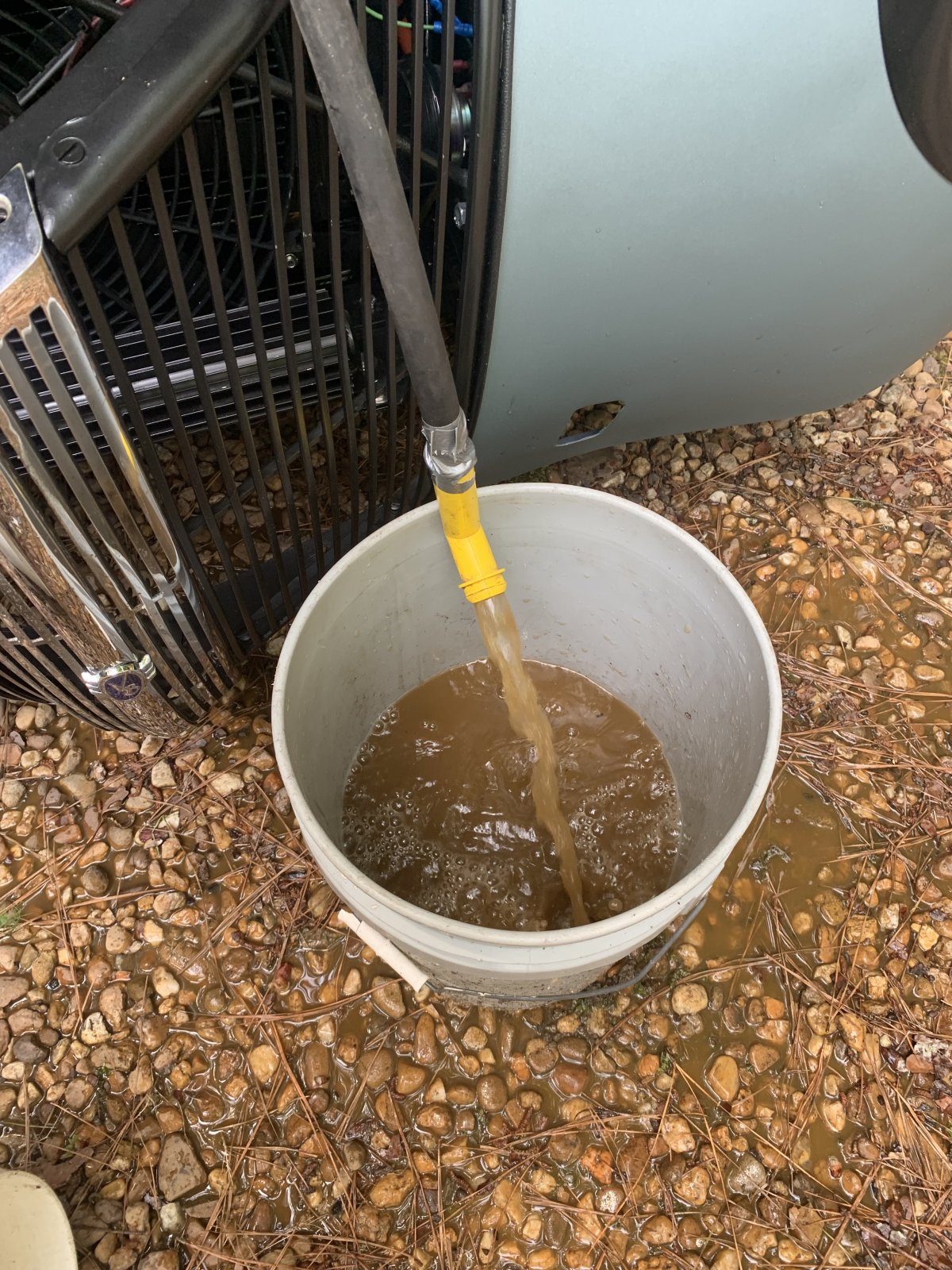

    Continued to drive around and in the truck Sat and s Sun with real feel temps 95-100. On my last DWI (Bandit - lol!) the truck (which my wife has named Pearl) got around .240 . I pulled into a church parking lot where a wedding was about to go on - waited about a 1/2 hour, and when was cool enough to drop be home just about the time the wedding began. So with the thermo in, this was after about 4 gallons running through …,
    It was really brown. After about 12 -15 buckets of water running through she was still a light brown. The engine was running and the heater on but the engine never really got hot. I removed the thermo and after about 6-8 more buckets, here’s what I had ….
    That looked really good to me so I consider my flush complete. Btw, here’s a pic of their thermo ….
    Needless to say, I have ordered a new one and it will be in sometime this week along with a 16 lb rad cap with sacrificial diode for a coolant recovery system. Once back in the garage I will empty the rad and remove the lower rad hose to empty out as much water from the system as possible and mix up 4 gallons of 50/50 (from concentrate) and I will keep you informed. It will be a few days so I will be working on a few items while I wait for parts …..

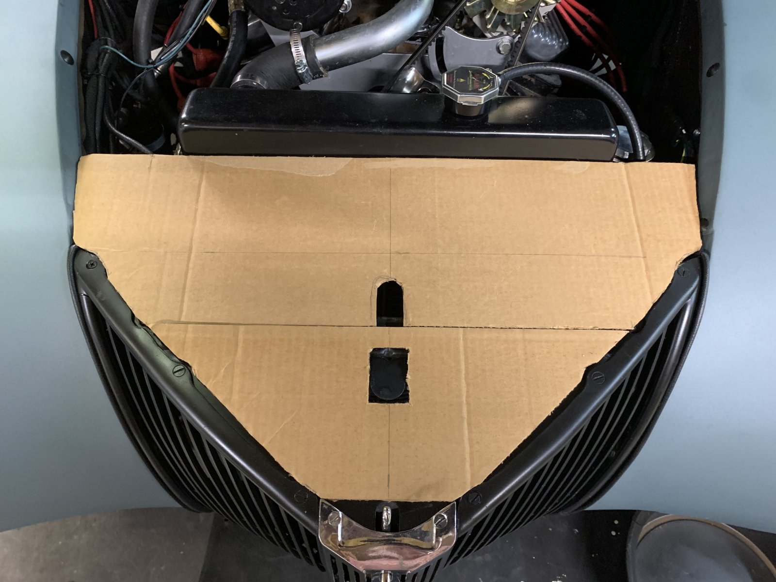

  23. TomT
    Posts: 4,682
    TomT
    Template for a top cover …..
    …. just have to come up with some material to make it out of. What thickness have you guys used?
    '28phonebooth and pprather like this.
  24. Bandit Billy
    Posts: 17,206
    Bandit Billy
    I think 2 ply cardboard is plenty thick.

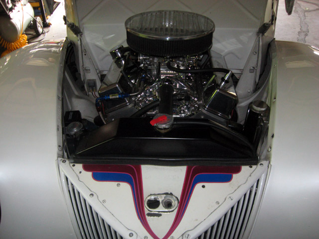

  27. The 39 guy
    Joined: Nov 5, 2010
    Posts: 3,846
    The 39 guy
    Hey pprather, that's my old 39. Can't say I built that plate though. It has been working well for well over 20 years.
    You do need the baffle plates on the sides though to make the air p*** through the radiator. I make my plates out of 19 ga. steel but aluminum or stainless steel works well also.
    Because of Toms radiator his side plates will have to include more bend than the stock style radiator side plate.
    The side plates can be pretty simple. These were just made for my 39 out of 19 gauge steel.
    I highly recommend a shroud like this. This is the one we built for my 40.
    We had less room to work with on my 39 so went with a different (low profile) fan on this one.
    The shrouds are made from 19 gauge steel. You can see how they are were made in my build
    threads.
    http://www.jalopyjournal.com/forum/threads/a-40-ford-coupe-for-uncle-mike-build-thread.949053/
    https://www.jalopyjournal.com/forum...an-resurrection.1204912/page-11#post-14913590
    Tom, I know you will figure this out. You have succefully solved so many problems already. This is just a bump in the road.I know how frustrating it can be to have a Hot rod that constantly overheats. My modifications are not perfect but they keep the temperatures tolerable in high 90's weather.

  29. The 39 guy
    Joined: Nov 5, 2010
    Posts: 3,846
    The 39 guy
    Here are some pictures of the bottom plate or air dam. If you don't have one these the pictures
    will give you an idea of how simple they are. You should be able to make something similar to fit
    your application. The mounting holes are the same ones used for the radiator mount on the frame.
    two more holes in the front attach the dam to the bottom of the grill. Don't forget to leave a drain hole
    for rain water.
    I cut most of mine off to allow easier accesses to the radiator drain and bottom hose.
    You can see there a few places for rain water to flow out but most of the incoming air
    has just one way to go.
    Hope this is helpful Tom. feel free to delete all of these pictures when you are ready as I
    don't want to mess up your build thread with my stuff.
    Sam
