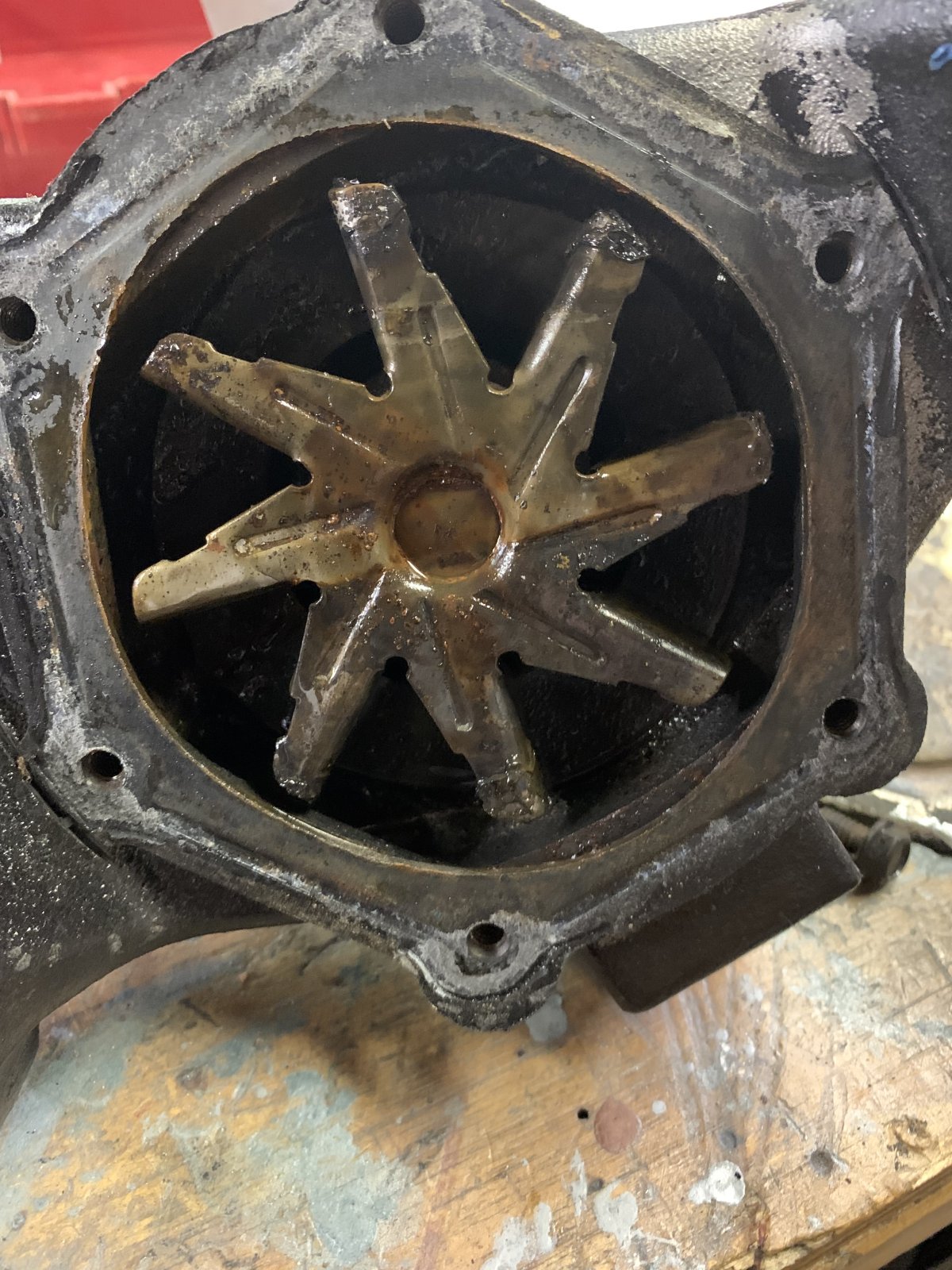

  10. TomT
    Joined: Dec 11, 2003
    Posts: 4,682
    TomT

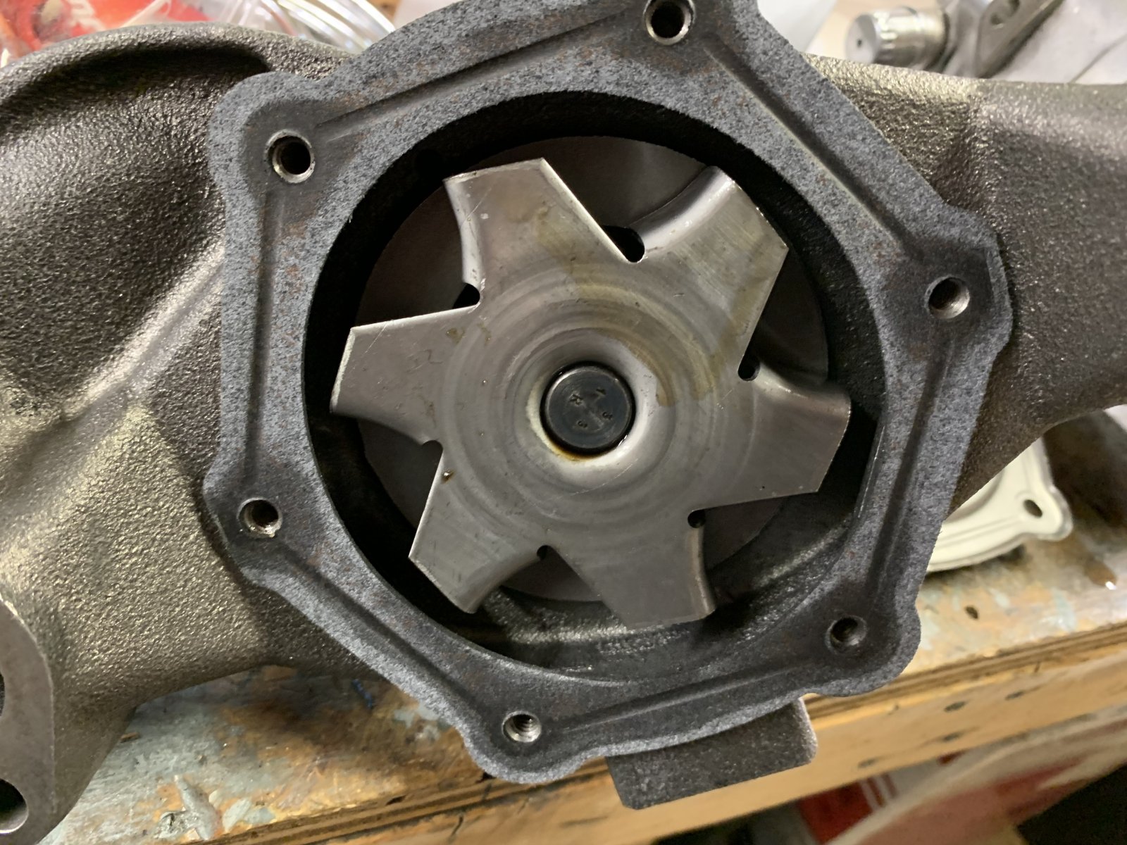

    I had another sbc swp lying around and I opened up the back of it ….
    … this looks to me to NOT be a reverse flow wp. So, once I am up and about again. I will install this one.
    Once the old one is off I will open it up as well ….
    One less thing to be questioning …..
    brEad and lothiandon1940 like this.

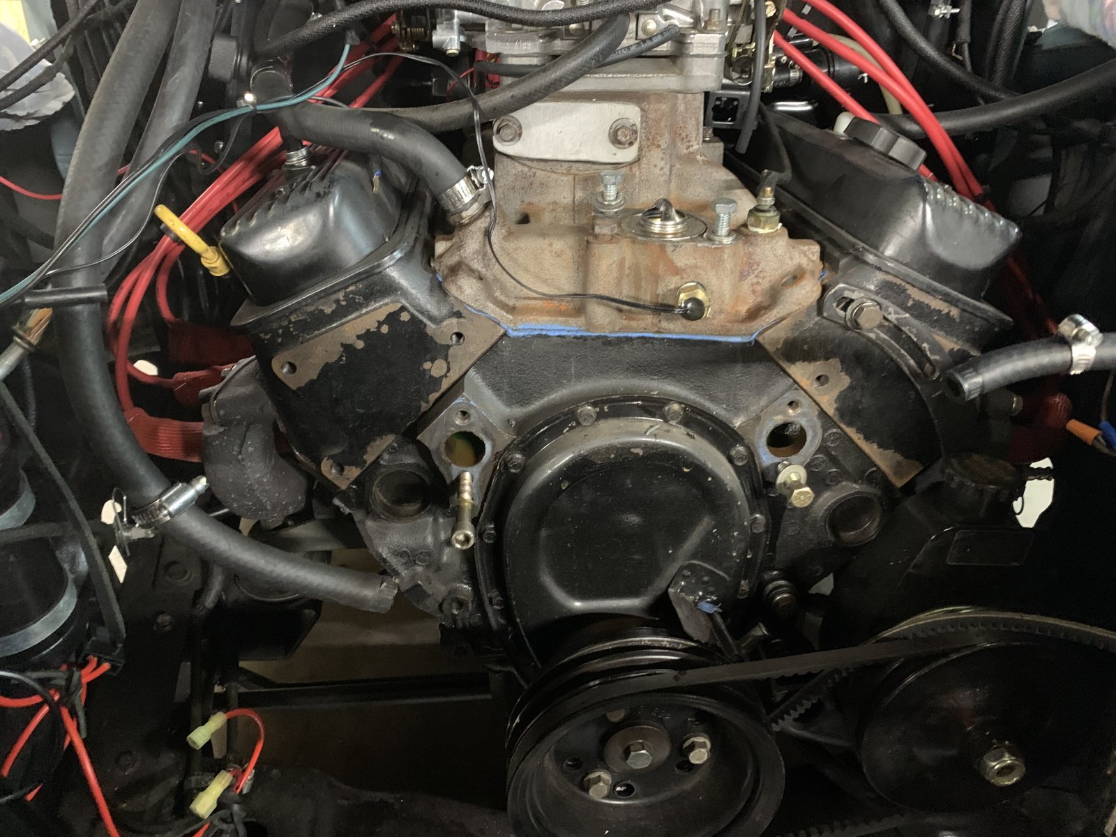

    So it’s my first day back in the garage - dropped the antifreeze and began pulling things apart:
    … and I have found my problem ….
    … and the pump is/was the issue. I guess this is what a reverse flow water pump looks like. My previous post is what I will be installing. I have done about all I can do today and will start re-***embling tomorrow.
    I am glad I started with the pump! Saved a a step or two I think ….
    brEad, pprather and lothiandon1940 like this.
  12. Bandit Billy
    Joined: Sep 16, 2014
    Posts: 17,216
    Bandit Billy
    Am I missing something or are both those pump blades moving water the same direction?
    milwscruffy, joel and TomT like this.

  14. TomT
    Posts: 4,682
    TomT
    Bandit - you are probably right - I just do not know what the first one is to be truthfull!

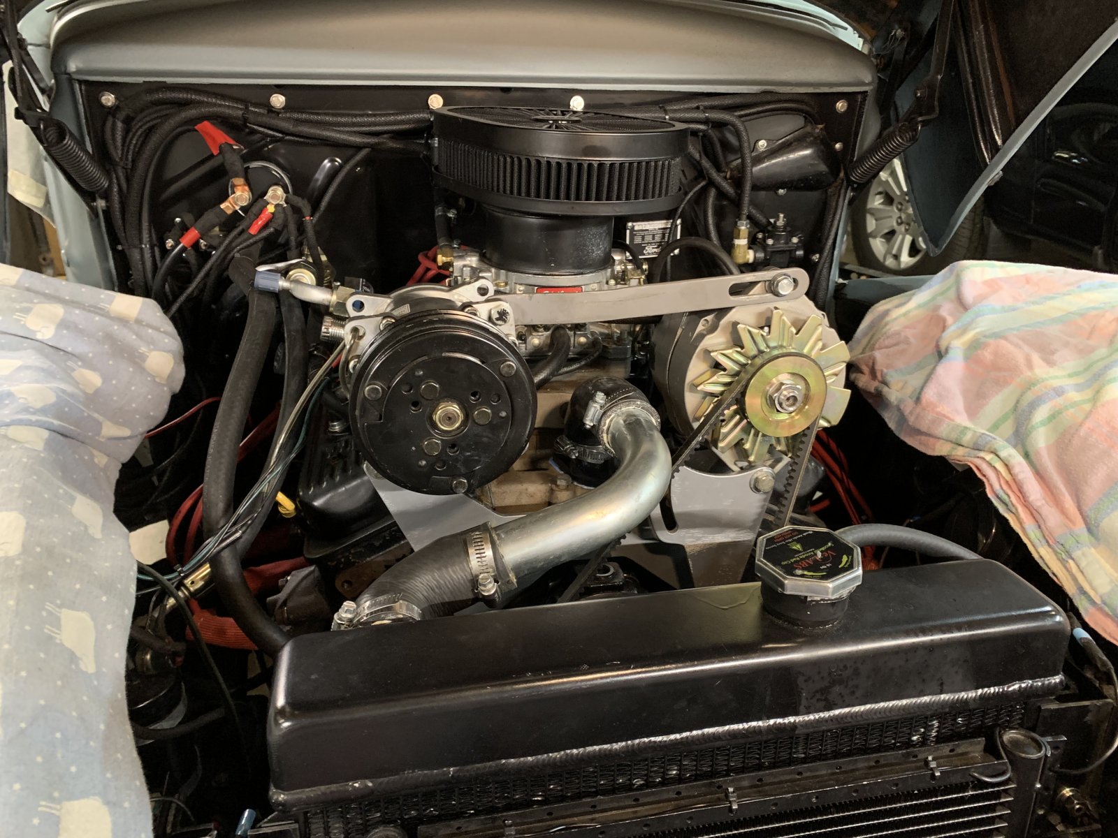

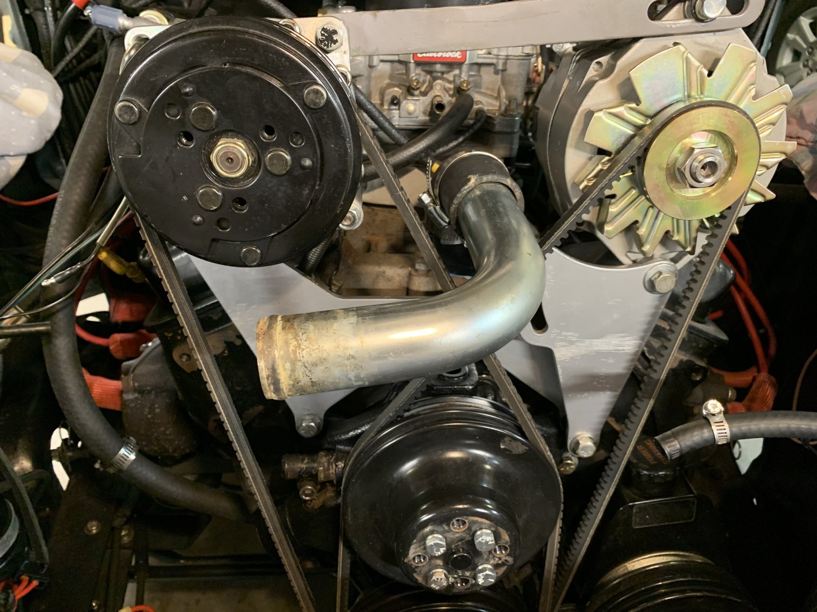

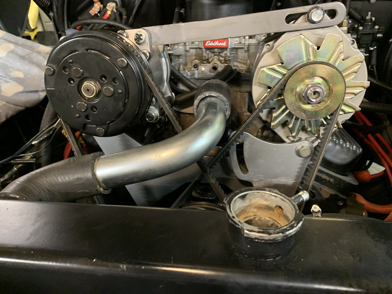

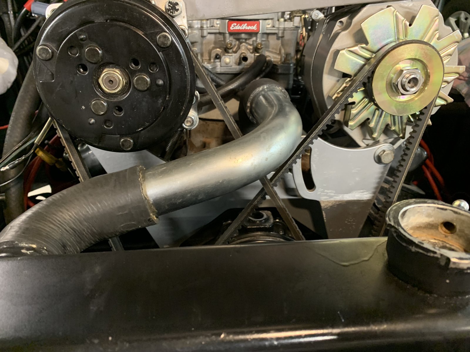

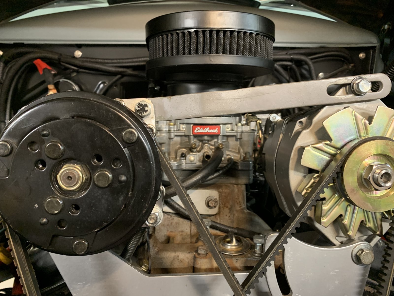

  16. TomT
    Posts: 4,682
    TomT

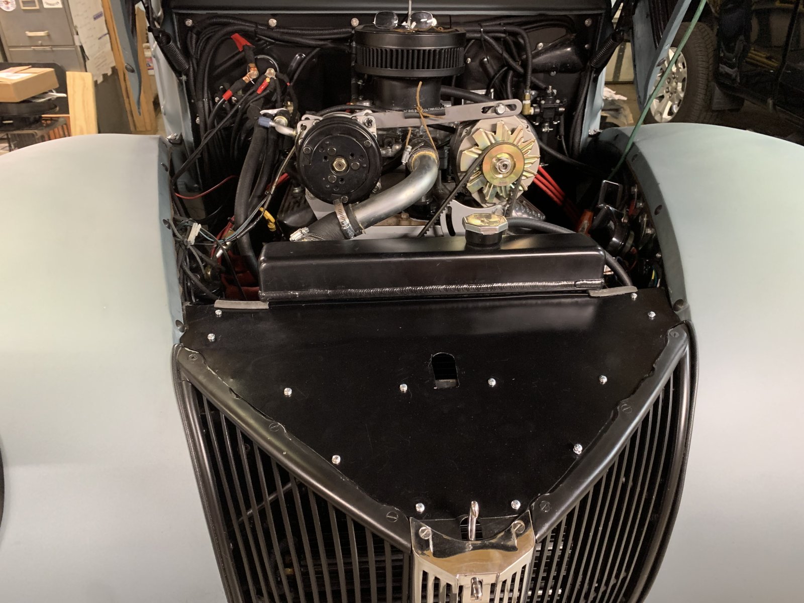

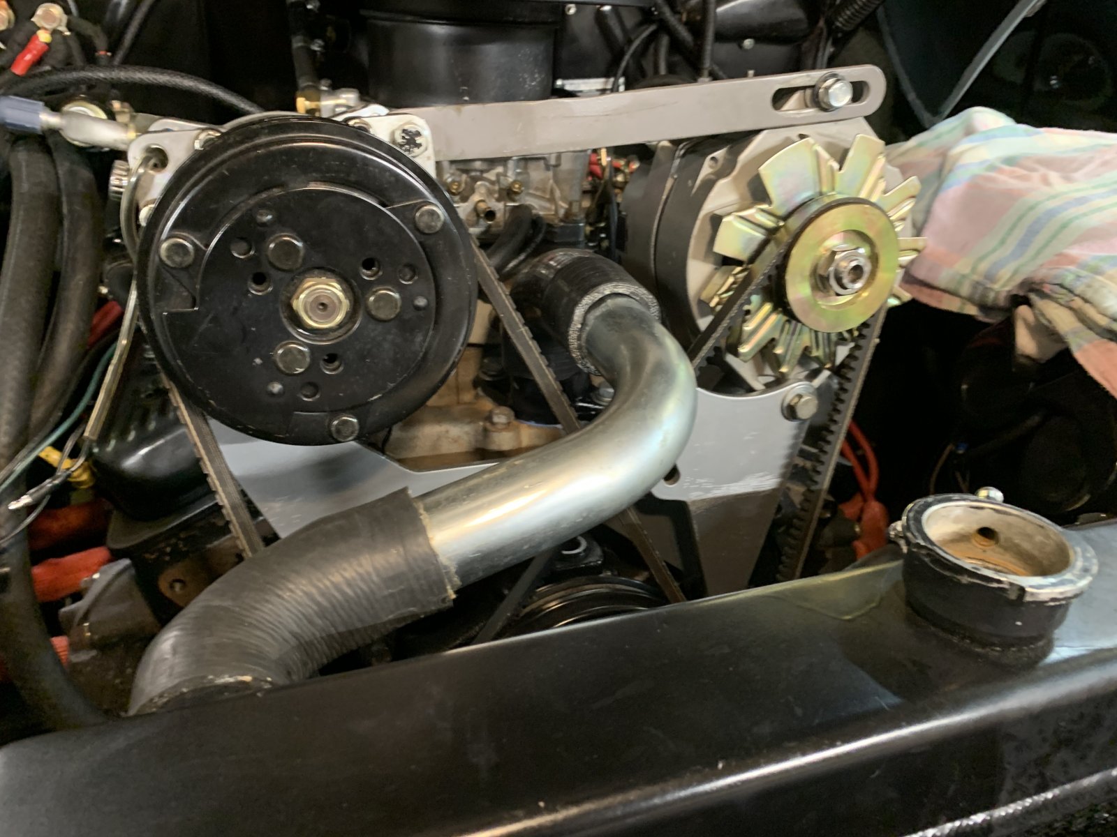

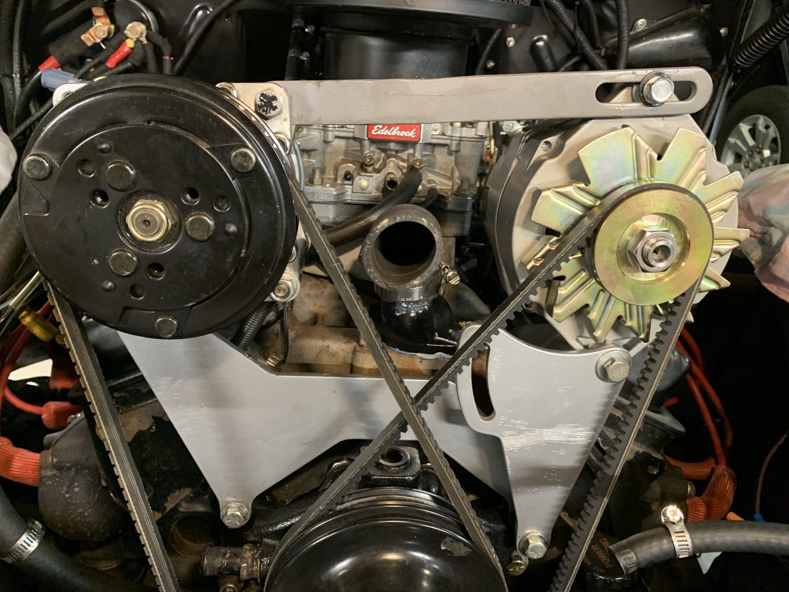

    Got sone time to out things back together. Once tge alt and ac compressor were in I thought I would put the belts on good and tight and see about upper hose clearance getting them engine and rad on the same plane …
    so from this pic you can see thexangle neck thermo housing was mot going to work. I then stayed with the non chrome housing I recently installed ….
    And experimented on how it would line up …
    I then installed the radiator ….
    … and I then changed some rubber hosing around for the best fit ….
    This is the best I could come up without major mods so this is a go for me. I will keep plugging away at it when I can and fo a test run ….
    By the way, the hose is down from where it was …
    The 39 guy, brEad, loudbang and 2 others like this.
  17. 40FORDPU
    Joined: Mar 15, 2009
    Posts: 4,066
    40FORDPU
    I'd plug that front PCV port on your carb, if you're not using it.

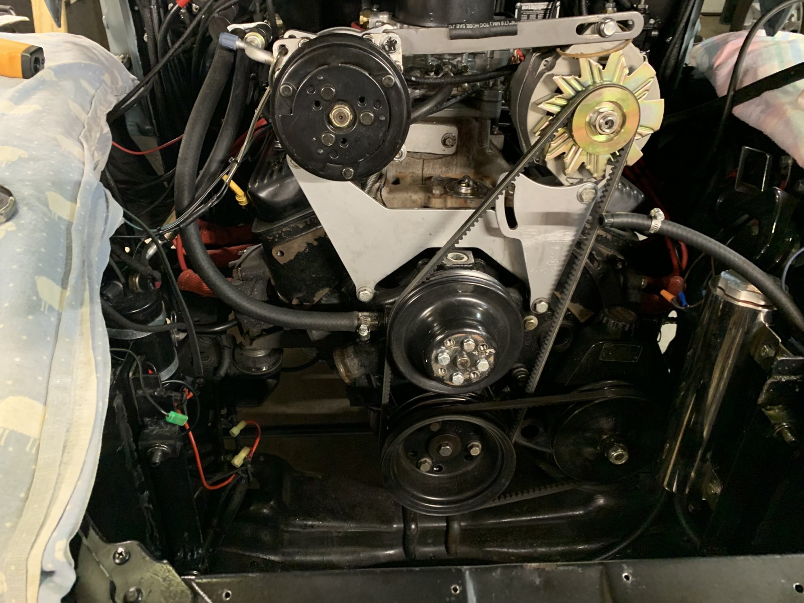

    Finally got some garage time in to start putting things back together ….
    Yea, I know, it doesn’t look much different but I am getting closer …..
