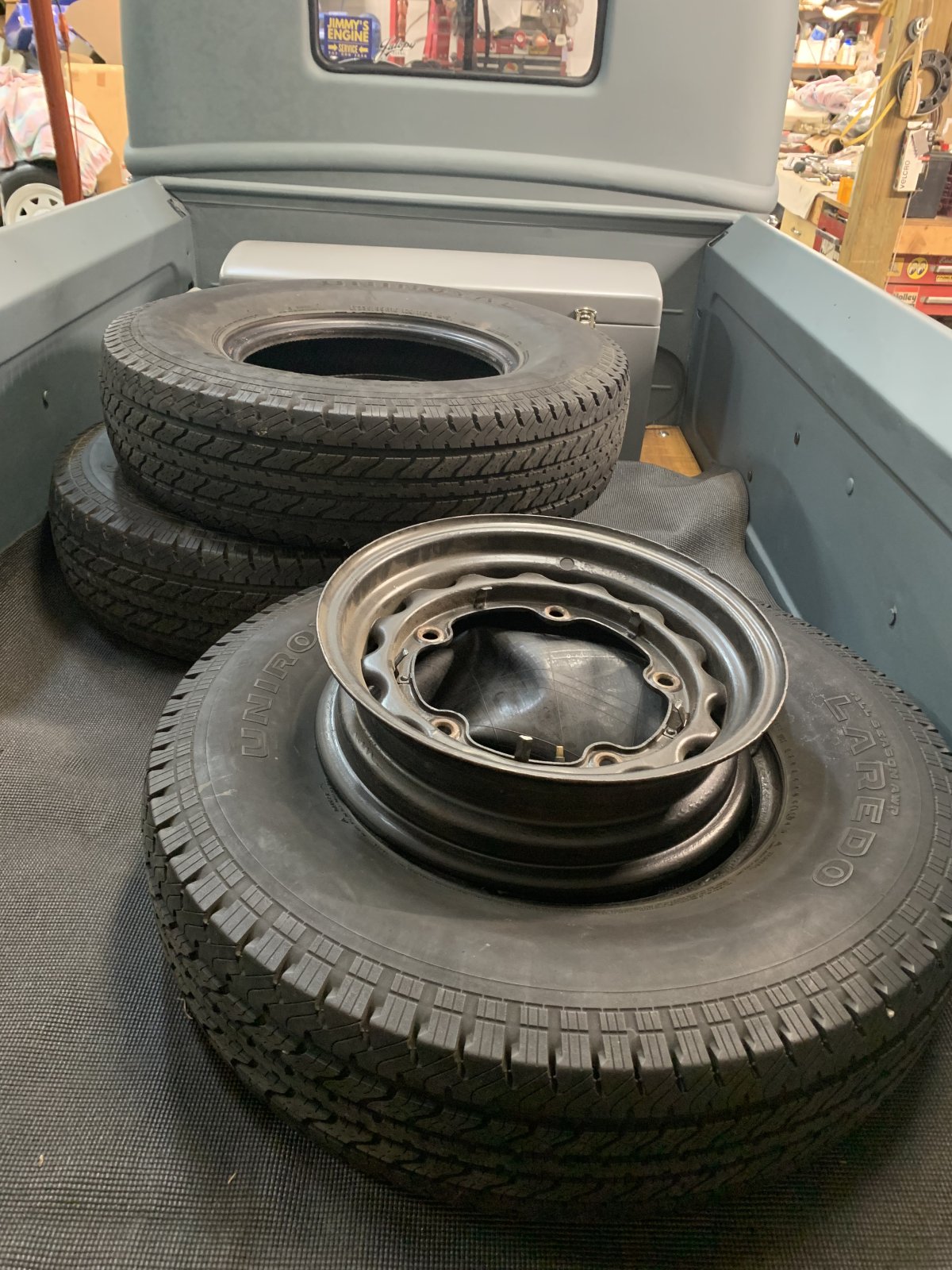

    Took the truck out again today to pick up tires I had dismounted at my buddy’s place. It’s a truck, right?!
    It ran great, temps never got above 140, I scooted along at 55-60. No over heat issues at all and my buddy also adjusted my tv cable so the truck was not so lethargic and I actually had a p***ing gear! Of course, once the heat is back all may not be so rosie but we'll cross that bridge when we get to it. I am just tickled to death it’s running so nice now! I will post a pic tomorrow of my “haul” - lol!

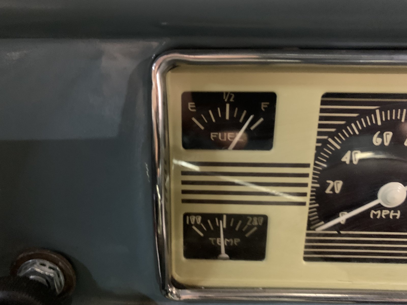

    I'm a little unsure how it could run 140, when it has a 180 thermostat. The thermostat will stay closed until the water temp is 180 degrees, give or take.
    Where is the temp gauge sensor located?

    X38
    140? That's cold. Not really optimal power or economy, or good for engine durability. As above, where is the temp sensor and maybe the accuracy is questionable???

    Measuring temp near the thermostat housing is good, for accurate measurement. BUT, I'm still not sure how a 180 thermostat will allow the engine to run at 140 degrees.

    Ok - the vertical sensor that is located right front of the intake is for the temp gauge while the one in the front of the intake is the fan sensor. My temp gauge reads from 100 to 195 at the apex then to 180 completing the 180 degree sweep of the gauge. Throughout today’s ride my gauge never read above midway between 100 and 195. At one point I pulled over and checked temps around the vertical heat sensor - 140-145 - the horizontal sensor read 165-170 and the top tank of the radiator, 177. And no I have not changed when the fan turns on so it is still coming on early. My gauge temp stayed in the same location all day regardless of speed or more stop and go. To be truthful, I was happy it was not puking, the overflow tank did not overflow, and there were no antifreeze leaks anywhere. She ran like a top, idled nice, and after my good friend Koppy checked and reset my TV cable (I am running a 700 with no lockup), there was no lethargy/sluggishness during acceleration had p***ing gear - everything is coming together and I feel like I can now jump in it and go whenever I want with less and less fear of problems.

    If your gauge is reading midway between 100 and 195 after the engine is warmed up, either:
    1. The gauge is not accurate
    2. The sender isn't touching the hot water that should be flowing past it.
    Does your kitchen have a thermometer like for cooking a turkey or making candy?
    If so, when hot, if you can open rad cap you should be able to hold the tip in the hot water to get a reading. If unable to open cap. Maybe sneak it between the fins at the top of the radiator.
    Your engine should run above 140, even with the fan running constantly. It should run over 140, even with no thermostat.

    Popped the radiator cap and put in a meat thermometer, started it up and waited until the meat thermo hit 190. I then adjusted the fan to go on - at that point my thermo water temp was nearly 200 when it kicked in and gauge temp was on the second mark past the apex of 195 on my gauge. Fan brought the temp down to 185-190 at the tank neck and shut off and my temp gauge was reading 195. My best guess my gauge reads 10-12 degrees higher than actual temp. I removed the thermo, installed the cap and went for a spin. My gauge read 195+ (meaning almost to the next gauge mark beyond the apex) and the fan kicked in. Btw - thermo temp and heat gun temp about midway of the top tank were nearly the same
    So, going by the gauge, 195 is actually 180-5. I go almost to the mark beyond the apex, fan kicks in and the gauge temp drops below 195 initially then seems to settle at the 195 gauge temp. It was pretty warm out today - 55+ - but windy. We will see how she runs at cooler temps. I feel I am pretty close to where I need to be right now …..

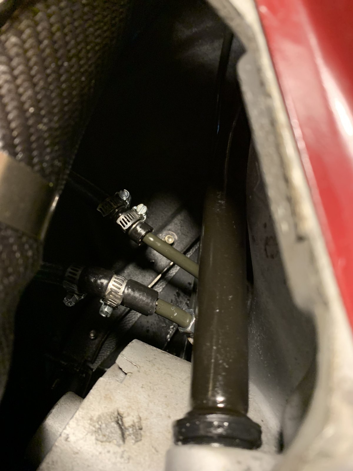

    I have bren getting in a lot of driving time going further and further out from home. All WAS going well until I started getting smoke in the cab. The ****** was acting funny and I was just 5 mikes from home. Next traffic light in downtown Col Willyburg she would not move. Thought the ****** was toast but then I noticed the one rubber return line to the ****** had popped off the metal line dumping a bunch of fluid. My buddy Koppy got me home and in the garage where she stayed until today (been interior house painting). Finally got it up in the air and noticed I had not flared the ends of the metal lines coming out of the ******. My bad …. but there was no room to do anything like that. So, I reseated the rubber lines way up into the metal lines and double clamped them. That’s the best I can do for now but they are way tighter than before ….
    Good thing I am short and have small hands or I would have had to drop the exhaust pipe …. that will probably be done next winter.
    Hopefully some fresh fluid and a test run will prove all is well ……
