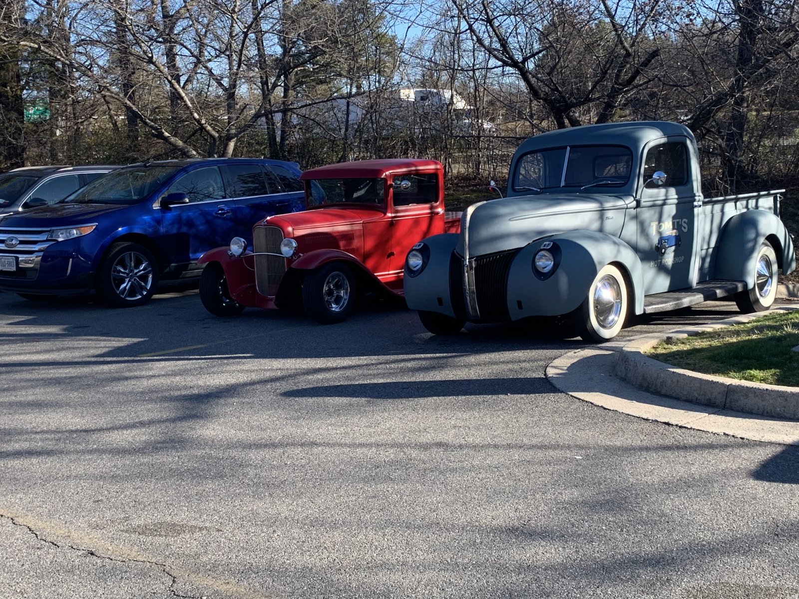

    Went to the show today - left at 6:15 and 32 degrees. Temp gauge never went above 120-130 degrees - I guess I should have blocked off a part of the radiator - taking the road less travelled worked out pretty well. No runs, no hits, no errors as they say save for gas milage at around 12-13 mpg and my radiator shrouding loosening up again and rattling. Need to try and tune it better and install rivet nuts in the sheet metal surrounding the radiator.
    The truck was pretty well rec’d especially tge wide whites and caps ….
    Biggest thing was how well the truck ran and running temps going home in nearly 50 degree weather had the temperature in the more normal range, from 160 to 190 depending on speed, with the fan going on and off as it should. Cruising at 60 she was around 160 and at 70 with hard acceleration to get on the interstate for 7 miles she got up to around 190 but no more. More items added to my punch lust but a good day for sure ….

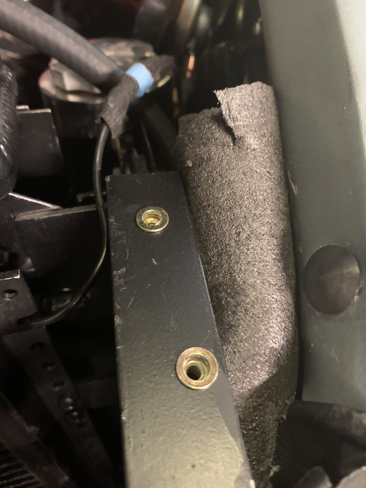

    Gotta say - the truck has been running great. So good in fact I decided to put it up on stands to finish off my punch list of items yet to do.
    So,
    - fixed the horn
    - centered the steering wheel
    - Adjusted the bump stops do there’s no ps squeal
    when going full left or right

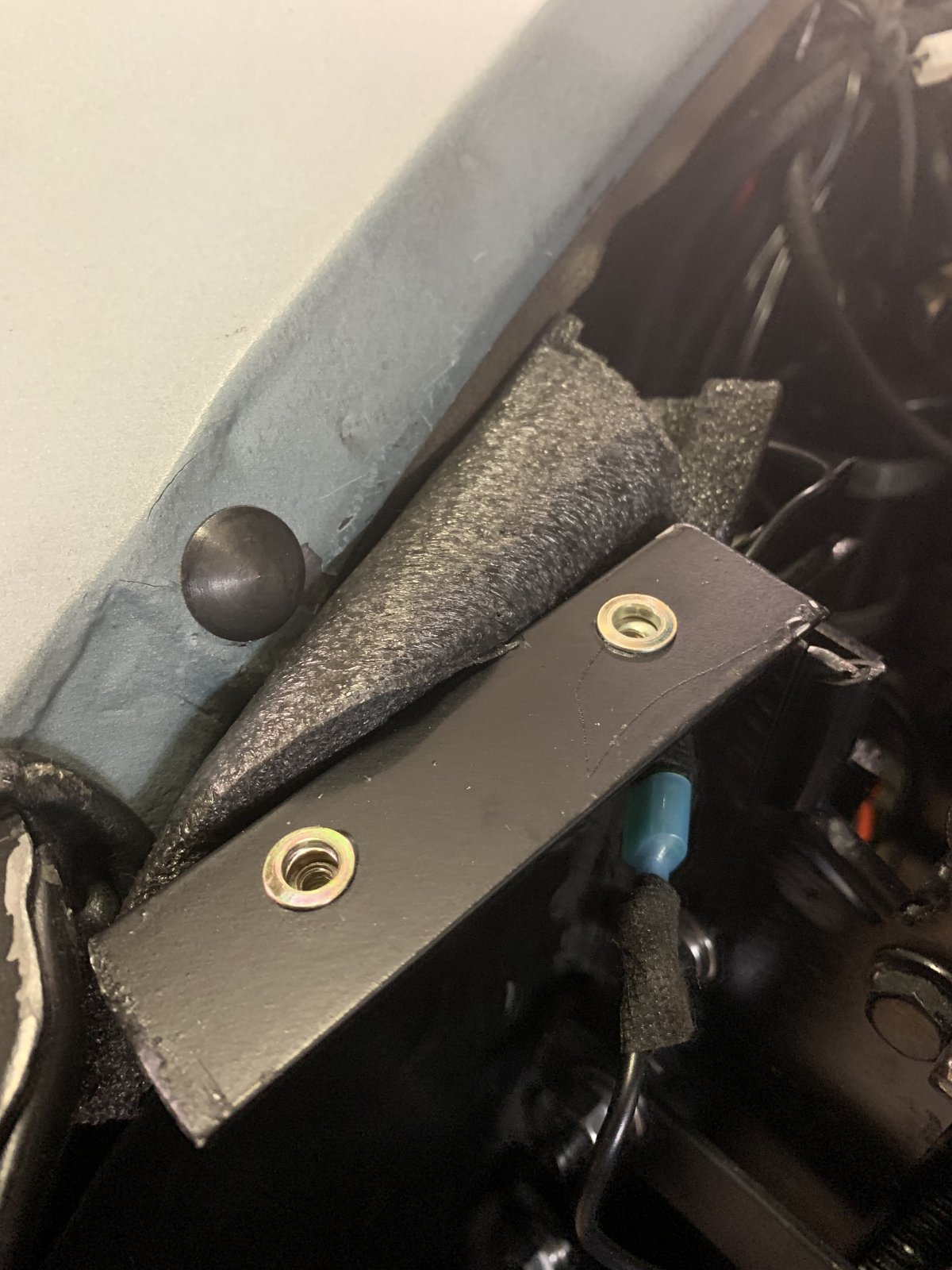

    - started adding the nutserts (name?) to the front
    rad sheetmetal wherever I find a looseness ….
    ….. and then I noticed a couple things:

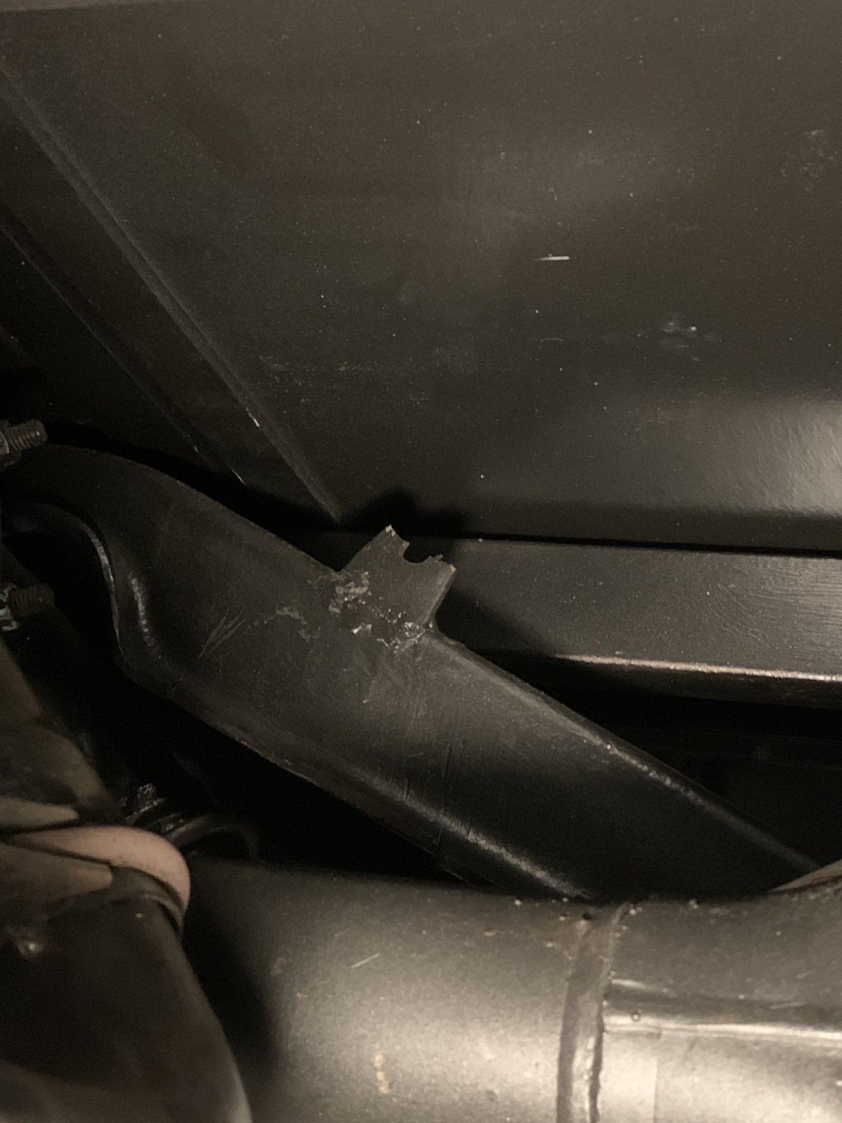

    2- the rear shocks were at a funny angle - turns out they sheared off the frame at the upper mount
    With no room to work with and gas lines too close for welding driver side, I will have to drill two upper 1/2” holes for grade 8 upper shock mount bolts. It's tight but doable. Presently I am researching shocks - when I played around with helper springs, extra leaves and the angle of the driveshaft, I unknowingly changed rear shock travel too short for the length of the old shocks and eventually broke off the upper shock mounts. It never even occurred to me at the time….

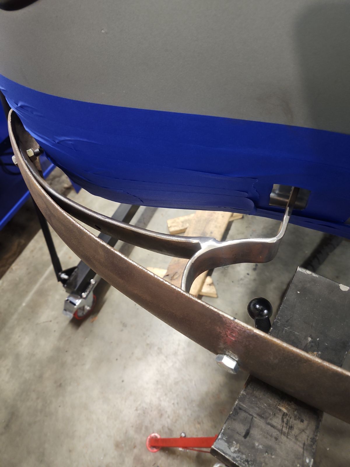

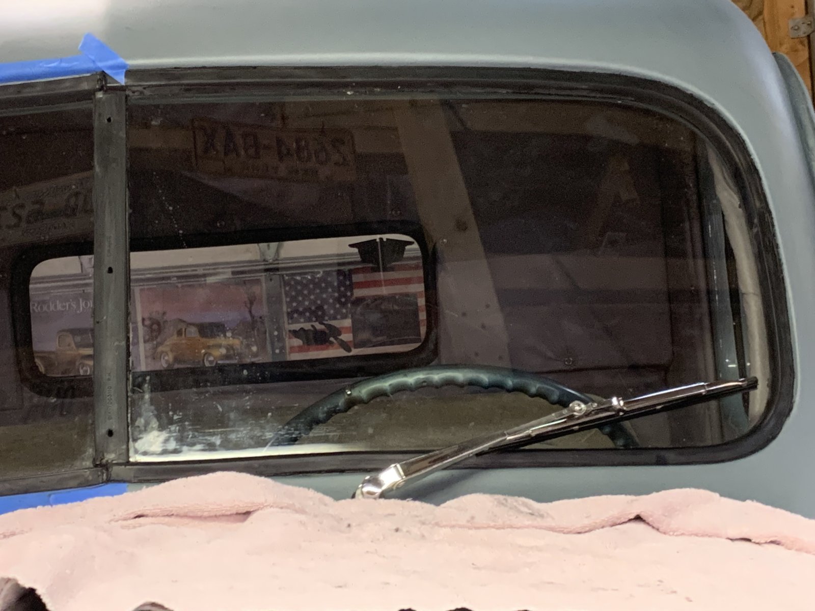

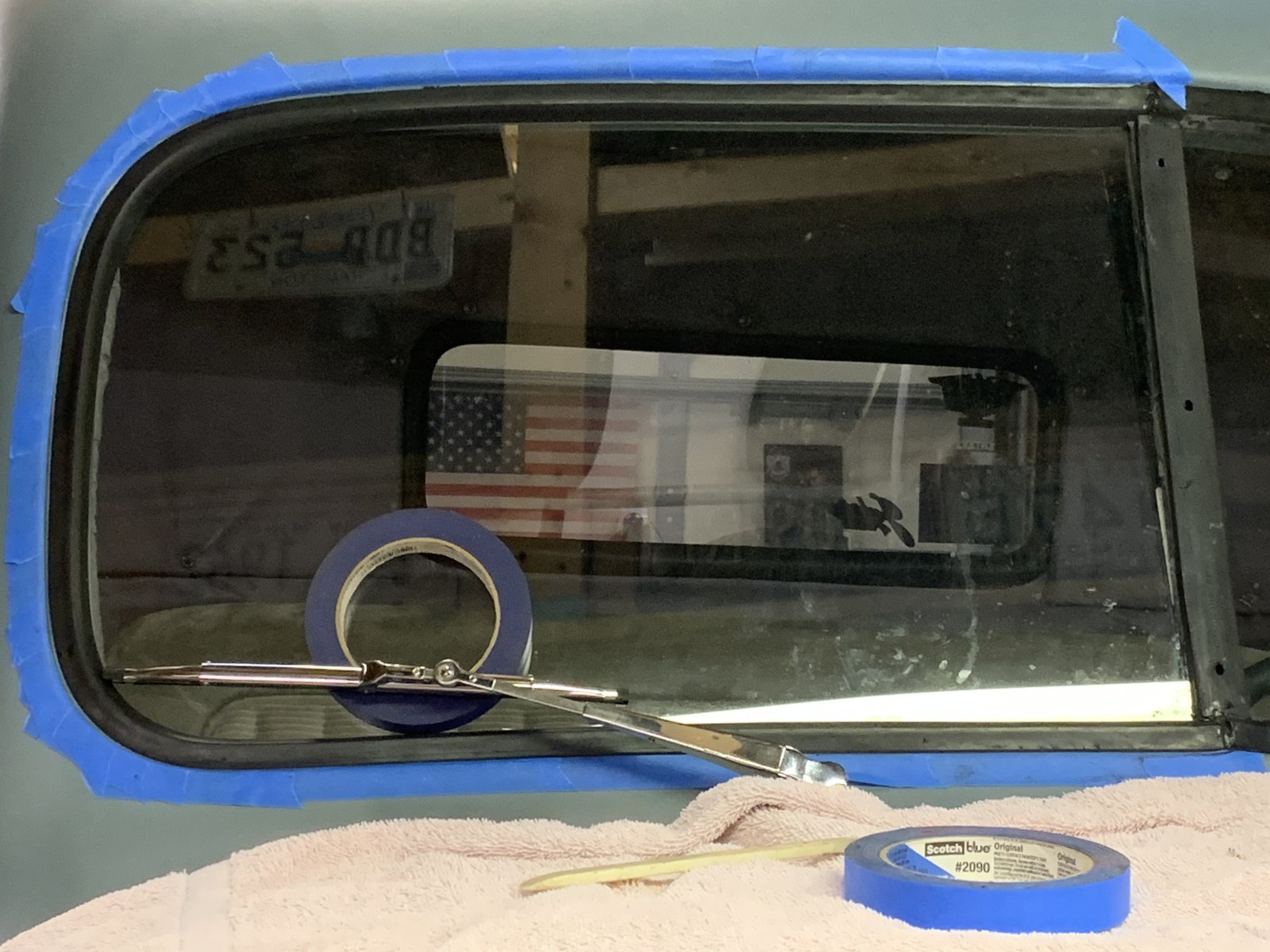

    Minor update - trying to work my way back into the garage for the little amount of time that I have. On one of my first test drives I was hit with a short, fast, heavy rain and ny front windshield leaked in the outer corners, center bar area, and from the top. The outer corner leaks are usually from where the gl*** goes into and under the gasket at the bottom causing water ti collect in that channel and leak to the inside. I picked up some clear sealer and pulling the rubber away from the gl***, put sone sealer in there. For the center bar it’s always the rubber overlap that the cinch between the inner and outer pieces can’t seam to close off. I am running some clear sealer between the lips and silicone on the vertical edge. Top top leak is where the outer lip of the seal rests on the cab flange. The flange us wavy a bit and is allowing water to p***. I will pull away the lip, add black silicone, and then run an iuter bead ti “seal” the deal ….. IMG_8586.jpeg
    The tape will keep me honest regarding thst outer layer of silicone.
    Not much but it’s something …..

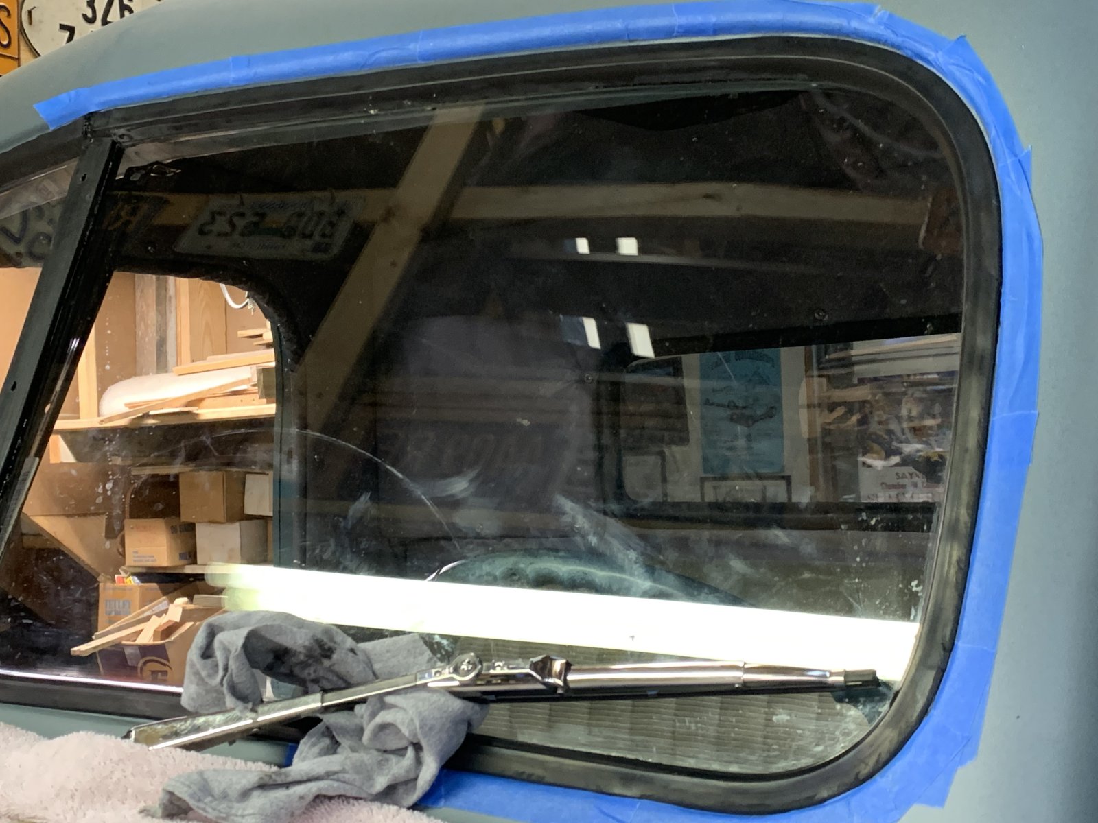

    Little more progress … driver side gl*** needs a good cleanup and some silicone on the center vertical rubber but it has been sealed (attempted sealing that is).
    Now on to the p***enger side ….
    Progress is progress ….

    So the p***enger front windshield seal is almost done - just had to redo an area at the p***enger top near the center divider that pulled away a-bit when I removed the tape. Will get a pic of that tomorrow.

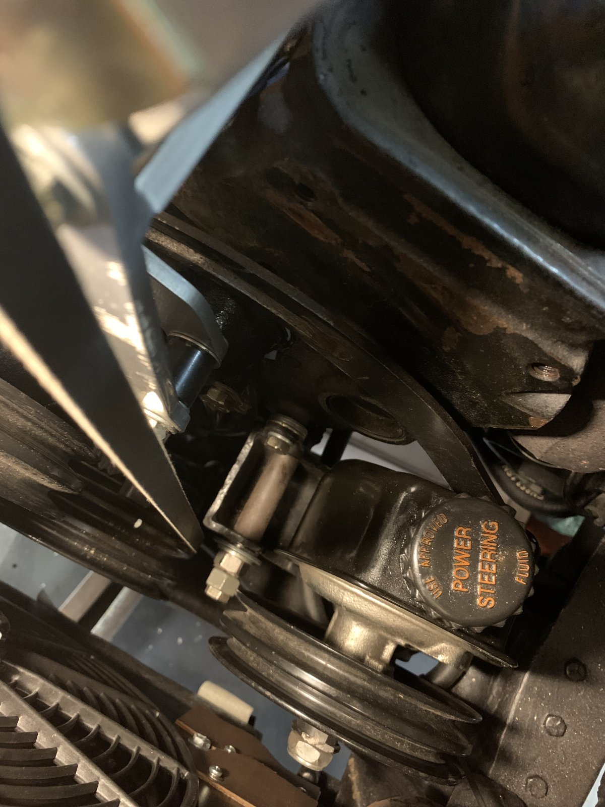

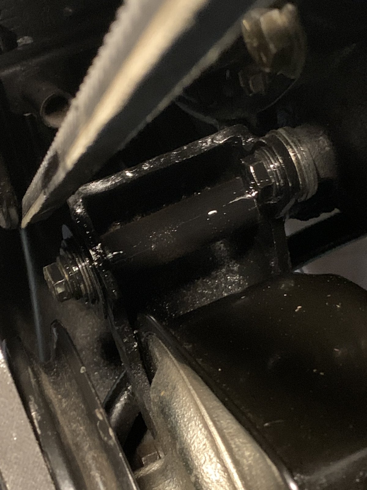

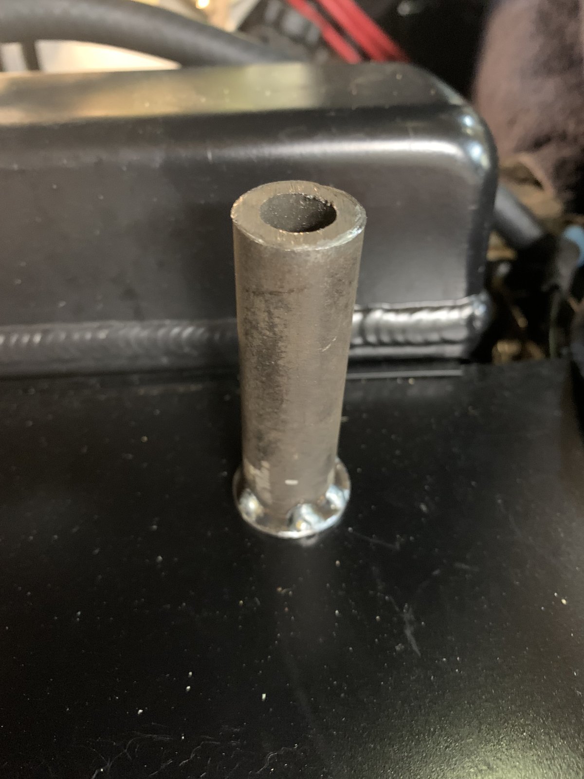

    I think I had mentioned a while back that my ps pump bracket was wobbling. It is the mud 69s Chevy swp ps bracket bolted tonthe two threaded holes to the driver side of the block. The bracket that keeps everything steady lays up against the block do everything holding the pump is to the engine side. My first thought was to make the bracket that adjusts belt tension to the front of the pump as it wobbles so much that I know it will worry the back two holes to the point of breaking off. A good friend if mine, jacksandeuces here on the HAMB suggested making a sleeve fir the lower bolt through the access hole for a ratchet wrench to tighten the bolt. I thought that was a pretty slick idea so I worked that up today.
    I found a piece of pipe that was suitable cutvitgyo length minus a washer thickness that would fit into the outer access hole to keep it from wobbling around and tac’d it in place ….
    I then mocked it up with a too long bolt to eee how it fit …
    After a run to the local hw I got a correct length grade 8 bolt and got it together ….
    While doing this I noticed the bolts holding things together were not very tight. This may have added to the normal ps squeal when at full lock in either direction. Amazing what you can get done in a short period of time when you are starved from time to do it - you pretty much have it done in your head before you start!

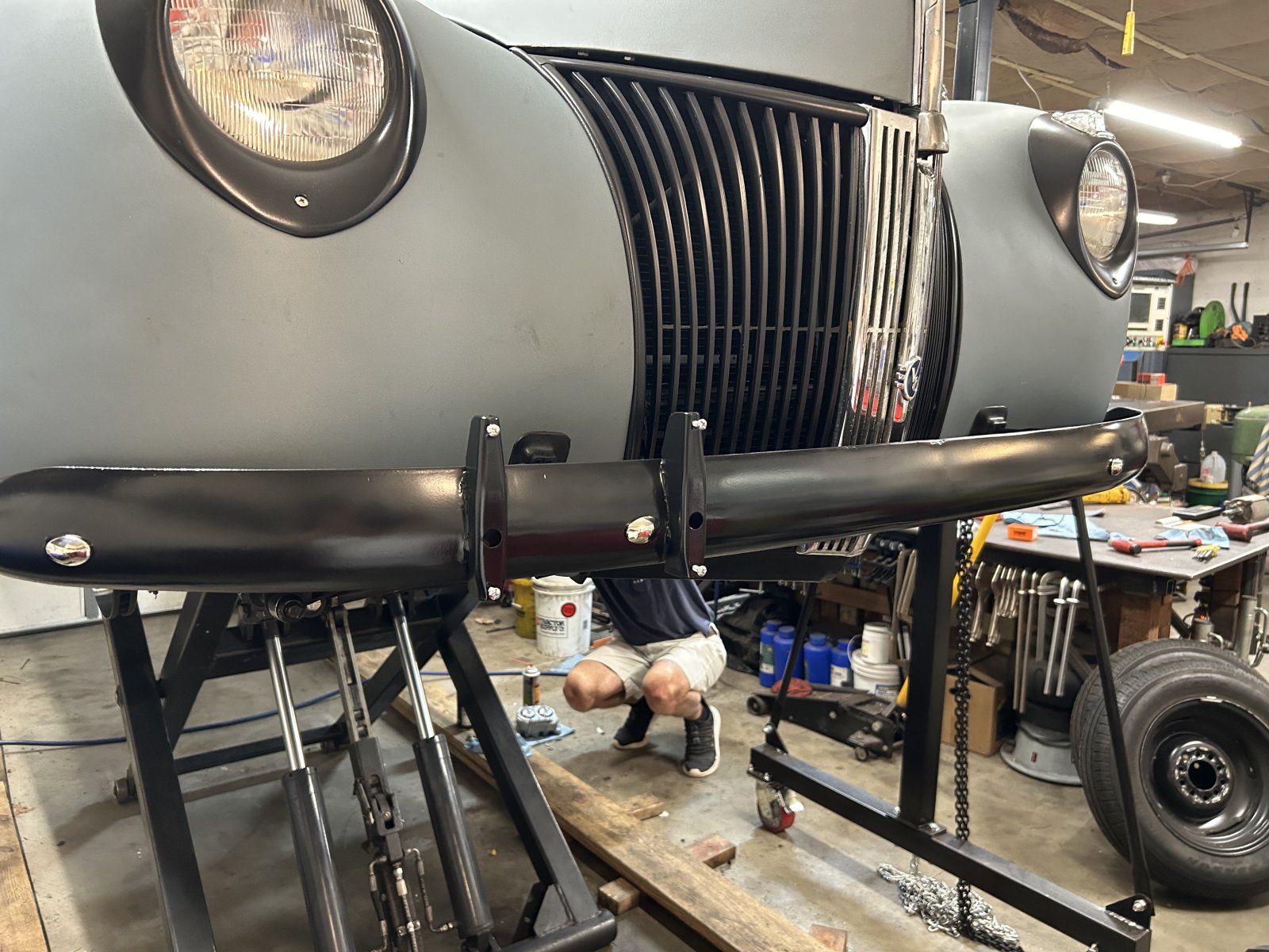

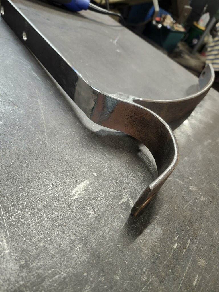

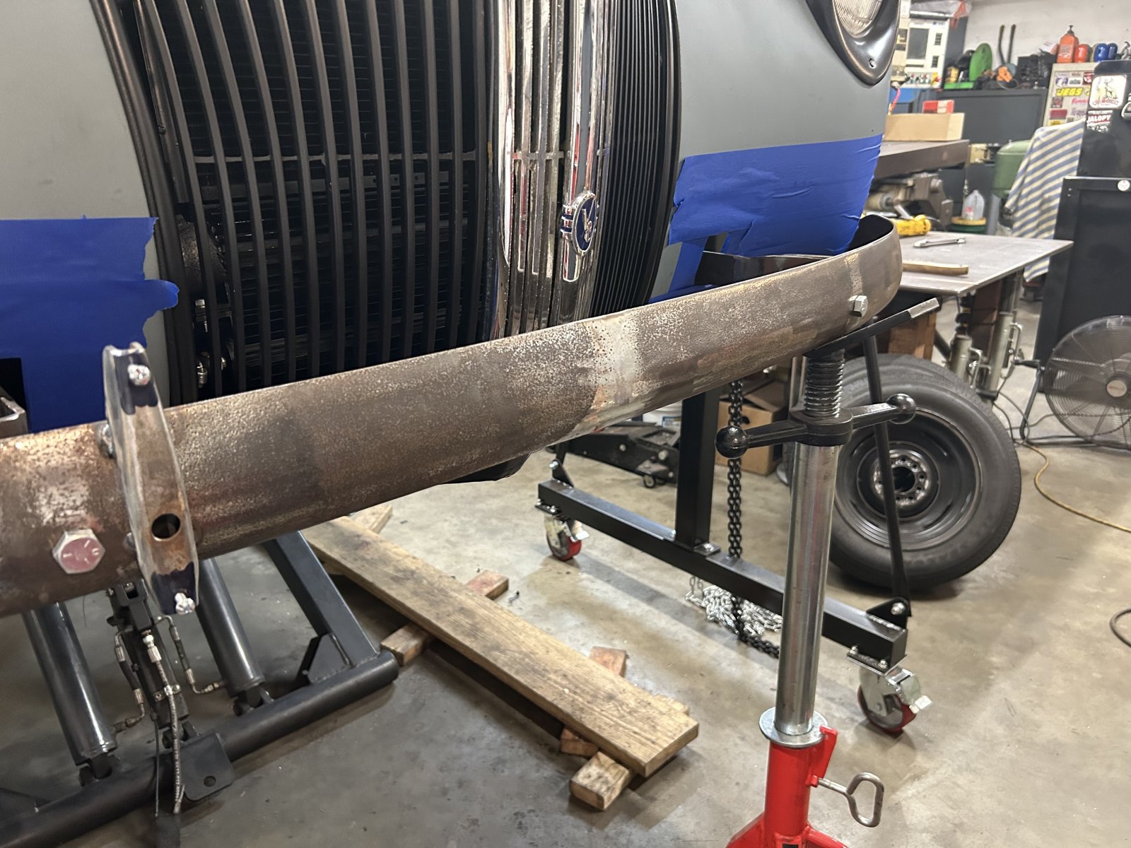

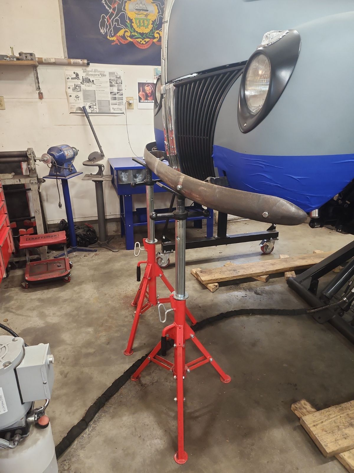

    My Buddy Ben took the truck to his place a week ago Friday to finish up things so my wife can drive it - my shop tine is non-existent but things with Dad are good and getting better and that’s what’s important.
    Ben gas furnished up:
    - the rear air shocks
    - the ****** lines now have flares in them
    - he is just about done with tge front pumper
    - fixed the horn issue I dud mot know I still had
    - checked everything underneath, tightening, checking, etc.
    - what I thought might have been a hanging caliper - turns out to be a faulty mc. ….
    Here are some bumper pics ….
    Just as I had envisioned!
    osage orange, brEad, Oneball and 7 others like this.
  19. Bandit Billy
    Joined: Sep 16, 2014
    Posts: 17,206
    Bandit Billy
    I like the bumper brackets, smart making them one piece at the frame rather than two. Easier install and alignment besides looking real clean. I may borrow that idea when I trim my rear brackets.
  20. TomT
    Joined: Dec 11, 2003
    Posts: 4,682
    TomT
    I am honored you like it but it was my buddy Ben’s idea really. I just love the clean look. I also like the position of the tucked in bumper look, especially with the 37 bumper. The 40 Ford bumper guard backing pieces for a license plate mount cane out pretty good. I had dragged the 5-6 I had to so many swap meets when it dawned on me that they would work great for a plate when I had 3 left. Funny how ideas come together like that …..

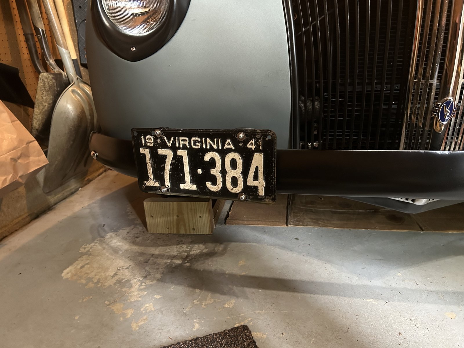

    One other minor thing - we were hard pressed to find a grease cap that that would he the correct size and stay in place. My buddy Ben whittled this little ditty up in a flash - my hat is off to all you machinists out there ….
    My plan for this? I am not going to say - I woukd be laughed off the HAMB! Lol!
