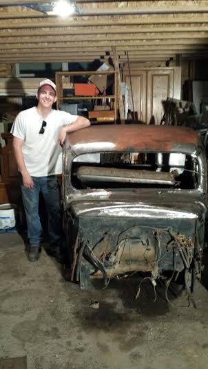

    So I've been building a 1940 Ford Pickup while attending school at WyoTech in Laramie, Wyoming. I picked the cab up from a guy close to the school and so far what I have done to it is chop it 1.5 inches while in my Street Rod and Custom Fabrication Class. Now I am in Motorsports Chassis Fabrication where I am going to build a full custom frame to set the cab on. I am not quite decided yet on if I want to go completely traditional with the chassis and do a dropped axle and monoleaf suspension or if I am going to go more modern with mustang 2 and four link. I am going to build the frame shorter than factory so that I can move the wheelbase forward a foot or so and run a shorter bed to get everything back in proportions with the chop. I am not quite decided on how much to shorten the wheelbase and bed so if anyone has any pictures of truck with this modification please share. It make take a second to get pictures loaded so please bear with me.

    This is the pickup cab as I bought it. Can anyone tell me how to post full size pictures? I loaded this one from my phone but will upload the rest to my computer

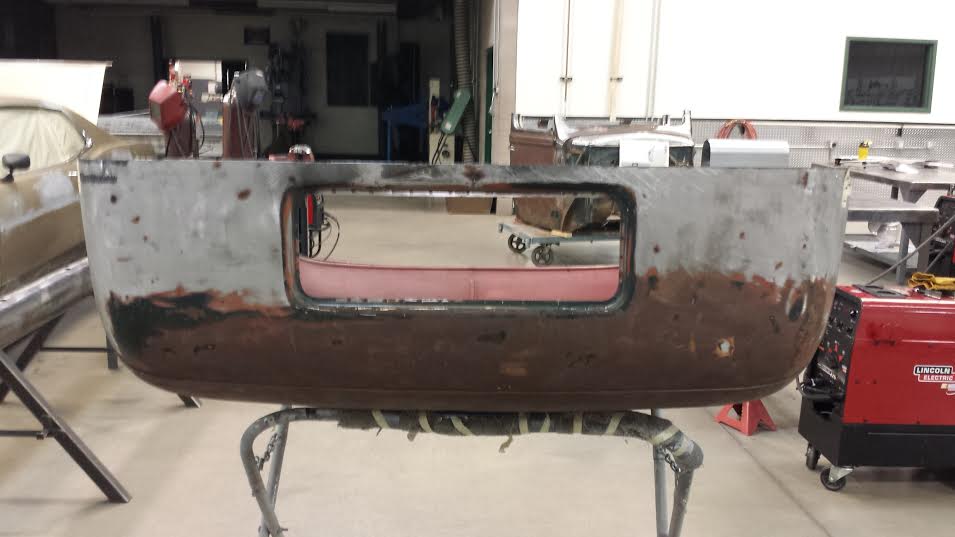

    Here is the cab after i got it into class and got the tape laid out with 1" increments laid out down the tape so i could get a few pictures and cut the cab up on paper to decide how much i wanted to cut it. I decided on an 1.5" chop. Pickup Chop Layout 3.jpg Pickup Chop Layout 2.jpg Pickup Chop Layout 1.jpg
    Here my instructor and I are heating up the striker plates so i could remove them without snapping the heads off.

    Interior of the truck cab before my partner and I began sanding on the interior before cutting. 40 Ford 5.jpg
    Here my partner is sanding on his half of the cab getting it down to bare metal for cutting and welding 1.jpg 2.jpg 3.jpg 4.jpg
    Here is after we sanded everywhere we were going to cut and weld and made templates for the chop. You can also see the paper cut out of my chop on paper and the a picture of the truck i want my chop to turnout like. 5.jpg

    Starting the chop! The a pillars and the b pillars were cut with a hacksaw and the back of the cab was cut with a plasma cutter and a guide! 40 Ford 6.jpg 40 Ford 7.jpg
