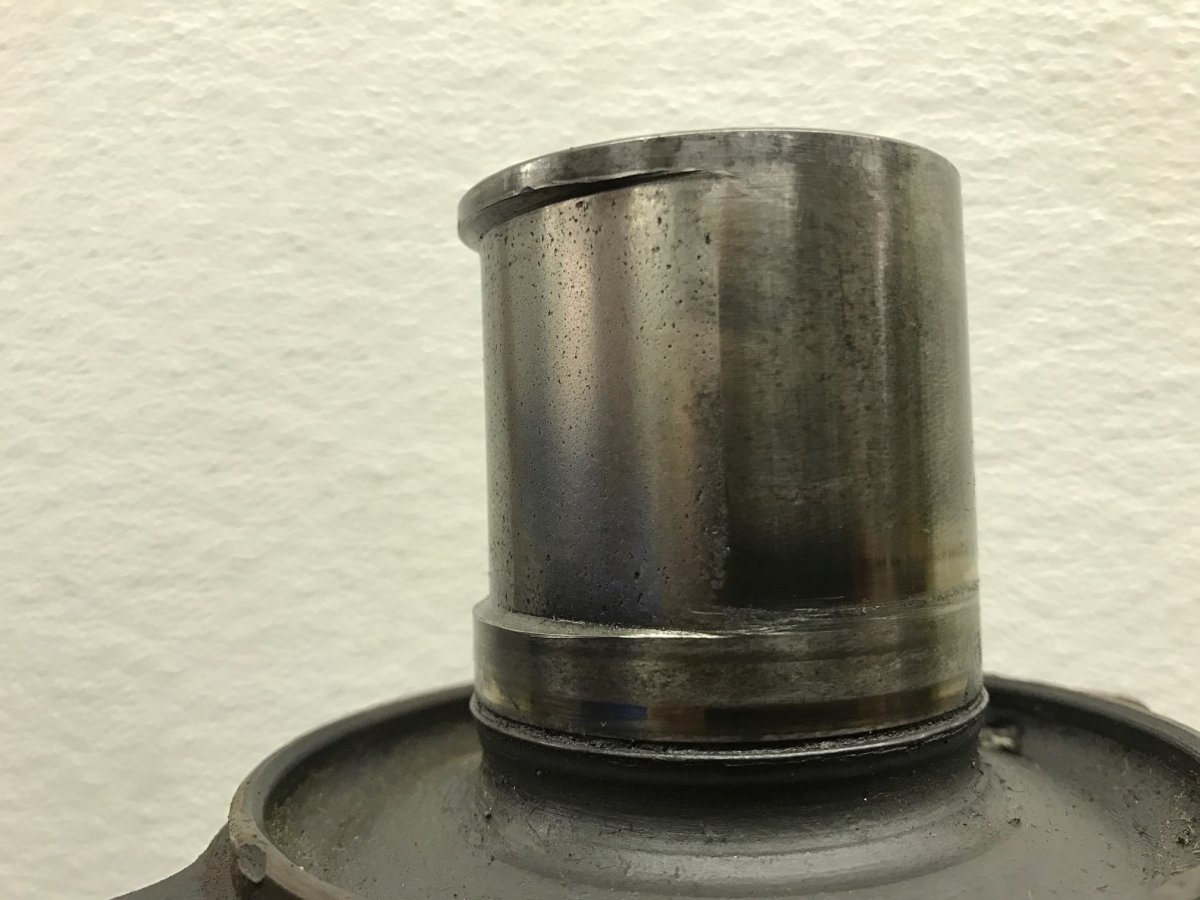

    We can turn down your housings and install new bearing races. Or we stock the good races and you can buy them and have someone there install them.
    Be aware that there are "soft" replacement sleeves out there that don't hold up.
    We did a side by side visual and hardness comparison a while ago. Here are the results (Hardness numbers denoted as Rockwell C):
    A "less expensive" aftermarket bearing race after 20,000 miles:
    Compared to an original Ford:
    Compared to the aftermarket race we stock:
    Packrat, RMR&C, 31hotrodguy and 6 others like this.

  16. dwollam
    Joined: Oct 22, 2012
    Posts: 2,833
    dwollam
    So, obviously that cheap repair sleeve has WAAAY too much damage but on an original bearing race, how much wear is too much? Is it when they have grooves or are egg shaped or a divit out of it or what? How bad do they have to be to not run it? Fingernail size blemish too much? 1/4" rusty spot having tiny pits? I'm talking about a car that doesn't see all that many miles, not a regular daily driver.
