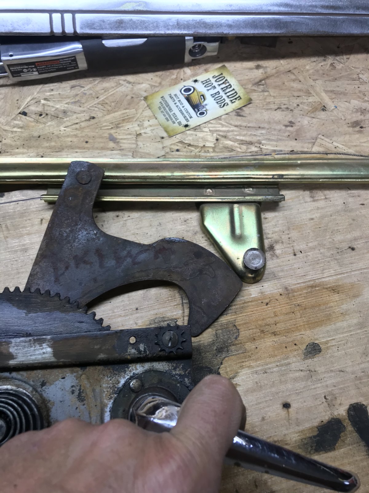

    7989ABB0-38A8-4E9B-8483-37592FEDFF56.jpeg Hey guys, I need some help with my window regulators and channels, they are the rear p***enger ones, I’m wondering there is a rod/pin that sticks out and connects with the regulator on the channel and the regulator seems to have like a hook at the end, Does that pin go on top of that hook or under it? Thanks for any help

    It’s been a minute since I’ve looked at those 40 regulators. But the rear windows on a 40 have what Ford called smokers gl***.
    Roll the window all the way up then about a half turn more and the gl*** would slide back horizontally opening a “vent” in the front edge of the gl***.
    I think the hook goes over the pin to make this work.

    I specifically did not take the regulators out when I replaced the gl*** in the quarter windows becasue of this. It was a giant pain in the as to get the gl*** in but also kept everything in time for the window vent to operate as intended. Luckily my regulators just needed cleaned and lubed.

    That’s how I remember it too, Jason

    My last 40’s rears did that but i never had to take the panel off to see how it worked, unfortunately this time im starting from scratch , thanks!
