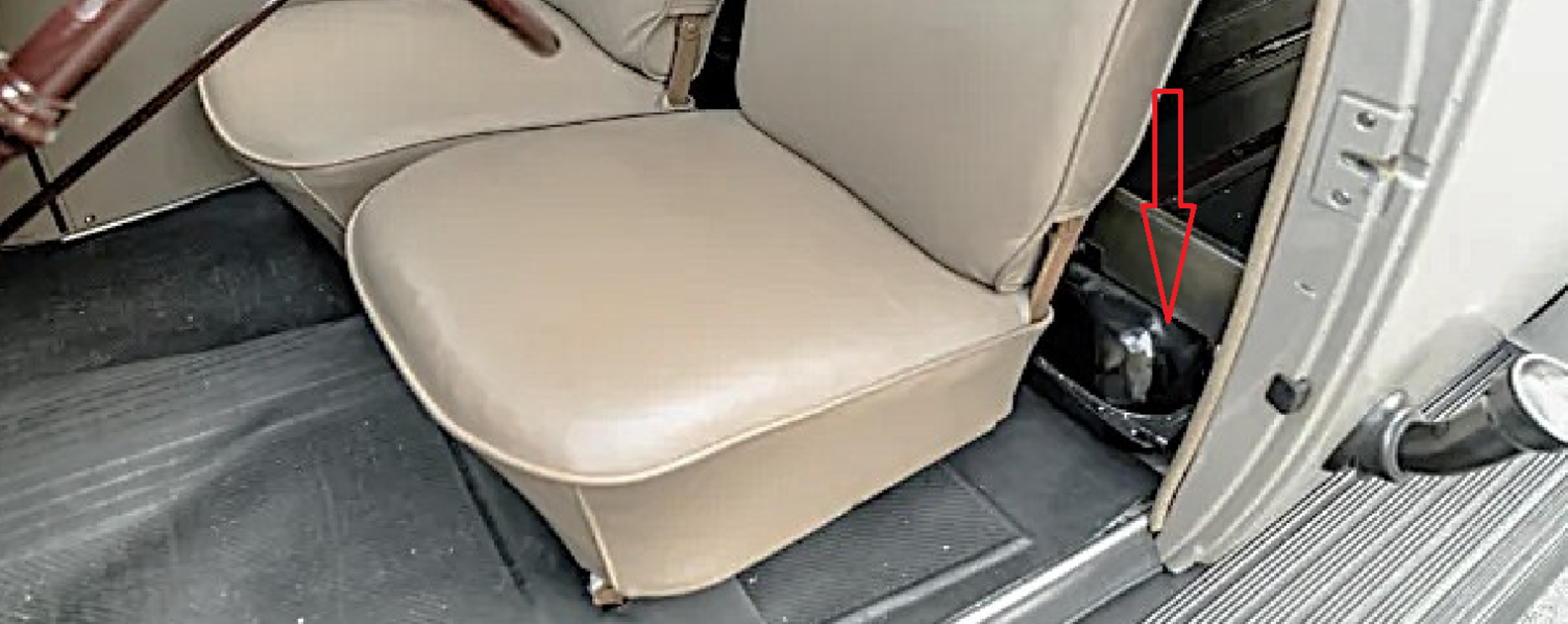

  9. jnaki
    Joined: Jan 1, 2015
    Posts: 11,403
    jnaki
    Hello,
    Well, since the gas tank has been moved to the rear, you now have a large space behind the seat under the boards. It would make a good lockable lined compartment for….
    The one thing that a lot of sedan delivery models had was an aroma of gas, if the cap needed a new seal or was accidently fastened. The inlet was so close to the seats that even if the outlet/inlet was outside, the pipe still had connections to the tank. So, for an old car, it did require replacement, clamps and a new cap.
    Once the new connecting pipe hoses, clamps and cap were installed in the old Flathead powered sedan delivery, there was no more smell.
    Jnaki
    As soon as my wife and I bought a different 327 powered 40 Ford Sedan Delivery as 20 somethings, we did the same thing to prevent the gas aroma to float around inside of the cave and driver/p***enger compartment. No gas aroma was outstanding on those long road trips.
    But, we did consider turning the rear under the floor compartment into a gas tank. The space near/behind our flip up bucket seats would have been turned into a “secret compartment” of sorts.
    Yes, why would we need an extra compartment when we have a huge cave? We need an out of view space to hold our camera gear and stuff we took on our road trips. The suitcases found a home strapped down in the rear cave, but we had to take the camera case with us when we went inside a restaurant or out of sight of the sedan delivery.
    Note:
    Even if we moved the gas tank to the rear, there were few places we could run the fill pipe and cap. We did not want an interior fill cap… the old fumes situation would have arisen again… YRMV

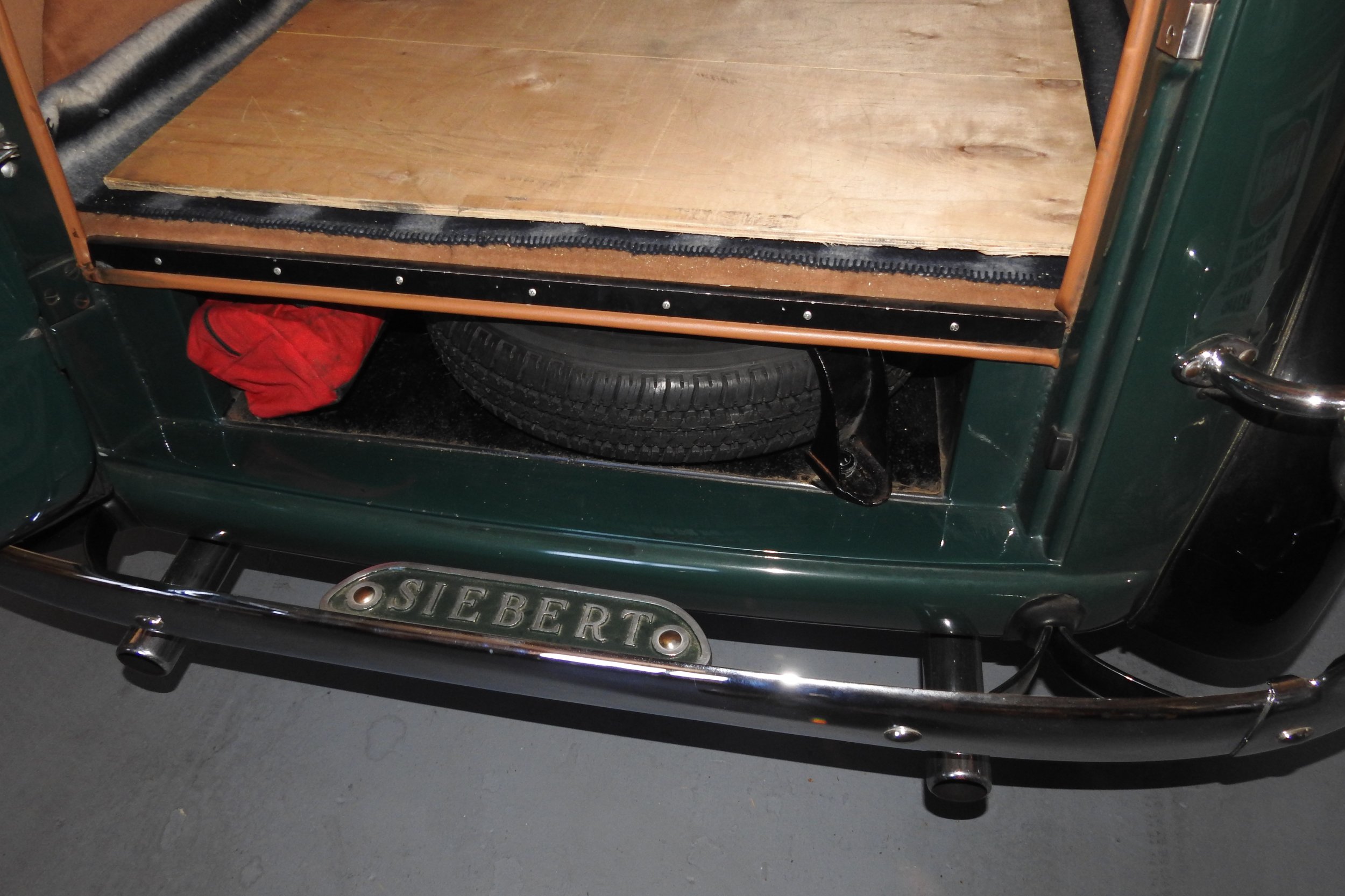

  12. LOU WELLS
    Joined: Jan 24, 2010
    Posts: 3,571
    LOU WELLS
    from IDAHO

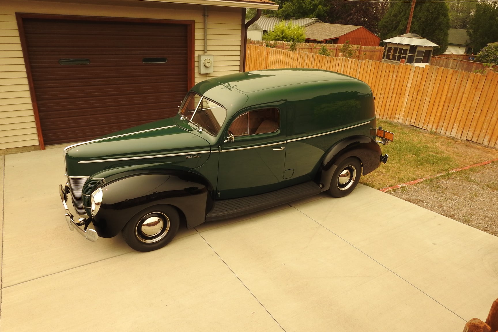

    Well Stated Jnaki And I Prefer My Spare Tire In The Stock Compartment....Personal Choice... DSCN0622.JPG

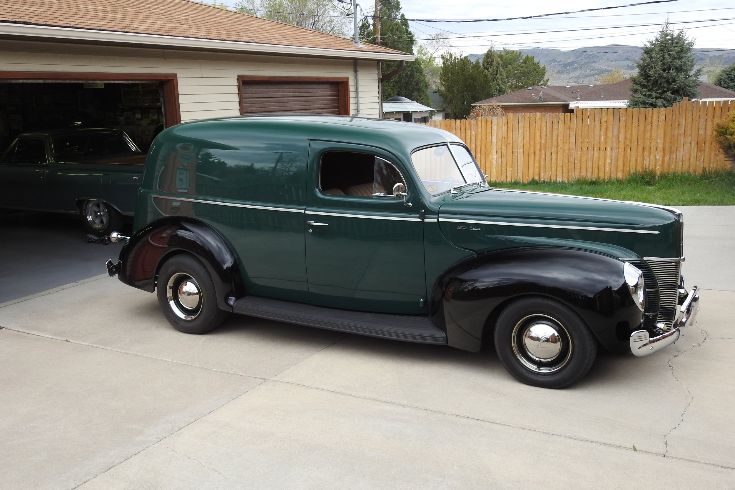

  22. LOU WELLS
    Posts: 3,571
    LOU WELLS
    from IDAHO
    rockable likes this.
