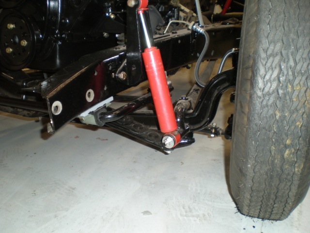

    Mocked up the grille this weekend to gauge ride height. The Ch***is engineering spring is really stiff, and I'm not sure it's going to settle as much as I'd like. I've heard Poises springs offer more drop, so a good buddy of mine is letting me borrow a Poises spring to see the difference. This car MUST SIT RIGHT!!!
    With the CE spring, the grille chin is 6.5" off the ground, but the rear is jacked way up in the air, so the nose will be higher. I'm hoping the posies spring + fluids+Fenders + settling will = a perfect stance.

    Aaahhh man, I thought you had a posies. The CE springs are stiff, my front spring did not settle but maybe 1/4" I'm going to de-arch it 2 - 2-1/2" because I'm too cheap to buy a posies after laying out the dough for the CE.

    I originally put together a spring using a CE main leaf in combination with some of the stock leaves; but it seemed too high to me. Thought about de-arching it; but decided it would end up too wide. I have a 47" CE axle and '40 bones; Posies came up with the recommendation to use their 2102 spring based on the spring eye centers. Put it in the other day, sits lower and the shackles have a good angle. May have to put shorter sway bar links tho.
    As a reference there is 4-3/8" between the axle and frame. Maybe helpful info? spring.JPG

    Top of axle to bottom of frame on the back side of the axle measures 4-3/4" on mine with the CE spring, as shipped. Its been sitting fully loaded for right at a year, has 3k miles on it or so, and has settled 3/8".
    I'm running a stock axle that Sid dropped. Its dropped 2" over stock - what everybody calls a 4" dropped axle.

    Clay I just went out and measured, and I have a little over 5" from axle top to frame. Sounds about right for a CE spring with no front clip unsettled.

    LOL. Clay, I ran out to the garage and shot photos of that same measurement. Mine is 3 1/8" (average of the slope of the axle) on the coupe (dearched and reverse eye stock), and about 2 5/8" on the truck (Posies full width spring)
    The Coupe's Deluxe grille is 5 3/4" from the floor to the dimple I gave it's chin, and the truck is 8 1/8" off the floor.
    Coupe has a dropped '40 axle and the truck has the stock axle in it.
    By the math, the coupes tires should be 25 3/8" tall and the truck's tires show 26 5/8" tall.

    Bret, that confirms what I was thinking. If I reverse the main leaf on my stock spring, it will sit just right. I'm calling St. Louis Spring Co tomorrow and see what they'll sock me to reverse the main leaf and recondition my stock spring.

    The pic below is a video on instagram, but it comes through here as a picture. Anyways, Slid the rear end back in today, and mocked up a tire to get an idea of ride height... just about perfect, and it will probably settle a bit. I also have a posies front spring now that I need to change out to get the front down another inch or so. Little by little!

    So, I'm terrible a at estimating ride height from the previous post. Got the brakes all together and rolled it outside... Much lower and much better.
