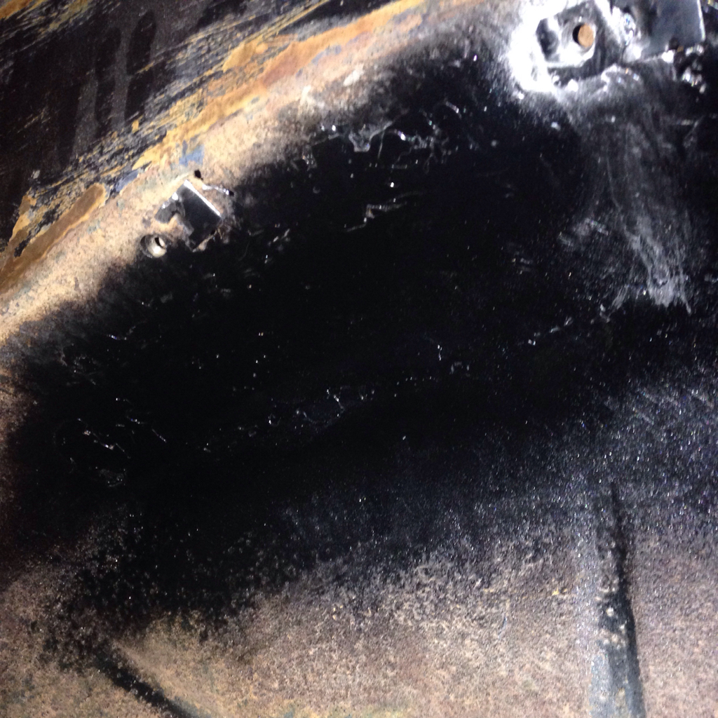

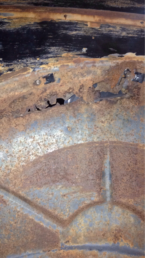

    Still working on this thing. Repairing rust. ImageUploadedByH.A.M.B.1455905566.128118.jpg ImageUploadedByH.A.M.B.1455905585.094729.jpg ImageUploadedByH.A.M.B.1455905611.694840.jpg ImageUploadedByH.A.M.B.1455905626.044128.jpg ImageUploadedByH.A.M.B.1455905646.278230.jpg

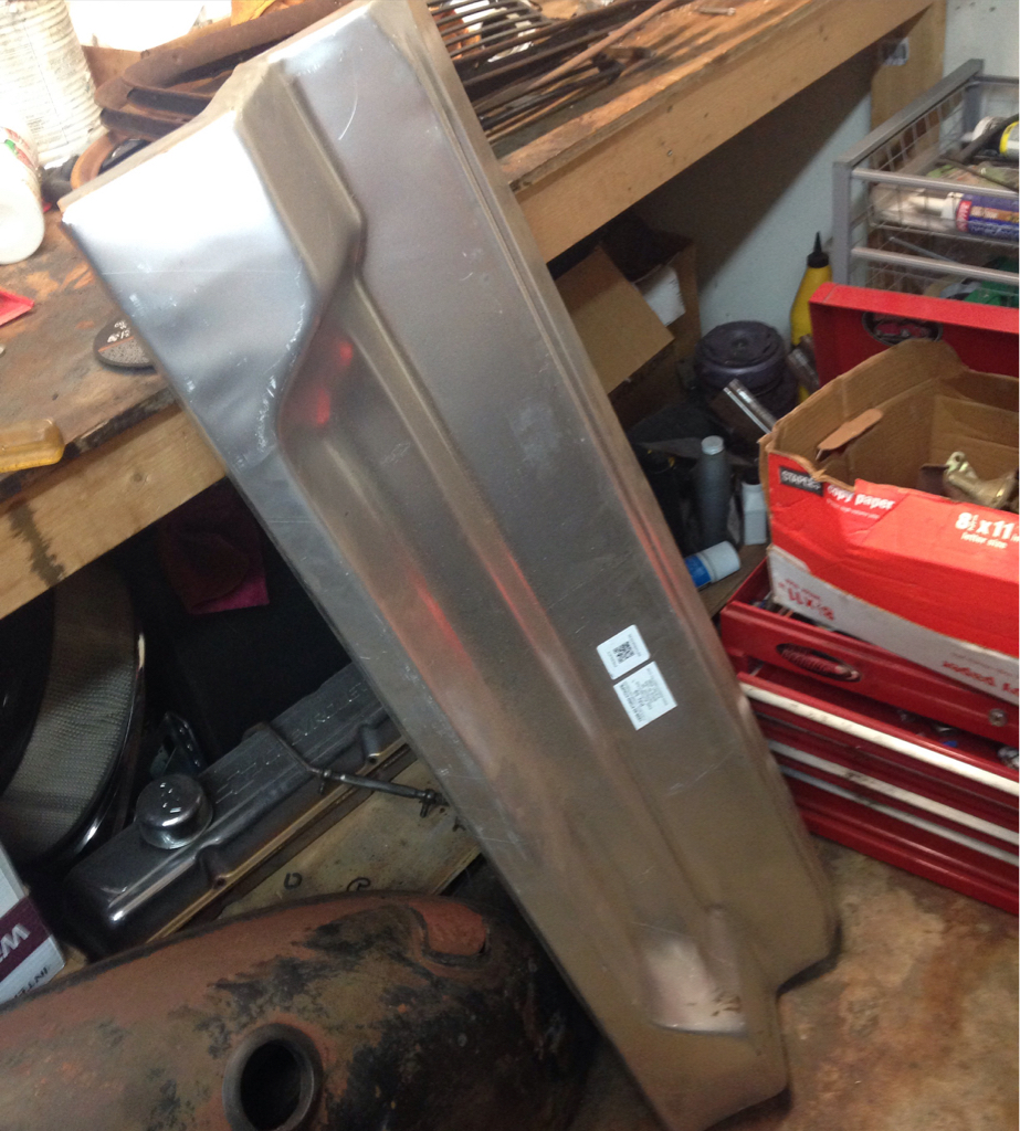

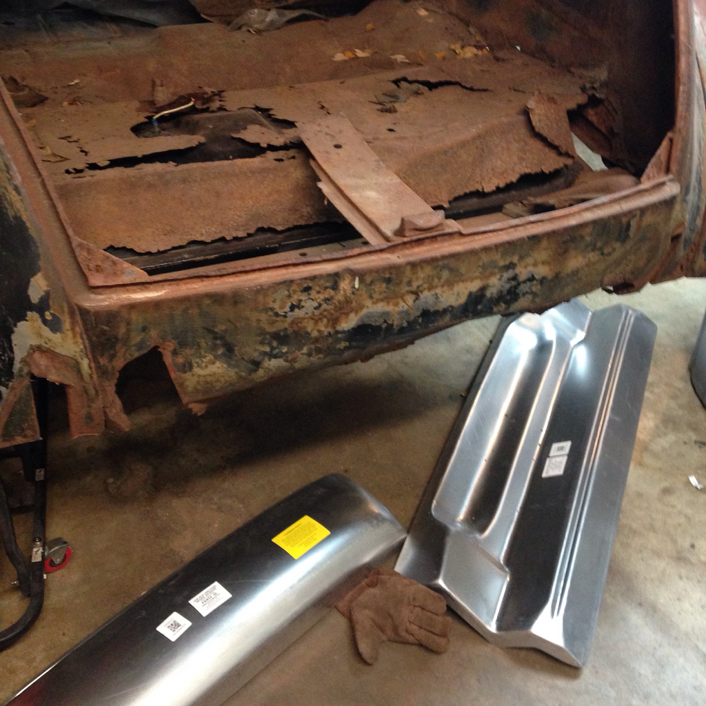

    Anyone have any tips or insight how to trim this tool tray to fit a sedan? EMS makes it to fit a 40 Coupe but says it will fit a sedan with "some t*******" ImageUploadedByH.A.M.B.1455905736.527773.jpg

    Posts: 4,515
    Nailhead Jason
    Id like to know that too, as I need to replace the tool tray in my 39 sedan, trying to decide if I should buy one or just make one if I have to cut it into ten pieces to make it fit.

  22. The 39 guy
    Joined: Nov 5, 2010
    Posts: 3,775
    The 39 guy
    And I thought I had some rust issues! I have no idea what you need to do to make that panel fit but I hope you show us what it takes. Good to see you are busy working on your cool sedan!

    http://www.jalopyjournal.com/forum/threads/40-ford-sedan-tool-tray.610776/
    Dadgummit I thought I already had started a reply... Anyway I can't help you with your fitment issue since I have never done a sedan tool tray. I did find this little thread. Give EMS a call and see if they have any instructions or ideas.

  24. Dan Hay
    Joined: Mar 16, 2007
    Posts: 6,454
    Dan Hay
    Thanks, I'll give EMS a call today. My car really isn't that rusty, but the places it does have rust it's bad!
    When I looked at this car I didn't see half of the rust, due to inexperience, and if it was in better shape, it would have been out of my price range. So, I'm looking at it like I'm getting an education on rust repair.
    Edit: called EMS, he gave me a few pointers, but over the phone, and it was kinda vague. From the sounds of things I might have a tough road ahead getting this thing to fit right since I am a novice.

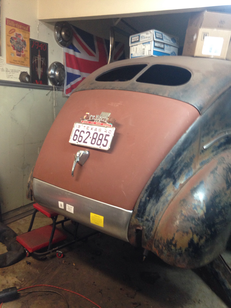

  26. Dan Hay
    Posts: 6,454
    Dan Hay
  27. Silverado85
    Joined: Mar 29, 2009
    Posts: 211
    Silverado85
    Nice tail piece insert

  28. rodl
    Joined: Jan 14, 2011
    Posts: 255
    rodl
    Hey Dan, The 39 Guy had some good tips in his post re: marking out your centreline of the new section to be fitted and checking it against the centreline of your existing trunk. That will show you how much metal needs to trimmed at both ends.
    Are you going to use an angle grinder with a slitting blade or tinsnips. If you have never used tinsnips I suggest you get left and right hand ones. Always cut so the lower blade is on the side that you want to trim off. If you don't use them that way you will distort the piece you want to keep!!
    I've added a couple of photos of my 40 tudor trunk, which may help. RodL
