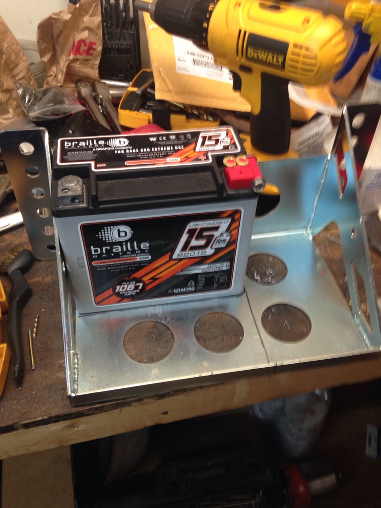

    Battery location looks good. What's going on with the inner fender well? I'm guessing you are getting rid of some hot air thru there. Any more pictures of how you made that?
  3. Dan Hay
    Joined: Mar 16, 2007
    Posts: 6,454
    Dan Hay
    Those are stock Ford inner fender panels (as far as I know). Henry figured out by 1940 that it helped those water heaters (flatheads) to get the heat out of the engine compartment.
  4. joel
    Joined: Oct 10, 2009
    Posts: 2,735
    joel
    The bulge is bigger on this side to allow the battery to sit in the engine compartment. The battery tray bolted to both the frame and firewall. The battery acid fumes ate through most original panels. Before that the battery sat in a shelf in the firewall, under the floor etc. The drivers side had a smaller bulge, so maybe ventilation also.
