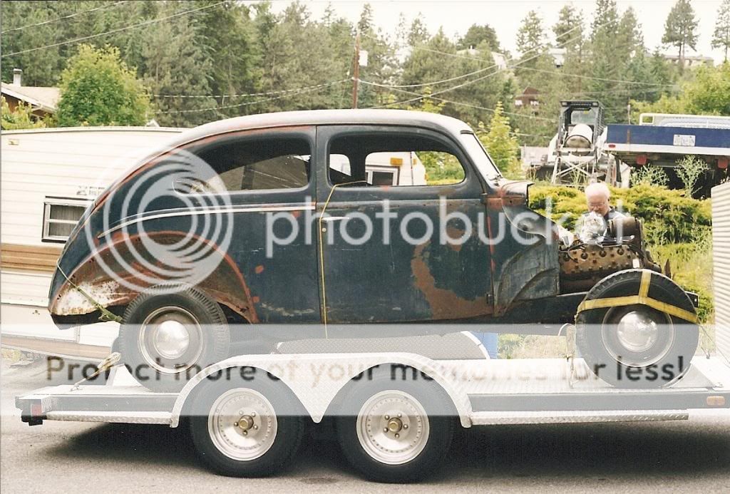

    I hear that. Mine spent way too many years sitting outside under a tree as well! I know the guy that owned mine in 1962, he drove it to high school. He said it was a real good car back then. Not so much now but I'm getting her done. My avatar is the way it looked in '62.
