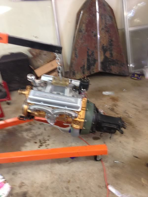

    So, the HAMB was down, I got work done!
    I went ahead and ***embled the motor/trans, and then slid it in the ch***is. It feels like I've met a major milestone in this build.
    I used the spacers that speedway says to use for a 35-40 ford frame. But I think it could come down a little and still not be touching the crossmember... Here are some pics of the clearances... the distributor cap just kisses the firewall, and it doesn't seem to be impeded at all. I barely got the bolts in the ****** mount. It's sitting about a 1/2 inch too far forward on the ****** mount, but as you can see, there is no more room to go back, the motor could come forward a bit, but I'm not sure if it'll bolt up to the trans mount.... thoughts?
    Should I shim the radiator up some? I don't really want to use an electric fan, but in this position, a mech. fan seems like it wouldn't work well.
    You can see the top bell housing bolt touching the transmission. I would move it forward, but I'm not sure if the transmission would bolt up to it's mount..

    If you replace those Speedway spacers with something half as high (or maybe even less), could the pan still clear the crossmember? Then you'd have more clearance at the firewall and maybe your trans mount would fit better. Remember, if the trans is a bit too far forward, so will be the rearend. Maybe you need a smaller diameter distributor like a two-piece-cap Mallory.

    And, yes, there is some room for the motor to come down before it's into the crossmember, and there is plenty of room between the pan and the drag link/tie rod.

    Dan, unless you need the additional height to clear the oil pan, I'd ditch those spacers. If I remember correctly, an EARLY SBC pan is small enough, in the area that is over the crossmember, that you shouldn't need them. That should also help out the mechanical fan angle issue. I ran a mechanical fan, on the coupe, until I replaced the stock radiator with a Walker, with an internal trans cooler. The additional heat from the transmission oil cooler required more cooling, so now I went to the dark side and added the electric fan.

    I don't really like the spacers either, but without them, the hurst mount is resting on the U bolts for the spring. If the CE donuts are shorter, that should bring it down to it's lowest point, but I will still have to use the spacers.

    Well, the is a Speedway Motors copy of a hurst mount. They advertise it for a universal application. That's why they have the spacers to use in this frame. So, I'm sure that the hurst mount that was originally designed for this application was an exact fit. I should've called mind a hurst-like mount..

    Can you section a little off the bottom chin of the Hurst-like mount? Obviously replacing the flange, just up a little? I'd think most of the work is being done by the outer wings of the mount, and the bolts holding them to the front of the block. The chin is just connecting the two halves together.
    If you can get that engine lower it should fit in there just like the Chevrolet Brothers intended.

    Looked at a pic of my CM vs. yours, and I now see why mine needed the additional spacers. The earlier CMs dip down inside the frame rails about the same dimension as the 40s rise - you can kind of see it in the below pic.
    I have an original small journal Hurst Mount at home that I can measure, but like you, I am using the same hurst-like mount on a large journal motor. It would definitely fit better without the spacers, but it looks like you would need a different pan, and you would need to trim the bottom of your mount. That's why Deuce Lover cut his in half.... I'm sure that will probably work fine, but I feel better with the connection between the two sides to reduce the shear on the bolts. [​IMG]

    One more tip with that mount..... you are going to need to notch it for your lower radiator hose. It would have be been much easier to mark it and do it off the car, that the way that I did it.

    I switched the spacer around... It's down a bunch and nothing is hitting the crossmember. This may be the answer. Any lower and I'd have to cut the mount or do something different. ImageUploadedByH.A.M.B.1400106383.940278.jpg ImageUploadedByH.A.M.B.1400106401.722702.jpg
