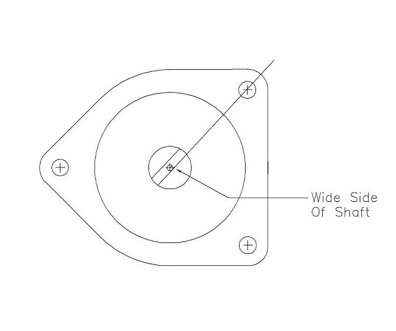

    Here is a drawing of the ruler method for the three bolt distributor:

    The '42-8 method is of course different from that for '40 and '32-41 but does explain the idea well. Here's the drawing of the helmet ruler method from a 1934 Ford patent...the method as shown by Bill M above can be readily deduced from this drawing and the others in patent US1963657.
    I was surprised when I spotted this patent...it also has further neat ideas like a cotterpin through the drain so it can be used with visual from the actual spark.
    I immediately timed a '34 distributor with it, then compared to results on same with a late KRW fixture and one of the cheap aftermarket timing plates, the sort that looks like a ping-pong paddle, and got 100% same result on all within the resolution limits of my eyeballs.
    Obviously Ford had gotten flak on the lack of an obvious timing method on the flathead, came up with this, and likely quashed the idea for production as the first version of the fixture was going out to dealers at about the same time.
    The whole writeup and other drawings on this patent US1963657 are quite interesting!
    And if you are new at this, DO note that the drive tab is NOT symmetrical and you need to have the ruler on the fat side!

    As I noted, for timing the ruler got the same result as I got with the fixture. When done, look at the scale on distributor...you should see it right about mid range, and if not likely you screwed up and used wrong side of the tab or some such. This stuff is usually dead nuts because Ford held all the dimensions to very tight standards, and with the Ford design the distributor shaft is one piece that does not move at all in its relationship to engine cam. All running timing movement is handled by distributor cam turning on the shaft.
