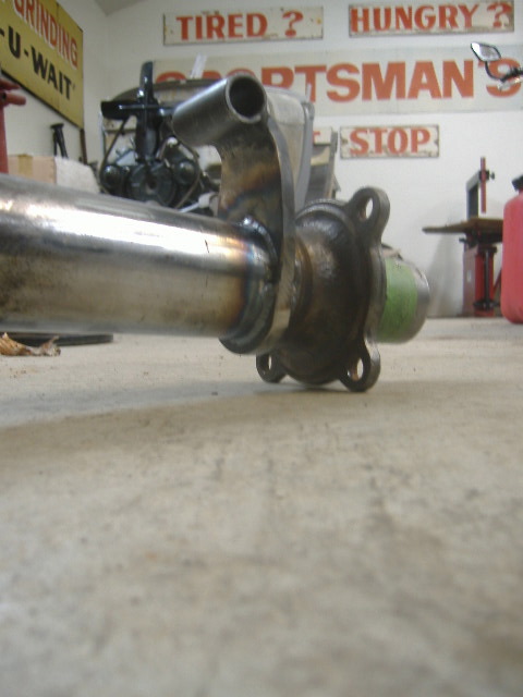

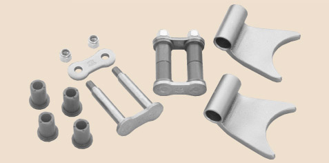

  2. I think the axles are the same physically between the car and 1/2 ton, spring are probably diffrent as are gear ratios etc. Brakes, spindles etc are the ones to use on a traditional Ford hot rod.
    You need weld on style spring perches to convert the rear to a spring on top style. Be VERY careful with welding the perches as it's easy to warp the axle housings, mine unfortunatley took two tris but the second attempt proved successful. I bought these factory made perches and pinched them to fit the smaller radius of my 36 diff.

    thanks for the info! where did you get that kit?
