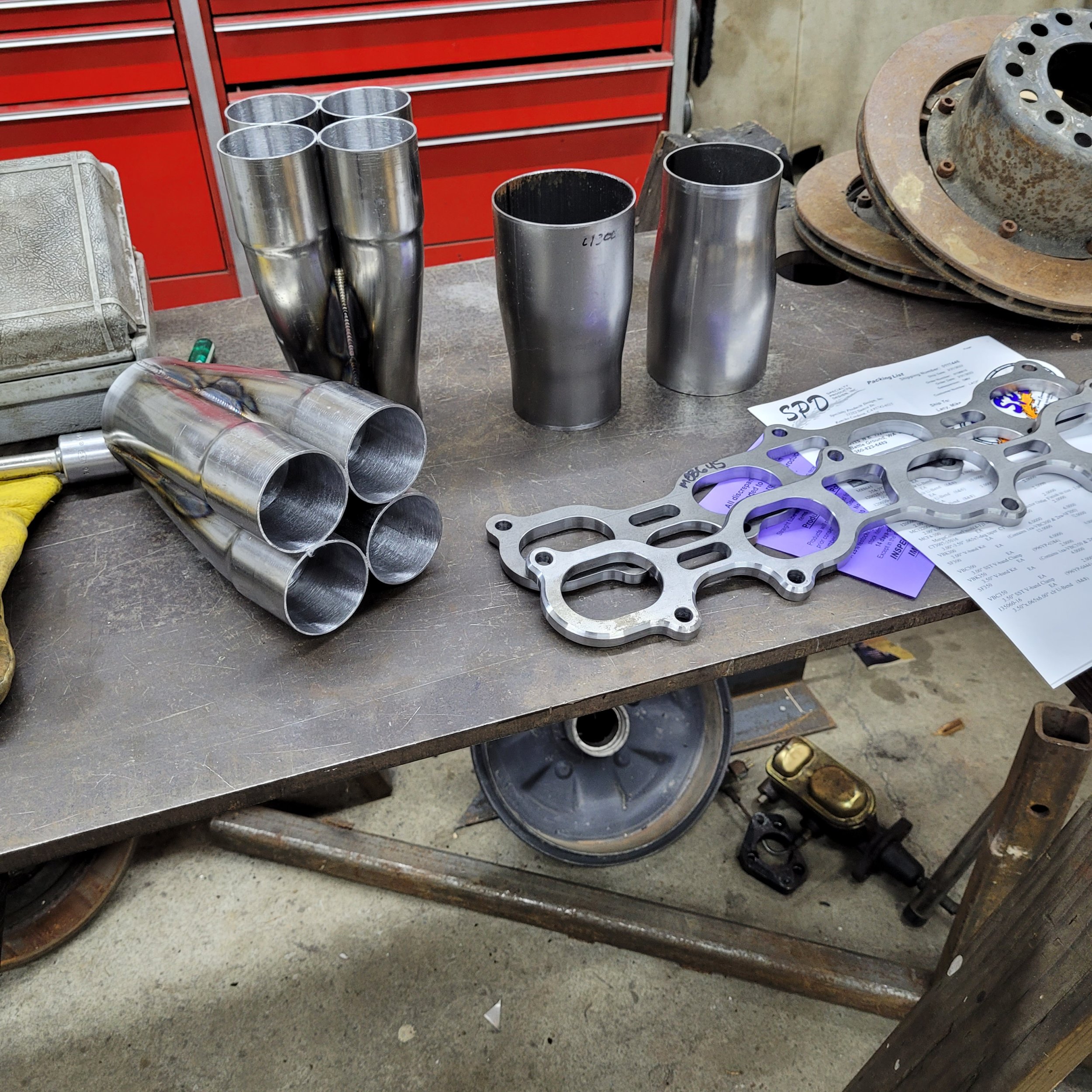

  7. I don't think so B-B. You know me, I never tell anyone not to do things they seem destoned to do even if I disagree. Change just for the sake of Change is pointless in my book. There is Zero improvement between the 2 boxes. Adding and 1-1/2" hole in the side of a frame right at the torque point is not for me, then add in there is an inner frame rail that needs to be carved out. For what gain? Factory manifolds aren't for me so I can't comment on what one might clear. If you're going to build a Hot Rod let it breath. Build some Headers that fir the space left behind after you place the motor where it fits best.
    Yes, it gets tight but the best thing in life are tight, right? And yes, it will run a manual fan when done. Electric fans are for people that can't plan ahead and read a tape measure.
    That is a rebuilt stock 40 steering gear. If there was a better one for this build it would be in it. I'm building a Hot Rod, not a Street Rod. Notice the labels on the box tape.
    Hiding inside the box was all the stuff to build the recommended Headers. Again, I never tell anyone to do something I wouldn't or haven't done myself that I know works best.
