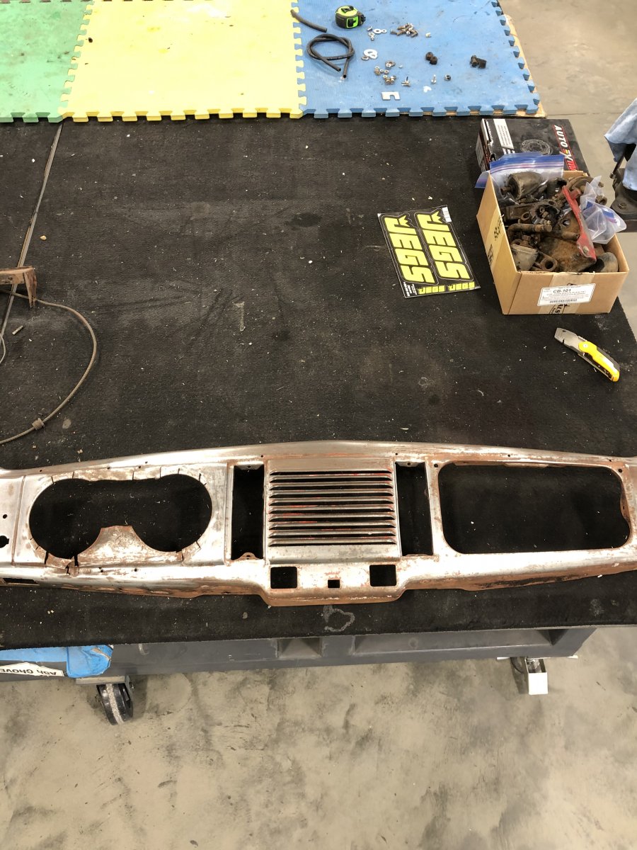

    So I bought a 40 Ford Woody last summer that was missing the dash. Unbeknownst to me I purchased a dash for it not knowing that the woody and convertible use a slightly different dash than the coupe/sedan. My question is, what are the differences between the two style dashes? I would like to find out if the dash I have is actually for a woody/convertible. The angles in pics online are tricking me and it’s hard to make out any differences.
    Thanks in advance.

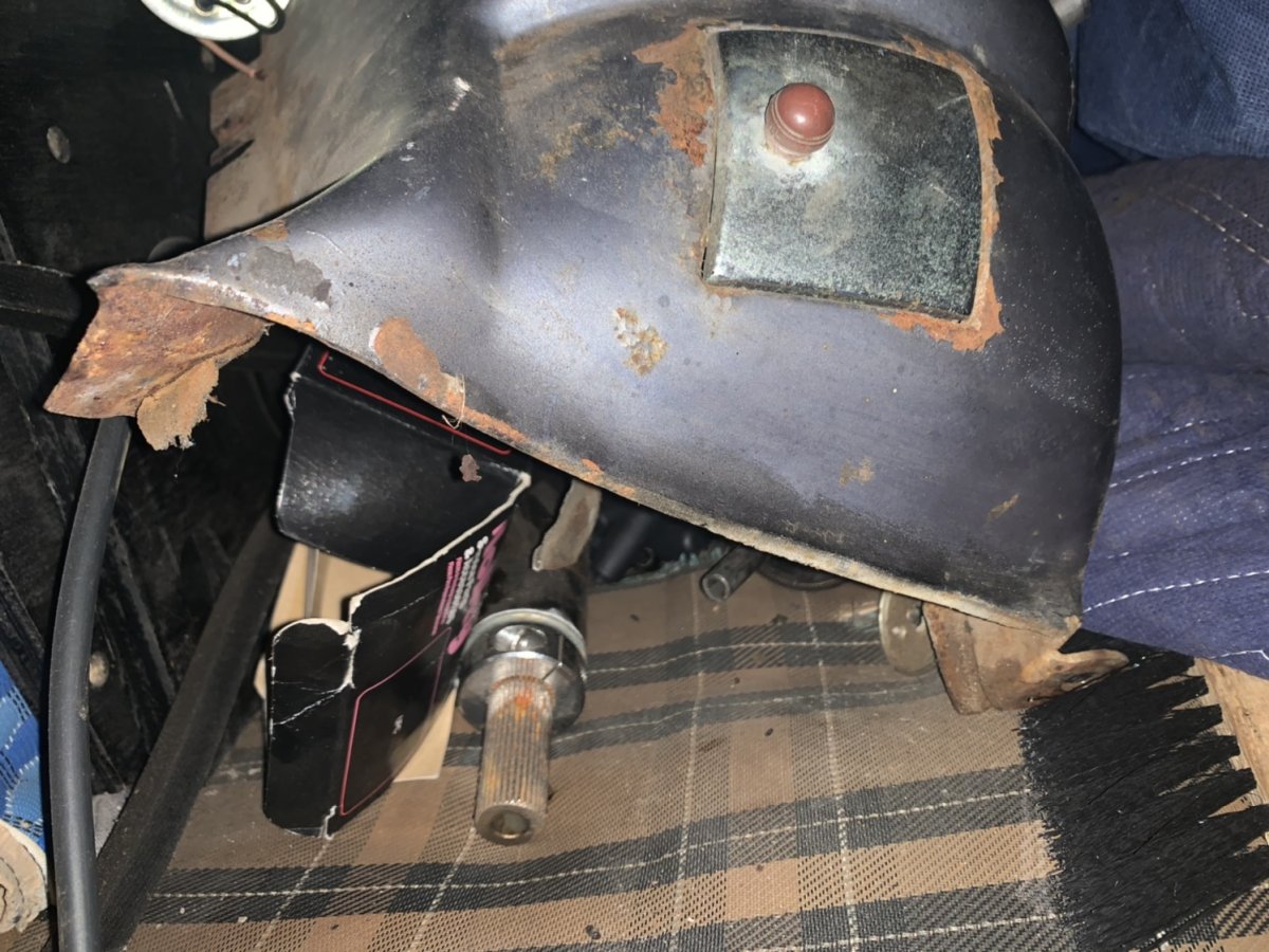

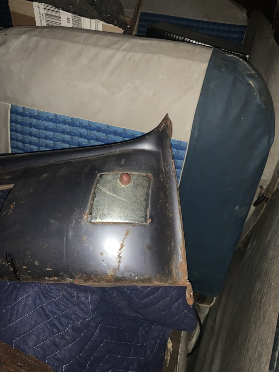

    I'm not much help, but the pointy "horns" on the upper corners of the dash are different on the Woodie/Convert dash. I'll try to take a picture for you, but my Convertible is currently snowed in. Someone on Ford Barn will know, if you post there.

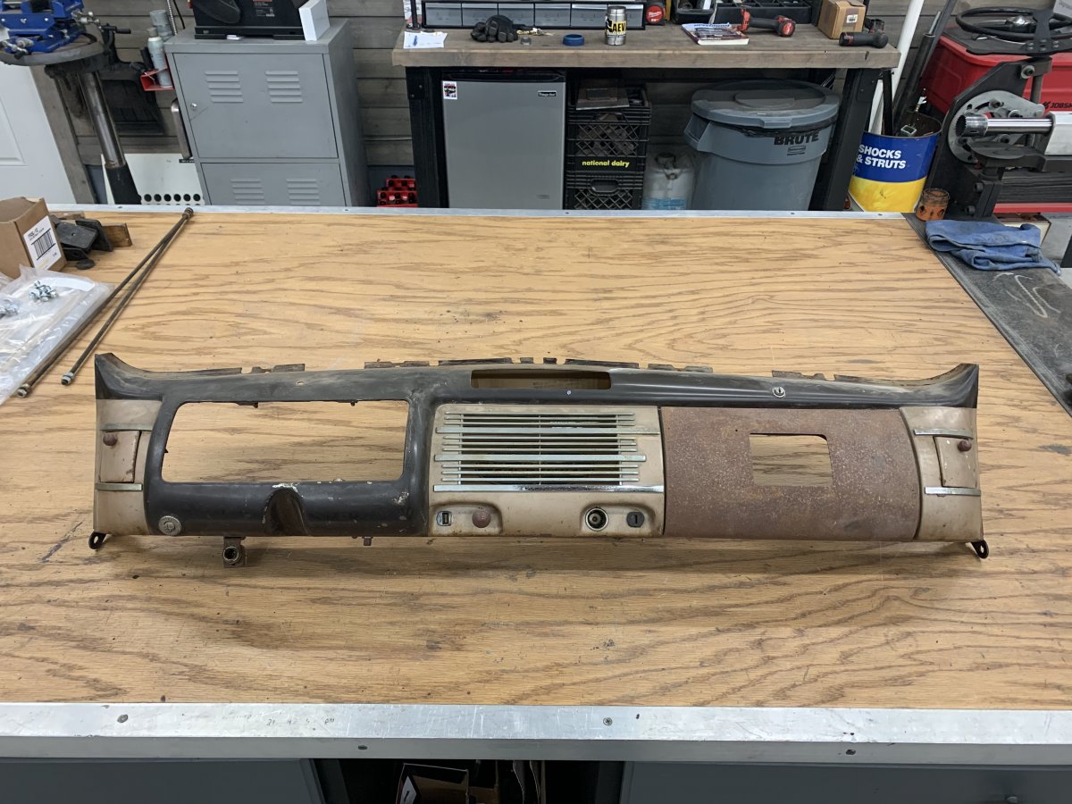

    Here is my dash from my '40 Convertible, if that helps.

    Here are some close up pics of mine from a 40 convertible. IMG_7710.JPG IMG_7712.JPG IMG_7713.JPG IMG_7714.JPG

    Again, I’m ***uming but it looks like the coupe/sedan dash has a more subtle corner that isn’t as pointy as my dash.

    That looks like a closed car dash you have, it appears the ears stick out a bit more, but it's very hard to tell from a picture. I've had them laying on top of each other and even then it's subtle.

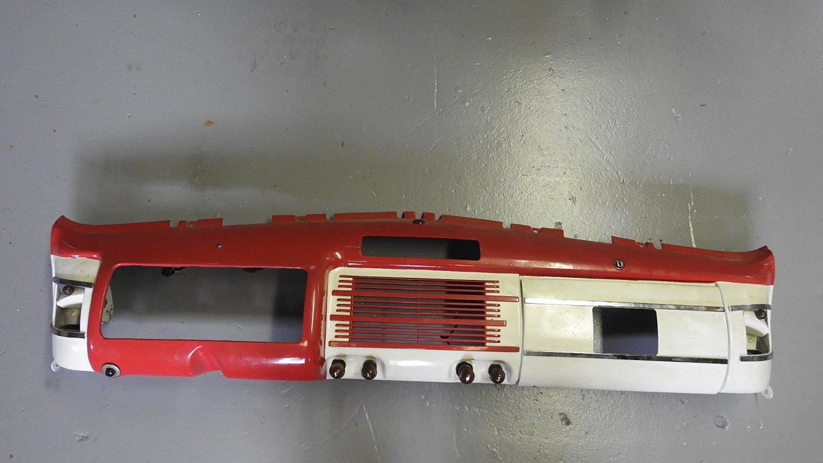

    Maybe these pictures will help. The purple dash is from a Convertible and the brown one is from a Sedan. IMG_6481.jpg IMG_6484.jpg
