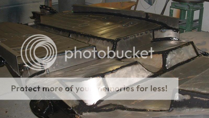

    Floor done.
    Flipped to seam seal the underside.
    Cowl bolted in place.
    Quarter panels blocked up in place.
    Still got a long way to go.
    Thats all for today.I will have more on Friday.:)

    Thanks to everyone for all the nice compliments:) .Today we hung the doors to the cowl so we could kinda set the door gaps and help locate the rear half of the body.Dave made the panels for the tool tray in the trunk(he makes wavy beads too:rolleyes: ) while I was doing some things on the MustangII.

    Doing an awesome job. One question though, why did you not get the body blasted first? I woulda thought it would make the job easier(!) and cleaner.

    wow. the floor looks great. what gauge metal did you use?

    Im guessing 18 ga.

    It will get blasted before we attach it to the floor.The metal is 20-22g.
