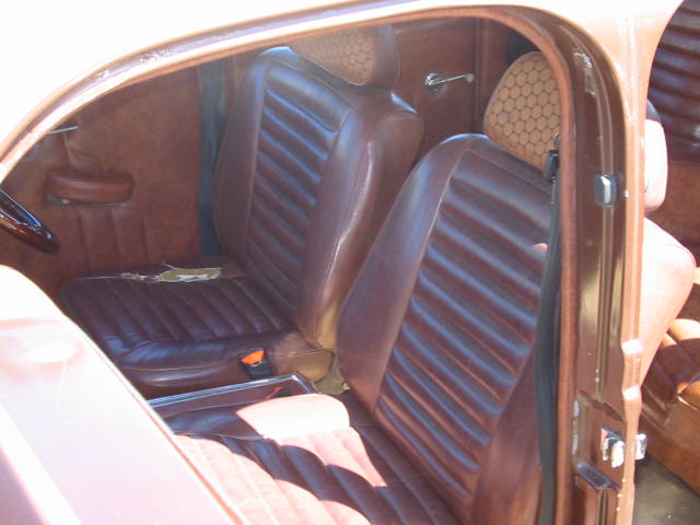

    Very cool and original car. Love all the chrome and trim, that's hard to find these days. I like your plan, get it on the road, get the poly built, and when the time is right do the swap. Stick with a mopar ****** if you can. Good luck!
