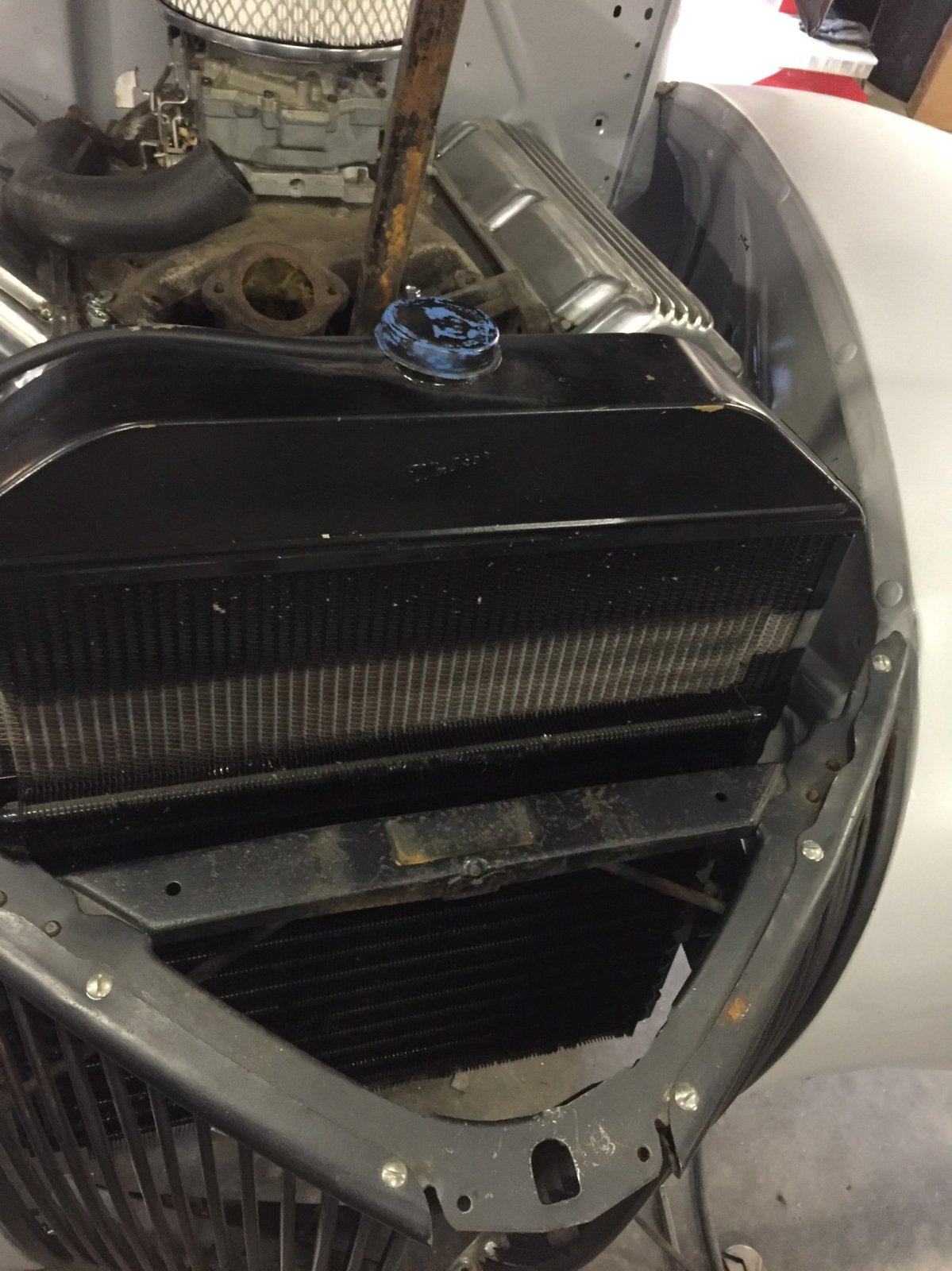

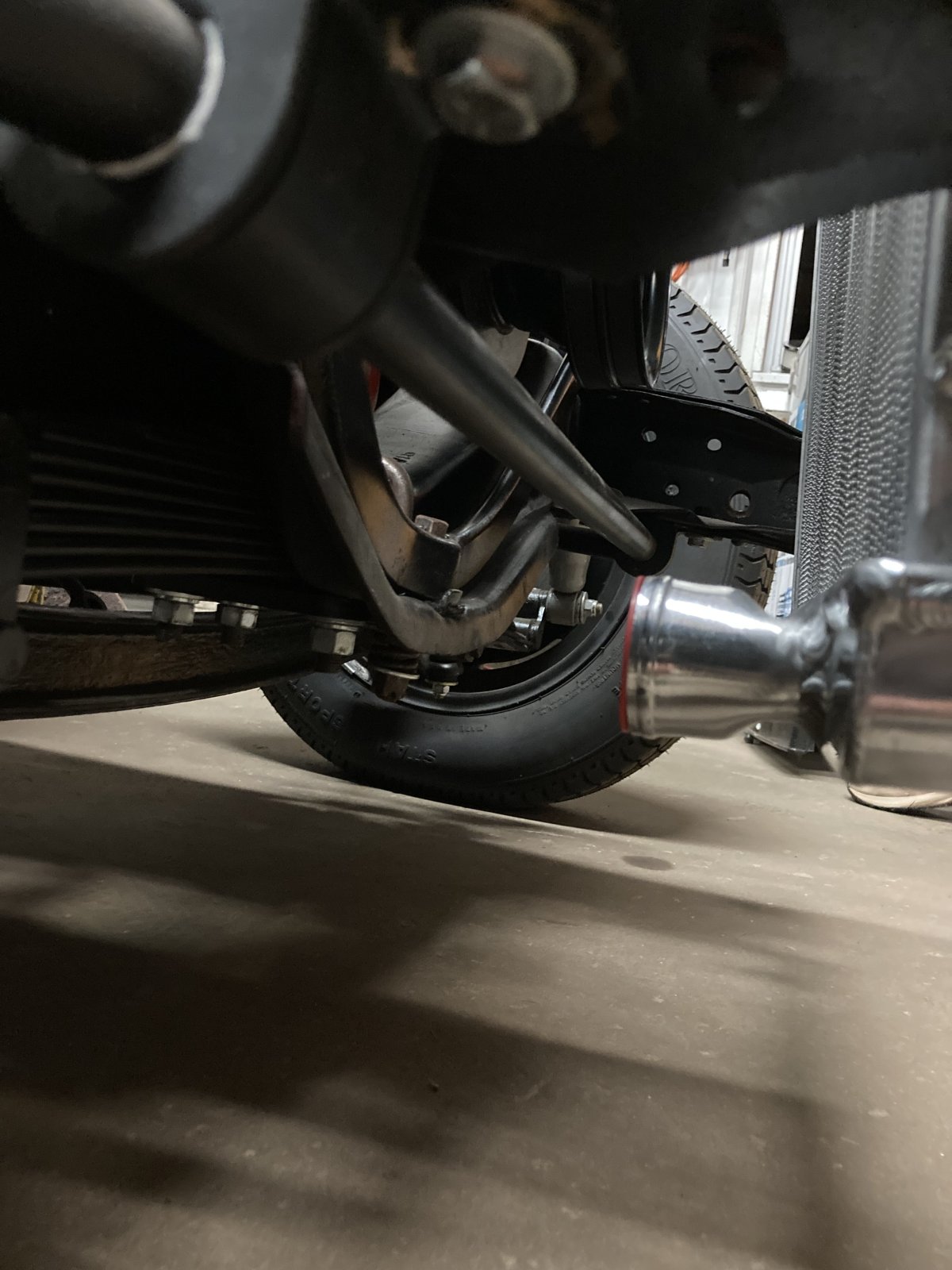

    1940 ford with a sbc. IMG_7863.png What hoses are you guys running, specifically the bottom. I have a sway bar in the way. Modify the lower rad neck and bring it up and over the sway bar? Notch the front crossmember and try to squeeze one between that and the front fender brace? The neck is lower than the sway bar. Pic does not really show that.

    Can you lower the anti sway bar at the frame mounting point?

    Add thick enough spacer blocks between the frame and the sway bar to clear and done. The sway bar won't be affected if the front end is an inch or so lower.

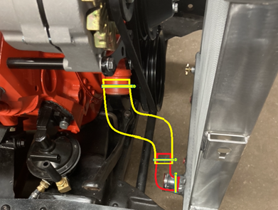

    But just in case you have to have your sway bar, and then get the front end correctly situated, here is a possible 90 degree fitting and hose possibility.
    upload_2023-11-5_1-41-4.png Proportions would be standard sizes…
    This is a quick drawing of how it could be set up. YRMV

    I like the idea of dropping the sway bar, if you can. Past that a different pickup would have to go on the radiator. The sway bar doesn't care where it is, still does the same job.
    A more intense but also free solution, bend the sway bar down between it's frame mounts. Would a drop equal to the diameter clear things up? Heat, bend, slow cool, no worries. Last, I'm guessing you can't raise the radiator or you woulda done it by now.
    I was staring at the bar to shock mount distance. Looks close, maybe blocking it down is the way.

    Can you pull the shock so we can see the lower attachment for the sway bar? If you drop the sway bar, is the spring going to interfere?

    Fundamentally the spring and sway bar should move in unison. It's far enuff outboard it shouldn't be a problem.

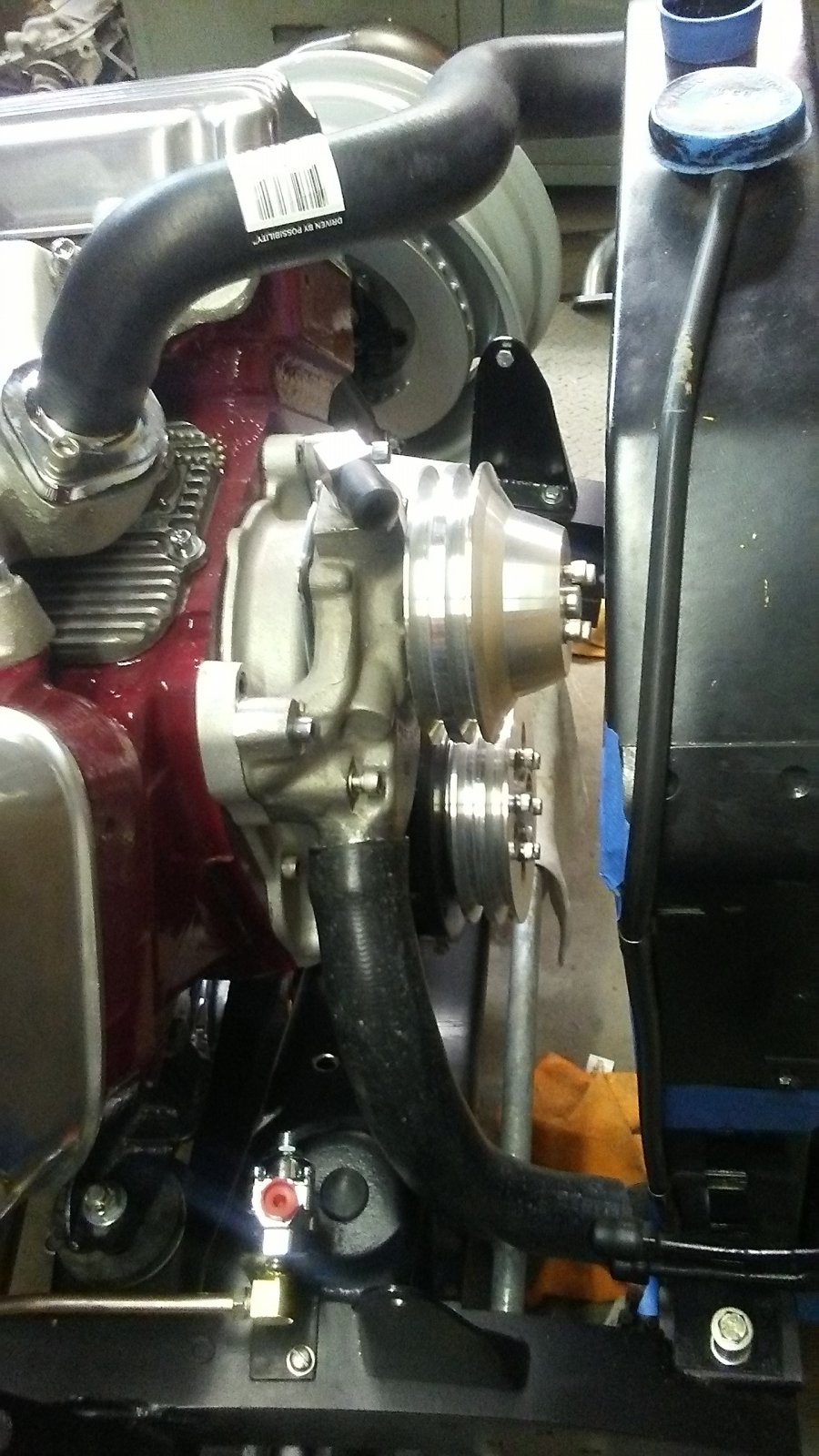

    Not a SBC, but a Desoto with SBC pump in my 41 truck.
    I’ll be doing the same with the SBC I’m switching out now in my 40 Coupe. Just use a stock 45* water outlet.
    The truck has 1” spacer for the front sway bar and the Walker radiator raised a little for clearance .
    Upper Gates 23234
    Lower Gates 21956

    Thanks for all the comments, much appreciated. The sway bar is a ch***is engineering piece. I may be able to add a block between it and the frame to lower it a bit. The radiator is a Champion. I have used them in the past on other builds and I like them. This truck had no radiator so it did not occur to me that there might be interference when we added the sway bar. I am thinking of changing the lower outlet on the rad to a 90. Might make things easier.

    Looking at it from that angle puts a totally different prospective on it than the other shot did.
    I'm thinking that you need to wait to set the nose on before putting the radiator on though. It looks like yours is sitting way lower than it should right now.
