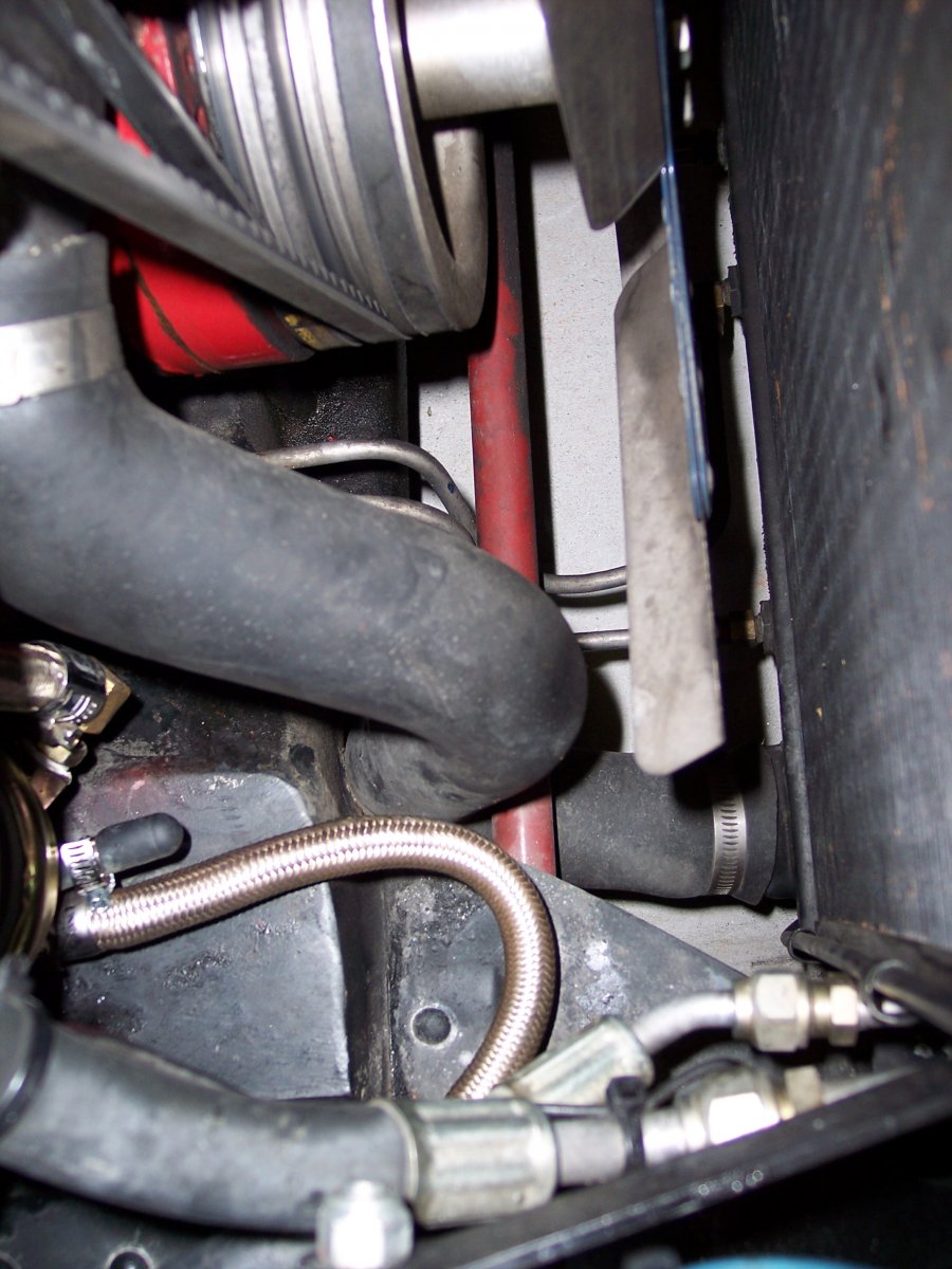

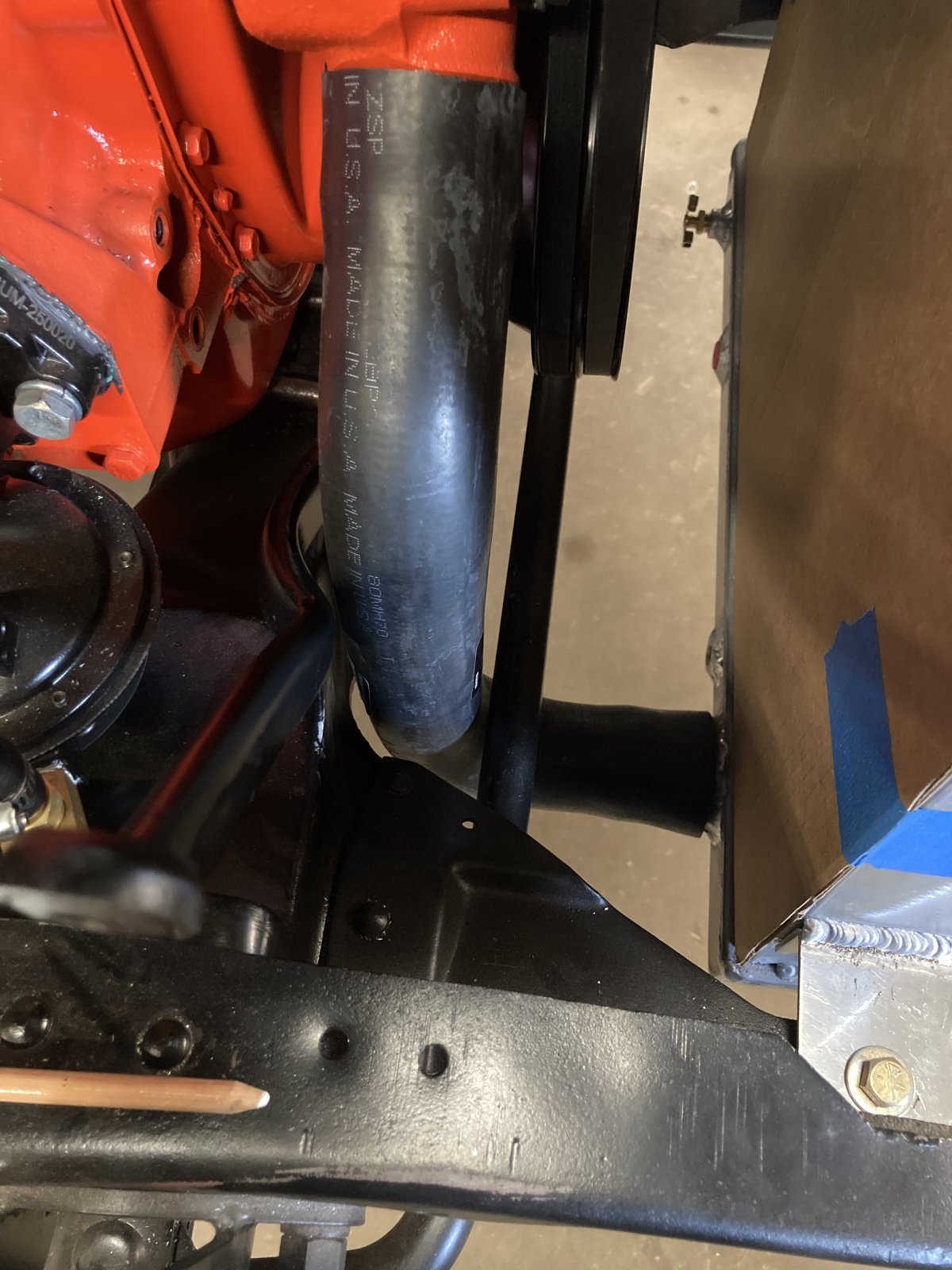

    Found this pic on the web. Looks just like the issue I have. Looks like he notched the front crossmember. IMG_7896.jpeg

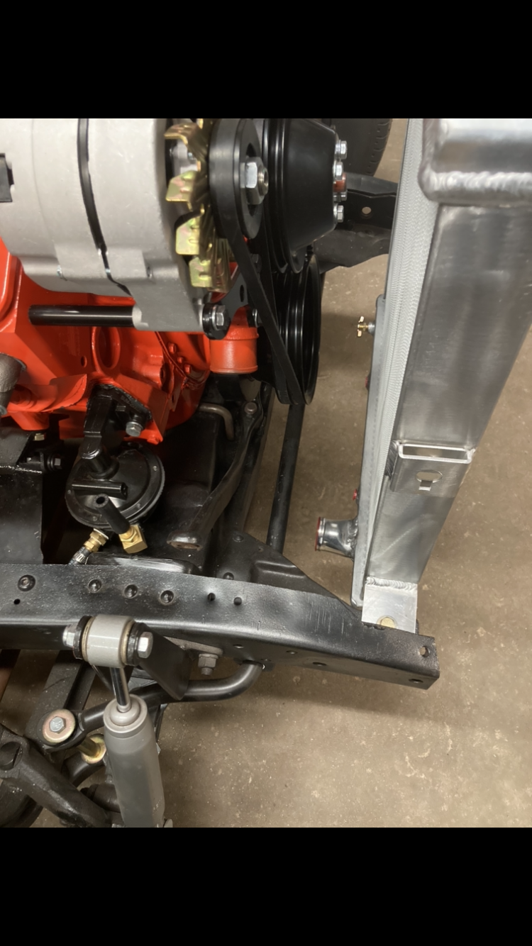

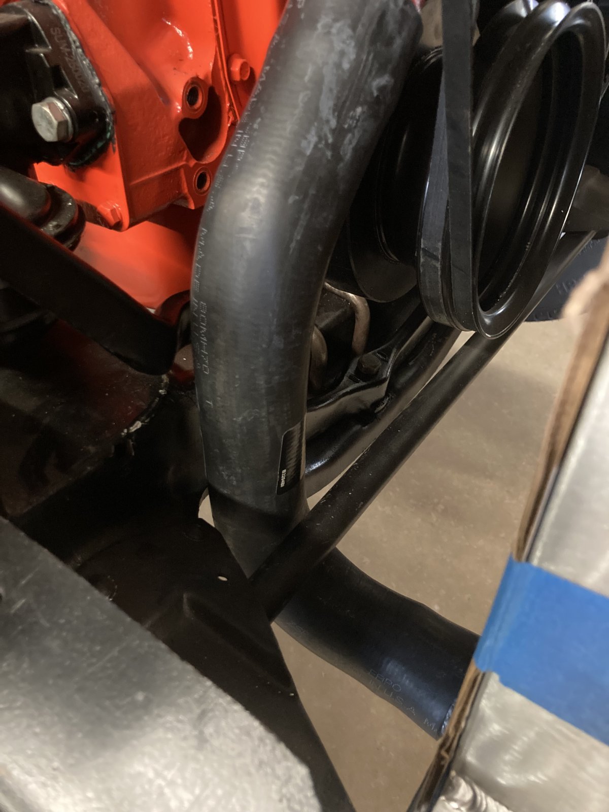

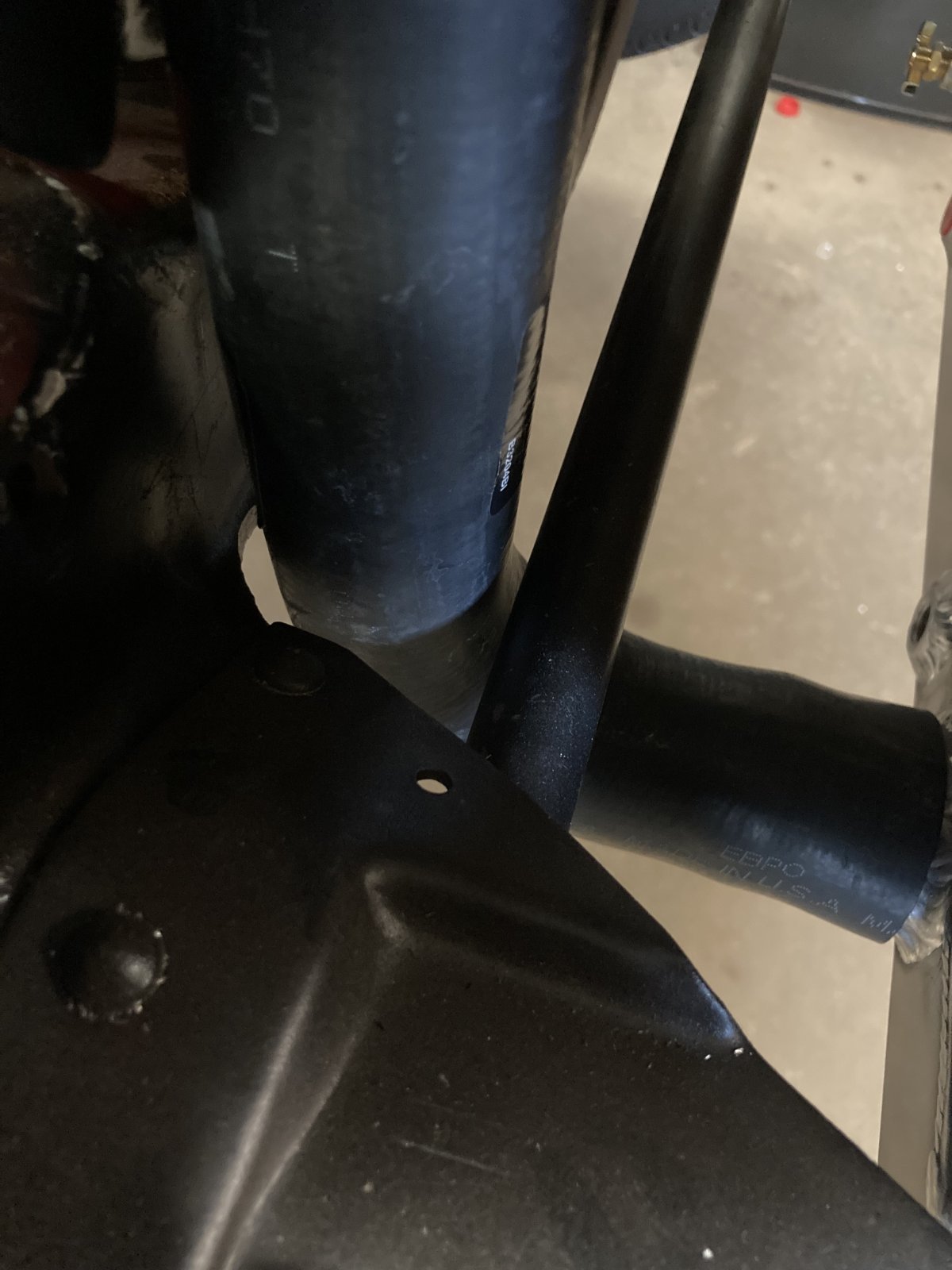

    This is what I ended up doing in case anybody is interested. Pulled out the V fender brace and put a curve it it to miss the hose. Cut a small arc out of the front crossmember to allow clearance as well. Grabbed some hose pieces I had laying around and taped up a mock-up hose. A Gates 20345 matched the mock up and it is in. Everything has plenty of clearance, nothing touches. I did not want to raise the radiator as it has brackets on the side that a factory brace connects to that runs to the V brace. IMG_8011.jpeg IMG_8013.jpeg IMG_8014.jpeg

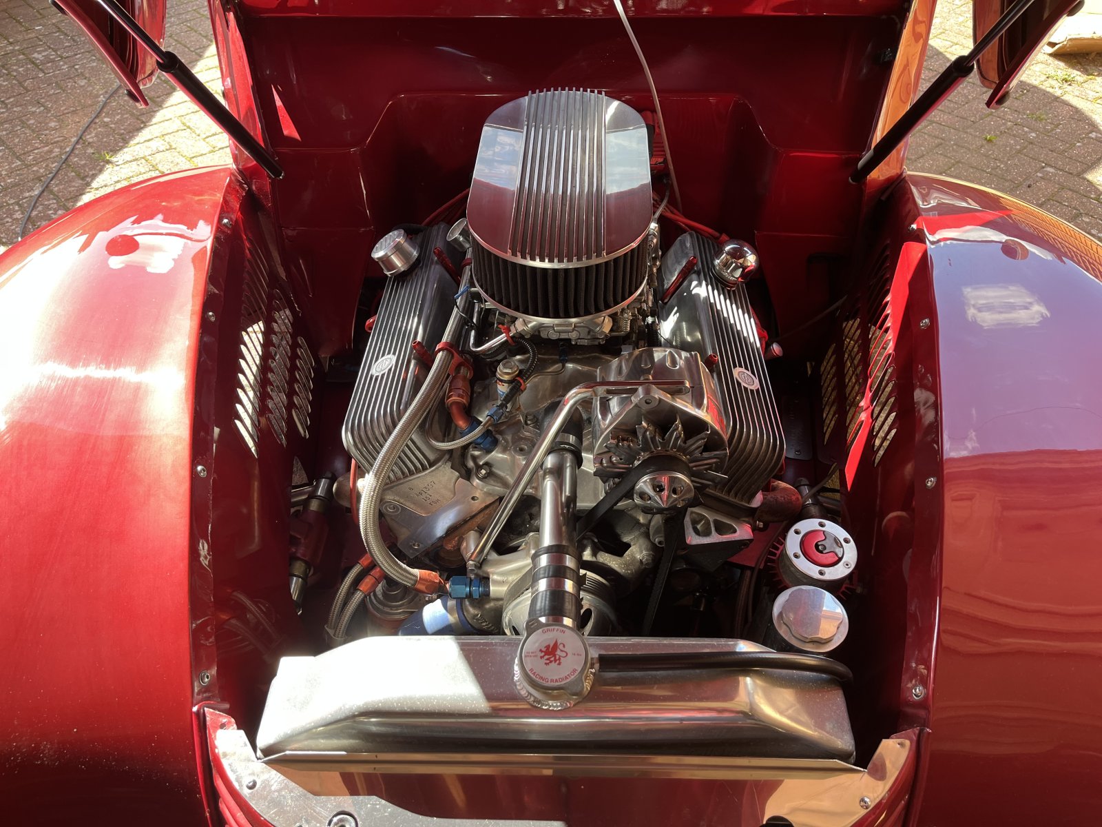

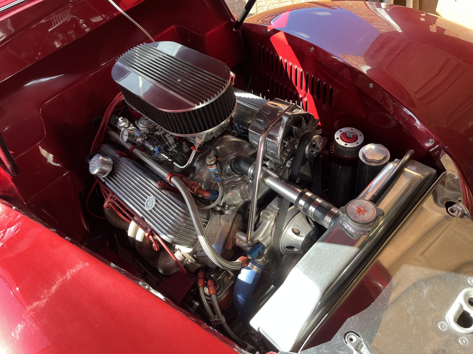

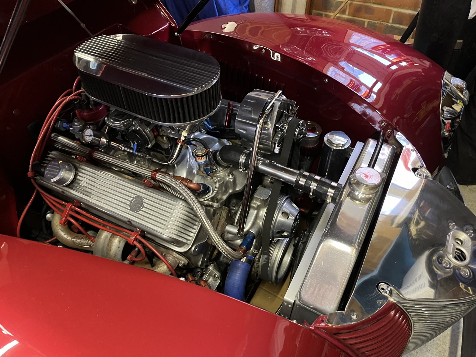

    I have a 1940 Ford with a Chevy engine. It has a Walker radiator with a 90 degree lower connection which is fabricated so it leans back towards the engine. What hose will fir that application?
