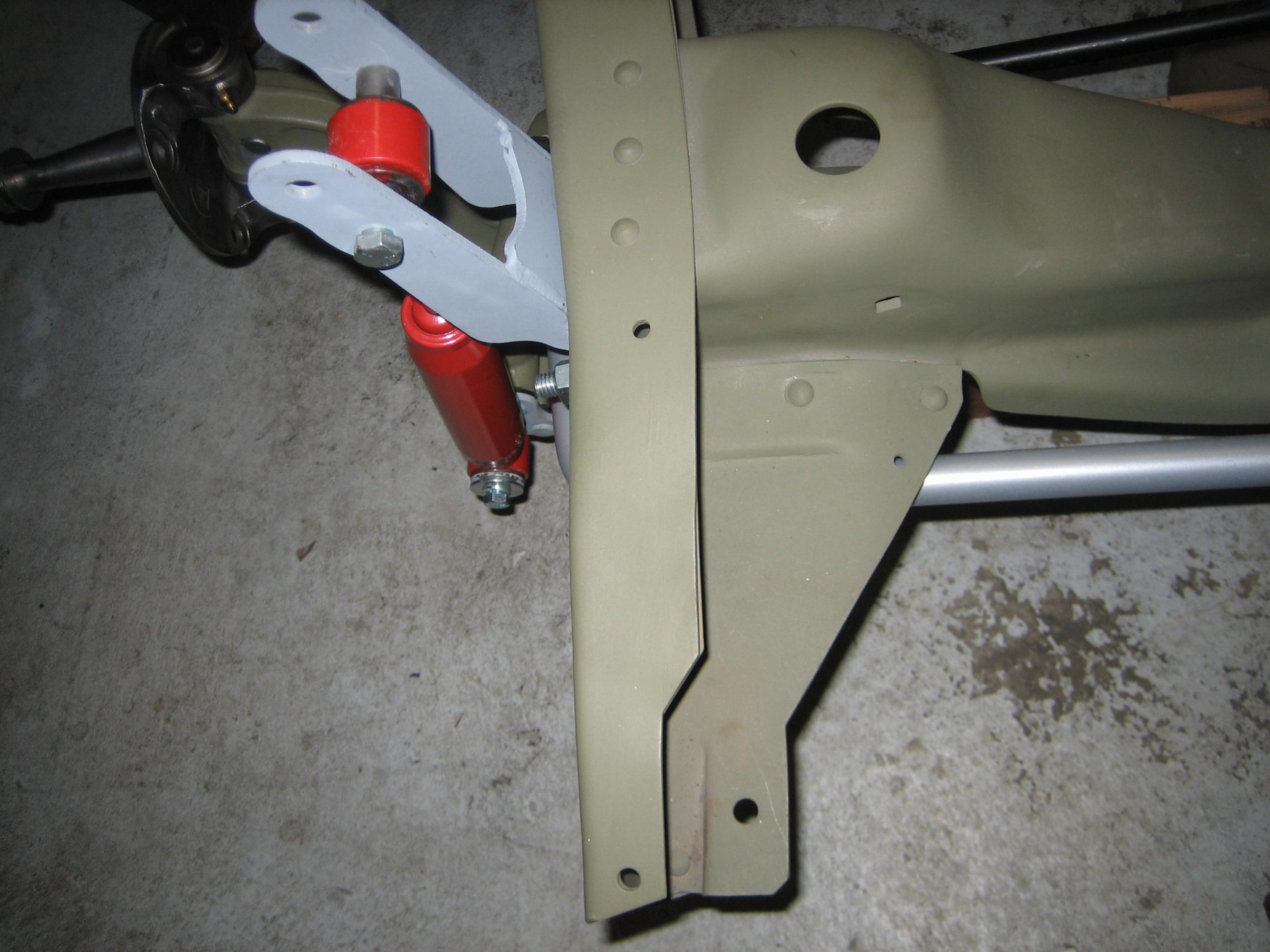

    Well tonight, I drilled out the rivets for the V8-60 motor mounts, and drilled the frame for the Ch***is Engineering stabilizer bar. I decided to sit my 90hp radiator on the frame, and quickly found out that I don't know all of the differences between a 60hp and 90hp radiator. The radiator sits too close to the front crossmember, with no chance of a lower hose going on.
    I grabbed my Green Bible, and ran through the parts numbers. First, I found out that the braces that go from the radiator to the inner fenders are different.....I'm guessing longer, which would push the radiator farther forward. The lower pan is supposed to be different too, though I'm not too sure that I just couldn't modify my 60hp pan. Finally, the radiator pads that are riveted to the frame are supposed to be different too - I'm guessing they have a mounting location farther forward as well. I did find it interesting that the 90hp is the only car to show having side air deflectors, which my 60hp has?
    Anyway, I guess I'll be tracking down some 90hp parts tomorrow. Does anyone happen to have a photo of the radiator pad (like in my second photo) that's riveted to the frame? I'm wondering if they're close enough that I can just modify my 60hp pads....

    Cory- here is the stock radiator mount on my '40 coupe ch***is. You will see the C.E. front sway bar, and shock kit also. Same setup as yours, dropped axle, etc. Steve

    Thanks for the photos Steve - that's exactly what I was looking for. I wonder if anyone reproduces those? I'm going to call the vintage Ford parts place I deal with today to see if they have any originals.

    I was able to locate the pads that rivet to the frame today, and the braces from the radiator to the inner fenders.....original pieces too. After I got that sorted out, I finished the welding on the wishbone, and metal finished the worked area. Also, per Danny's suggestion, I added a gusset to the CE shock mount to prevent any cracks.
