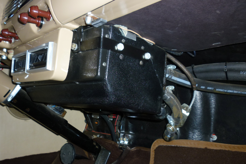

    Here are some photos of the AC installation in my Coupe. Not as nice as olscrounger's, but it works okay for me. I used an Airtique HC unit, and modified it by adding vent outputs on the front of the box, and placing the defroster outputs on the top. I made my own under dash vent panel. The ashtray vents are from Vintage Air (Please excuse the dust!). Most of the cool air comes out of the under dash vents (The path of least resistance!). The cowl vent is activated by a motor. The unit sits below the full-sized glove box, hung by straps attached onto the top edge of the cowl where the dash attaches. I don't know if Airtique is still in business; their units were not as sophisticated as Vintage Airs. If I want windshield defrosters, I have to shut the side and bottom dash vents and turn the fan on high! It would be much nicer to have a defroster control more like modern cars (Turn a knob and they work!). The brackets used to mount the AC compressor and alternator are from Alan Grove.

    How do the set-ups with using only the center vents behind the speaker grille work out for air flow? Or, are their other hidden vents I am not seeing?

    RichB--two other vents/hoses near kick panels

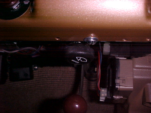

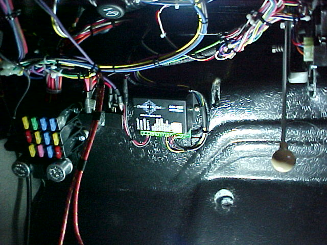

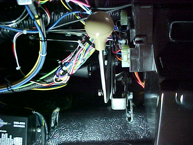

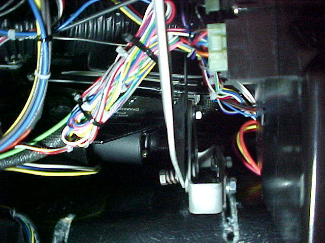

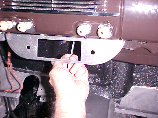

    Yeah Tim, I'd like to see how you mounted the system behind the dash and still retianed the cowl vent with the stock linkage. I see you have the unit as far right as you can get it. I guess that's the key. Sorry for being a pain in the ***!:eek:

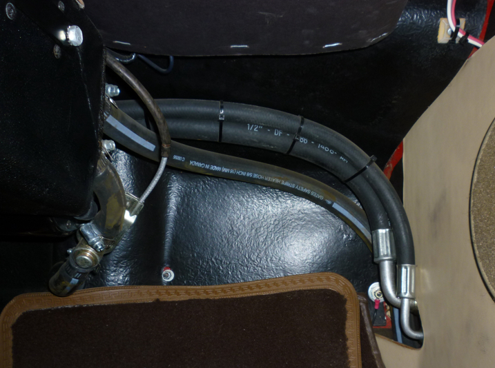

  10. olscrounger
    Joined: Feb 23, 2008
    Posts: 4,840
    olscrounger
    Ol 55-- a few pics---one is my 40 and the others are current project--excuse the wiring not done yet

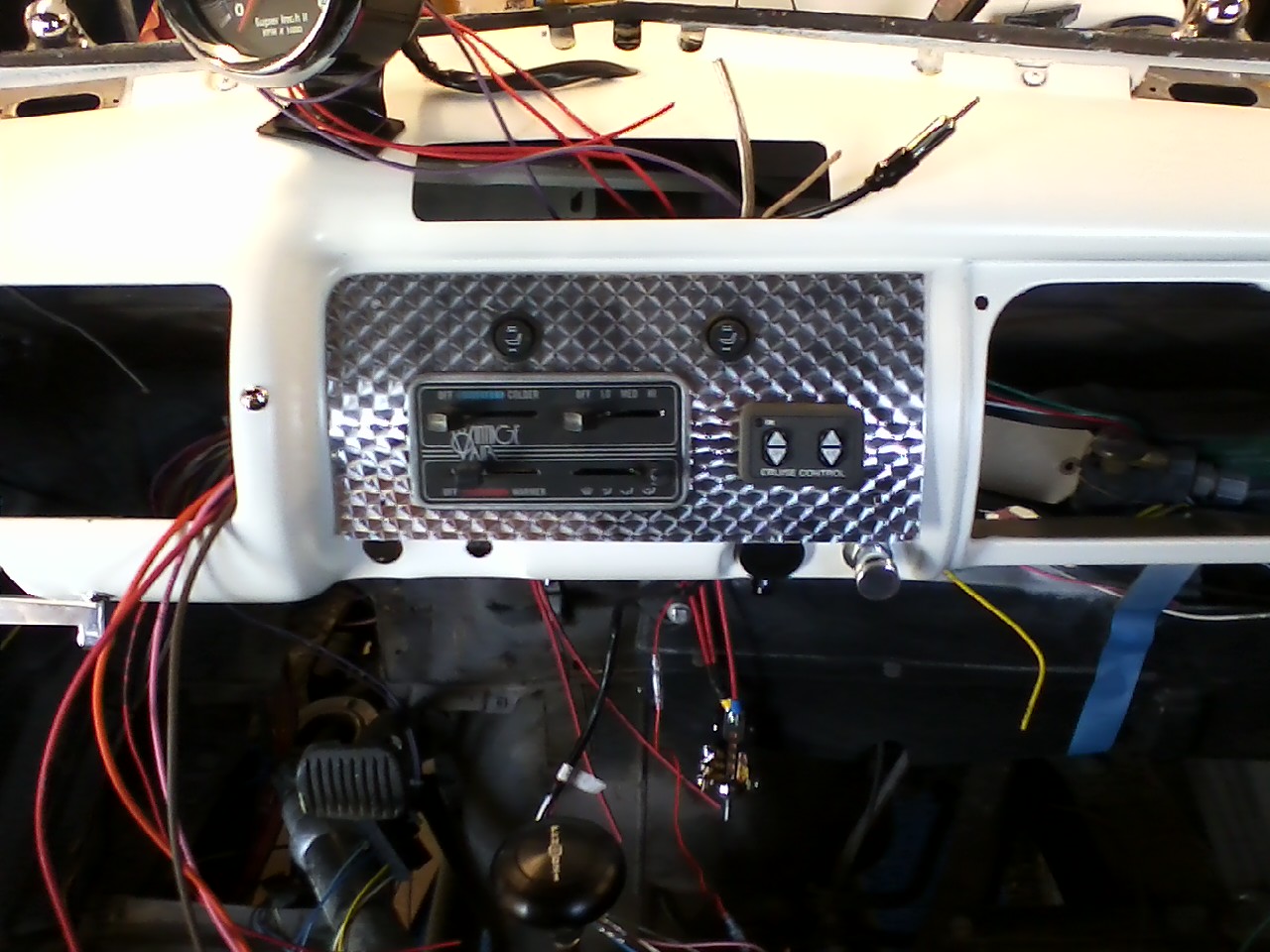

    just finished this panel to take the place of the speaker grill. started with a piece of machine turned aluminum from Speedway Mtrs. did template on back then cut holes. holds vintage air controls, cruise control switches, and seat heater switches.
