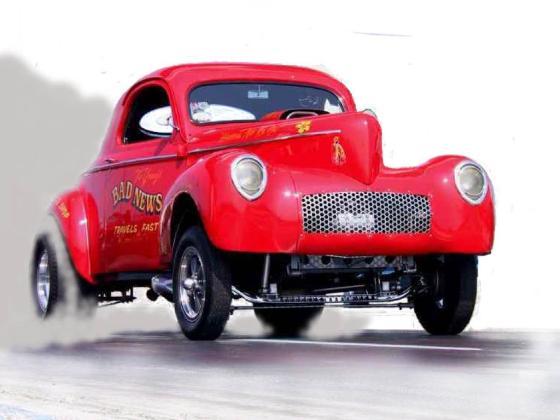

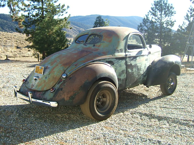

  19. Not little faith, just a hard one to find. Good luck! You are going to run a Y-Block of course. :D
    I like this one, certainly not like all the rest. ;)

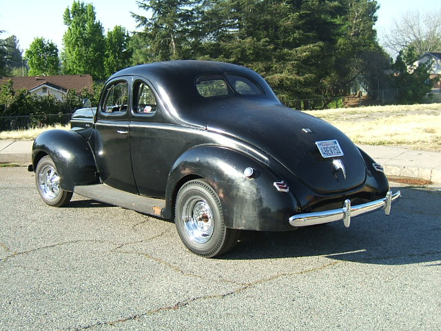

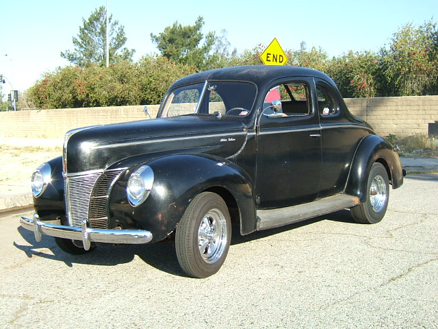

  24. You probably have your heart set on the Willys but I would go along with the '40 Ford idea myself, always been one of my favorites. :)
    I even got a 59A all built sitin' in a crate for it. ;)
