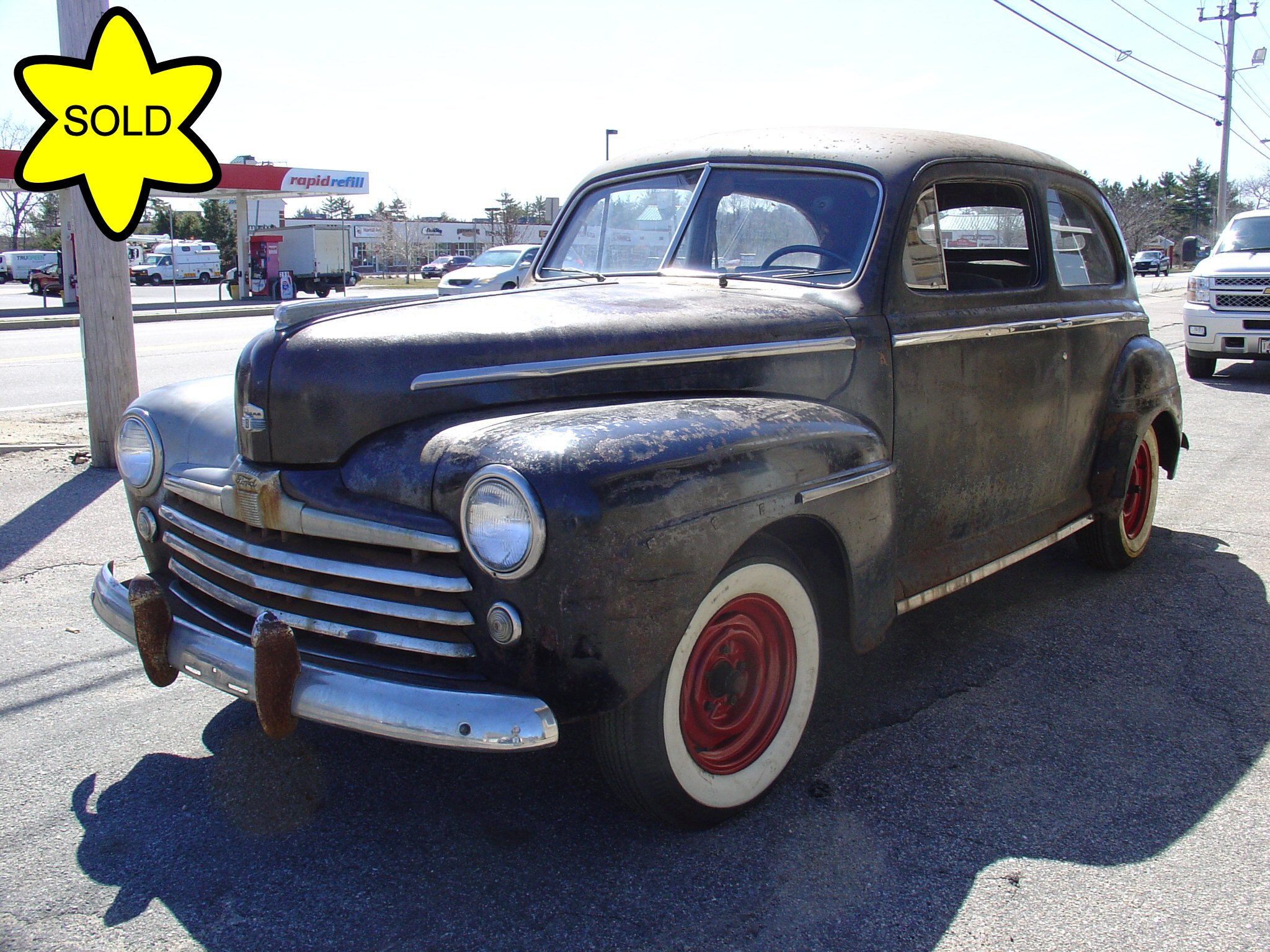

  23. bchrismer
    Joined: Jun 1, 2007
    Posts: 2,835
    bchrismer
    Hey Vetteman61,
    Not my car, but I saw this one on Craigslist out on Oklahoma City for $11,000.
    A dropped axle and reversed eye springs and you would have a great starting point for your daily driver.
    bc
