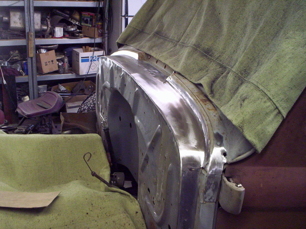

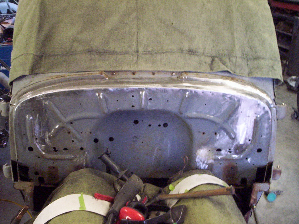

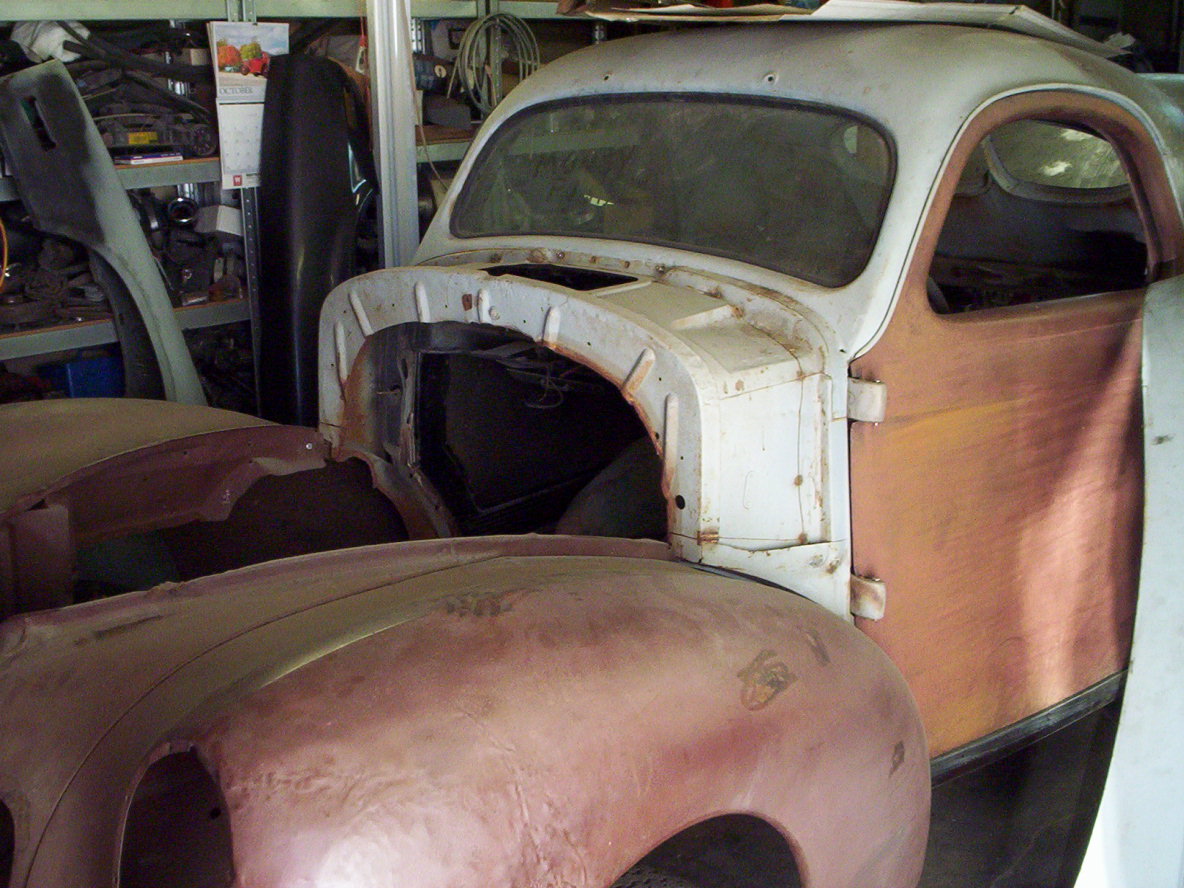

    I found a pic of the firewall before

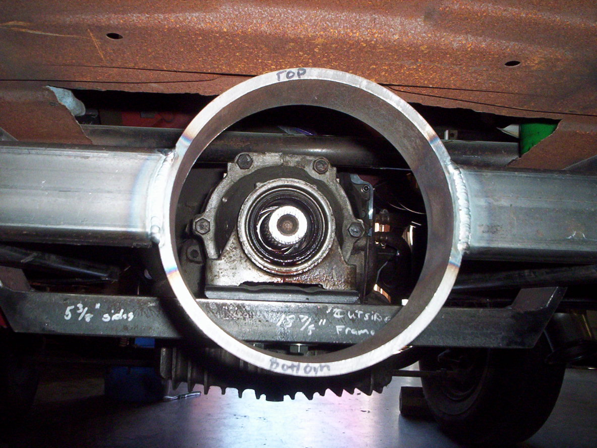

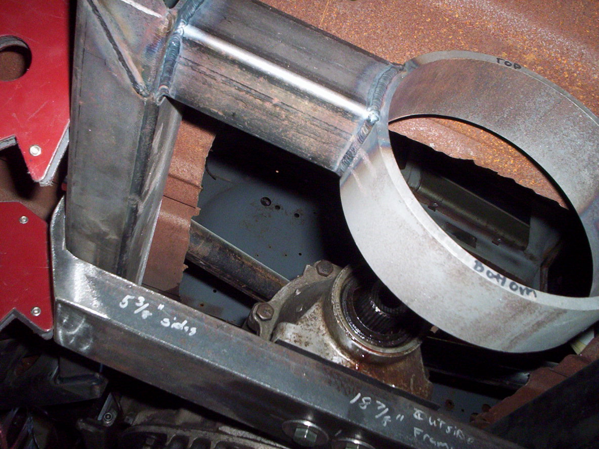

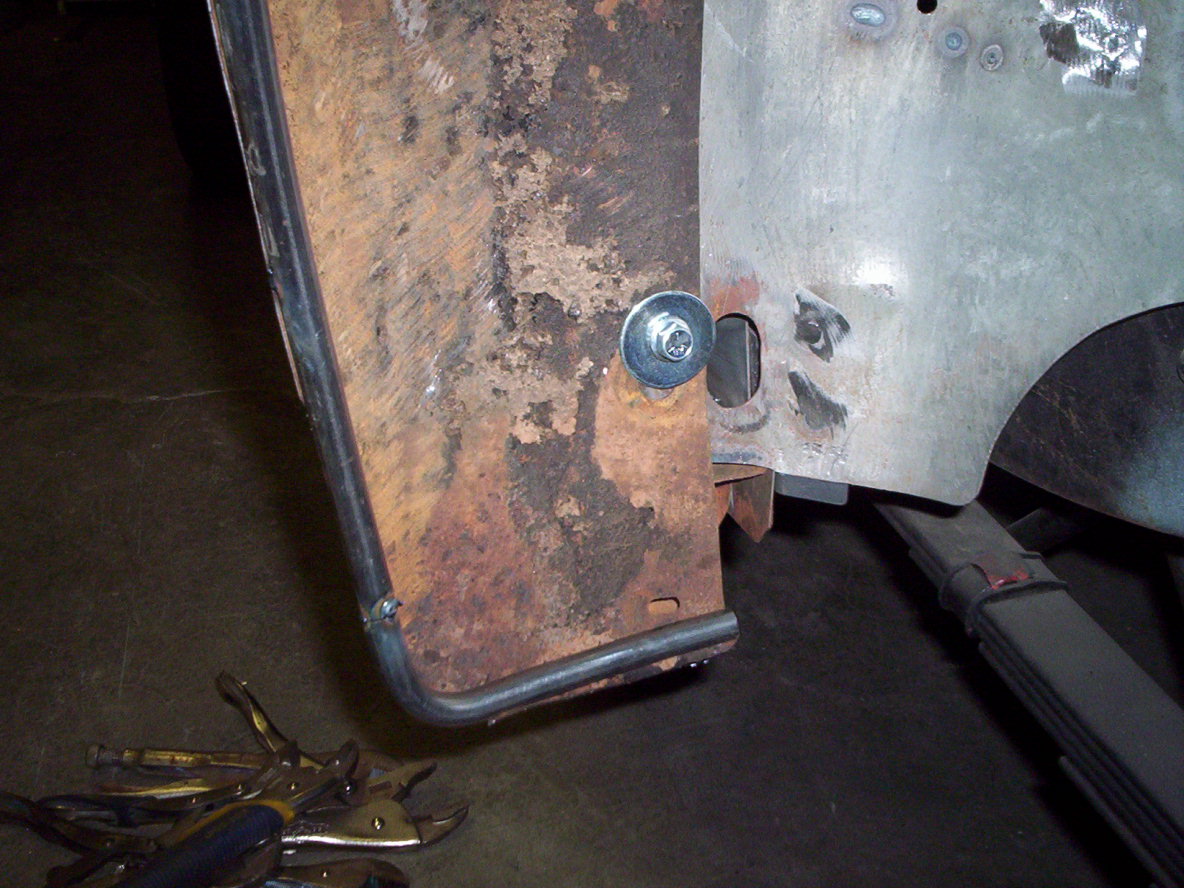

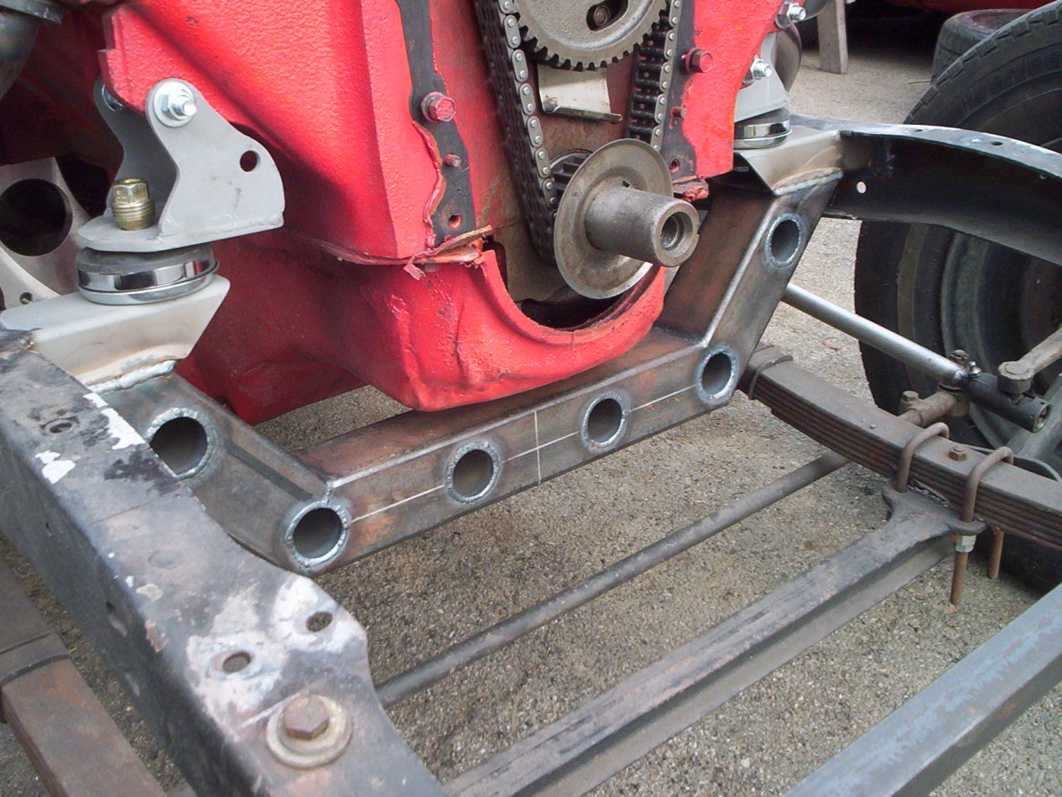

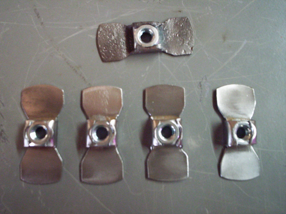

    These are the captured nuts I fabbed to bolt on the rear fenders .The one on top is the original.Also mtrmnt crossmember ,and driveline loop..

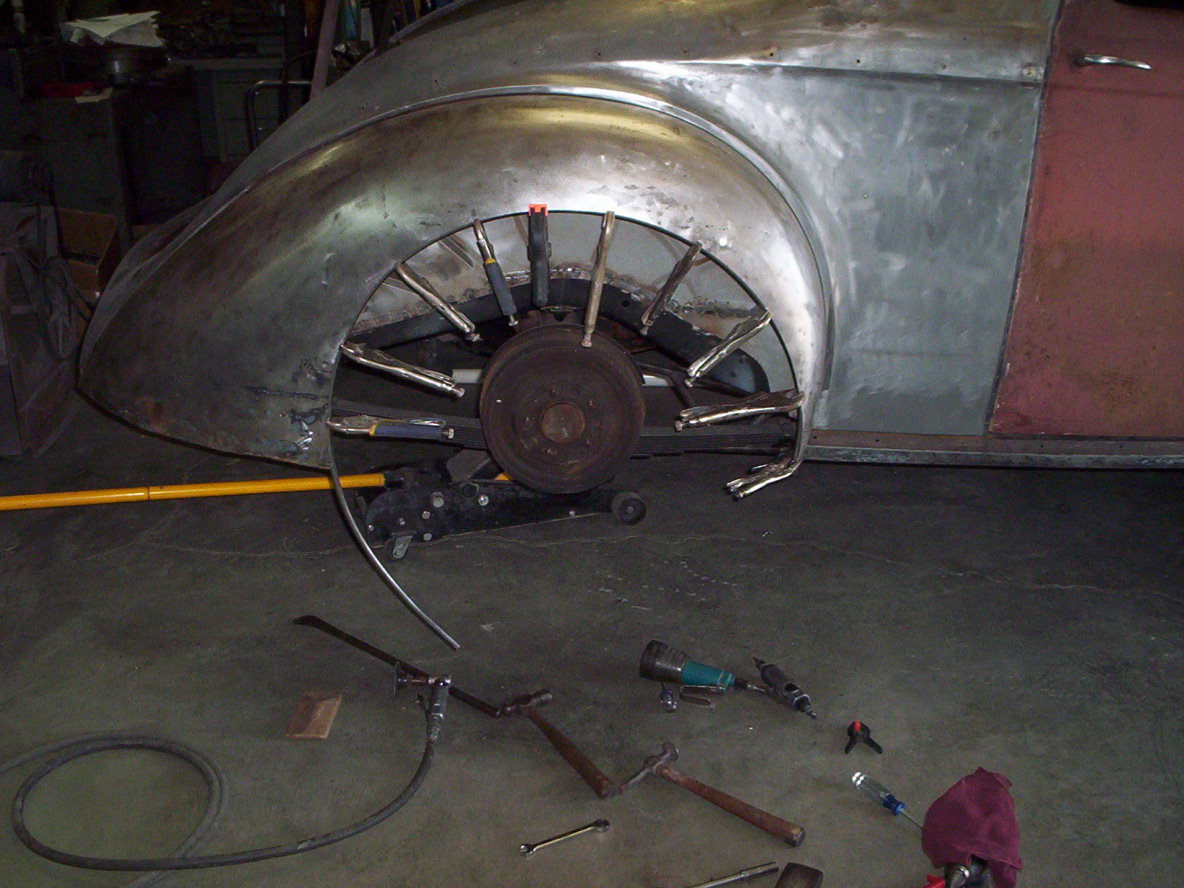

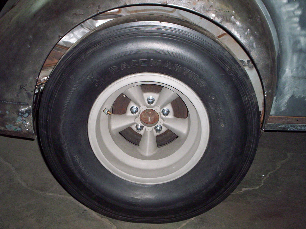

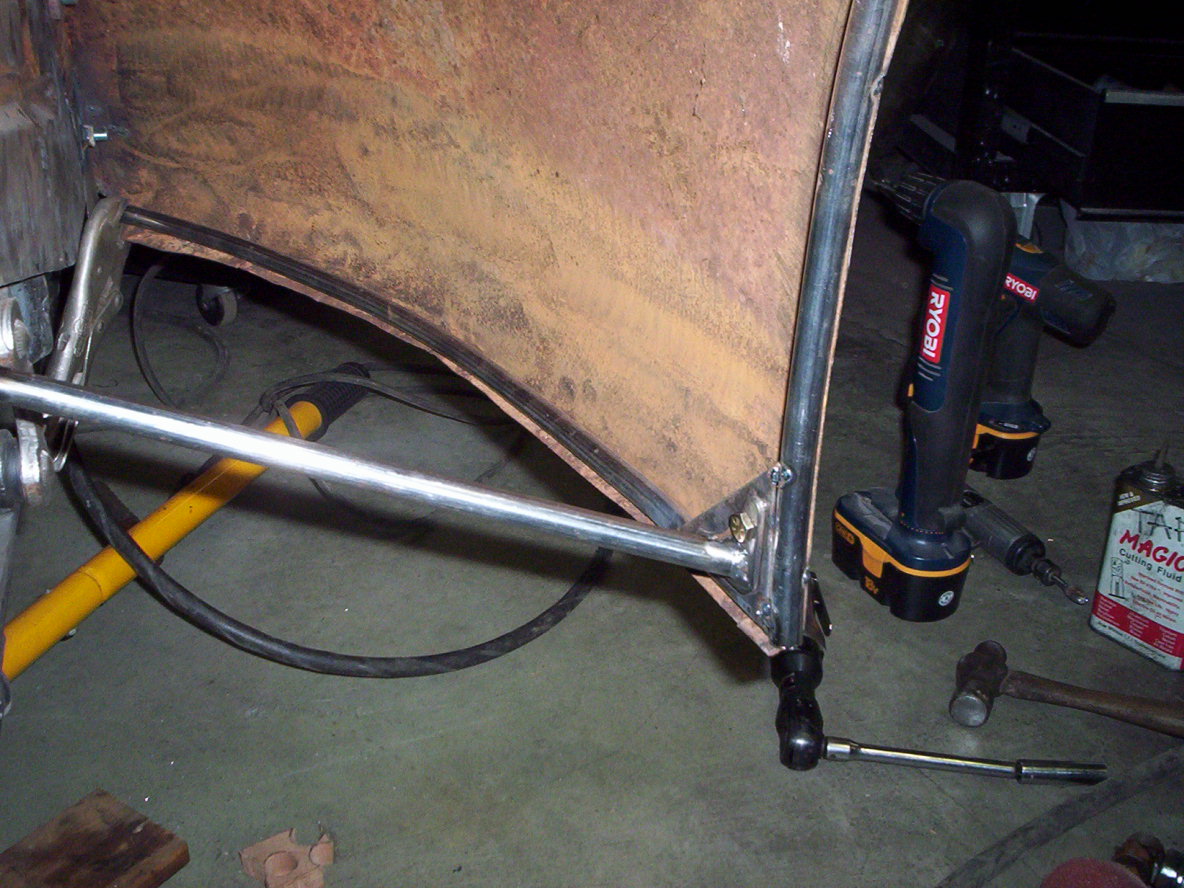

    Cutout rear fender for tire clearance.Added 1/2" x16ga.tube around perimeter,and along bottom for strength.Also fender brace.Pics are of both sides.
