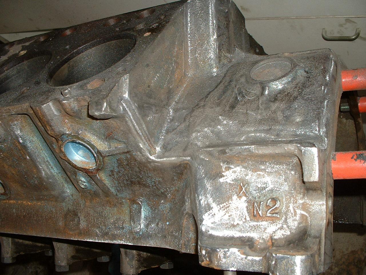

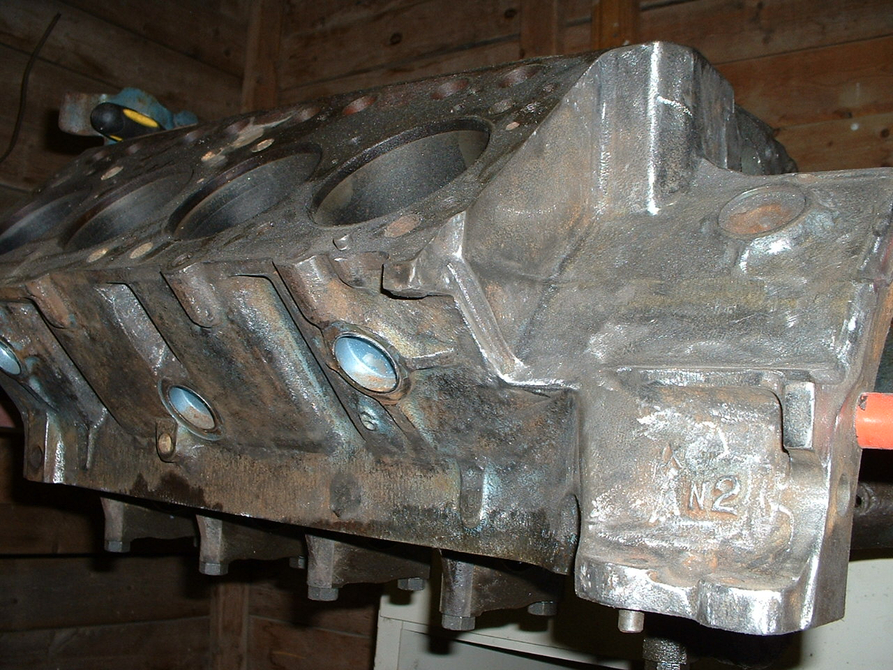

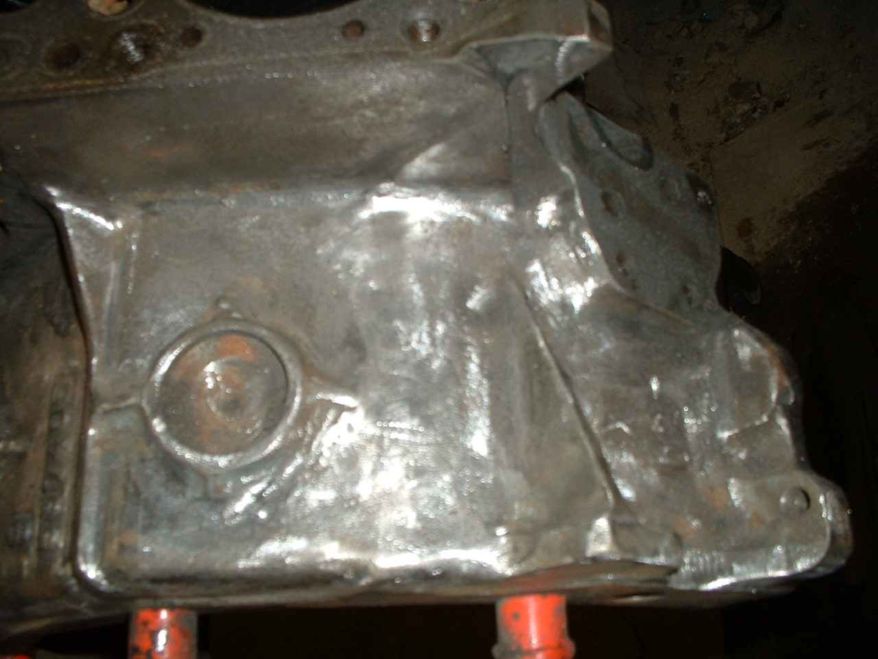

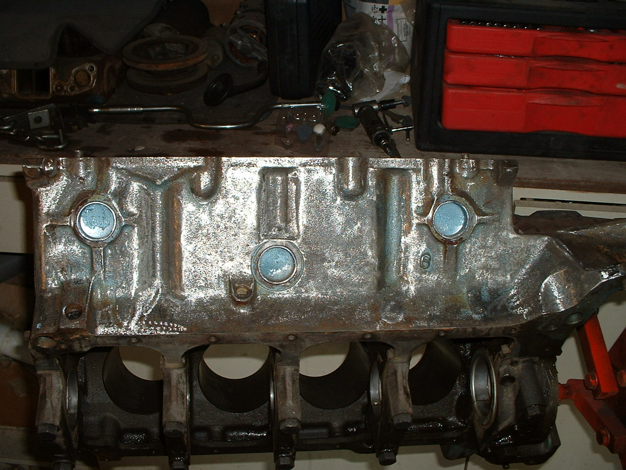

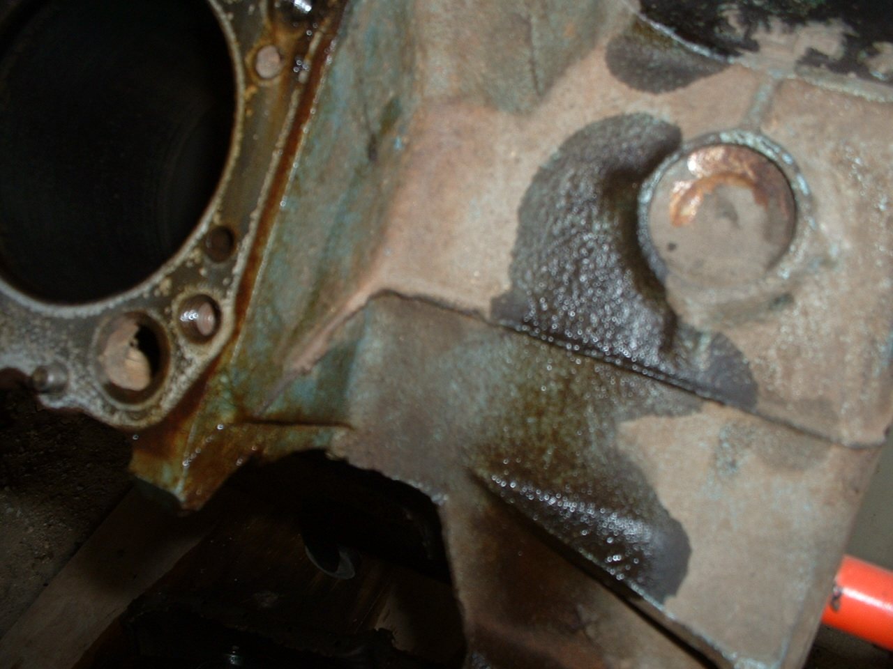

    Finally made to time to work on the Willys again...
    Here are some before and after pics of the block.
    Have about 2 hours of sanding with a die grinder on it right now. Looking to take all the casting ridges out of the block, heads, and front cover.

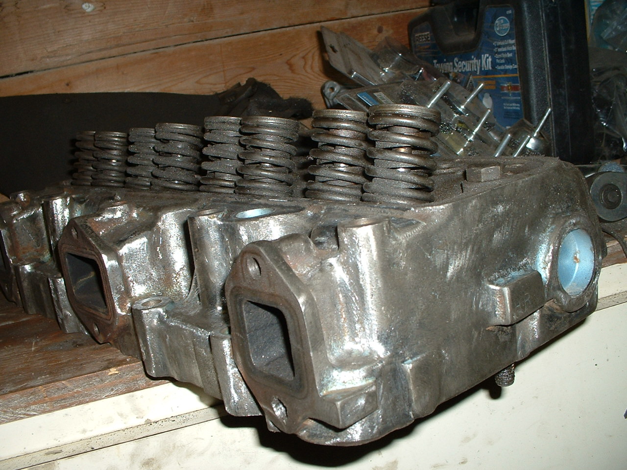

    Here are some updated Pics.
    Block is pretty much done and one Head is done.
    I have about 8 hours in it right now.

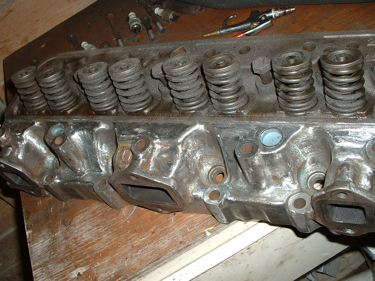

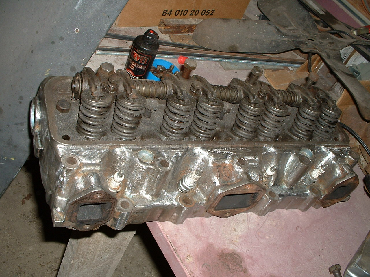

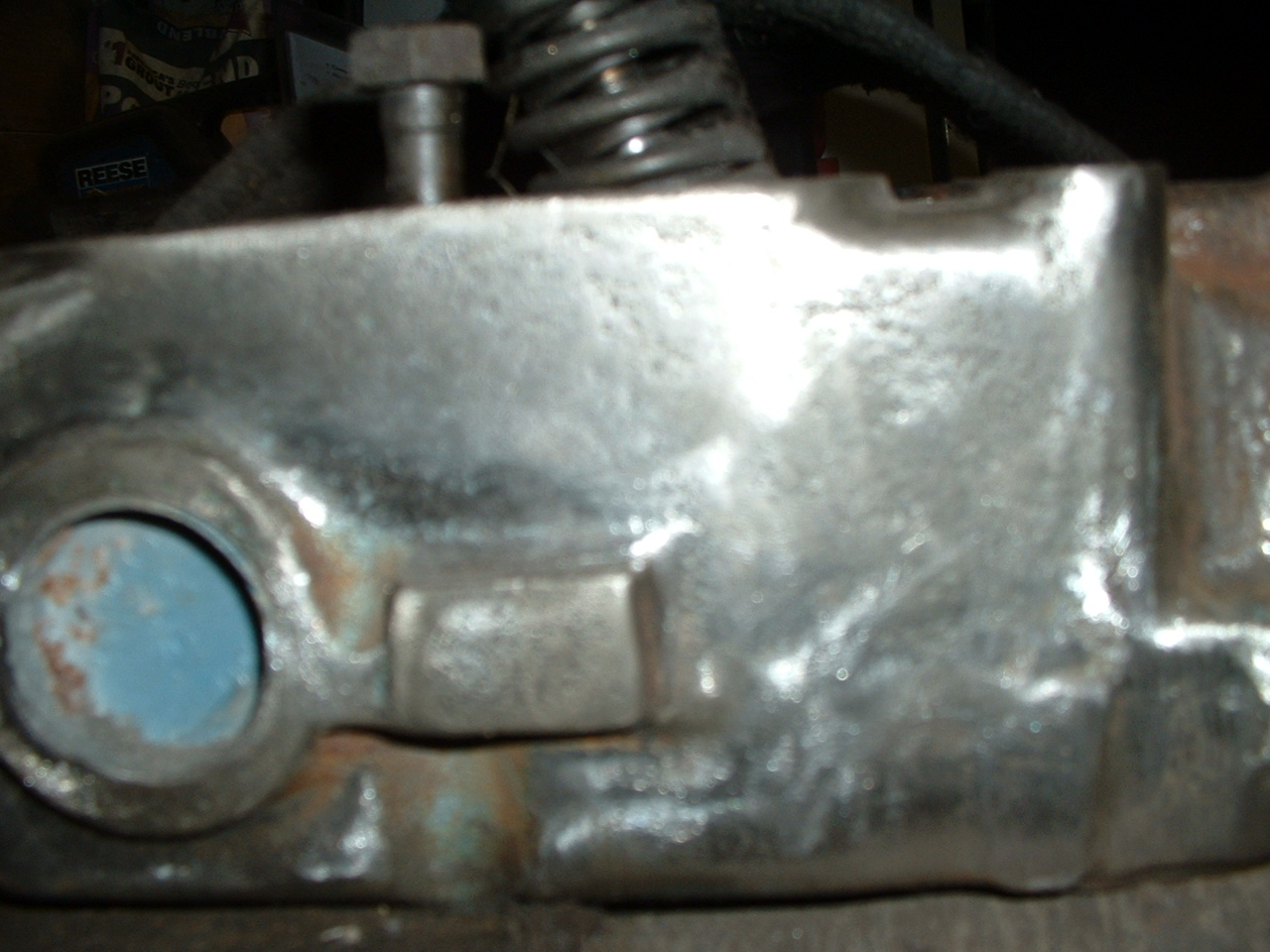

    Got a little more done last couple of days. Heads are done just need to go over them with a real small bit and clean area around "10" casting.

    I've done this job quite a few times now so i feel your pain !!!

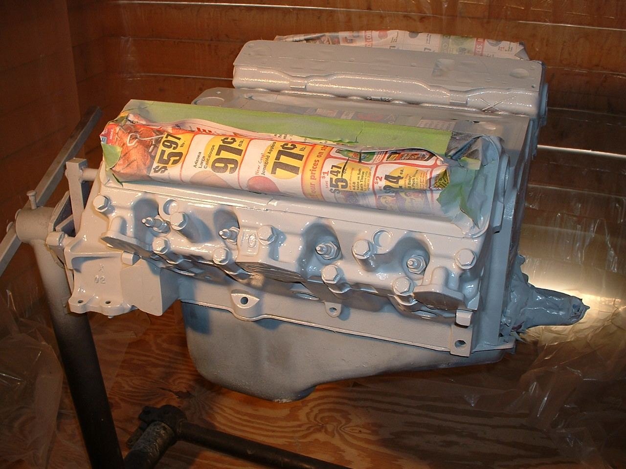

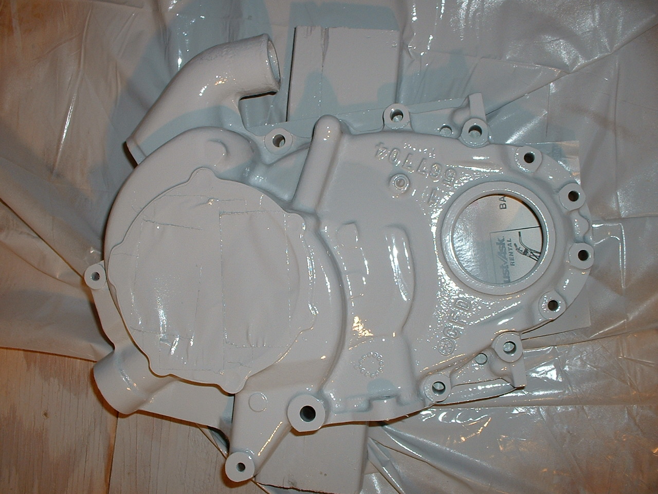

    Here is the engine with 2 coats of Epoxy Primer. Going to smooth up the transmission case and Primer that then, finish ***embly and see how this old dog runs!

    Looks impressive, well done.
    Just a small tip. If you go wet on wet on top of the epoxy with your topcoat you will save yourself a lot of rekeying.

    Engine looks great! Can't wait to see the final paint on it!

    Engine is looking good, a lot of work smoothing a block

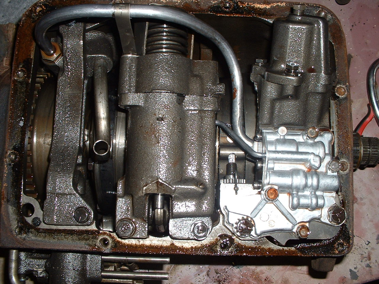

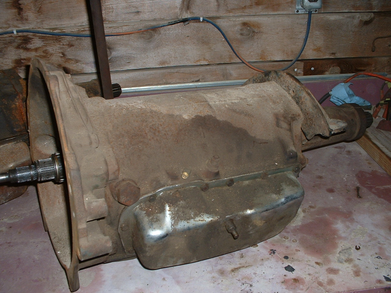

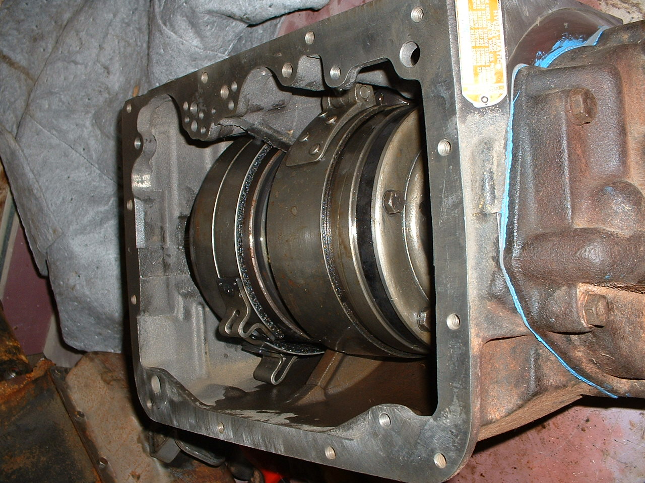

    Here are some pics of the trans when I started the tear-down. I already got it apart, inspected and mostly back together with new seals.
    I just need the tools to adjust the front and rear bands.
    Going to smooth the case tomorrow, then Prime!!!
    Will post pics of that also.

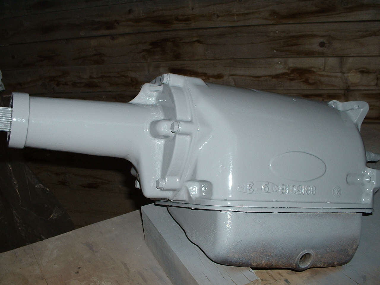

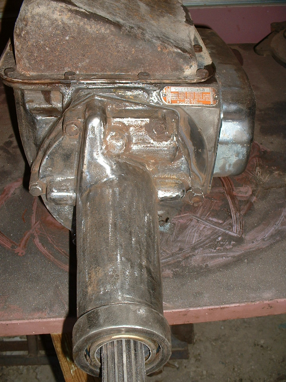

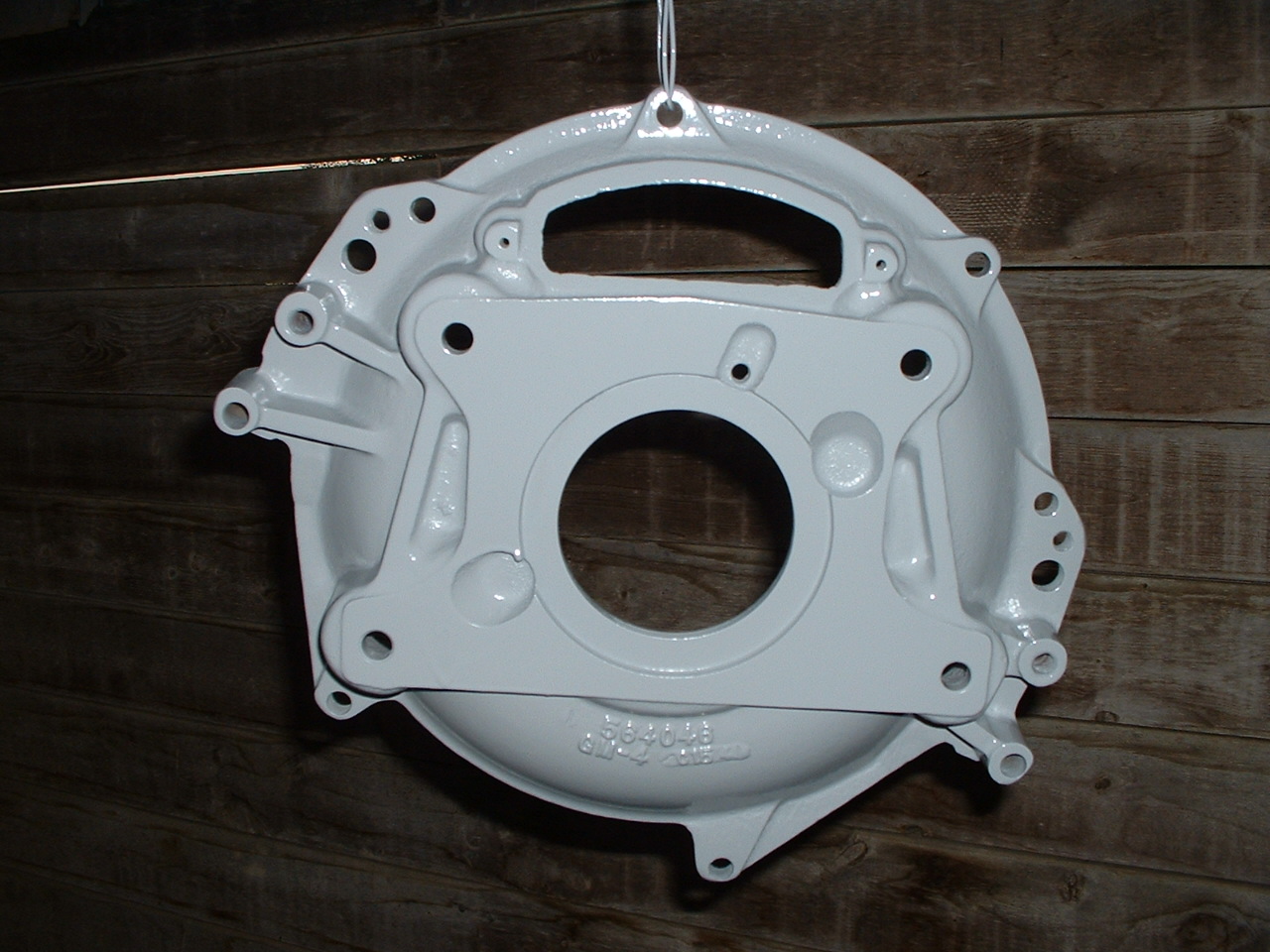

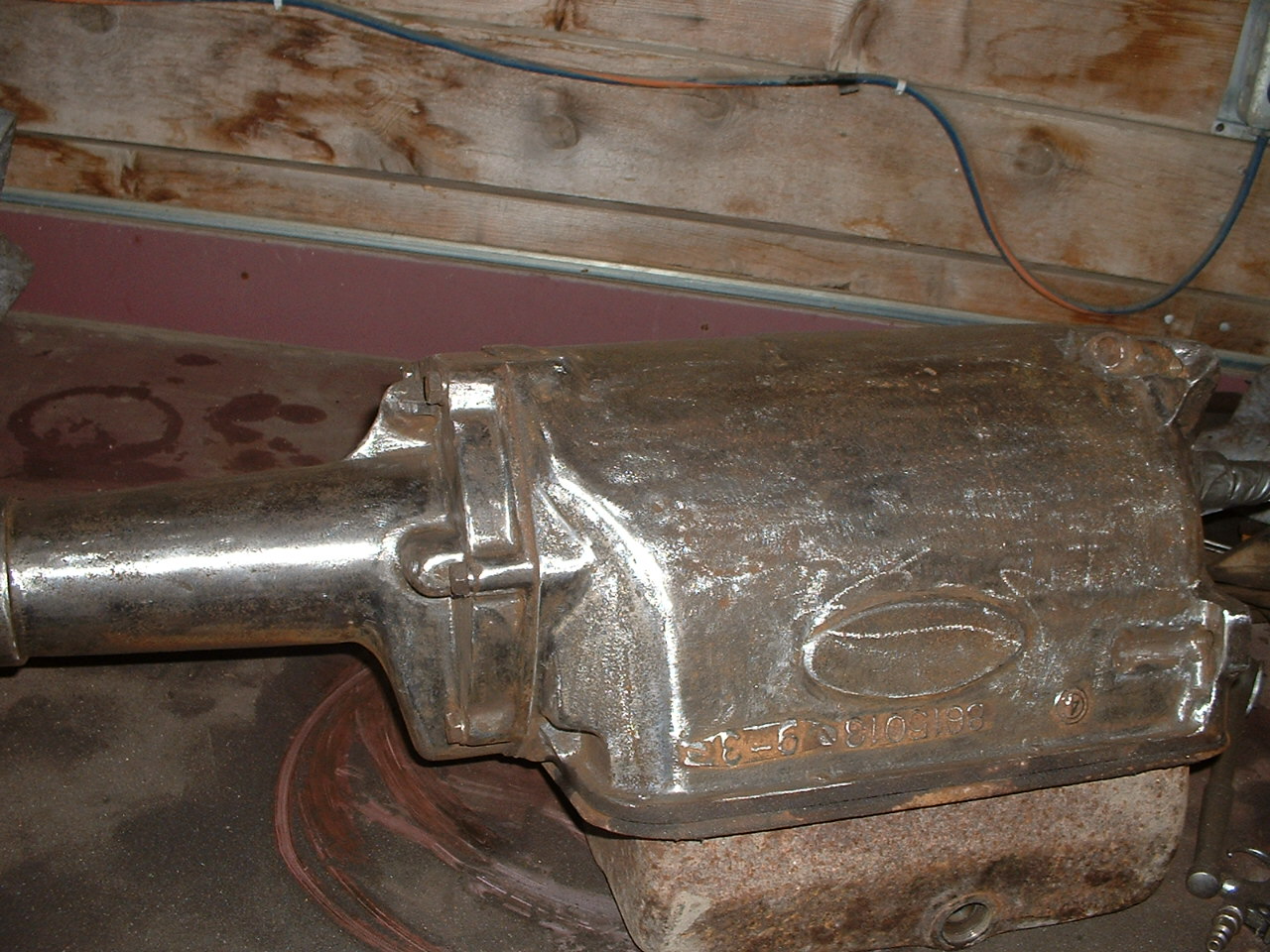

    Here are some pics of when I was smoothing out the case, and a couple pics with a fresh coat of Primer!

    engine an trans are looking good,glad to see your on it.looking forward to pics

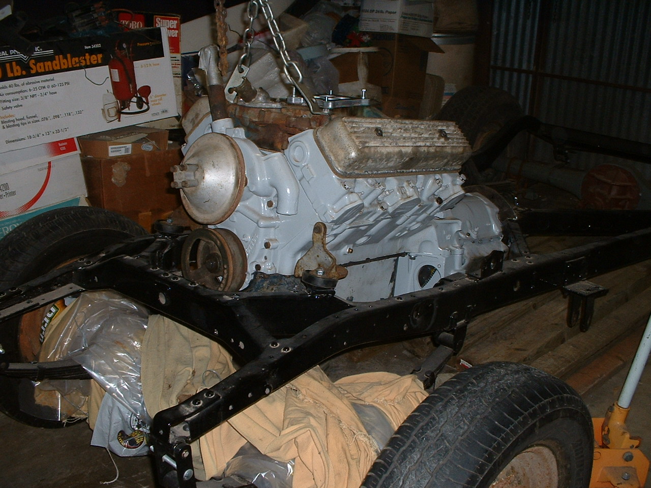

    I got the Engine and Transmission in the frame on Sunday! Fired it up last night, and ran it for sometime. Runs pretty good, carb needs a rebuild... but I will be switching it out for the Hilborn Injection anyways!!!!!!
