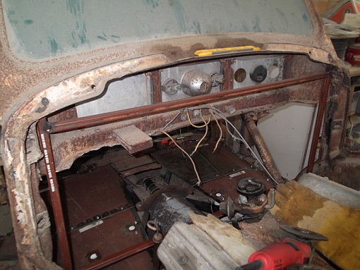

    Hey everyone I know its been awhile since ive posted, But I got the old floor pans and firewall out, and I am working on installing the new pans....
    Can I get some pics of how anyone mounted a UNDERFLOOR brake master cylinder to the stock Willys frame?
    I installed mine but its too far back, I would like it closer to the firewall....
    any pics would be great, just looking for ideas

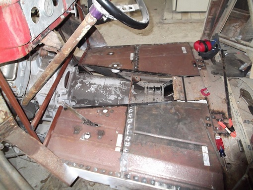

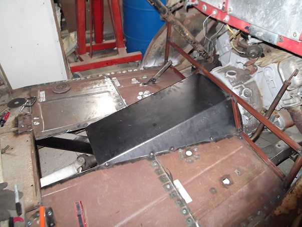

    Thank you Kiwi Kev, that is basically what I did, I got it about as far forward as I can, that pickup is looking nice.... I look at nasty habit for inspiration.

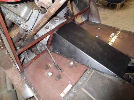

    I got the tunnel formed and tacked in today, bolted the hilborn manifolds to the heads, so I can start on my throttle linkage.

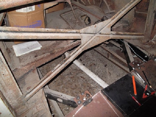

    Started cutting out the rusted metal on the rear part of the floor pan. 74 year old car, plus leaving the battery in the back since it was last ran, equals rusted floor pan!

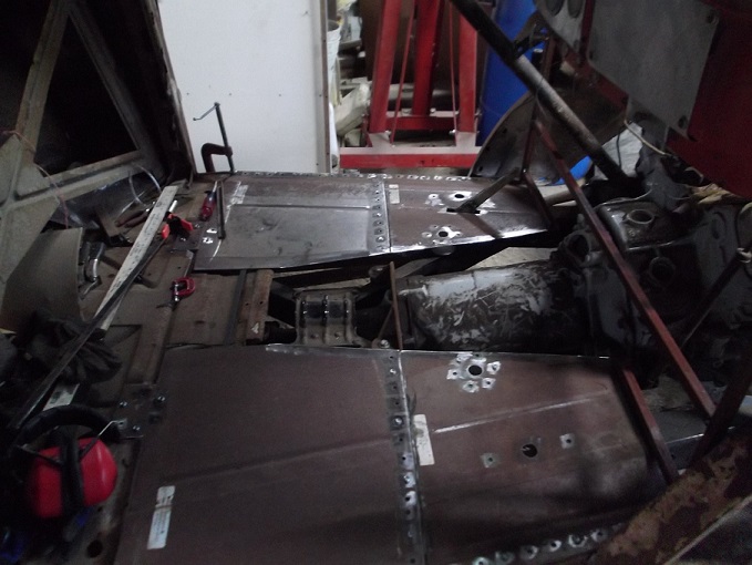

    I started cutting and shaping new panels for the rear floor pan section. I will take pics when I get them tacked in.

    I finally got the floor pan section under the shelf finish and tacked into place. I got a friend of mine to roll some beads in it to match the front, and stiffing it up a little.
