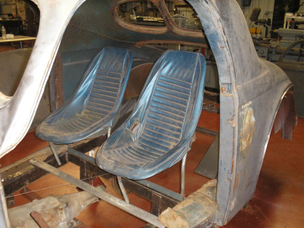

    Anybody have pictures, of there seat mounts?

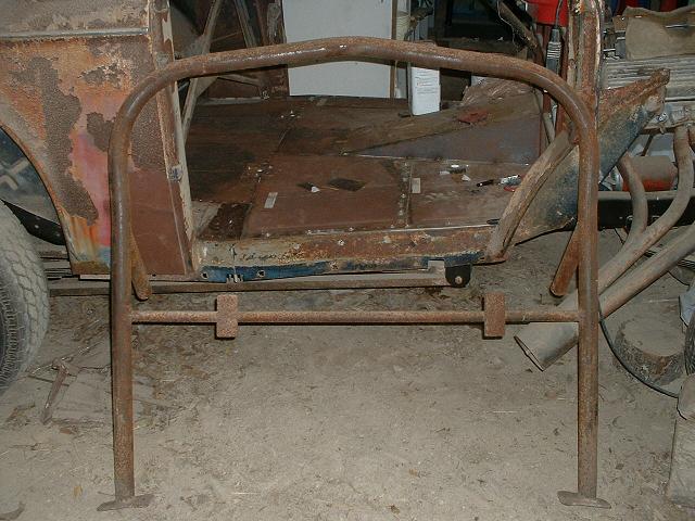

    Went and picked up the roll bar, that my dad built.
    And the center section, the EELCO tank still looks in good shape!

    I got the fuel lines and adapters off the tank so i can polish it up. I also got the roll bar mounted back into place so I can set up my seats and build seat risers.
    What thickness sheet metal should I use for the risers? I am going to make the sides out of steel "weight bearing", and a front panel out of aluminum or stainless steel with lightening holes "looks".

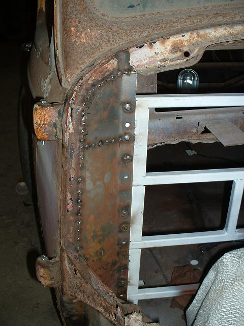

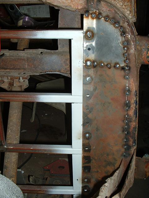

    Sorry guys, its been ahwile... But I got the firewall side panels tacked into place. And I have been fully welding the floor pans in also. Next is to weld some hat channel down so I can build seat mounts.

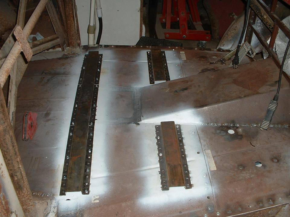

    I got the seat channels formed, primed the insides, and temporary bolted down. So I can build my seat mounts.

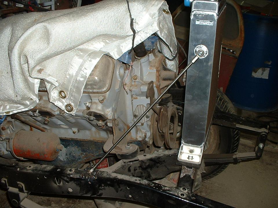

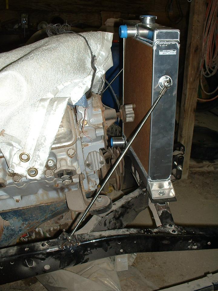

    I got my radiator mounted.
    I used stainless steel radiator support rods, for a Model A then cut them, and re-tapped the ends for hiem joints.
    Radiator came out Perfect! I used Eric Hazen, at C and R Racing. Very easy process, and great customer service.

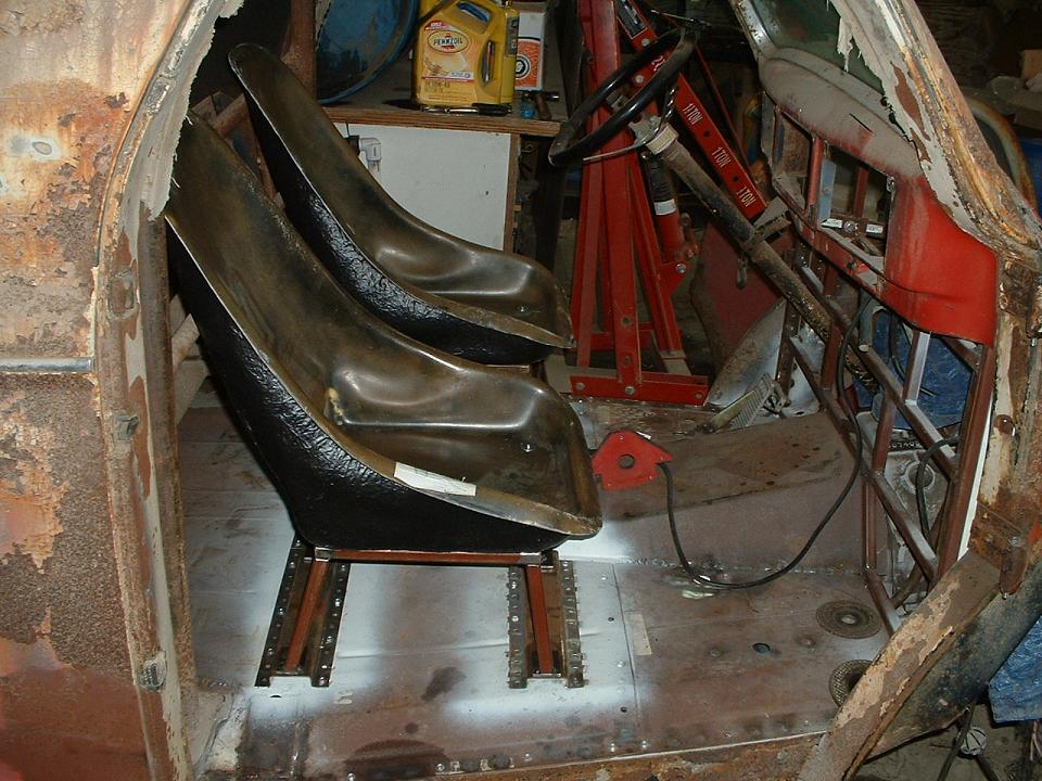

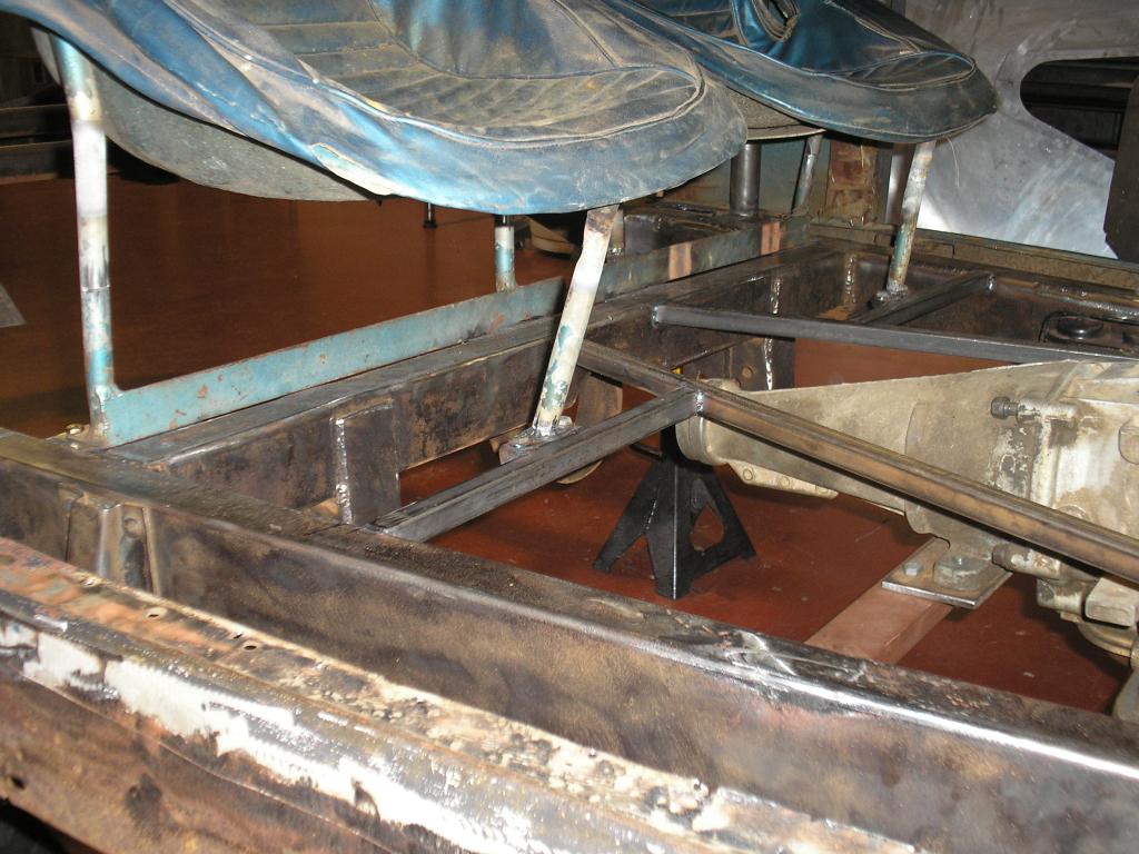

    Here are some seats from about the same era, if you still looking.
  29. ALLSTEELWILLYS
    Joined: Nov 2, 2009
    Posts: 154
    ALLSTEELWILLYS
    from TEXAS
    speedyb, thank you. Are you going? I really like your panel!
    glrbird, Thank you for the pictures, i did something like that, i just used square tubing.
    Here are a couple pictures of them.

    Looks good to me!
