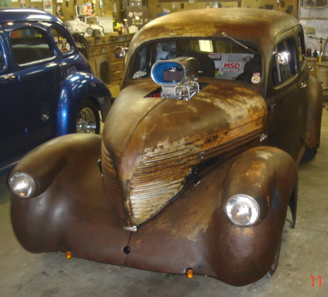

    Here is a pic of mine with stock rails, partially boxed with custom x members rides and holds up very well so far.
