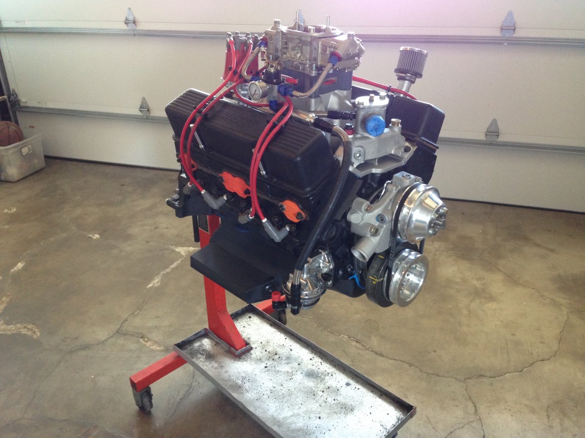

    Standard deal on all circle track using a SBC if allowed. Every engine we build for ours has these hoses. You can see them on the enclosed photo of our back-up engine B806C6B9-9739-49F7-A645-3869478554F8.jpeg
