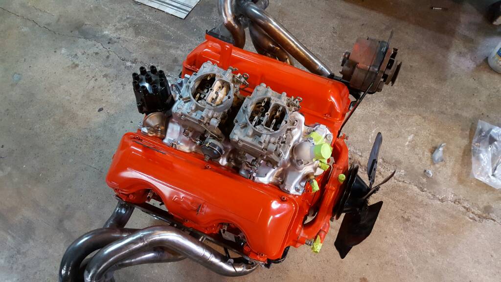

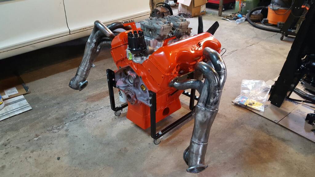

    Its called thermal barrier coating... the headers will be coated and a heat shield will be fabricated to protect the master.

    I always liked the look of fenderwell headers! Tight fit in that engine compartment but looking good!

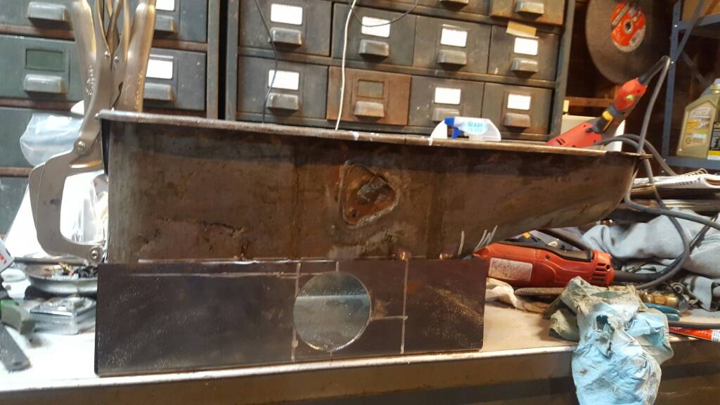

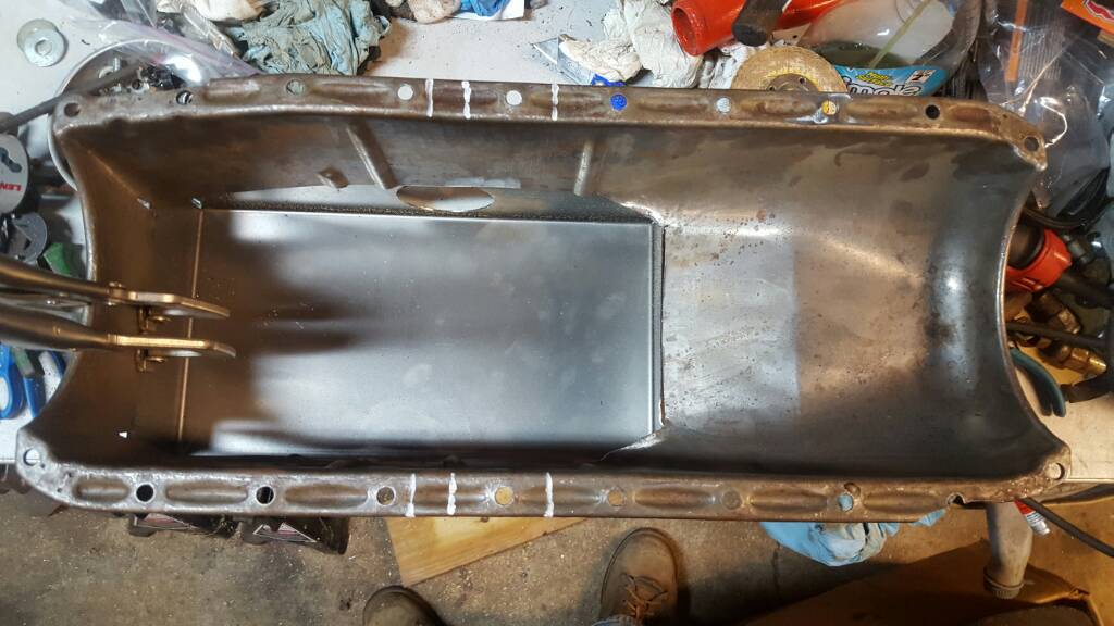

    In the process of reworking my oil pan. I decided to go with a pro stock style pan with a nearly full length sump. I will fabricate an oil control baffle to prevent the oil from climbing up the pan when braking and accelerating. I feel better about ground clearance now.

    Oil pan is done. Finished headers as well. Almost done with shock tower repairs.

    Is there space under the tube through the oil pan for oil to drain into the sump ?

    Yes. Plus a trap door to keep oil in the back near the pickup.

    Big Nova fan here, I especially like the headers, curious as to your reason for making one of the headers' collector a slip fit?

    Both headers are welded collectors. Maybe your eyes playing tricks on you

    The primary tubes look big...you have a Z11 in your future?

    2" primaries... I can neither confirm or deny that second question...

    Moroso used to have a lot of Chevy II oil pans for small blocks and big blocks with the tube running thru the sump. Looks good!

    Might have missed this? Did you TIG or MIG the headers.
  21. Fuelaltereds4life
    Joined: Dec 12, 2012
    Posts: 132
    Fuelaltereds4life
    I didn't personally weld them but the guy who did used a tig. They look pretty ratty but I figured thats what home made headers would have looked like back in the day right?
