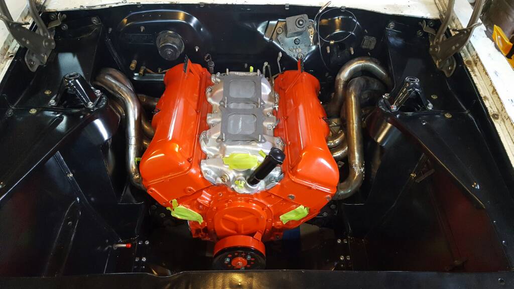

  4. Fuelaltereds4life
    Joined: Dec 12, 2012
    Posts: 132
    Fuelaltereds4life
    Engine and trans in. Verified header fitment. Great part about fender well headers is I dont have to go through any girations to take them off. Makes working on this thing a dream compared to under ch***is headers.

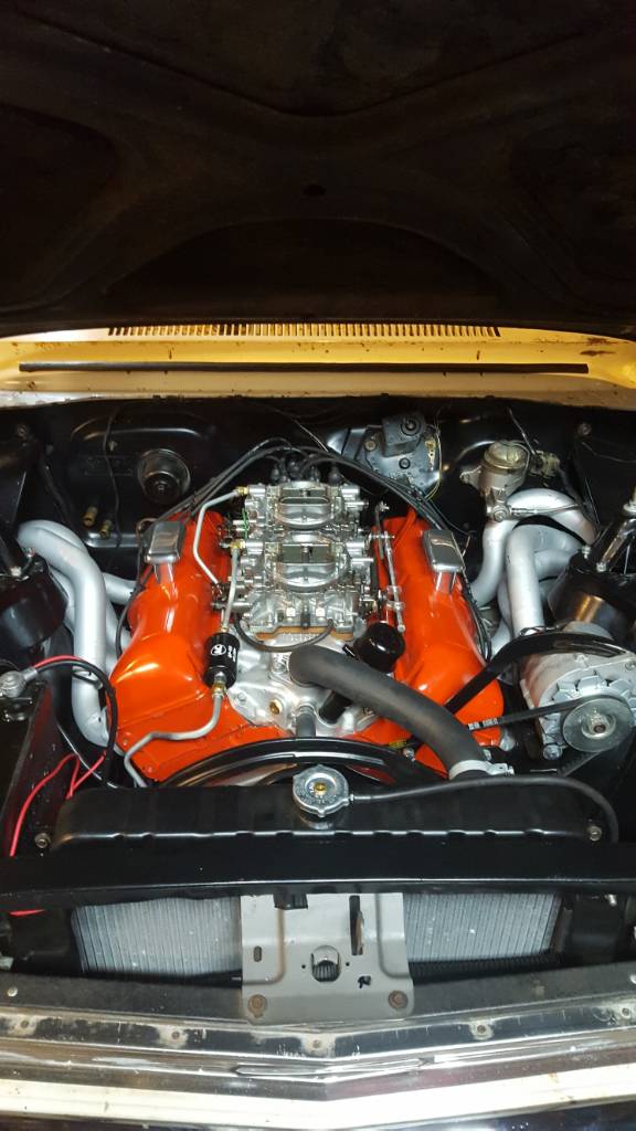

  6. Fuelaltereds4life
    Posts: 132
    Fuelaltereds4life
    Long overdue update.
    Car is running but some bugs to work out.

    Great job, do you think the exhaust header will create a problem with the master brake cylinder?

  15. Fuelaltereds4life
    Posts: 132
    Fuelaltereds4life
    Headers are HTC coated and so is the Master Cylinder so i think I will be ok... One of my winter projects is to fabricate a heat shield of some sort under the master cylinder.

  16. pumpman
    Joined: Dec 6, 2010
    Posts: 2,674
    pumpman
    Great, I was a little concerned about stopping that bad boy. It's too cool to wreck.
