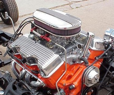

    You can build a good engine out of a truck core, but it's not cheap. Not many 409 budget builds. The block and heads are both scalloped out, but I think that only drops the compression something like .75 point. The trucks low compression is in the pistons, replace them, port the heads/bigger valves, good cam (Isky still makes them), do all of the detail work and your good to go.
    This started life in a truck.
    Larry T
