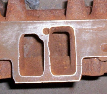

    This started life as a truck engine.
    Ross makes lightweight pistons that will get you where you need to be on compression.
    You can install larger high quality valves and work the heads to get better flow, but you wouldn't have hard seats like the aftermarket heads.
    The tri-power won't make the horsepower of an after market intake, but the wow factor is there and they fit the truck heads with no problems.
    I don't see 350 hp as any problem.
    The 409 is a big bore/short stroke engine. It should rpm as high as you reasonably want to turn it, if you build it right with light weight pistons (heavy pistons from the factory caused high rpm problems from the factory) and good parts.
    I even opened up the standard truck heads to a stock high performance intake on this engine. I don't know if it helped, but it was port matched. Here's the junk head I used to see if it was going to work or not. I had to drag it out of the junk pile to take the picture. You do lose the intake bolt between the ports on the deal.
