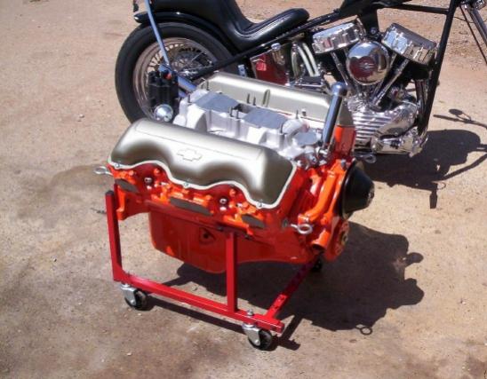

    And the love affair with the 409 continues! Yes I am glad I pulled the trigger! Now here's a question: stamped valve covers or cast aluminum of some sort, offy, weiand, Chevrolet, etc?
  12. DDDenny
    Posts: 23,431
    Chrome, preferably with some patina (rust).

  14. Depends on the rest of the engine but straight chrome or the argent silver painted covers. If you go aluminum- full polish.

    I see they are making fake Aluminum valve covers for the 409 that look like Ford Flathead heads AND you can get them cast or polished..................................................................

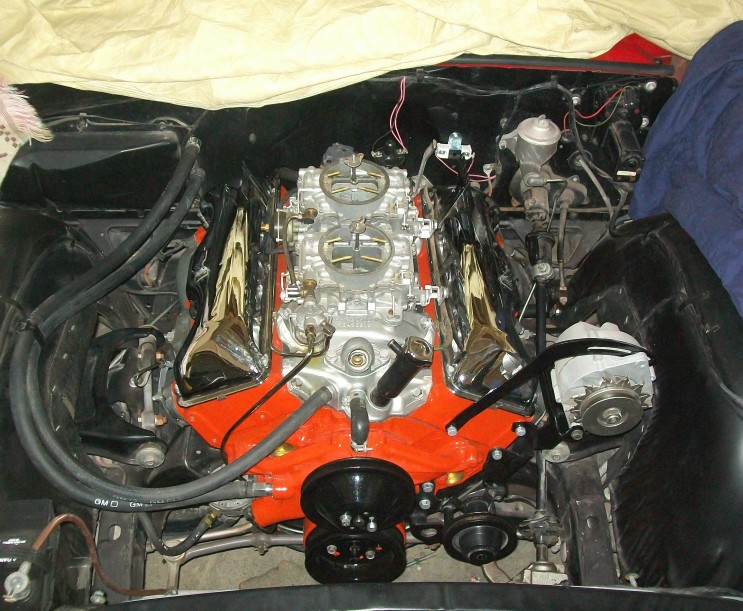

    409 truck block only has 1 notch, and drops compression .75 or so. I would shoot for 9.5-10.5 compression, modern camshaft, stainless valves, loose the rotators, little bowl work, and dual quads. 350-400 horse and way more torque than that Saginaw can handle! Engine in picture has 333 truck heads.

    Lots of folks make aftermarket 409 valve covers, these are Moon. Then there are the silver argent covers that were 1962 high performance only. Show Cars sells the "correct" color in a spray can. Chrome are 63 up high performance covers.

    good info, thanks. I like the silver stamped ones which are on my motor right now but the offy and weiand cast units are nice too. Lots of time to decide

    you and I are thinking the same thing, t-10
  22. Fordors
    Joined: Sep 22, 2016
    Posts: 7,052
    Fordors
    I don't think so, the vent on top of the tail shaft says Saginaw to me. You can just make it out by the shifter bracket.

  24. falcongeorge
    Joined: Aug 26, 2010
    Posts: 18,339
    falcongeorge
    from BC
    had to put my reading gl***es on for that one.

    yup. I took a look at that, and a quick look at the pic (without my cheaters, getting old ****s) and jumped to the obvious conclusion.

    I didn't have to look, Saginaws didn't come out until the 66 model year.
    I know this kind of minutia generally has little value here but I don't want to perpetuate the "I read it on the internet" deal.
