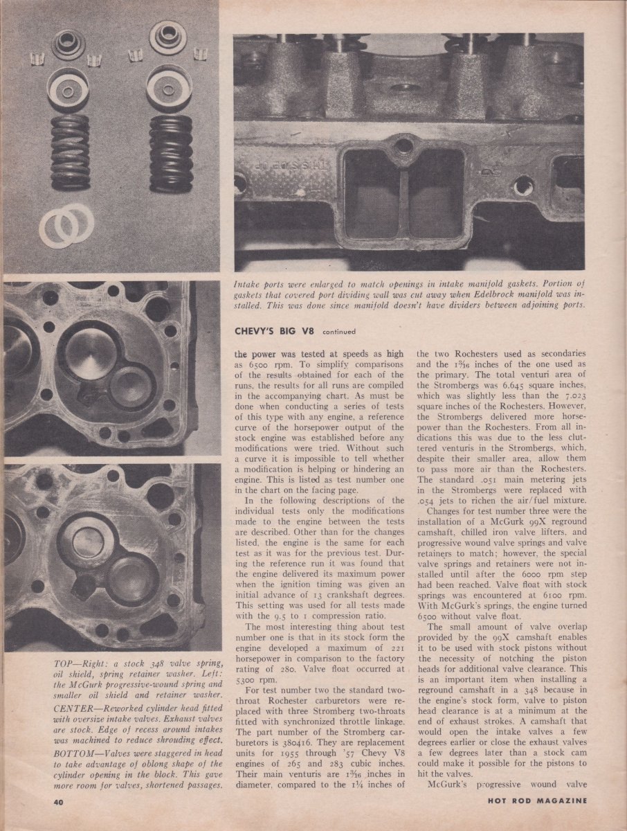

    I think these are the same as your heads, so you may find this pertinent. I would expect a modern cam to be up about 20-25hp when compared to a similar duration cam from the late fifties.
    w001.jpg w002.jpg w003.jpg w004.jpg w005.jpg w006.jpg w007.jpg w008.jpg w009.jpg w010.jpg
