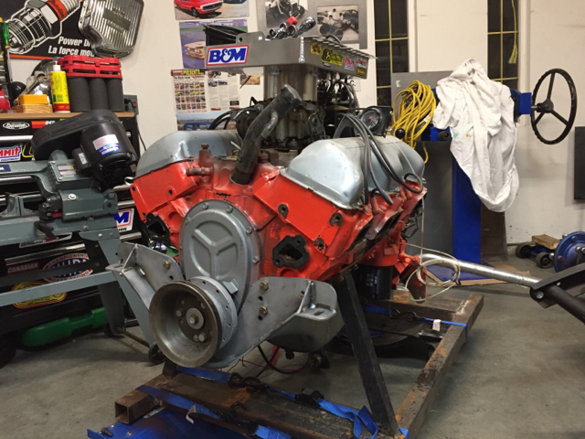

    One step closer to hanging her between the rails for a test fit. Got the unnecessary stuff stripped off the motor for now and my hurst mount bolted on.

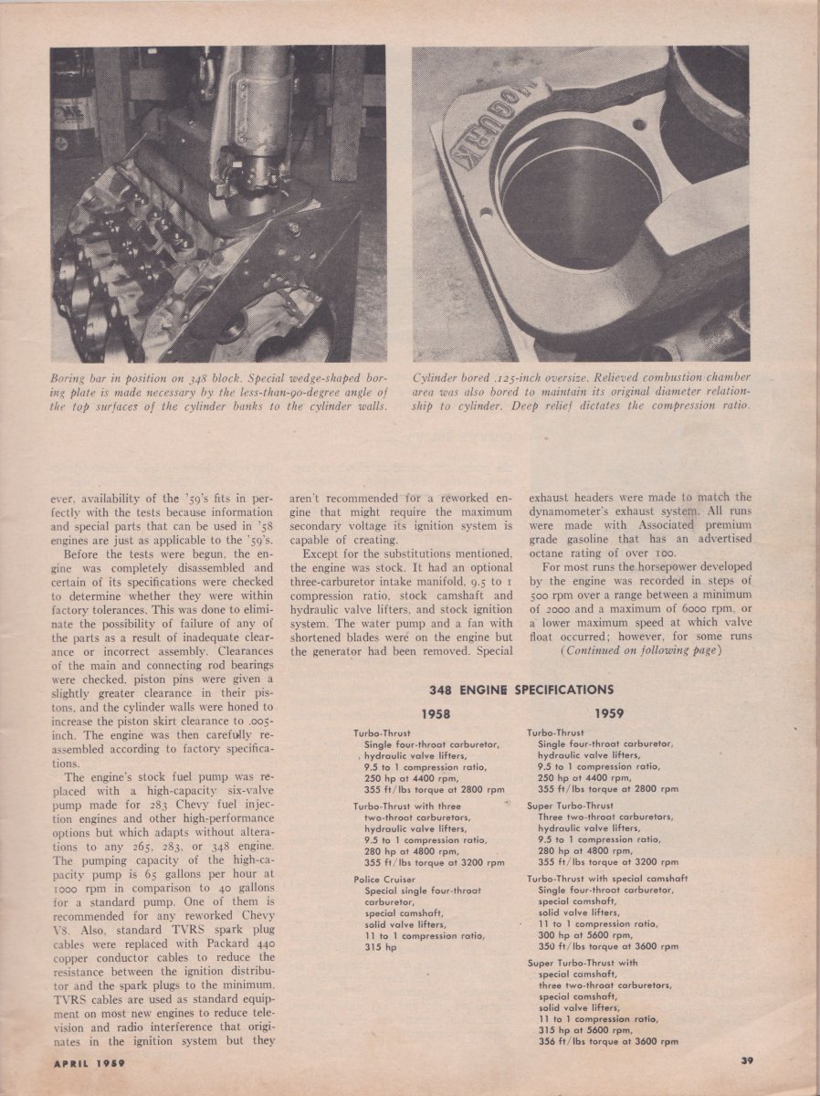

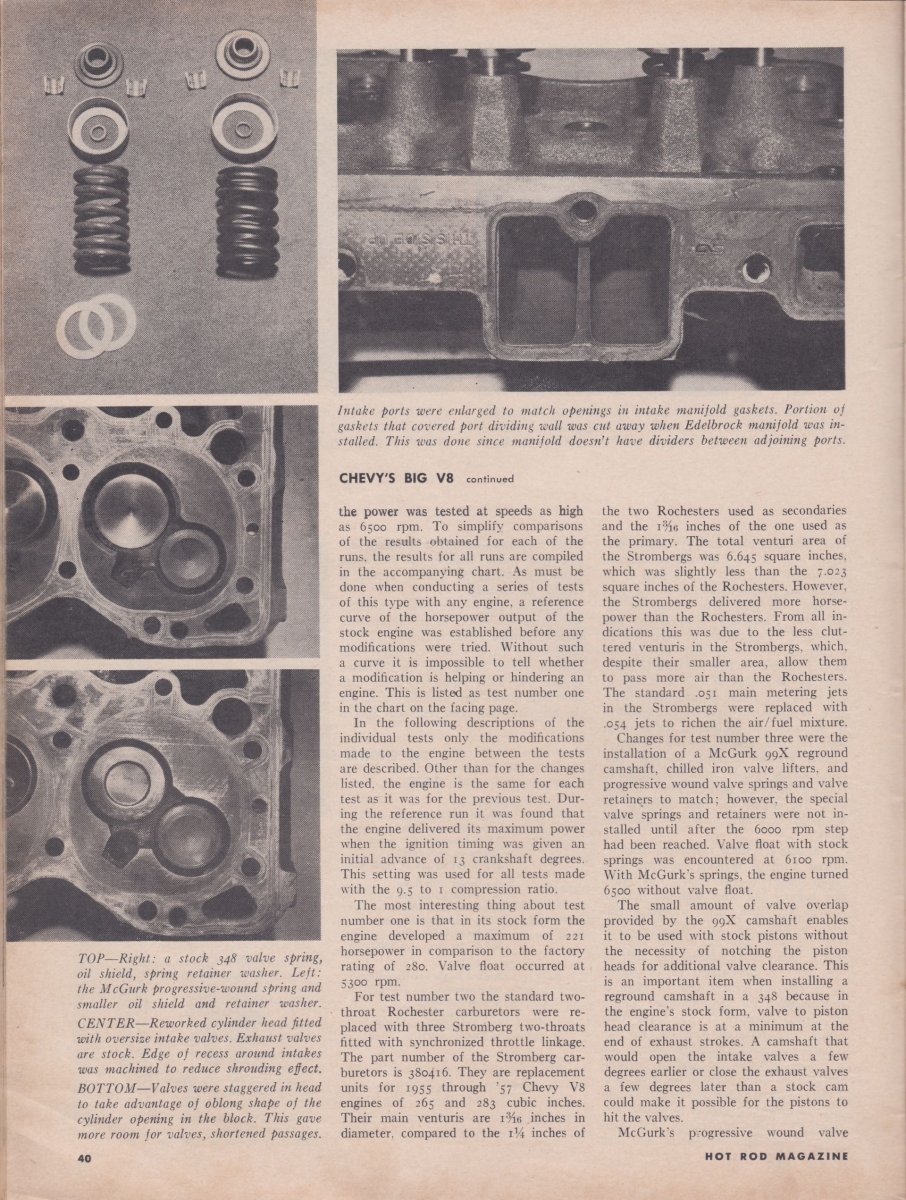

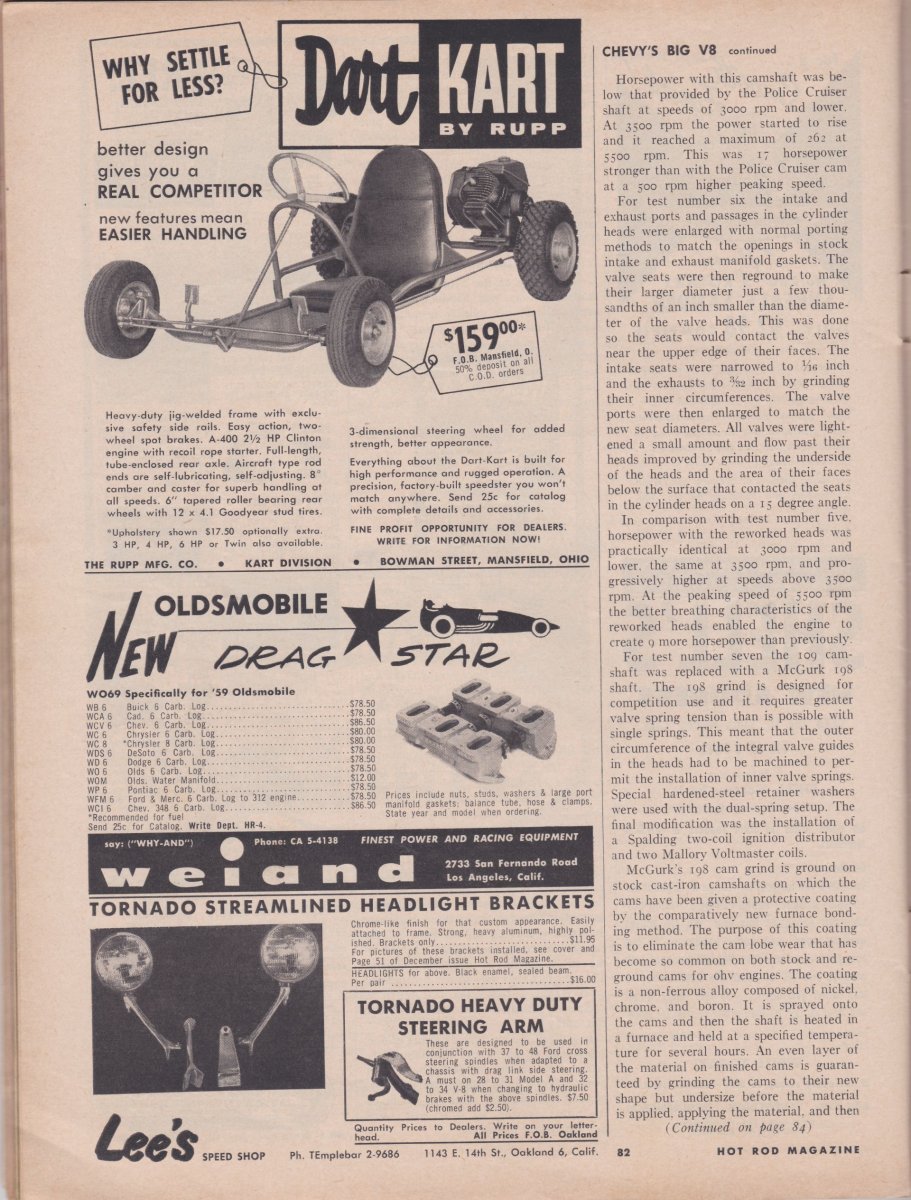

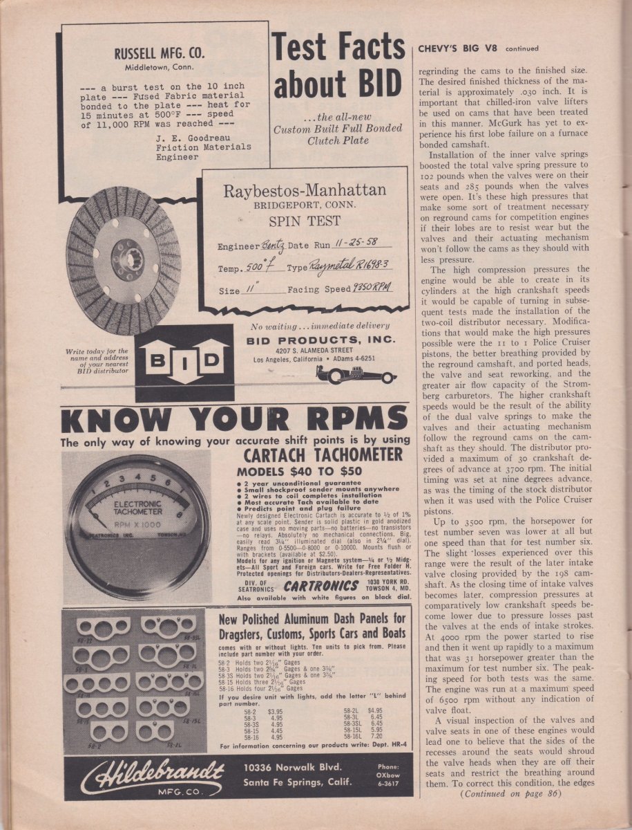

    My filing cabinet.:p;) April 1959 Hot Rod.

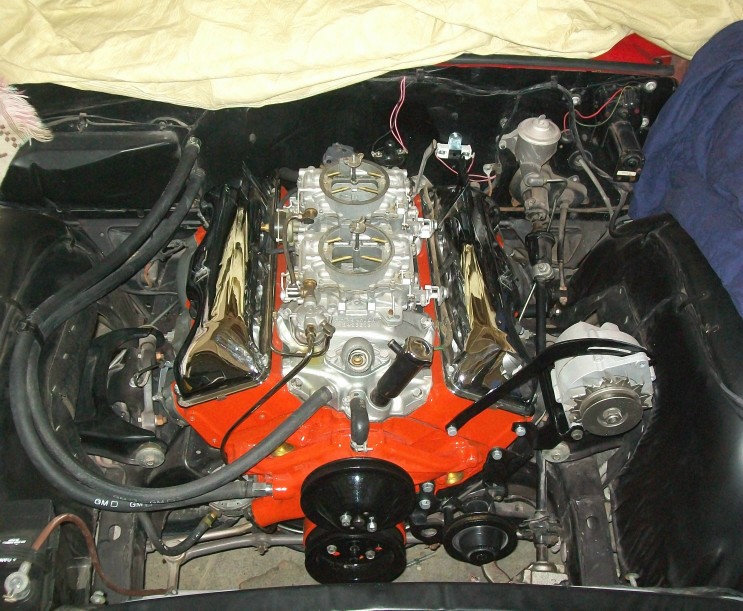

    I transplanted a 425 hp 409 into my '63 Impala (originally a 327/powerglide car). The engine was built using a block, crank and rods from a '65 truck. The heads and dual quad intake are factory '63 425 hp pieces. I had Isky ground a cam to the factory 425 hp specs. Pistons are from Ross. I'm no expert, but I learned some things during this process.
    Every thing about these is expensive, I have about $11,000 the purchase of and rebuild of the engine.
    I've noticed a few posts that mention raising compression and changing heads. The combustion chambers on a 409 are in the block, so changing heads can change flow, but will not change compression.
    As for the dual quad carbs (I know this doesn't apply to you using tri power), I had the factory correct carbs, sent them to a 409 carb expert for rebuilds ($500), and I couldn't get the car to run right. Bought two 500 cfm Edelbrocks from Pep Boys, and the car runs great. Sold the factory carbs to a restorer for a pile of cash.
    Last thing, with a tripower on it, most folks will think it's a 348, but so what, it'll still be cool as hell. I say go for it!
