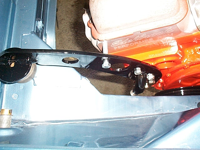

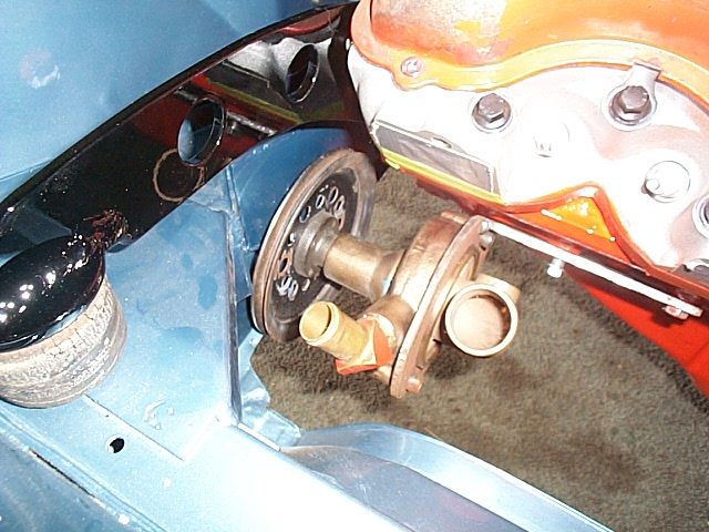

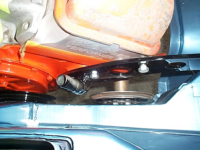

  21. NASTY 1
    Joined: Jul 24, 2011
    Posts: 98
    NASTY 1
    here's some pics of the side mounted solid br*** reverse rotation marine water pump
    Gasser 57 likes this.
  22. Who makes that pump? I hope you are going to paint those heads.

  24. NASTY 1
    Posts: 98
    NASTY 1
    Sherwood Br*** Works makes the pump .it does not have a part number, it is a reverse rotation unit, I purchased it off EBAY These pumps were used on Chris Craft and likely others.
