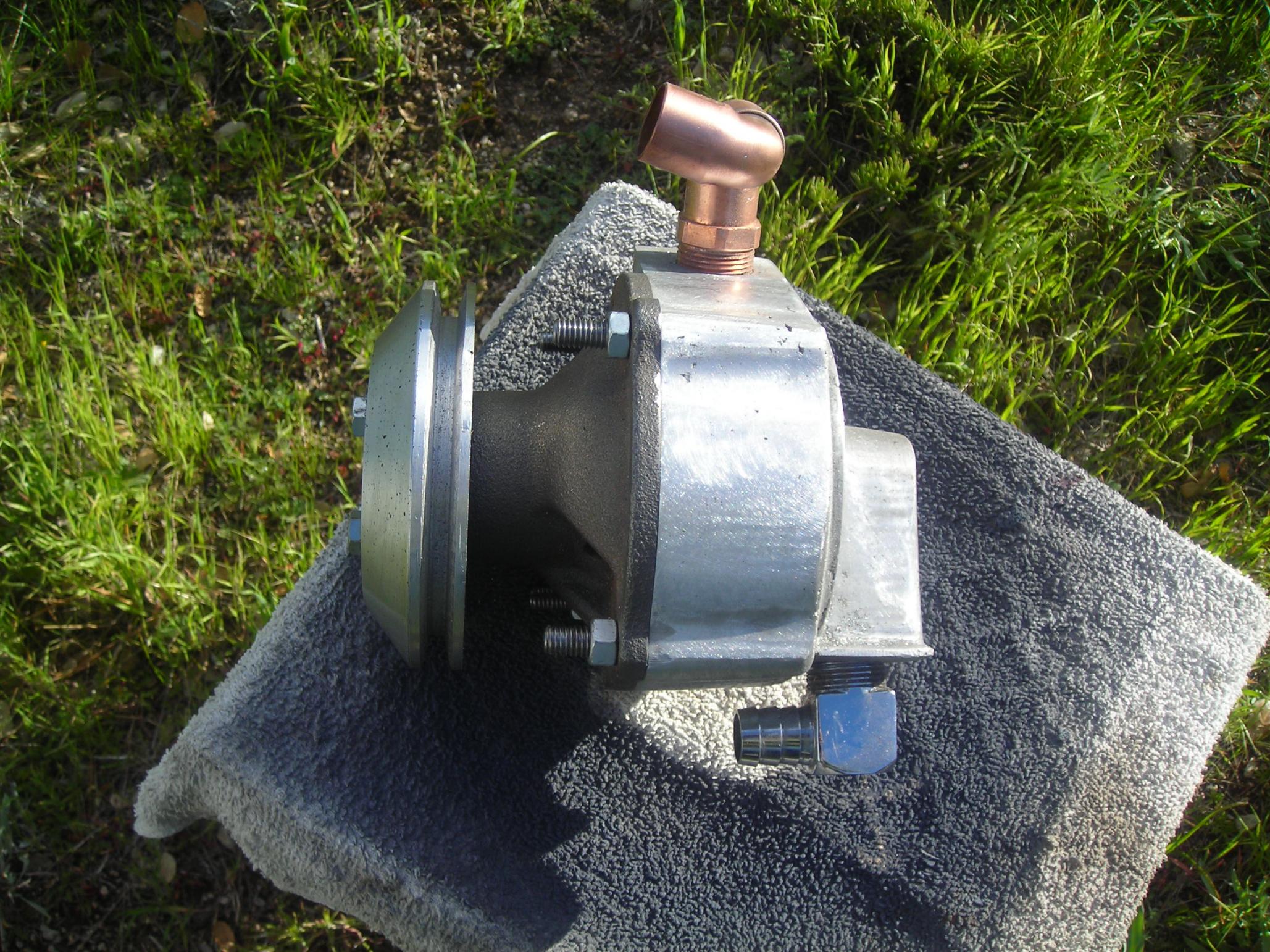

  2. Here's a pump that I built for my Boss Hoss bike. I cast and machined the housing in my home shop and used a 383/440/Hemi pump. Works *****en
