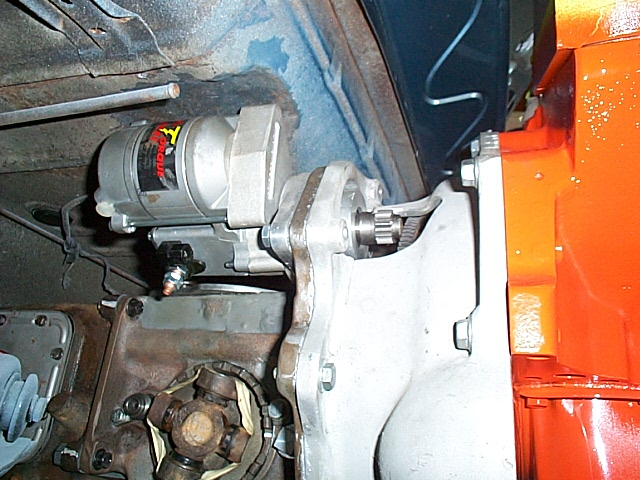

    High torque starter in place:)

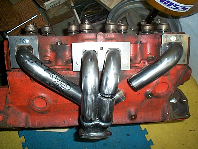

    Building block huggers headers for the 409, modified Summit small block headers, cheap ! The tubes are a little bit small but I think it will work OK.;)

    should work just fine. there's no reason to twist that thing up to 8 grand or anything. it'll make all the HP & torque most folks have the balls for at half that rpm that those headers were designed for. i'm guessing that they were designed for 7/8 the cu. in. and 6-8K rpm.

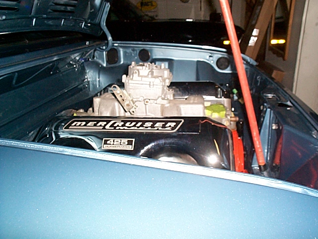

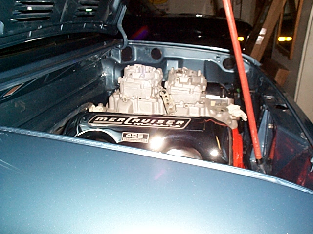

    I can't decide:confused: single four barrel or dual quad setup?:confused: what do you think?
  11. Ole don
    Joined: Dec 16, 2005
    Posts: 2,915
    Ole don
    Go with the single. It will run better at very low RPM's, where you may find its fun to drive. Easier to get a decent air cleaner to fit too.
    With a torque monster like that, it should go down to 18 MPH in high and out-pull anything in the other lane

    from Mass.
    This is no time to start going conservative .... dual quads of course!

    thats gonna be a hell of a ride, i say 2 4s.

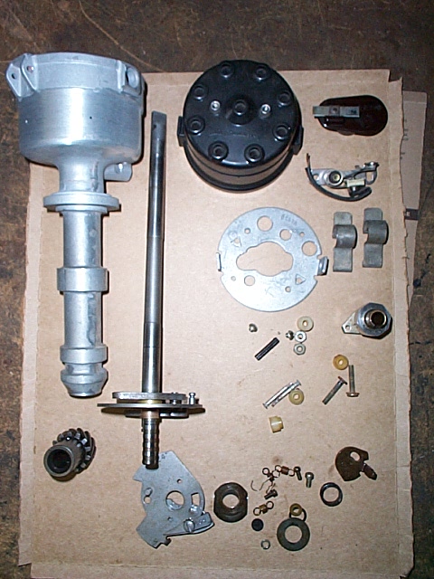

    I am using a vintage Mallory 348/409 distributor to help reduce the weight a tiny bit, the stock cast iron 409 dist weighs 6 pounds,:eek:YIKES the Mallory unit weighs 3 pounds:)
